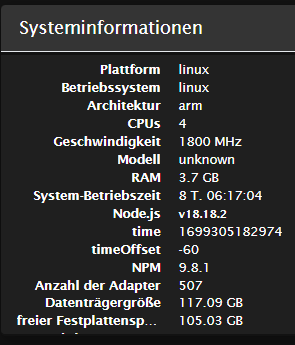

                     Icon name: computer
              Operating System: Raspbian GNU/Linux 11 (bullseye)
                        Kernel: Linux 6.1.58-v8+
                  Architecture: arm64
            Model           : Raspberry Pi 4 Model B Rev 1.5
            Docker          : false
            Virtualization  : none
            Kernel          : aarch64
            Userland        : armhf
            Systemuptime and Load:
             22:52:35 up 8 days,  6:53,  1 user,  load average: 0.91, 0.70, 0.70
            CPU threads: 4
            *** RASPBERRY THROTTLING ***
            Current issues:
            Previously detected issues:
            *** Time and Time Zones ***
                           Local time: Mon 2023-11-06 22:52:35 CET
                       Universal time: Mon 2023-11-06 21:52:35 UTC
                             RTC time: n/a
                          NTP service: active
                      RTC in local TZ: no
            *** User and Groups ***
            pi
            /home/pi
            pi adm dialout cdrom sudo audio video plugdev games users input render netdev gpio i2c spi iobroker
            *** X-Server-Setup ***
            X-Server:       false
            Desktop:
            Terminal:       tty
            *** MEMORY ***
            Mem:            3.8G        1.8G        490M        2.0M        1.5G        2.0G
            Swap:            99M         58M         41M
            Total:          3.9G        1.8G        532M
                     3792 M total memory
                     1765 M used memory
                     1744 M active memory
                     1144 M inactive memory
                      490 M free memory
                       23 M buffer memory
                     1512 M swap cache
                       99 M total swap
                       58 M used swap
                       41 M free swap
            Raspberry only:
            oom events: 0
            lifetime oom required: 0 Mbytes
            total time in oom handler: 0 ms
            max time spent in oom handler: 0 ms
            *** FAILED SERVICES ***
            0 loaded units listed.
            *** FILESYSTEM ***
            /dev/root      ext4      118G   13G  101G  11% /
            devtmpfs       devtmpfs  1.6G     0  1.6G   0% /dev
            tmpfs          tmpfs     1.9G  3.5M  1.9G   1% /dev/shm
            tmpfs          tmpfs     759M  880K  758M   1% /run
            tmpfs          tmpfs     5.0M  4.0K  5.0M   1% /run/lock
            /dev/sda1      vfat      253M   52M  201M  21% /boot
            tmpfs          tmpfs     380M     0  380M   0% /run/user/999
            tmpfs          tmpfs     380M     0  380M   0% /run/user/1000
                         3792 M total memory
                         1765 M used memory
                          490 M free memory
                           23 M buffer memory
                         1512 M swap cache
                           99 M total swap
                           58 M used swap
                           41 M free swap
                Raspberry only:
                oom events: 0
                *** FILESYSTEM ***
