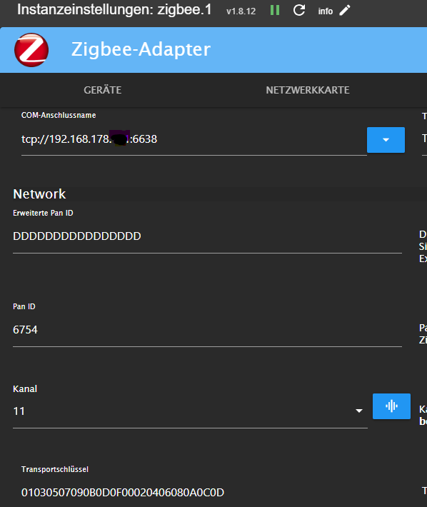

        @thomas-braun Hallo Thomas, ja habe ich mittlerweile gemacht, dass Ergebnis bleibt aber wie oben beschrieben
        zigbee.1
        5473	2023-07-26 21:13:11.435	warn	Terminated (UNCAUGHT_EXCEPTION): Without reason
        zigbee.1
        5473	2023-07-26 21:13:11.434	info	terminating
        zigbee.1
        5473	2023-07-26 21:13:10.925	info	Zigbee: disabling joining new devices.
        zigbee.1
        5473	2023-07-26 21:13:10.922	info	cleaned everything up...
        zigbee.1
        5473	2023-07-26 21:13:10.908	error	Cannot read properties of undefined (reading 'Error')
        zigbee.1
        5473	2023-07-26 21:13:10.907	error	TypeError: Cannot read properties of undefined (reading 'Error') at /opt/iobroker/node_modules/iobroker.zigbee/main.js:122:56 at Hub.configureScope (/opt/iobroker/node_modules/@sentry/src/hub.ts:340:1) at Object.configureScope (/opt/iobroker/node_modules/@sentry/src/exports.ts:76:1) at Zigbee.sendError (/opt/iobroker/node_modules/iobroker.zigbee/main.js:118:32) at Zigbee.onZigbeeAdapterReady (/opt/iobroker/node_modules/iobroker.zigbee/main.js:415:30)
        zigbee.1
        5473	2023-07-26 21:13:10.870	error	unhandled promise rejection: Cannot read properties of undefined (reading 'Error')
        zigbee.1
        5473	2023-07-26 21:13:10.869	error	Unhandled promise rejection. This error originated either by throwing inside of an async function without a catch block, or by rejecting a promise which was not handled with .catch().
        zigbee.1
        5473	2023-07-26 21:13:10.867	error	Unable to apply ExtPanID changes: Error: SRSP - SYS - osalNvRead after 0,2ms
        zigbee.1
        5473	2023-07-26 21:13:10.864	info	Zigbee started
        zigbee.1
        5473	2023-07-26 21:13:10.863	info	Currently no devices.
        zigbee.1
        5473	2023-07-26 21:13:10.852	info	--> transmitPower : high+
        zigbee.1
        5473	2023-07-26 21:13:10.833	info	Unable to disable LED, unsupported function.
        zigbee.1
        5473	2023-07-26 21:13:10.832	info	Disable LED
        zigbee.1
        5473	2023-07-26 21:13:10.822	info	Coordinator firmware version: {"type":"zStack3x0","meta":{"transportrev":2,"product":1,"majorrel":2,"minorrel":7,"maintrel":1,"revision":20220726}}
        zigbee.1
        5473	2023-07-26 21:13:07.762	error	Running despite adapter configuration mismatch as configured. Please update the adapter to compatible firmware and recreate your network as soon as possible.
        zigbee.1
        5473	2023-07-26 21:13:07.761	error	Re-commissioning your network will require re-pairing of all devices!
        zigbee.1
        5473	2023-07-26 21:13:07.761	error	If you wish to re-commission your network, please remove coordinator backup at /opt/iobroker/iobroker-data/zigbee_1/nvbackup.json.
        zigbee.1
        5473	2023-07-26 21:13:07.760	error	Please update configuration to prevent further issues.
        zigbee.1
        5473	2023-07-26 21:13:07.759	error	- Channel List: configured=11, adapter=11
        zigbee.1
        5473	2023-07-26 21:13:07.759	error	- Network Key: configured=01030507090b0d0f00020406080a0c0d, adapter=01030507090b0d0f00020406080a0c0d
        zigbee.1
        5473	2023-07-26 21:13:07.758	error	- Extended PAN ID: configured=00124b0025792115, adapter=00124b0025792115
        zigbee.1
        5473	2023-07-26 21:13:07.757	error	- PAN ID: configured=6754, adapter=6755
        zigbee.1
        5473	2023-07-26 21:13:07.756	error	Configuration is not consistent with adapter state/backup!
        • M michihorn

                @michihorn
                Warum steht in deinem Screenshot der 'DDDDDDDDDDDDDD'-Standard drin?
                  @michihorn
                  michihorn
                  @thomas-braun sagte in Zigbee mit TCP:
                  00124b0025792115
                  Weil er die ID in der Konfiguration ROT Unterstrichen hat.
                  Anbei das LOG

                        @michihorn sagte in Zigbee mit TCP:
                        Ich wiederhole mich glaube ich.
                        Die Werte MÜSSEN übereinstimmen.

                            michihorn
                            schrieb am zuletzt editiert von michihorn
                            @thomas-braun Ich weiß hattest du geschrieben, habe ich auch mittels Screenshot gezeigt.
                            Offenbar ist irgendwo noch die 6755 gespeichert.
                            Ich habe aus dem aktuellen Protokoll eine neue Erweiterte Pan ID angezeigt bekommen, die konnte gespeichert werden, im Moment ist der Adapter grün. Das wars leider nicht nun ist der Adapter gelb. Sentry ist ausgeschaltet. Witzigerweise ist wärend ich hier schreibe der Adapter wieder auf grün gegangen
                            Nun ist er wieder auf gelb, im Protokoll steht folgendes:

                                    2023-07-26 21:57:03.868  - info: zigbee.1 (6127) Coordinator firmware version: {"type":"zStack3x0","meta":{"transportrev":2,"product":1,"majorrel":2,"minorrel":7,"maintrel":1,"revision":20220726}}
                                    2023-07-26 21:57:03.870  - info: zigbee.1 (6127) Disable LED
                                    2023-07-26 21:57:03.871  - info: zigbee.1 (6127) Unable to disable LED, unsupported function.
                                    2023-07-26 21:57:03.872  - info: zigbee.1 (6127)   --> transmitPower : high+
                                    2023-07-26 21:57:03.883  - info: zigbee.1 (6127) Coordinator firmware version: {"type":"zStack3x0","meta":{"transportrev":2,"product":1,"majorrel":2,"minorrel":7,"maintrel":1,"revision":20220726}}
                                    2023-07-26 21:57:03.883  - info: zigbee.1 (6127) Disable LED
                                    2023-07-26 21:57:03.884  - info: zigbee.1 (6127) Unable to disable LED, unsupported function.
                                    2023-07-26 21:57:03.885  - info: zigbee.1 (6127)   --> transmitPower : high+
                                    2023-07-26 21:57:03.892  - info: zigbee.1 (6127) Currently no devices.
                                    2023-07-26 21:57:03.892  - info: zigbee.1 (6127) Zigbee started
                                    2023-07-26 21:57:03.901  - info: zigbee.1 (6127) Currently no devices.
                                    2023-07-26 21:57:03.901  - info: zigbee.1 (6127) Zigbee started

                                        michihorn
                                        @thomas-braun Danke für deinen Einsatz, konnte auch gerade ein Gerät pairen
