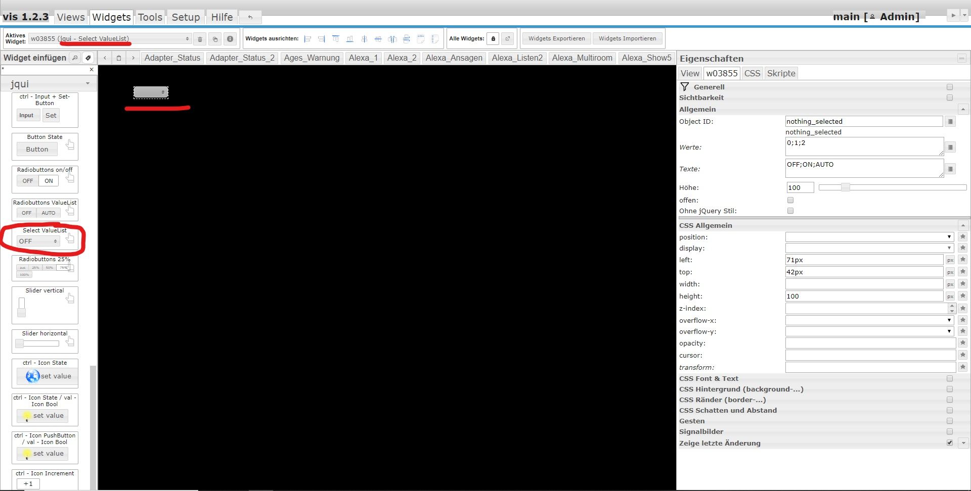

                      @sigi234 .. hi Sigi - die hatte ich bereits installiert.
                      Habe nur gerade Probleme die HM Thermostate zwischen AUTO/MAN/PARTY/BOOST
                      Mode zu schalten. Weiß nicht wirklich bei welchen Objekt ich ansetzen muss.
                      Habe den jqui probiert:
                      Mit folgenden Werten , mit diesem Object: hm-rpc.0.PEQ1259765.2.CONTROL_MODE
                      Die Werte ändern sich auch, nur das Thermostat ändern den Zustand nicht.
                      ∘ MB ASRock J4105M Intel J4105 CPU M-ATX | 16 GB RAM | 480 GB SSD ∘ PROXMOX LCX-Container > IoBroker
                      • TG70T TG70

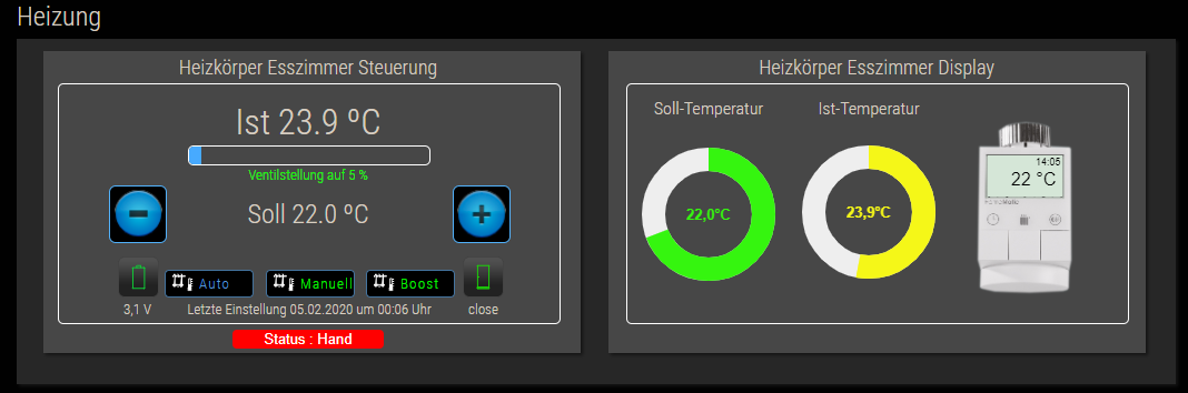

                        sigi234
                        @TG70
                        Teste mal:
                        Widget:
                        [{"tpl":"tplValueLastchange","data":{"oid":"hm-rpc.0.OEQ0655913.4.SET_TEMPERATURE","visibility-cond":"==","visibility-val":1,"signals-cond-0":"==","signals-val-0":true,"signals-icon-0":"/vis/signals/lowbattery.png","signals-icon-size-0":0,"signals-blink-0":false,"signals-horz-0":0,"signals-vert-0":0,"signals-hide-edit-0":false,"signals-cond-1":"==","signals-val-1":true,"signals-icon-1":"/vis/signals/lowbattery.png","signals-icon-size-1":0,"signals-blink-1":false,"signals-horz-1":0,"signals-vert-1":0,"signals-hide-edit-1":false,"signals-cond-2":"==","signals-val-2":true,"signals-icon-2":"/vis/signals/lowbattery.png","signals-icon-size-2":0,"signals-blink-2":false,"signals-horz-2":0,"signals-vert-2":0,"signals-hide-edit-2":false,"format_date":"DD.MM.YYYY um hh:mm Uhr","html_prepend":"Letzte Einstellung ","visibility-groups-action":"hide","name":"Wohnzimmer HK2","lc-type":"last-change","lc-is-interval":true,"lc-is-moment":false,"lc-format":"","lc-position-vert":"top","lc-position-horz":"right","lc-offset-vert":0,"lc-offset-horz":0,"lc-font-size":"12px","lc-font-family":"","lc-font-style":"","lc-bkg-color":"","lc-color":"","lc-border-width":"0","lc-border-style":"","lc-border-color":"","lc-border-radius":10,"lc-zindex":0},"style":{"left":"148px","top":"274px","width":"260px","font-style":"normal","font-variant":"normal","font-size":"small","height":"15px","color":"#d7cec1","z-index":"1","text-align":"center","font-family":"RobotoCondensed-Light"},"widgetSet":"basic"},{"tpl":"tplValueFloat","data":{"oid":"hm-rpc.0.OEQ0655913.4.BOOST_STATE","visibility-cond":"==","visibility-val":"3","is_comma":"true","factor":"1","html_append_singular":" min","html_append_plural":" min","is_tdp":"false","gestures-offsetX":0,"gestures-offsetY":0,"digits":"0","signals-cond-0":"==","signals-val-0":true,"signals-icon-0":"/vis/signals/lowbattery.png","signals-icon-size-0":0,"signals-blink-0":false,"signals-horz-0":0,"signals-vert-0":0,"signals-hide-edit-0":false,"signals-cond-1":"==","signals-val-1":true,"signals-icon-1":"/vis/signals/lowbattery.png","signals-icon-size-1":0,"signals-blink-1":false,"signals-horz-1":0,"signals-vert-1":0,"signals-hide-edit-1":false,"signals-cond-2":"==","signals-val-2":true,"signals-icon-2":"/vis/signals/lowbattery.png","signals-icon-size-2":0,"signals-blink-2":false,"signals-horz-2":0,"signals-vert-2":0,"signals-hide-edit-2":false,"visibility-groups-action":"hide","html_prepend":"Boost ","name":"Wohnzimmer HK2","lc-type":"last-change","lc-is-interval":true,"lc-is-moment":false,"lc-format":"","lc-position-vert":"top","lc-position-horz":"right","lc-offset-vert":0,"lc-offset-horz":0,"lc-font-size":"12px","lc-font-family":"","lc-font-style":"","lc-bkg-color":"","lc-color":"","lc-border-width":"0","lc-border-style":"","lc-border-color":"","lc-border-radius":10,"lc-zindex":0,"visibility-oid":"hm-rpc.0.OEQ0655913.4.CONTROL_MODE"},"style":{"left":"350px","top":"299px","width":"113px","height":"20px","color":"#ffffff","text-align":"left","font-family":"RobotoCondensed-Light","font-style":"","font-variant":"","font-weight":"normal","font-size":"small","z-index":"2","border-width":"1px","border-style":"none","border-color":"white","border-radius":"0px","line-height":"20px"},"widgetSet":"basic"},{"tpl":"tplValueListHtml8","data":{"oid":"hm-rpc.0.OEQ0655913.4.CONTROL_MODE","visibility-cond":"==","visibility-val":1,"count":"2","signals-cond-0":"==","signals-val-0":true,"signals-icon-0":"/vis/signals/lowbattery.png","signals-icon-size-0":0,"signals-blink-0":false,"signals-horz-0":0,"signals-vert-0":0,"signals-hide-edit-0":false,"signals-cond-1":"==","signals-val-1":true,"signals-icon-1":"/vis/signals/lowbattery.png","signals-icon-size-1":0,"signals-blink-1":false,"signals-horz-1":0,"signals-vert-1":0,"signals-hide-edit-1":false,"signals-cond-2":"==","signals-val-2":true,"signals-icon-2":"/vis/signals/lowbattery.png","signals-icon-size-2":0,"signals-blink-2":false,"signals-horz-2":0,"signals-vert-2":0,"signals-hide-edit-2":false,"value0":"AUTO","value1":"Hand","style0":"background-color: green; padding-top:3px;","style1":"background-color: red; padding-top:3px;","test_list":"1","visibility-groups-action":"hide","style2":"background-color: blue; padding-top:3px;","value2":"Boost","value3":"Boost","style3":"background-color: blue; padding-top:3px;","name":"Wohnzimmer HK2","lc-type":"last-change","lc-is-interval":true,"lc-is-moment":false,"lc-format":"","lc-position-vert":"top","lc-position-horz":"right","lc-offset-vert":0,"lc-offset-horz":0,"lc-font-size":"12px","lc-font-family":"","lc-font-style":"","lc-bkg-color":"","lc-color":"","lc-border-width":"0","lc-border-style":"","lc-border-color":"","lc-border-radius":10,"lc-zindex":0,"html_prepend":"Status : "},"style":{"left":"209px","top":"300px","z-index":"5","color":"#ffffff","text-align":"center","width":"136px","height":"17px","border-radius":"4px","padding-top":"","line-height":"12px","font-size":"small","background-color":"#FFFFFF"},"widgetSet":"basic"},{"tpl":"tplMfdCustom10","data":{"oid":"hm-rpc.0.OEQ0655913.4.BATTERY_STATE","g_fixed":false,"g_visibility":false,"g_css_font_text":false,"g_css_background":false,"g_css_shadow_padding":false,"g_css_border":false,"g_gestures":false,"g_signals":false,"visibility-cond":"==","visibility-val":1,"visibility-groups-action":"hide","asButton":true,"icon0":"/icons-mfd-svg/measure_battery_0.svg","icon1":"/icons-mfd-svg/measure_battery_0.svg","icon2":"/icons-mfd-svg/measure_battery_0.svg","icon3":"/icons-mfd-svg/measure_battery_0.svg","icon4":"/icons-mfd-svg/measure_battery_0.svg","icon5":"/icons-mfd-svg/measure_battery_0.svg","icon6":"/icons-mfd-svg/measure_battery_0.svg","icon7":"/icons-mfd-svg/measure_battery_0.svg","icon8":"/icons-mfd-svg/measure_battery_0.svg","icon9":"/icons-mfd-svg/measure_battery_0.svg","icon10":"/icons-mfd-svg/measure_battery_0.svg","signals-cond-0":"==","signals-val-0":true,"signals-icon-0":"/vis/signals/lowbattery.png","signals-icon-size-0":0,"signals-blink-0":false,"signals-horz-0":0,"signals-vert-0":0,"signals-hide-edit-0":false,"signals-cond-1":"==","signals-val-1":true,"signals-icon-1":"/vis/signals/lowbattery.png","signals-icon-size-1":0,"signals-blink-1":false,"signals-horz-1":0,"signals-vert-1":0,"signals-hide-edit-1":false,"signals-cond-2":"==","signals-val-2":true,"signals-icon-2":"/vis/signals/lowbattery.png","signals-icon-size-2":0,"signals-blink-2":false,"signals-horz-2":0,"signals-vert-2":0,"signals-hide-edit-2":false,"min":"1,5","max":"3,2","name":"Wohnzimmer HK2","show_active":false,"invert_value":true,"iconColor10":"#0fcc36","iconValue0":"1,5","iconColor0":"#b7061a","iconValue1":"1,5","iconColor1":"#b7061a","iconValue2":"1,6","iconValue3":"1,6","iconValue4":"1,6","iconValue5":"1,6","iconValue6":"1,9","iconValue7":"1,9","iconValue8":"2,5","iconValue9":"3,0","iconValue10":"3,2","iconColor2":"#b7061a","iconColor3":"#fecdcd","iconColor4":"#fecdcd","iconColor5":"#fecdcd","iconColor6":"#bcfbc2","iconColor7":"#bcfbc2","iconColor8":"#9bfa6b","iconColor9":"#bcfbc2","lc-type":"last-change","lc-is-interval":true,"lc-is-moment":false,"lc-format":"","lc-position-vert":"top","lc-position-horz":"right","lc-offset-vert":0,"lc-offset-horz":0,"lc-font-size":"12px","lc-font-family":"","lc-font-style":"","lc-bkg-color":"","lc-color":"","lc-border-width":"0","lc-border-style":"","lc-border-color":"","lc-border-radius":10,"lc-zindex":0},"style":{"left":"106px","top":"234px","width":"35px","height":"35px","z-index":"2"},"widgetSet":"jqui-mfd"},{"tpl":"tplImage","data":{"g_fixed":false,"g_visibility":false,"g_css_font_text":true,"g_css_background":false,"g_css_shadow_padding":false,"g_css_border":true,"g_gestures":false,"g_signals":false,"visibility-cond":"==","visibility-val":1,"visibility-groups-action":"hide","refreshInterval":"0","refreshOnWakeUp":true,"refreshOnViewChange":true,"signals-cond-0":"==","signals-val-0":true,"signals-icon-0":"/vis/signals/lowbattery.png","signals-icon-size-0":0,"signals-blink-0":false,"signals-horz-0":0,"signals-vert-0":0,"signals-hide-edit-0":false,"signals-cond-1":"==","signals-val-1":true,"signals-icon-1":"/vis/signals/lowbattery.png","signals-icon-size-1":0,"signals-blink-1":false,"signals-horz-1":0,"signals-vert-1":0,"signals-hide-edit-1":false,"signals-cond-2":"==","signals-val-2":true,"signals-icon-2":"/vis/signals/lowbattery.png","signals-icon-size-2":0,"signals-blink-2":false,"signals-horz-2":0,"signals-vert-2":0,"signals-hide-edit-2":false,"src":"","name":"Wohnzimmer HK2","stretch":false,"g_last_change":false,"lc-type":"last-change","lc-is-interval":true,"lc-is-moment":false,"lc-format":"","lc-position-vert":"top","lc-position-horz":"right","lc-offset-vert":0,"lc-offset-horz":0,"lc-font-size":"12px","lc-font-family":"","lc-font-style":"","lc-bkg-color":"","lc-color":"","lc-border-width":"0","lc-border-style":"","lc-border-color":"","lc-border-radius":10,"lc-zindex":0,"refreshWithNoQuery":false},"style":{"left":"52px","top":"78px","width":"450px","height":"215px","z-index":"1","border-color":"","border-radius":"5px","border-style":"solid","border-width":"1px","color":""},"widgetSet":"basic"},{"tpl":"tplValueFloat","data":{"oid":"hm-rpc.0.OEQ0655913.4.VALVE_STATE","visibility-cond":"==","visibility-val":1,"is_comma":"true","factor":"1","html_append_singular":" %","html_append_plural":" %","is_tdp":"false","gestures-offsetX":0,"gestures-offsetY":0,"digits":"0","signals-cond-0":"==","signals-val-0":true,"signals-icon-0":"/vis/signals/lowbattery.png","signals-icon-size-0":0,"signals-blink-0":false,"signals-horz-0":0,"signals-vert-0":0,"signals-hide-edit-0":false,"signals-cond-1":"==","signals-val-1":true,"signals-icon-1":"/vis/signals/lowbattery.png","signals-icon-size-1":0,"signals-blink-1":false,"signals-horz-1":0,"signals-vert-1":0,"signals-hide-edit-1":false,"signals-cond-2":"==","signals-val-2":true,"signals-icon-2":"/vis/signals/lowbattery.png","signals-icon-size-2":0,"signals-blink-2":false,"signals-horz-2":0,"signals-vert-2":0,"signals-hide-edit-2":false,"visibility-groups-action":"hide","html_prepend":"Ventilstellung auf ","name":"Esszimmer HK1","lc-type":"last-change","lc-is-interval":true,"lc-is-moment":false,"lc-format":"","lc-position-vert":"top","lc-position-horz":"right","lc-offset-vert":0,"lc-offset-horz":0,"lc-font-size":"12px","lc-font-family":"","lc-font-style":"","lc-bkg-color":"","lc-color":"","lc-border-width":"0","lc-border-style":"","lc-border-color":"","lc-border-radius":10,"lc-zindex":0,"comment":"Valve"},"style":{"left":"169px","top":"153px","width":"216px","height":"17px","color":"#12fa00","text-align":"center","font-family":"RobotoCondensed-Light","font-style":"normal","font-variant":"normal","font-weight":"normal","font-size":"small","z-index":"5","border-width":"1px","border-style":"none","border-color":"white","border-radius":"0px"},"widgetSet":"basic"},{"tpl":"tplValueFloat","data":{"oid":"hm-rpc.0.OEQ0655913.4.ACTUAL_TEMPERATURE","visibility-cond":"==","visibility-val":1,"is_comma":false,"factor":"1","html_append_singular":" ºC","html_append_plural":" ºC","signals-cond-0":"==","signals-val-0":true,"signals-icon-0":"/vis/signals/lowbattery.png","signals-icon-size-0":0,"signals-blink-0":false,"signals-horz-0":0,"signals-vert-0":0,"signals-hide-edit-0":false,"signals-cond-1":"==","signals-val-1":true,"signals-icon-1":"/vis/signals/lowbattery.png","signals-icon-size-1":0,"signals-blink-1":false,"signals-horz-1":0,"signals-vert-1":0,"signals-hide-edit-1":false,"signals-cond-2":"==","signals-val-2":true,"signals-icon-2":"/vis/signals/lowbattery.png","signals-icon-size-2":0,"signals-blink-2":false,"signals-horz-2":0,"signals-vert-2":0,"signals-hide-edit-2":false,"is_tdp":false,"visibility-groups-action":"hide","html_prepend":"Ist ","name":"Wohnzimmer HK2","lc-type":"last-change","lc-is-interval":true,"lc-is-moment":false,"lc-format":"","lc-position-vert":"top","lc-position-horz":"right","lc-offset-vert":0,"lc-offset-horz":0,"lc-font-size":"12px","lc-font-family":"","lc-font-style":"","lc-bkg-color":"","lc-color":"","lc-border-width":"0","lc-border-style":"","lc-border-color":"","lc-border-radius":10,"lc-zindex":0},"style":{"left":"52px","top":"94px","width":"450px","height":"40px","color":"#d7cec1","text-align":"center","font-family":"RobotoCondensed-Light","font-style":"normal","font-variant":"normal","font-weight":"normal","font-size":"xx-large","z-index":"2","border-width":"1px","border-style":"none","border-color":"white","border-radius":"0px","background-color":""},"widgetSet":"basic"},{"tpl":"tplValueFloatBar","data":{"oid":"hm-rpc.0.OEQ0655913.4.VALVE_STATE","visibility-cond":"==","visibility-val":1,"factor":"1","color":"#47aaff","min":"0","max":"99","orientation":"horizontal","gestures-offsetX":0,"gestures-offsetY":0,"signals-cond-0":"==","signals-val-0":true,"signals-icon-0":"/vis/signals/lowbattery.png","signals-icon-size-0":0,"signals-blink-0":false,"signals-horz-0":0,"signals-vert-0":0,"signals-hide-edit-0":false,"signals-cond-1":"==","signals-val-1":true,"signals-icon-1":"/vis/signals/lowbattery.png","signals-icon-size-1":0,"signals-blink-1":false,"signals-horz-1":0,"signals-vert-1":0,"signals-hide-edit-1":false,"signals-cond-2":"==","signals-val-2":true,"signals-icon-2":"/vis/signals/lowbattery.png","signals-icon-size-2":0,"signals-blink-2":false,"signals-horz-2":0,"signals-vert-2":0,"signals-hide-edit-2":false,"visibility-groups-action":"hide","name":"Wohnzimmer HK2","lc-type":"last-change","lc-is-interval":true,"lc-is-moment":false,"lc-format":"","lc-position-vert":"top","lc-position-horz":"right","lc-offset-vert":0,"lc-offset-horz":0,"lc-font-size":"12px","lc-font-family":"","lc-font-style":"","lc-bkg-color":"","lc-color":"","lc-border-width":"0","lc-border-style":"","lc-border-color":"","lc-border-radius":10,"lc-zindex":0,"reverse":false},"style":{"left":"169px","top":"134px","width":"216px","height":"16px","border-color":"white","border-radius":"5px","border-width":"1px","border-style":"solid","z-index":"2"},"widgetSet":"basic"},{"tpl":"tplValueFloat","data":{"oid":"hm-rpc.0.OEQ0655913.4.SET_TEMPERATURE","visibility-cond":"==","visibility-val":1,"is_comma":false,"factor":"1","html_append_singular":" ºC","html_append_plural":" ºC","digits":"1","signals-cond-0":"==","signals-val-0":true,"signals-icon-0":"/vis/signals/lowbattery.png","signals-icon-size-0":0,"signals-blink-0":false,"signals-horz-0":0,"signals-vert-0":0,"signals-hide-edit-0":false,"signals-cond-1":"==","signals-val-1":true,"signals-icon-1":"/vis/signals/lowbattery.png","signals-icon-size-1":0,"signals-blink-1":false,"signals-horz-1":0,"signals-vert-1":0,"signals-hide-edit-1":false,"signals-cond-2":"==","signals-val-2":true,"signals-icon-2":"/vis/signals/lowbattery.png","signals-icon-size-2":0,"signals-blink-2":false,"signals-horz-2":0,"signals-vert-2":0,"signals-hide-edit-2":false,"is_tdp":false,"visibility-groups-action":"hide","html_prepend":"Soll ","name":"Wohnzimmer HK2","lc-type":"last-change","lc-is-interval":true,"lc-is-moment":false,"lc-format":"","lc-position-vert":"top","lc-position-horz":"right","lc-offset-vert":0,"lc-offset-horz":0,"lc-font-size":"12px","lc-font-family":"","lc-font-style":"","lc-bkg-color":"","lc-color":"","lc-border-width":"0","lc-border-style":"","lc-border-color":"","lc-border-radius":10,"lc-zindex":0},"style":{"left":"52px","top":"181px","width":"450px","height":"25px","color":"#d7cec1","text-align":"center","font-family":"RobotoCondensed-Light","font-style":"normal","font-variant":"normal","font-weight":"normal","font-size":"x-large","z-index":"2"},"widgetSet":"basic"},{"tpl":"tplIconInc","data":{"oid":"hm-rpc.0.OEQ0655913.4.SET_TEMPERATURE","visibility-cond":"==","visibility-val":1,"repeat_delay":"800","repeat_interval":"800","src":"/vis.0/main/button_blue_add.png","step":"+0.5","minmax":"30","signals-cond-0":"==","signals-val-0":true,"signals-icon-0":"/vis/signals/lowbattery.png","signals-icon-size-0":0,"signals-blink-0":false,"signals-horz-0":0,"signals-vert-0":0,"signals-hide-edit-0":false,"signals-cond-1":"==","signals-val-1":true,"signals-icon-1":"/vis/signals/lowbattery.png","signals-icon-size-1":0,"signals-blink-1":false,"signals-horz-1":0,"signals-vert-1":0,"signals-hide-edit-1":false,"signals-cond-2":"==","signals-val-2":true,"signals-icon-2":"/vis/signals/lowbattery.png","signals-icon-size-2":0,"signals-blink-2":false,"signals-horz-2":0,"signals-vert-2":0,"signals-hide-edit-2":false,"text":"","visibility-groups-action":"hide","name":"Wohnzimmer HK2","lc-type":"last-change","lc-is-interval":true,"lc-is-moment":false,"lc-format":"","lc-position-vert":"top","lc-position-horz":"right","lc-offset-vert":0,"lc-offset-horz":0,"lc-font-size":"12px","lc-font-family":"","lc-font-style":"","lc-bkg-color":"","lc-color":"","lc-border-width":"0","lc-border-style":"","lc-border-color":"","lc-border-radius":10,"lc-zindex":0},"style":{"left":"407px","top":"170px","background":"black","width":"50px","height":"50px","z-index":"2","border-color":"#52b1fa"},"widgetSet":"jqui"},{"tpl":"tplIconInc","data":{"oid":"hm-rpc.0.OEQ0655913.4.SET_TEMPERATURE","visibility-cond":"==","visibility-val":1,"repeat_delay":"800","repeat_interval":"800","src":"/vis.0/main/button_blue_delete.png","step":"-0.5","minmax":"4.5","signals-cond-0":"==","signals-val-0":true,"signals-icon-0":"/vis/signals/lowbattery.png","signals-icon-size-0":0,"signals-blink-0":false,"signals-horz-0":0,"signals-vert-0":0,"signals-hide-edit-0":false,"signals-cond-1":"==","signals-val-1":true,"signals-icon-1":"/vis/signals/lowbattery.png","signals-icon-size-1":0,"signals-blink-1":false,"signals-horz-1":0,"signals-vert-1":0,"signals-hide-edit-1":false,"signals-cond-2":"==","signals-val-2":true,"signals-icon-2":"/vis/signals/lowbattery.png","signals-icon-size-2":0,"signals-blink-2":false,"signals-horz-2":0,"signals-vert-2":0,"signals-hide-edit-2":false,"text":"","visibility-groups-action":"hide","invert_icon":false,"imageHeight":"98","name":"Wohnzimmer HK2","lc-type":"last-change","lc-is-interval":true,"lc-is-moment":false,"lc-format":"","lc-position-vert":"top","lc-position-horz":"right","lc-offset-vert":0,"lc-offset-horz":0,"lc-font-size":"12px","lc-font-family":"","lc-font-style":"","lc-bkg-color":"","lc-color":"","lc-border-width":"0","lc-border-style":"","lc-border-color":"","lc-border-radius":10,"lc-zindex":0},"style":{"left":"98px","top":"170px","background":"black","width":"50px","height":"50px","z-index":"2","border-color":"#52b1fa"},"widgetSet":"jqui"},{"tpl":"tplValueFloat","data":{"oid":"hm-rpc.0.OEQ0655913.4.BATTERY_STATE","g_fixed":false,"g_visibility":false,"g_css_font_text":true,"g_css_background":true,"g_css_shadow_padding":false,"g_css_border":false,"g_gestures":false,"g_signals":false,"visibility-cond":"==","visibility-val":1,"visibility-groups-action":"hide","is_comma":true,"is_tdp":false,"factor":"1","signals-cond-0":"==","signals-val-0":true,"signals-icon-0":"/vis/signals/lowbattery.png","signals-icon-size-0":0,"signals-blink-0":false,"signals-horz-0":0,"signals-vert-0":0,"signals-hide-edit-0":false,"signals-cond-1":"==","signals-val-1":true,"signals-icon-1":"/vis/signals/lowbattery.png","signals-icon-size-1":0,"signals-blink-1":false,"signals-horz-1":0,"signals-vert-1":0,"signals-hide-edit-1":false,"signals-cond-2":"==","signals-val-2":true,"signals-icon-2":"/vis/signals/lowbattery.png","signals-icon-size-2":0,"signals-blink-2":false,"signals-horz-2":0,"signals-vert-2":0,"signals-hide-edit-2":false,"html_append_plural":" V","html_append_singular":"","digits":"1","lc-type":"last-change","lc-is-interval":true,"lc-is-moment":false,"lc-format":"","lc-position-vert":"top","lc-position-horz":"right","lc-offset-vert":0,"lc-offset-horz":0,"lc-font-size":"12px","lc-font-family":"","lc-font-style":"","lc-bkg-color":"","lc-color":"","lc-border-width":"0","lc-border-style":"","lc-border-color":"","lc-border-radius":10,"lc-zindex":0},"style":{"left":"106px","top":"274px","width":"35px","height":"15px","background-color":"","text-align":"center","color":"#d7cec1","font-size":"small","z-index":"1","font-family":"RobotoCondensed-Light"},"widgetSet":"basic"},{"tpl":"tplMfdDoor","data":{"oid":"hm-rpc.0.NEQ1826414.1.STATE","g_fixed":true,"g_visibility":false,"g_css_font_text":true,"g_css_background":false,"g_css_shadow_padding":false,"g_css_border":false,"g_gestures":false,"g_signals":false,"asButton":true,"iconColor":"","invert_state":false,"invert_icon":false,"g_values":true,"visibility-cond":"==","visibility-val":1,"visibility-groups-action":"hide","signals-cond-0":"==","signals-val-0":true,"signals-icon-0":"/vis/signals/lowbattery.png","signals-icon-size-0":0,"signals-blink-0":false,"signals-horz-0":0,"signals-vert-0":0,"signals-hide-edit-0":false,"signals-cond-1":"==","signals-val-1":true,"signals-icon-1":"/vis/signals/lowbattery.png","signals-icon-size-1":0,"signals-blink-1":false,"signals-horz-1":0,"signals-vert-1":0,"signals-hide-edit-1":false,"signals-cond-2":"==","signals-val-2":true,"signals-icon-2":"/vis/signals/lowbattery.png","signals-icon-size-2":0,"signals-blink-2":false,"signals-horz-2":0,"signals-vert-2":0,"signals-hide-edit-2":false,"closed_iconColor":"#1bd408","opened_iconColor":"#e41607","closed_value":"false","opened_value":"true","lc-type":"last-change","lc-is-interval":true,"lc-is-moment":false,"lc-format":"","lc-position-vert":"top","lc-position-horz":"right","lc-offset-vert":0,"lc-offset-horz":0,"lc-font-size":"12px","lc-font-family":"","lc-font-style":"","lc-bkg-color":"","lc-color":"","lc-border-width":"0","lc-border-style":"","lc-border-color":"","lc-border-radius":10,"lc-zindex":0,"opened_icon":"/icons-mfd-svg/fts_door_open.svg","closed_icon":"/icons-mfd-svg/fts_door.svg"},"style":{"left":"416px","top":"234px","width":"35px","height":"35px","z-index":"2"},"widgetSet":"jqui-mfd"},{"tpl":"tplImage","data":{"g_fixed":false,"g_visibility":false,"g_css_font_text":false,"g_css_background":false,"g_css_shadow_padding":false,"g_css_border":false,"g_gestures":false,"g_signals":false,"visibility-cond":"==","visibility-val":1,"visibility-groups-action":"hide","refreshInterval":"0","refreshOnWakeUp":"false","refreshOnViewChange":"false","signals-cond-0":"==","signals-val-0":true,"signals-icon-0":"/vis/signals/lowbattery.png","signals-icon-size-0":0,"signals-blink-0":false,"signals-horz-0":0,"signals-vert-0":0,"signals-hide-edit-0":false,"signals-cond-1":"==","signals-val-1":true,"signals-icon-1":"/vis/signals/lowbattery.png","signals-icon-size-1":0,"signals-blink-1":false,"signals-horz-1":0,"signals-vert-1":0,"signals-hide-edit-1":false,"signals-cond-2":"==","signals-val-2":true,"signals-icon-2":"/vis/signals/lowbattery.png","signals-icon-size-2":0,"signals-blink-2":false,"signals-horz-2":0,"signals-vert-2":0,"signals-hide-edit-2":false,"src":"/vis.0/main/HM-Funk-Heizkoerperthermostat.png","stretch":false,"lc-type":"last-change","lc-is-interval":true,"lc-is-moment":false,"lc-format":"","lc-position-vert":"top","lc-position-horz":"right","lc-offset-vert":0,"lc-offset-horz":0,"lc-font-size":"12px","lc-font-family":"","lc-font-style":"","lc-bkg-color":"","lc-color":"","lc-border-width":"0","lc-border-style":"","lc-border-color":"","lc-border-radius":10,"lc-zindex":0},"style":{"left":"787px","top":"102px","width":"269px","height":"205px","z-index":"1"},"widgetSet":"basic"},{"tpl":"tplHqCircle","data":{"g_fixed":false,"g_visibility":false,"g_css_font_text":true,"g_css_background":false,"g_css_shadow_padding":false,"g_css_border":false,"g_gestures":false,"g_signals":false,"visibility-cond":"==","visibility-val":1,"visibility-groups-action":"hide","oid":"hm-rpc.0.OEQ0655913.4.SET_TEMPERATURE","min":"4","max":"30","digits":"1","step":"1","is_comma":"true","displayPrevious":"true","signals-cond-0":"==","signals-val-0":true,"signals-icon-0":"/vis/signals/lowbattery.png","signals-icon-size-0":0,"signals-blink-0":false,"signals-horz-0":0,"signals-vert-0":0,"signals-hide-edit-0":false,"signals-cond-1":"==","signals-val-1":true,"signals-icon-1":"/vis/signals/lowbattery.png","signals-icon-size-1":0,"signals-blink-1":false,"signals-horz-1":0,"signals-vert-1":0,"signals-hide-edit-1":false,"signals-cond-2":"==","signals-val-2":true,"signals-icon-2":"/vis/signals/lowbattery.png","signals-icon-size-2":0,"signals-blink-2":false,"signals-horz-2":0,"signals-vert-2":0,"signals-hide-edit-2":false,"readOnly":true,"oid-battery":"hm-rpc.1.OEQ0655913.0.LOWBAT","descriptionLeft":"Heizkörper Esszimmer OEQ0655913:4.SET_TEMPERATURE","unit":"°C","hideNumber":false,"anticlockwise":false,"lc-type":"last-change","lc-is-interval":true,"lc-is-moment":false,"lc-format":"","lc-position-vert":"top","lc-position-horz":"right","lc-offset-vert":0,"lc-offset-horz":0,"lc-font-size":"12px","lc-font-family":"","lc-font-style":"","lc-bkg-color":"","lc-color":"","lc-border-width":"0","lc-border-style":"","lc-border-color":"","lc-border-radius":10,"lc-zindex":0,"color":"#35f50f"},"style":{"left":"577px","top":"136px","width":"120px","height":"120px","z-index":"1","font-size":"small"},"widgetSet":"hqwidgets"},{"tpl":"tplHqCircle","data":{"g_fixed":false,"g_visibility":false,"g_css_font_text":true,"g_css_background":false,"g_css_shadow_padding":false,"g_css_border":false,"g_gestures":false,"g_signals":false,"visibility-cond":"==","visibility-val":1,"visibility-groups-action":"hide","oid":"hm-rpc.0.OEQ0655913.4.ACTUAL_TEMPERATURE","min":"17","max":"30","digits":"1","step":"1","is_comma":"true","displayPrevious":true,"signals-cond-0":"==","signals-val-0":true,"signals-icon-0":"/vis/signals/lowbattery.png","signals-icon-size-0":0,"signals-blink-0":false,"signals-horz-0":0,"signals-vert-0":0,"signals-hide-edit-0":false,"signals-cond-1":"==","signals-val-1":true,"signals-icon-1":"/vis/signals/lowbattery.png","signals-icon-size-1":0,"signals-blink-1":false,"signals-horz-1":0,"signals-vert-1":0,"signals-hide-edit-1":false,"signals-cond-2":"==","signals-val-2":true,"signals-icon-2":"/vis/signals/lowbattery.png","signals-icon-size-2":0,"signals-blink-2":false,"signals-horz-2":0,"signals-vert-2":0,"signals-hide-edit-2":false,"readOnly":true,"oid-battery":"hm-rpc.1.OEQ0655913.0.LOWBAT","descriptionLeft":"Heizkörper Esszimmer OEQ0655913:4.SET_TEMPERATURE","unit":"°C","hideNumber":false,"anticlockwise":false,"color":"#f5f718","linecap":false,"lc-type":"last-change","lc-is-interval":true,"lc-is-moment":false,"lc-format":"","lc-position-vert":"top","lc-position-horz":"right","lc-offset-vert":0,"lc-offset-horz":0,"lc-font-size":"12px","lc-font-family":"","lc-font-style":"","lc-bkg-color":"","lc-color":"","lc-border-width":"0","lc-border-style":"","lc-border-color":"","lc-border-radius":10,"lc-zindex":0},"style":{"left":"721px","top":"134px","width":"120px","height":"120px","z-index":"1","font-size":"small"},"widgetSet":"hqwidgets"},{"tpl":"tplHtml","data":{"g_fixed":false,"g_visibility":false,"g_css_font_text":true,"g_css_background":false,"g_css_shadow_padding":false,"g_css_border":false,"g_gestures":false,"g_signals":false,"visibility-cond":"==","visibility-val":1,"visibility-groups-action":"hide","refreshInterval":"0","signals-cond-0":"==","signals-val-0":true,"signals-icon-0":"/vis/signals/lowbattery.png","signals-icon-size-0":0,"signals-blink-0":false,"signals-horz-0":0,"signals-vert-0":0,"signals-hide-edit-0":false,"signals-cond-1":"==","signals-val-1":true,"signals-icon-1":"/vis/signals/lowbattery.png","signals-icon-size-1":0,"signals-blink-1":false,"signals-horz-1":0,"signals-vert-1":0,"signals-hide-edit-1":false,"signals-cond-2":"==","signals-val-2":true,"signals-icon-2":"/vis/signals/lowbattery.png","signals-icon-size-2":0,"signals-blink-2":false,"signals-horz-2":0,"signals-vert-2":0,"signals-hide-edit-2":false,"html":"Soll-Temperatur","lc-type":"last-change","lc-is-interval":true,"lc-is-moment":false,"lc-format":"","lc-position-vert":"top","lc-position-horz":"right","lc-offset-vert":0,"lc-offset-horz":0,"lc-font-size":"12px","lc-font-family":"","lc-font-style":"","lc-bkg-color":"","lc-color":"","lc-border-width":"0","lc-border-style":"","lc-border-color":"","lc-border-radius":10,"lc-zindex":0},"style":{"left":"577px","top":"91px","width":"120px","height":"20px","color":"#d7cec1","font-size":"medium","z-index":"1","font-family":"RobotoCondensed-Light","text-align":"center"},"widgetSet":"basic"},{"tpl":"tplHtml","data":{"g_fixed":false,"g_visibility":false,"g_css_font_text":true,"g_css_background":false,"g_css_shadow_padding":false,"g_css_border":false,"g_gestures":false,"g_signals":false,"visibility-cond":"==","visibility-val":1,"visibility-groups-action":"hide","refreshInterval":"0","signals-cond-0":"==","signals-val-0":true,"signals-icon-0":"/vis/signals/lowbattery.png","signals-icon-size-0":0,"signals-blink-0":false,"signals-horz-0":0,"signals-vert-0":0,"signals-hide-edit-0":false,"signals-cond-1":"==","signals-val-1":true,"signals-icon-1":"/vis/signals/lowbattery.png","signals-icon-size-1":0,"signals-blink-1":false,"signals-horz-1":0,"signals-vert-1":0,"signals-hide-edit-1":false,"signals-cond-2":"==","signals-val-2":true,"signals-icon-2":"/vis/signals/lowbattery.png","signals-icon-size-2":0,"signals-blink-2":false,"signals-horz-2":0,"signals-vert-2":0,"signals-hide-edit-2":false,"html":"Ist-Temperatur","lc-type":"last-change","lc-is-interval":true,"lc-is-moment":false,"lc-format":"","lc-position-vert":"top","lc-position-horz":"right","lc-offset-vert":0,"lc-offset-horz":0,"lc-font-size":"12px","lc-font-family":"","lc-font-style":"","lc-bkg-color":"","lc-color":"","lc-border-width":"0","lc-border-style":"","lc-border-color":"","lc-border-radius":10,"lc-zindex":0},"style":{"left":"721px","top":"91px","width":"120px","height":"20px","color":"#d7cec1","font-size":"medium","z-index":"1","font-family":"RobotoCondensed-Light","text-align":"center"},"widgetSet":"basic"},{"tpl":"tplFrame","data":{"visibility-cond":"==","visibility-val":1,"title":"Heizung","title_color":"#d7cec1","title_top":"-35","title_left":"0","header_height":"0","header_color":"","gestures-offsetX":0,"gestures-offsetY":0,"signals-cond-0":"==","signals-val-0":true,"signals-icon-0":"/icons-mfd-svg/control_ok.svg","signals-icon-size-0":"72","signals-blink-0":false,"signals-horz-0":"90","signals-vert-0":"81","signals-hide-edit-0":false,"signals-cond-1":"==","signals-val-1":"false","signals-icon-1":"/icons-mfd-svg/control_ok.svg","signals-icon-size-1":"72","signals-blink-1":false,"signals-horz-1":"90","signals-vert-1":"81","signals-hide-edit-1":false,"signals-cond-2":"==","signals-val-2":true,"signals-icon-2":"/vis.0/main/lowbattery.png","signals-icon-size-2":0,"signals-blink-2":false,"signals-horz-2":0,"signals-vert-2":0,"signals-hide-edit-2":false,"visibility-groups-action":"hide","lc-type":"last-change","lc-is-interval":true,"lc-is-moment":false,"lc-format":"","lc-position-vert":"top","lc-position-horz":"right","lc-offset-vert":0,"lc-offset-horz":0,"lc-font-size":"12px","lc-font-family":"","lc-font-style":"","lc-bkg-color":"","lc-color":"","lc-border-width":"0","lc-border-style":"","lc-border-color":"","lc-border-radius":10,"lc-zindex":0,"signals-oid-0":"","signals-oid-1":"","signals-icon-style-1":""},"style":{"left":"15px","top":"38px","width":"1042px","height":"311px","font-family":"RobotoCondensed-Light","font-style":"normal","font-variant":"normal","font-weight":"","font-size":"x-large","z-index":"0","background":"rgba(39, 39, 39, 50)","border-width":"0px","box-shadow":"2px 2px 3px rgba(20, 20, 20, 50)"},"widgetSet":"basic"},{"tpl":"tplFrame","data":{"visibility-cond":"==","visibility-val":1,"title":"","title_color":"#d7cec1","title_top":"-30","title_left":"0","header_height":"0","header_color":"","gestures-offsetX":0,"gestures-offsetY":0,"signals-cond-0":"==","signals-val-0":true,"signals-icon-0":"/icons-mfd-svg/control_ok.svg","signals-icon-size-0":"72","signals-blink-0":false,"signals-horz-0":"90","signals-vert-0":"81","signals-hide-edit-0":false,"signals-cond-1":"==","signals-val-1":"false","signals-icon-1":"/icons-mfd-svg/control_ok.svg","signals-icon-size-1":"72","signals-blink-1":false,"signals-horz-1":"90","signals-vert-1":"81","signals-hide-edit-1":false,"signals-cond-2":"==","signals-val-2":true,"signals-icon-2":"/vis.0/main/lowbattery.png","signals-icon-size-2":0,"signals-blink-2":false,"signals-horz-2":0,"signals-vert-2":0,"signals-hide-edit-2":false,"visibility-groups-action":"hide","lc-type":"last-change","lc-is-interval":true,"lc-is-moment":false,"lc-format":"","lc-position-vert":"top","lc-position-horz":"right","lc-offset-vert":0,"lc-offset-horz":0,"lc-font-size":"12px","lc-font-family":"","lc-font-style":"","lc-bkg-color":"","lc-color":"","lc-border-width":"0","lc-border-style":"","lc-border-color":"","lc-border-radius":10,"lc-zindex":0,"signals-oid-0":"","signals-oid-1":"","signals-icon-style-1":""},"style":{"left":"39px","top":"49px","width":"483px","height":"272px","font-family":"RobotoCondensed-Light","font-style":"normal","font-variant":"normal","font-weight":"","font-size":"large","z-index":"0","background":"","border-width":"0px","box-shadow":"2px 2px 3px rgba(20, 20, 20, 50)","background-color":"#474747"},"widgetSet":"basic"},{"tpl":"tplFrame","data":{"visibility-cond":"==","visibility-val":1,"title":"","title_color":"#d7cec1","title_top":"-30","title_left":"0","header_height":"0","header_color":"","gestures-offsetX":0,"gestures-offsetY":0,"signals-cond-0":"==","signals-val-0":true,"signals-icon-0":"/icons-mfd-svg/control_ok.svg","signals-icon-size-0":"72","signals-blink-0":false,"signals-horz-0":"90","signals-vert-0":"81","signals-hide-edit-0":false,"signals-cond-1":"==","signals-val-1":"false","signals-icon-1":"/icons-mfd-svg/control_ok.svg","signals-icon-size-1":"72","signals-blink-1":false,"signals-horz-1":"90","signals-vert-1":"81","signals-hide-edit-1":false,"signals-cond-2":"==","signals-val-2":true,"signals-icon-2":"/vis.0/main/lowbattery.png","signals-icon-size-2":0,"signals-blink-2":false,"signals-horz-2":0,"signals-vert-2":0,"signals-hide-edit-2":false,"visibility-groups-action":"hide","lc-type":"last-change","lc-is-interval":true,"lc-is-moment":false,"lc-format":"","lc-position-vert":"top","lc-position-horz":"right","lc-offset-vert":0,"lc-offset-horz":0,"lc-font-size":"12px","lc-font-family":"","lc-font-style":"","lc-bkg-color":"","lc-color":"","lc-border-width":"0","lc-border-style":"","lc-border-color":"","lc-border-radius":10,"lc-zindex":0,"signals-oid-0":"","signals-oid-1":"","signals-icon-style-1":""},"style":{"left":"547px","top":"49px","width":"483px","height":"272px","font-family":"RobotoCondensed-Light","font-style":"normal","font-variant":"normal","font-weight":"","font-size":"large","z-index":"0","background":"","border-width":"0px","box-shadow":"2px 2px 3px rgba(20, 20, 20, 50)","background-color":"#474747"},"widgetSet":"basic"},{"tpl":"tplImage","data":{"g_fixed":false,"g_visibility":false,"g_css_font_text":false,"g_css_background":false,"g_css_shadow_padding":false,"g_css_border":true,"g_gestures":false,"g_signals":false,"visibility-cond":"==","visibility-val":1,"visibility-groups-action":"hide","refreshInterval":"0","refreshOnWakeUp":true,"refreshOnViewChange":true,"signals-cond-0":"==","signals-val-0":true,"signals-icon-0":"/vis/signals/lowbattery.png","signals-icon-size-0":0,"signals-blink-0":false,"signals-horz-0":0,"signals-vert-0":0,"signals-hide-edit-0":false,"signals-cond-1":"==","signals-val-1":true,"signals-icon-1":"/vis/signals/lowbattery.png","signals-icon-size-1":0,"signals-blink-1":false,"signals-horz-1":0,"signals-vert-1":0,"signals-hide-edit-1":false,"signals-cond-2":"==","signals-val-2":true,"signals-icon-2":"/vis/signals/lowbattery.png","signals-icon-size-2":0,"signals-blink-2":false,"signals-horz-2":0,"signals-vert-2":0,"signals-hide-edit-2":false,"src":"","name":"Wohnzimmer HK2","stretch":false,"g_last_change":false,"lc-type":"last-change","lc-is-interval":true,"lc-is-moment":false,"lc-format":"","lc-position-vert":"top","lc-position-horz":"right","lc-offset-vert":0,"lc-offset-horz":0,"lc-font-size":"12px","lc-font-family":"","lc-font-style":"","lc-bkg-color":"","lc-color":"","lc-border-width":"0","lc-border-style":"","lc-border-color":"","lc-border-radius":10,"lc-zindex":0,"refreshWithNoQuery":false},"style":{"left":"563px","top":"78px","width":"450px","height":"215px","z-index":"1","border-color":"","border-radius":"5px","border-style":"solid","border-width":"1px"},"widgetSet":"basic"},{"tpl":"tplHtml","data":{"visibility-cond":"==","visibility-val":1,"refreshInterval":"0","html":"Heizkörper Esszimmer Steuerung","comment":"","visibility-groups-action":"hide","signals-cond-0":"==","signals-val-0":true,"signals-icon-0":"/vis/signals/lowbattery.png","signals-icon-size-0":0,"signals-blink-0":false,"signals-horz-0":0,"signals-vert-0":0,"signals-hide-edit-0":false,"signals-cond-1":"==","signals-val-1":true,"signals-icon-1":"/vis/signals/lowbattery.png","signals-icon-size-1":0,"signals-blink-1":false,"signals-horz-1":0,"signals-vert-1":0,"signals-hide-edit-1":false,"signals-cond-2":"==","signals-val-2":true,"signals-icon-2":"/vis/signals/lowbattery.png","signals-icon-size-2":0,"signals-blink-2":false,"signals-horz-2":0,"signals-vert-2":0,"signals-hide-edit-2":false,"lc-type":"last-change","lc-is-interval":true,"lc-is-moment":false,"lc-format":"","lc-position-vert":"top","lc-position-horz":"right","lc-offset-vert":0,"lc-offset-horz":0,"lc-font-size":"12px","lc-font-family":"","lc-font-style":"","lc-bkg-color":"","lc-color":"","lc-border-width":"0","lc-border-style":"","lc-border-color":"","lc-border-radius":10,"lc-zindex":0},"style":{"left":"52px","top":"52px","width":"450px","height":"22px","color":"#d7cec1","text-align":"center","font-family":"RobotoCondensed-Light","font-style":"normal","font-variant":"normal","font-weight":"400","font-size":"18px","background":"","padding":"","z-index":"30","padding-top":"","line-height":"24px","border-width":"","border-style":"","border-color":"","border-radius":"1px"},"widgetSet":"basic"},{"tpl":"tplHtml","data":{"visibility-cond":"==","visibility-val":1,"refreshInterval":"0","html":"Heizkörper Esszimmer Display","comment":"","visibility-groups-action":"hide","signals-cond-0":"==","signals-val-0":true,"signals-icon-0":"/vis/signals/lowbattery.png","signals-icon-size-0":0,"signals-blink-0":false,"signals-horz-0":0,"signals-vert-0":0,"signals-hide-edit-0":false,"signals-cond-1":"==","signals-val-1":true,"signals-icon-1":"/vis/signals/lowbattery.png","signals-icon-size-1":0,"signals-blink-1":false,"signals-horz-1":0,"signals-vert-1":0,"signals-hide-edit-1":false,"signals-cond-2":"==","signals-val-2":true,"signals-icon-2":"/vis/signals/lowbattery.png","signals-icon-size-2":0,"signals-blink-2":false,"signals-horz-2":0,"signals-vert-2":0,"signals-hide-edit-2":false,"lc-type":"last-change","lc-is-interval":true,"lc-is-moment":false,"lc-format":"","lc-position-vert":"top","lc-position-horz":"right","lc-offset-vert":0,"lc-offset-horz":0,"lc-font-size":"12px","lc-font-family":"","lc-font-style":"","lc-bkg-color":"","lc-color":"","lc-border-width":"0","lc-border-style":"","lc-border-color":"","lc-border-radius":10,"lc-zindex":0},"style":{"left":"563px","top":"52px","width":"450px","height":"22px","color":"#d7cec1","text-align":"center","font-family":"RobotoCondensed-Light","font-style":"normal","font-variant":"normal","font-weight":"400","font-size":"18px","background":"","padding":"","z-index":"30","padding-top":"","line-height":"24px","border-width":"","border-style":"","border-color":"","border-radius":"1px"},"widgetSet":"basic"},{"tpl":"tplHtml","data":{"g_fixed":false,"g_visibility":false,"g_css_font_text":true,"g_css_background":true,"g_css_shadow_padding":false,"g_css_border":false,"g_gestures":false,"g_signals":false,"g_last_change":false,"visibility-cond":"==","visibility-val":1,"visibility-groups-action":"hide","refreshInterval":"0","signals-cond-0":"==","signals-val-0":true,"signals-icon-0":"/vis/signals/lowbattery.png","signals-icon-size-0":0,"signals-blink-0":false,"signals-horz-0":0,"signals-vert-0":0,"signals-hide-edit-0":false,"signals-cond-1":"==","signals-val-1":true,"signals-icon-1":"/vis/signals/lowbattery.png","signals-icon-size-1":0,"signals-blink-1":false,"signals-horz-1":0,"signals-vert-1":0,"signals-hide-edit-1":false,"signals-cond-2":"==","signals-val-2":true,"signals-icon-2":"/vis/signals/lowbattery.png","signals-icon-size-2":0,"signals-blink-2":false,"signals-horz-2":0,"signals-vert-2":0,"signals-hide-edit-2":false,"lc-type":"last-change","lc-is-interval":true,"lc-is-moment":false,"lc-format":"","lc-position-vert":"top","lc-position-horz":"right","lc-offset-vert":0,"lc-offset-horz":0,"lc-font-size":"12px","lc-font-family":"","lc-font-style":"","lc-bkg-color":"","lc-color":"","lc-border-width":"0","lc-border-style":"","lc-border-color":"","lc-border-radius":10,"lc-zindex":0},"style":{"left":"888px","top":"143px","background-color":"#d5e6d7","width":"67px","height":"37px","z-index":"5"},"widgetSet":"basic"},{"tpl":"tplValueFloat","data":{"oid":"hm-rpc.0.OEQ0655913.4.SET_TEMPERATURE","g_fixed":false,"g_visibility":false,"g_css_font_text":true,"g_css_background":false,"g_css_shadow_padding":false,"g_css_border":false,"g_gestures":false,"g_signals":false,"g_last_change":false,"visibility-cond":"==","visibility-val":1,"visibility-groups-action":"hide","is_comma":"true","factor":"1","signals-cond-0":"==","signals-val-0":true,"signals-icon-0":"/vis/signals/lowbattery.png","signals-icon-size-0":0,"signals-blink-0":false,"signals-horz-0":0,"signals-vert-0":0,"signals-hide-edit-0":false,"signals-cond-1":"==","signals-val-1":true,"signals-icon-1":"/vis/signals/lowbattery.png","signals-icon-size-1":0,"signals-blink-1":false,"signals-horz-1":0,"signals-vert-1":0,"signals-hide-edit-1":false,"signals-cond-2":"==","signals-val-2":true,"signals-icon-2":"/vis/signals/lowbattery.png","signals-icon-size-2":0,"signals-blink-2":false,"signals-horz-2":0,"signals-vert-2":0,"signals-hide-edit-2":false,"lc-type":"last-change","lc-is-interval":true,"lc-is-moment":false,"lc-format":"","lc-position-vert":"top","lc-position-horz":"right","lc-offset-vert":0,"lc-offset-horz":0,"lc-font-size":"12px","lc-font-family":"","lc-font-style":"","lc-bkg-color":"","lc-color":"","lc-border-width":"0","lc-border-style":"","lc-border-color":"","lc-border-radius":10,"lc-zindex":0,"html_append_plural":" °C"},"style":{"left":"909px","top":"156px","z-index":"5","color":"#000000","width":"43px","height":"14px","font-size":"medium"},"widgetSet":"basic"},{"tpl":"tplTwSimpleClock","data":{"g_fixed":false,"g_visibility":false,"g_css_font_text":true,"g_css_background":false,"g_css_shadow_padding":false,"g_css_border":false,"g_gestures":false,"g_signals":false,"g_last_change":false,"visibility-cond":"==","visibility-val":1,"visibility-groups-action":"hide","signals-cond-0":"==","signals-val-0":true,"signals-icon-0":"/vis/signals/lowbattery.png","signals-icon-size-0":0,"signals-blink-0":false,"signals-horz-0":0,"signals-vert-0":0,"signals-hide-edit-0":false,"signals-cond-1":"==","signals-val-1":true,"signals-icon-1":"/vis/signals/lowbattery.png","signals-icon-size-1":0,"signals-blink-1":false,"signals-horz-1":0,"signals-vert-1":0,"signals-hide-edit-1":false,"signals-cond-2":"==","signals-val-2":true,"signals-icon-2":"/vis/signals/lowbattery.png","signals-icon-size-2":0,"signals-blink-2":false,"signals-horz-2":0,"signals-vert-2":0,"signals-hide-edit-2":false,"lc-type":"last-change","lc-is-interval":true,"lc-is-moment":false,"lc-format":"","lc-position-vert":"top","lc-position-horz":"right","lc-offset-vert":0,"lc-offset-horz":0,"lc-font-size":"12px","lc-font-family":"","lc-font-style":"","lc-bkg-color":"","lc-color":"","lc-border-width":"0","lc-border-style":"","lc-border-color":"","lc-border-radius":10,"lc-zindex":0,"hideSeconds":true,"noClass":true},"style":{"left":"931px","top":"144px","z-index":"5","color":"#000000","font-size":"xx-small"},"widgetSet":"timeandweather"},{"tpl":"tplVis-materialdesign-Button-Toggle","data":{"oid":"hm-rpc.0.OEQ0655913.4.AUTO_MODE","g_fixed":false,"g_visibility":false,"g_css_font_text":true,"g_css_background":false,"g_css_shadow_padding":false,"g_css_border":false,"g_gestures":false,"g_signals":false,"g_last_change":false,"visibility-cond":"==","visibility-val":1,"visibility-groups-action":"hide","buttonStyle":"outlined","toggleType":"boolean","stateIfNotTrueValue":"on","vibrateOnMobilDevices":"50","iconPosition":"left","signals-cond-0":"==","signals-val-0":true,"signals-icon-0":"/vis/signals/lowbattery.png","signals-icon-size-0":0,"signals-blink-0":false,"signals-horz-0":0,"signals-vert-0":0,"signals-hide-edit-0":false,"signals-cond-1":"==","signals-val-1":true,"signals-icon-1":"/vis/signals/lowbattery.png","signals-icon-size-1":0,"signals-blink-1":false,"signals-horz-1":0,"signals-vert-1":0,"signals-hide-edit-1":false,"signals-cond-2":"==","signals-val-2":true,"signals-icon-2":"/vis/signals/lowbattery.png","signals-icon-size-2":0,"signals-blink-2":false,"signals-horz-2":0,"signals-vert-2":0,"signals-hide-edit-2":false,"lc-type":"last-change","lc-is-interval":true,"lc-is-moment":false,"lc-format":"","lc-position-vert":"top","lc-position-horz":"right","lc-offset-vert":0,"lc-offset-horz":0,"lc-font-size":"12px","lc-font-family":"","lc-font-style":"","lc-bkg-color":"","lc-color":"","lc-border-width":"0","lc-border-style":"","lc-border-color":"","lc-border-radius":10,"lc-zindex":0,"readOnly":false,"valueOff":"false","valueOn":"true","buttontext":"Auto","labelTrue":"Auto","labelWidth":"100","invertImageTrue":false,"labelColorFalse":"#5d99d5","labelColorTrue":"#07f401","invertImage":false,"image":"/icons-mfd-svg/sani_heating_temp.svg","iconHeight":"30","imageTrue":"/icons-mfd-svg/sani_heating_temp.svg","colorBgFalse":"#000000"},"style":{"left":"148px","top":"246px","width":"80px","height":"25px","z-index":"5","font-size":"small","font-family":"RobotoCondensed-Light"},"widgetSet":"materialdesign"},{"tpl":"tplVis-materialdesign-Button-Toggle","data":{"oid":"hm-rpc.0.OEQ0655913.4.MANU_MODE","g_fixed":false,"g_visibility":false,"g_css_font_text":true,"g_css_background":false,"g_css_shadow_padding":false,"g_css_border":false,"g_gestures":false,"g_signals":false,"g_last_change":false,"visibility-cond":"==","visibility-val":1,"visibility-groups-action":"hide","buttonStyle":"outlined","toggleType":"value","stateIfNotTrueValue":"on","vibrateOnMobilDevices":"50","iconPosition":"left","signals-cond-0":"==","signals-val-0":true,"signals-icon-0":"/vis/signals/lowbattery.png","signals-icon-size-0":0,"signals-blink-0":false,"signals-horz-0":0,"signals-vert-0":0,"signals-hide-edit-0":false,"signals-cond-1":"==","signals-val-1":true,"signals-icon-1":"/vis/signals/lowbattery.png","signals-icon-size-1":0,"signals-blink-1":false,"signals-horz-1":0,"signals-vert-1":0,"signals-hide-edit-1":false,"signals-cond-2":"==","signals-val-2":true,"signals-icon-2":"/vis/signals/lowbattery.png","signals-icon-size-2":0,"signals-blink-2":false,"signals-horz-2":0,"signals-vert-2":0,"signals-hide-edit-2":false,"lc-type":"last-change","lc-is-interval":true,"lc-is-moment":false,"lc-format":"","lc-position-vert":"top","lc-position-horz":"right","lc-offset-vert":0,"lc-offset-horz":0,"lc-font-size":"12px","lc-font-family":"","lc-font-style":"","lc-bkg-color":"","lc-color":"","lc-border-width":"0","lc-border-style":"","lc-border-color":"","lc-border-radius":10,"lc-zindex":0,"readOnly":false,"valueOff":"false","valueOn":"true","buttontext":"Manuell","labelTrue":"Manuell","labelWidth":"100","invertImageTrue":false,"labelColorFalse":"#5d99d5","labelColorTrue":"#07f401","invertImage":false,"image":"/icons-mfd-svg/sani_heating_temp.svg","iconHeight":"30","imageTrue":"/icons-mfd-svg/sani_heating_temp.svg","colorBgFalse":"#000000"},"style":{"left":"239px","top":"246px","width":"80px","height":"25px","z-index":"5","font-size":"small","font-family":"RobotoCondensed-Light"},"widgetSet":"materialdesign"},{"tpl":"tplVis-materialdesign-Button-Toggle","data":{"oid":"hm-rpc.0.OEQ0655913.4.BOOST_MODE","g_fixed":false,"g_visibility":false,"g_css_font_text":true,"g_css_background":false,"g_css_shadow_padding":false,"g_css_border":false,"g_gestures":false,"g_signals":false,"g_last_change":false,"visibility-cond":"==","visibility-val":1,"visibility-groups-action":"hide","buttonStyle":"outlined","toggleType":"value","stateIfNotTrueValue":"on","vibrateOnMobilDevices":"50","iconPosition":"left","signals-cond-0":"==","signals-val-0":true,"signals-icon-0":"/vis/signals/lowbattery.png","signals-icon-size-0":0,"signals-blink-0":false,"signals-horz-0":0,"signals-vert-0":0,"signals-hide-edit-0":false,"signals-cond-1":"==","signals-val-1":true,"signals-icon-1":"/vis/signals/lowbattery.png","signals-icon-size-1":0,"signals-blink-1":false,"signals-horz-1":0,"signals-vert-1":0,"signals-hide-edit-1":false,"signals-cond-2":"==","signals-val-2":true,"signals-icon-2":"/vis/signals/lowbattery.png","signals-icon-size-2":0,"signals-blink-2":false,"signals-horz-2":0,"signals-vert-2":0,"signals-hide-edit-2":false,"lc-type":"last-change","lc-is-interval":true,"lc-is-moment":false,"lc-format":"","lc-position-vert":"top","lc-position-horz":"right","lc-offset-vert":0,"lc-offset-horz":0,"lc-font-size":"12px","lc-font-family":"","lc-font-style":"","lc-bkg-color":"","lc-color":"","lc-border-width":"0","lc-border-style":"","lc-border-color":"","lc-border-radius":10,"lc-zindex":0,"readOnly":false,"valueOff":"false","valueOn":"true","buttontext":"Boost","labelTrue":"Boost","labelWidth":"100","invertImageTrue":false,"labelColorFalse":"#5d99d5","labelColorTrue":"#07f401","invertImage":false,"image":"/icons-mfd-svg/sani_heating_temp.svg","iconHeight":"30","imageTrue":"/icons-mfd-svg/sani_heating_temp.svg","colorBgFalse":"#000000"},"style":{"left":"329px","top":"246px","width":"80px","height":"25px","z-index":"5","font-size":"small","font-family":"RobotoCondensed-Light"},"widgetSet":"materialdesign"},{"tpl":"tplValueListHtml8","data":{"oid":"hm-rpc.0.NEQ1826414.1.STATE","g_fixed":false,"g_visibility":false,"g_css_font_text":true,"g_css_background":false,"g_css_shadow_padding":false,"g_css_border":false,"g_gestures":false,"g_signals":false,"g_last_change":false,"visibility-cond":"==","visibility-val":1,"visibility-groups-action":"hide","count":"1","signals-cond-0":"==","signals-val-0":true,"signals-icon-0":"/vis/signals/lowbattery.png","signals-icon-size-0":0,"signals-blink-0":false,"signals-horz-0":0,"signals-vert-0":0,"signals-hide-edit-0":false,"signals-cond-1":"==","signals-val-1":true,"signals-icon-1":"/vis/signals/lowbattery.png","signals-icon-size-1":0,"signals-blink-1":false,"signals-horz-1":0,"signals-vert-1":0,"signals-hide-edit-1":false,"signals-cond-2":"==","signals-val-2":true,"signals-icon-2":"/vis/signals/lowbattery.png","signals-icon-size-2":0,"signals-blink-2":false,"signals-horz-2":0,"signals-vert-2":0,"signals-hide-edit-2":false,"lc-type":"last-change","lc-is-interval":true,"lc-is-moment":false,"lc-format":"","lc-position-vert":"top","lc-position-horz":"right","lc-offset-vert":0,"lc-offset-horz":0,"lc-font-size":"12px","lc-font-family":"","lc-font-style":"","lc-bkg-color":"","lc-color":"","lc-border-width":"0","lc-border-style":"","lc-border-color":"","lc-border-radius":10,"lc-zindex":0,"value0":"close","value1":"open","test_list":"0"},"style":{"left":"417px","top":"274px","z-index":"4","font-size":"small","text-align":"center","font-family":"RobotoCondensed-Light","width":"35px","height":"15px","color":"#d7cec1"},"widgetSet":"basic"}]
                        Immer Daten sichern!

                          Vielen Dank dir - da kann ich doch einiges verwenden und daraus lernen.
                          Dein Ansatz ist wohl anders, du setzt die Status AUOT/MAN/BOOST Mode mit
                          einzelnen Tasten
                          Wie soll ich die Farben verstehen - ich kann ja alle 3 Button in den Status grün oder blau bringen??
                          • TG70T TG70
                            einzelnen Tasten
                            @TG70 sagte:
                            du setzt die Status AUOT/MAN/BOOST Mode mit einzelnen Tasten
                            Es sind 3 Datenpunkte zum Steuern. Der Datenpunkt CONTROL_MODE ist "read only" und zeigt den aktuellen Modus an.
                            TG70T 1 Antwort Letzte Antwort

                                @paul53 ... OK aber es kann ja nicht die Kombination AUTO und gleichzeitg MANU geben oder?
                                @TG70 sagte:
                                Nein, deshalb zeigt CONTROL_MODE einen von 4 Zuständen.

                                  So wieder zuhause. Also AUTO und BOOST funktionieren. Der MANU Mode funktioniert
                                  bisher nicht.
                                  Der MANU_MODE weicht in den Objekten auch ab?
                                    bisher nicht.
                                    @TG70
                                    An MANU_MODE muss man den manuellen Sollwert übergeben.
                                      @TG70

                                      @paul53 .. jetzt wo du es sagst... ja so kenne ich das aus Mediola auch .. klar
                                      Wie übergibst du den Wert mit deinem Button?
                                      Kann man den Wert so schreiben lassen?
                                      Aber ich schaffe es ja trotzdem das alle drei Button im "grünen" Zustand sind ??
                                        @TG70 sagte:
                                        Wert 0 ist unzulässig. Ich glaube, Minimalwert ist 4.5.
                                        @TG70 sagte in Suche Widget mit Mehrfachauswahl:
                                        Die Rückmeldung erfolgt über CONTROL_MODE. Wenn die Button auch zur Rückmeldung dienen sollen, benötigt man einen eigenen Datenpunkt für Vis und ein Script.

                                          Danke dir für deine Rückmeldung und deine Bemühungen.
                                          Habs mittlerweile hinbekommen mit einem Status Button OFF (4.5 Grad) dann passt des schon.
