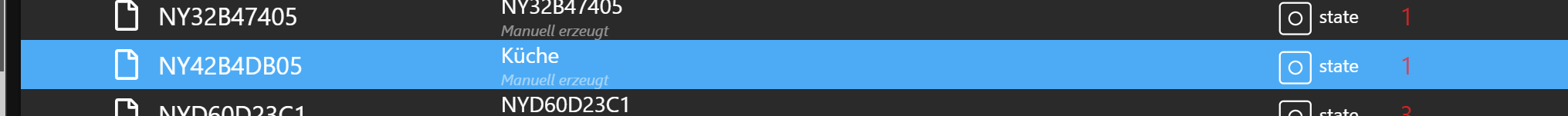

                      oelison @Nicoloma last edited by oelison
                      @nicoloma Alles klar. Deine Nummern lauten dann NYD70D8CE1, NYD70D6701, NYD60D23C1, NYD70D37B1 und NYD70D95A1. (die 44 weglassen, da das der Status ist und NY ist der Typ). Wenn das die 5 sind die Du hast, kannst Du die jetzt in action eintragen. (expert mode!!!)
                      Etwa so:
                      Dann sieht das so aus:
                      Value dann 1 oder 2 oder 3 reinschreiben (rauf, runter, stop)

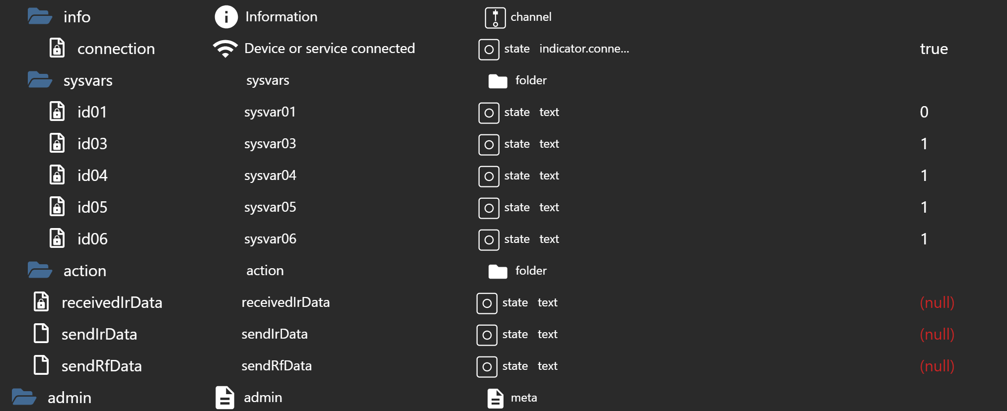

                        • Nicoloma
                          Nicoloma @Nicoloma last edited by
                          @oelison
                          mediola-gateway.0
                          2024-01-21 22:16:58.126	debug	state mediola-gateway.0.sysvars.id04 changed: 1 (ack = true)
                          mediola-gateway.0
                          2024-01-21 22:16:58.126	silly	States user redis pmessage mediola-gateway.0.sysvars.id*/mediola-gateway.0.sysvars.id04:{"val":"1","ack":true,"ts":1705871818125,"q":0,"from":"system.adapter.mediola-gateway.0","user":"system.user.admin","lc":1705615620733}
                          mediola-gateway.0
                          2024-01-21 22:16:58.042	debug	state mediola-gateway.0.sysvars.id06 changed: 1 (ack = true)
                          mediola-gateway.0
                          2024-01-21 22:16:58.042	silly	States user redis pmessage mediola-gateway.0.sysvars.id*/mediola-gateway.0.sysvars.id06:{"val":"1","ack":true,"ts":1705871818040,"q":0,"from":"system.adapter.mediola-gateway.0","user":"system.user.admin","lc":1705615620733}
                          mediola-gateway.0
                          2024-01-21 22:16:58.041	debug	state mediola-gateway.0.sysvars.id03 changed: 1 (ack = true)
                          mediola-gateway.0
                          2024-01-21 22:16:58.041	silly	States user redis pmessage mediola-gateway.0.sysvars.id*/mediola-gateway.0.sysvars.id03:{"val":"1","ack":true,"ts":1705871818038,"q":0,"from":"system.adapter.mediola-gateway.0","user":"system.user.admin","lc":1705615620733}
                          mediola-gateway.0
                          2024-01-21 22:16:58.041	debug	state mediola-gateway.0.sysvars.id05 changed: 1 (ack = true)
                          mediola-gateway.0
                          2024-01-21 22:16:58.040	silly	States user redis pmessage mediola-gateway.0.sysvars.id*/mediola-gateway.0.sysvars.id05:{"val":"1","ack":true,"ts":1705871818038,"q":0,"from":"system.adapter.mediola-gateway.0","user":"system.user.admin","lc":1705615620691}
                          mediola-gateway.0
                          2024-01-21 22:16:58.040	debug	state mediola-gateway.0.sysvars.id01 changed: 0 (ack = true)
                          mediola-gateway.0
                          2024-01-21 22:16:58.039	silly	States user redis pmessage mediola-gateway.0.sysvars.id*/mediola-gateway.0.sysvars.id01:{"val":"0","ack":true,"ts":1705871818038,"q":0,"from":"system.adapter.mediola-gateway.0","user":"system.user.admin","lc":1705615620691}
                          mediola-gateway.0
                          2024-01-21 22:16:58.036	debug	{"type":"EVENT","adr":"04","state":"1"}
                          mediola-gateway.0
                          2024-01-21 22:16:58.036	debug	{"type":"EVENT","adr":"06","state":"1"}
                          mediola-gateway.0
                          2024-01-21 22:16:58.036	debug	{"type":"EVENT","adr":"03","state":"1"}
                          mediola-gateway.0
                          2024-01-21 22:16:58.035	debug	{"type":"EVENT","adr":"05","state":"1"}
                          mediola-gateway.0
                          2024-01-21 22:16:58.035	debug	{"type":"EVENT","adr":"01","state":"0"}
                          mediola-gateway.0
                          2024-01-21 22:16:58.034	debug	mediola device found data: [{"type":"EVENT","adr":"01","state":"0"},{"type":"EVENT","adr":"05","state":"1"},{"type":"EVENT","adr":"03","state":"1"},{"type":"EVENT","adr":"06","state":"1"},{"type":"EVENT","adr":"04","state":"1"}]
                          mediola-gateway.0
                          2024-01-21 22:16:58.034	debug	"{XC_SUC}[{\"type\":\"EVENT\",\"adr\":\"01\",\"state\":\"0\"},{\"type\":\"EVENT\",\"adr\":\"05\",\"state\":\"1\"},{\"type\":\"EVENT\",\"adr\":\"03\",\"state\":\"1\"},{\"type\":\"EVENT\",\"adr\":\"06\",\"state\":\"1\"},{\"type\":\"EVENT\",\"adr\":\"04\",\"state\":\"1\"}]"
                          mediola-gateway.0
                          2024-01-21 22:16:57.895	debug	Source: onReady
                          mediola-gateway.0
                          2024-01-21 22:16:57.887	debug	http://192.168.178.144/command?XC_USER=admin&XC_PASS=sagichnicht&XC_FNC=getstates
                          mediola-gateway.0
                          2024-01-21 22:16:57.887	debug	validMediola: true sysvarInti: false timerRead: false cmd false pull false
                          mediola-gateway.0
                          2024-01-21 22:16:57.887	info	Mediola connected with ip:192.168.178.144 and mac:40-66-7a-00-6e-3f
                          mediola-gateway.0
                          2024-01-21 22:16:57.887	debug	code_text
