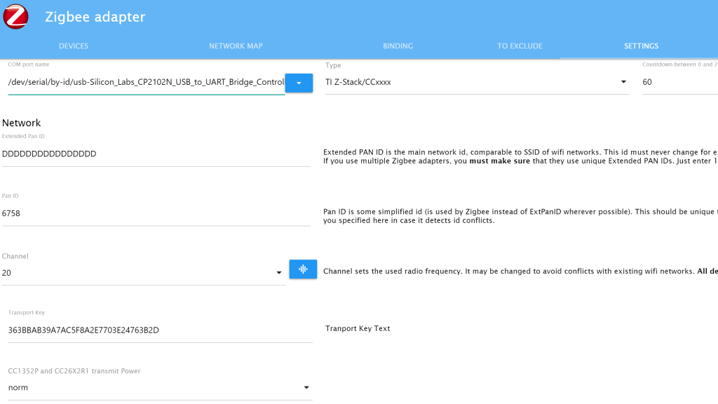

    Hi zusammen,
    drehe mich seit Stunden im Kreis... Das Setup lief schon, aber seit Update(?) plötzlich nicht mehr hinzubekommen:
    Raspi 4 + ioBroker + Sonoff Zigbee USB Stick mit CC2652P
    Adapter kann nicht initialisiert werden, da Verbindung zum Zigbee-USB-Stick nicht klappt.
    ioBroker-Log zu zigbee-Adapter:
    2022-10-03 19:14:14.588 - info: zigbee.0 (2318) starting. Version 1.7.5 in /opt/iobroker/node_modules/iobroker.zigbee, node: v16.17.1, js-controller: 4.0.23
    2022-10-03 19:14:14.659 - debug: zigbee.0 (2318) Using zigbee-herdsman with settings: {"network":{"panID":6758,"channelList":[20],"networkKey":[54,59,186,179,154,122,197,248,162,231,112,62,36,118,59,45],"extenedPanID":[221,221,221,221,221,221,221,221]},"databasePath":"/opt/iobroker/iobroker-data/zigbee_0/shepherd.db","backupPath":"/opt/iobroker/iobroker-data/zigbee_0/nvbackup.json","serialPort":{"baudRate":115200,"rtscts":false,"path":"/dev/serial/by-id/usb-Silicon_Labs_CP2102N_USB_to_UART_Bridge_Controller_de39dcaba293eb11990d194f3d98b6d1-if00-port0","adapter":"zstack"},"adapter":{"forceStartWithInconsistentAdapterConfiguration":false}}
    2022-10-03 19:14:14.728 - info: zigbee.0 (2318) delete old Backup files. keep only last 10
    2022-10-03 19:14:14.730 - info: zigbee.0 (2318) Starting Zigbee npm ...
    2022-10-03 19:14:14.732 - debug: zigbee.0 (2318) Starting zigbee-herdsman...
    2022-10-03 19:14:15.158 - debug: zigbee.0 (2318) Backup /opt/iobroker/iobroker-data/zigbee_0/backup_2022_10_03-19_14_14.tar.gz success
    2022-10-03 19:14:15.244 - debug: zigbee.0 (2318) zigbee-herdsman:controller:log Starting with options '{"network":{"networkKeyDistribute":false,"networkKey":[54,59,186,179,154,122,197,248,162,231,112,62,36,118,59,45],"panID":6758,"extendedPanID":[221,221,221,221,221,221,221,221],"channelList":[20],"extenedPanID":[221,221,221,221,221,221,221,221]},"serialPort":{"baudRate":115200,"rtscts":false,"path":"/dev/serial/by-id/usb-Silicon_Labs_CP2102N_USB_to_UART_Bridge_Controller_de39dcaba293eb11990d194f3d98b6d1-if00-port0","adapter":"zstack"},"databasePath":"/opt/iobroker/iobroker-data/zigbee_0/shepherd.db","databaseBackupPath":null,"backupPath":"/opt/iobroker/iobroker-data/zigbee_0/nvbackup.json","adapter":{"disableLED":false,"forceStartWithInconsistentAdapterConfiguration":false},"acceptJoiningDeviceHandler":null}'
    2022-10-03 19:14:15.246 - debug: zigbee.0 (2318) zigbee-herdsman:adapter:zStack:znp:log Opening SerialPort with /dev/serial/by-id/usb-Silicon_Labs_CP2102N_USB_to_UART_Bridge_Controller_de39dcaba293eb11990d194f3d98b6d1-if00-port0 and {"baudRate":115200,"rtscts":false,"autoOpen":false}
    2022-10-03 19:14:15.278 - info: zigbee.0 (2318) Installed Version: iobroker.zigbee@1.7.5
    2022-10-03 19:14:15.280 - debug: zigbee.0 (2318) zigbee-herdsman:adapter:zStack:znp:log Serialport opened
    2022-10-03 19:14:15.283 - debug: zigbee.0 (2318) zigbee-herdsman:adapter:zStack:znp:SREQ --> SYS - ping - {"capabilities":1}
    2022-10-03 19:14:15.286 - debug: zigbee.0 (2318) zigbee-herdsman:adapter:zStack:unpi:writer --> frame [254,0,33,1,32]
    2022-10-03 19:14:15.539 - debug: zigbee.0 (2318) zigbee-herdsman:adapter:zStack:znp:log Writing CC2530/CC2531 skip bootloader payload
    2022-10-03 19:14:15.540 - debug: zigbee.0 (2318) zigbee-herdsman:adapter:zStack:unpi:writer --> buffer [239]
    2022-10-03 19:14:16.543 - debug: zigbee.0 (2318) zigbee-herdsman:adapter:zStack:znp:SREQ --> SYS - ping - {"capabilities":1}
    2022-10-03 19:14:16.544 - debug: zigbee.0 (2318) zigbee-herdsman:adapter:zStack:unpi:writer --> frame [254,0,33,1,32]
    2022-10-03 19:14:16.796 - debug: zigbee.0 (2318) zigbee-herdsman:adapter:zStack:znp:log Skip bootloader for CC2652/CC1352
    2022-10-03 19:14:17.420 - debug: zigbee.0 (2318) zigbee-herdsman:adapter:zStack:znp:SREQ --> SYS - ping - {"capabilities":1}
    2022-10-03 19:14:17.421 - debug: zigbee.0 (2318) zigbee-herdsman:adapter:zStack:unpi:writer --> frame [254,0,33,1,32]
    2022-10-03 19:14:23.423 - debug: zigbee.0 (2318) zigbee-herdsman:adapter:zStack:znp:SREQ --> SYS - ping - {"capabilities":1}
    2022-10-03 19:14:23.425 - debug: zigbee.0 (2318) zigbee-herdsman:adapter:zStack:unpi:writer --> frame [254,0,33,1,32]
    2022-10-03 19:14:29.428 - debug: zigbee.0 (2318) zigbee-herdsman:adapter:zStack:znp:SREQ --> SYS - ping - {"capabilities":1}
    2022-10-03 19:14:29.429 - debug: zigbee.0 (2318) zigbee-herdsman:adapter:zStack:unpi:writer --> frame [254,0,33,1,32]
    2022-10-03 19:14:35.609 - error: zigbee.0 (2318) Starting zigbee-herdsman problem : "Failed to connect to the adapter (Error: SRSP - SYS - ping after 6000ms)"
    2022-10-03 19:14:35.610 - error: zigbee.0 (2318) Failed to start Zigbee
    2022-10-03 19:14:35.611 - error: zigbee.0 (2318) Error herdsman start
    2022-10-03 19:14:45.615 - info: zigbee.0 (2318) Try to reconnect. 1 attempts left
    2022-10-03 19:14:45.616 - info: zigbee.0 (2318) Starting Zigbee npm ...
    2022-10-03 19:14:45.617 - debug: zigbee.0 (2318) Starting zigbee-herdsman...
    2022-10-03 19:14:45.641 - info: zigbee.0 (2318) Installed Version: iobroker.zigbee@1.7.5
    2022-10-03 19:14:45.839 - debug: zigbee.0 (2318) zigbee-herdsman:controller:log Starting with options '{"network":{"networkKeyDistribute":false,"networkKey":[54,59,186,179,154,122,197,248,162,231,112,62,36,118,59,45],"panID":6758,"extendedPanID":[221,221,221,221,221,221,221,221],"channelList":[20],"extenedPanID":[221,221,221,221,221,221,221,221]},"serialPort":{"baudRate":115200,"rtscts":false,"path":"/dev/serial/by-id/usb-Silicon_Labs_CP2102N_USB_to_UART_Bridge_Controller_de39dcaba293eb11990d194f3d98b6d1-if00-port0","adapter":"zstack"},"databasePath":"/opt/iobroker/iobroker-data/zigbee_0/shepherd.db","databaseBackupPath":null,"backupPath":"/opt/iobroker/iobroker-data/zigbee_0/nvbackup.json","adapter":{"disableLED":false,"forceStartWithInconsistentAdapterConfiguration":false},"acceptJoiningDeviceHandler":null}'
    2022-10-03 19:14:45.840 - debug: zigbee.0 (2318) zigbee-herdsman:adapter:zStack:znp:log Opening SerialPort with /dev/serial/by-id/usb-Silicon_Labs_CP2102N_USB_to_UART_Bridge_Controller_de39dcaba293eb11990d194f3d98b6d1-if00-port0 and {"baudRate":115200,"rtscts":false,"autoOpen":false}
    2022-10-03 19:14:45.896 - error: zigbee.0 (2318) Starting zigbee-herdsman problem : "Error while opening serialport 'Error: Error Resource temporarily unavailable Cannot lock port'"
    2022-10-03 19:14:45.897 - error: zigbee.0 (2318) Failed to start Zigbee
    2022-10-03 19:14:45.898 - error: zigbee.0 (2318) Error herdsman start
    Node/NPM-Installation:
    pi@rp4:~ $ type -P nodejs node npm && nodejs -v && node -v && npm -v
    /usr/bin/nodejs
    /usr/bin/node
    /usr/bin/npm
    v16.17.1
    v16.17.1
    8.15.0
    Serial port:
    pi@rp4:~ $ ls -l /dev/serial/by-id
    total 0
    lrwxrwxrwx 1 root root 13 Oct  3 19:10 usb-Silicon_Labs_CP2102N_USB_to_UART_Bridge_Controller_de39dcaba293eb11990d194f3d98b6d1-if00-port0 -> ../../ttyUSB0
    Zigbee-Adapter:
    • Habe auch andere Extended PAN ID probiert.
    • Adapter inkl. Settings und Backup gelöscht, neu installiert. Version 1.7.5 als auch downgrade zu 1.6.18, "iobroker fix" etc...
    Zigbee-Stick:
    • Sonoff Zigbee 3.0 USB Dongle Plus ZBDongle-P CC2652P
    • an USB-2.0-Port (mit und ohne Verlängerung), SSD an anderem USB 2.0 Port
    • Z-Stack Firmware CC1352P2_CC2652P_launchpad_coordinator_20220219 neu geflashed incl Erase und Validate über TI-Flasher -> geht einwandfrei
    Aber trotzdem, ich bekomme den zigbee-Adapter nicht mehr zum Laufen.
    Mir gehen die Ideen aus. Hat noch jemand welche?
    Besten Dank!
