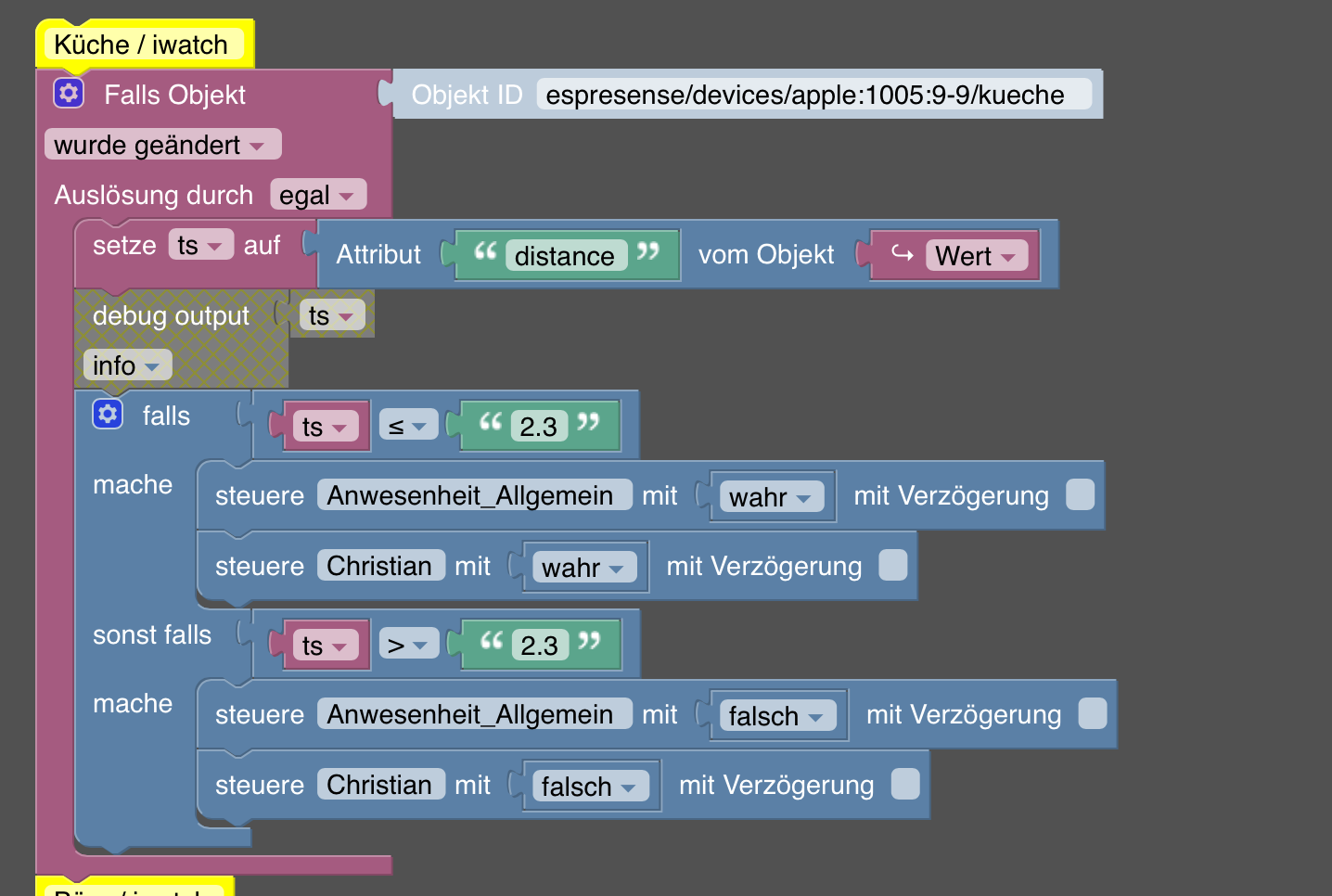

            A Former User
            wrote on last edited by A Former User
            @panik auf welchen Datenpunkt triggerst du denn?
            panikP 1 Reply Last reply
            • ? A Former User
              panikP Offline
              panikP Offline
              panik
              @ciddi89 Ich hatte zu beginn mit dem Wert versucht zu triggern aber da passierte nichts, jetzt triggert die Datenpunkt-ID.
              Habe das Jetzt mal mit deiner lösung umgesetzt, auch das klappt nun wunderbar :blush:

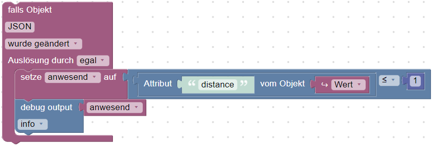

                @panik
                Etwas einfacher:
                M 1 Reply Last reply

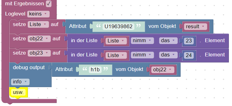

                  {"U19639862":[{"yr":2022,"mon":11,"dom":17,"imp":1346040,"exp":60,"dow":"Thu"},{"yr":2022,"mon":11,"dom":17,"hr":1,"imp":4306560,"exp":180,"dow":"Thu"},{"yr":2022,"mon":11,"dom":17,"hr":2,"imp":2824320,"exp":300,"dow":"Thu"},{"yr":2022,"mon":11,"dom":17,"hr":3,"imp":2531580,"dow":"Thu"},{"yr":2022,"mon":11,"dom":17,"hr":4,"imp":2265540,"dow":"Thu"},{"yr":2022,"mon":11,"dom":17,"hr":5,"imp":5135640,"dow":"Thu"},{"yr":2022,"mon":11,"dom":17,"hr":6,"imp":6107100,"gep":11640,"dow":"Thu"},{"yr":2022,"mon":11,"dom":17,"hr":7,"imp":1843860,"exp":1700280,"gep":3014640,"dow":"Thu"},{"yr":2022,"mon":11,"dom":17,"hr":8,"imp":4287180,"exp":385369,"gep":1468327,"dow":"Thu"},{"yr":2022,"mon":11,"dom":17,"hr":9,"imp":1484160,"exp":290160,"gep":2062320,"dow":"Thu"},{"yr":2022,"mon":11,"dom":17,"hr":10,"imp":223440,"exp":2646660,"gep":4492560,"dow":"Thu"},{"yr":2022,"mon":11,"dom":17,"hr":11,"imp":478620,"exp":7434720,"gep":11400120,"dow":"Thu"},{"yr":2022,"mon":11,"dom":17,"hr":12,"imp":969780,"exp":4711920,"gep":8420280,"dow":"Thu"},{"yr":2022,"mon":11,"dom":17,"hr":13,"imp":4778700,"exp":403560,"gep":7861260,"gen":1680,"dow":"Thu"},{"yr":2022,"mon":11,"dom":17,"hr":14,"imp":854040,"exp":367080,"gep":2401500,"dow":"Thu"},{"yr":2022,"mon":11,"dom":17,"hr":15,"imp":5258700,"exp":60,"gep":138600,"gen":600,"dow":"Thu"},{"yr":2022,"mon":11,"dom":17,"hr":16,"imp":2661059,"dow":"Thu"},{"yr":2022,"mon":11,"dom":17,"hr":17,"imp":7027140,"dow":"Thu"},{"yr":2022,"mon":11,"dom":17,"hr":18,"imp":3920580,"dow":"Thu"},{"yr":2022,"mon":11,"dom":17,"hr":19,"imp":6025500,"dow":"Thu"},{"yr":2022,"mon":11,"dom":17,"hr":20,"imp":2147220,"dow":"Thu"},{"yr":2022,"mon":11,"dom":17,"hr":21,"imp":7385220,"dow":"Thu"},{"yr":2022,"mon":11,"dom":17,"hr":22,"imp":12272700,"h1b":4451100,"h2b":4522740,"h3b":5760,"dow":"Thu"},{"yr":2022,"mon":11,"dom":17,"hr":23,"imp":31262640,"h1b":12451800,"h2b":12618180,"h3b":14460,"dow":"Thu"}]}
                  Hier möchte ich nun alle h1b, h2b und h3b Werte aufaddieren und durch 3600000 teilen (hier nur in den Stunden 22 und 23 vorhanden). Aber ich schaffe es nicht die Felder anzusprechen. Hat mir jemand einen Tipp?
                  paul53P 1 Reply Last reply
                  • M MP_Trixi
                    Hallo, ich hoffe es ist ok mich hier dranzuhängen :relaxed:
                    Ich hole mir im einem Blockly mit exec per curl ein JSON (denke mal das ist eins). Das funktioniert auch:
                    Das ist der vollständige curl den ich verwende:
                    curl --digest -u [USER]:[PASSWORD] -H 'accept: application/json' -H 'content-type: application/json' --compressed '[URL]'
                    Zurück bekomme ich folgendes:
                    @mp_trixi sagte: Zurück bekomme ich folgendes:
                      MP_Trixi
                      wrote on last edited by MP_Trixi
                      @paul53 Hammer - Danke! Und wie fix.

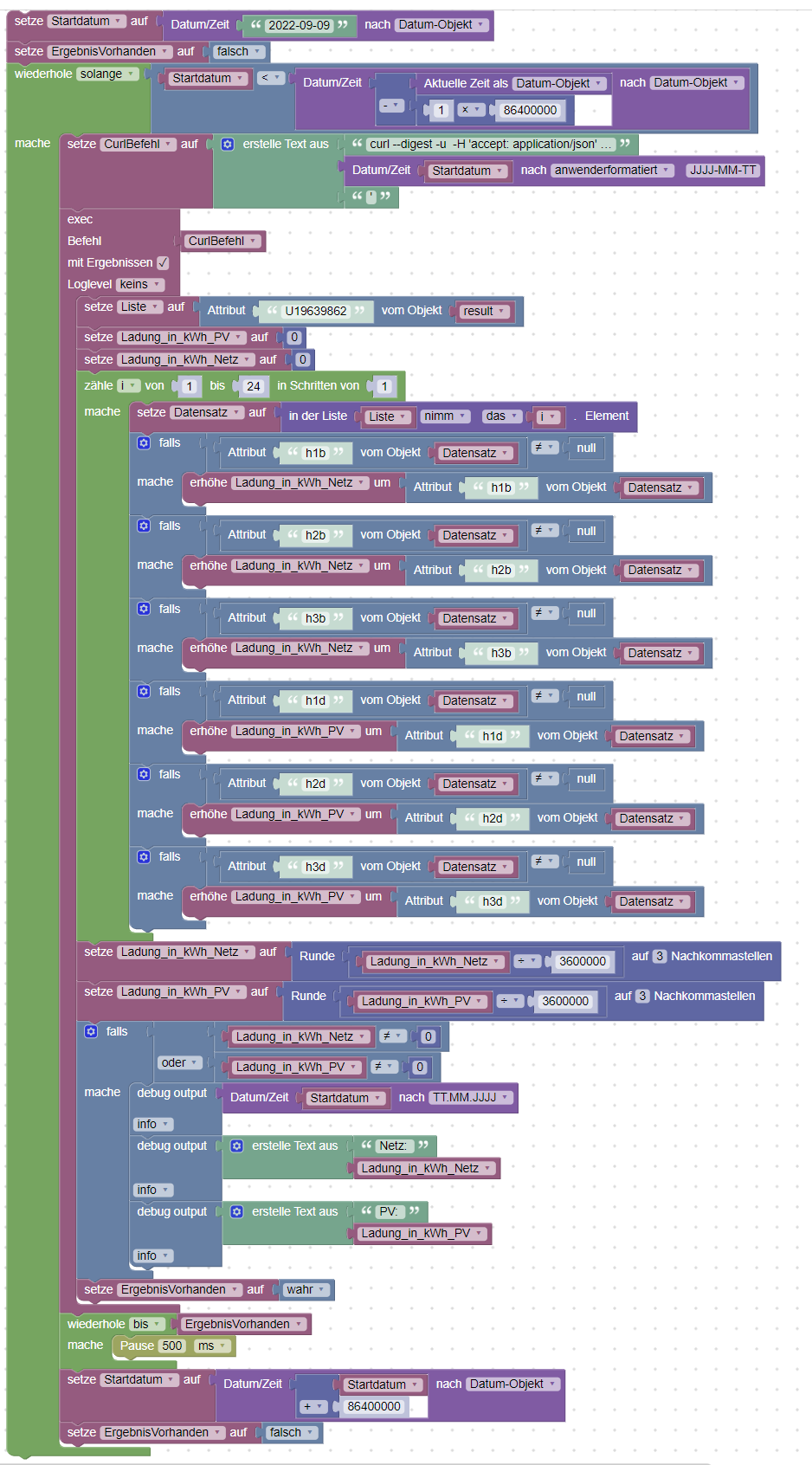

                      Habs jetzt so:
                      Das will ich täglich in einen Datenpunkt mit history schreiben. Dazu noch zwei Fragen:
                      • ich habe damit die Möglichkeit Werte der Vergangenheit zu ermitteln. Bekomme ich die auch in den Datenpunkt zu dem entsprechenden Datum?
                      • die Daten werden rückwirkend für den Tag zuvor ermittelt. Wie bekomme ich es hin, dass der Wert dann in den Datenpunk mit Datum-1 Tag geschrieben wird (ähnlich wie erste Frage)?
                      1 Reply Last reply
