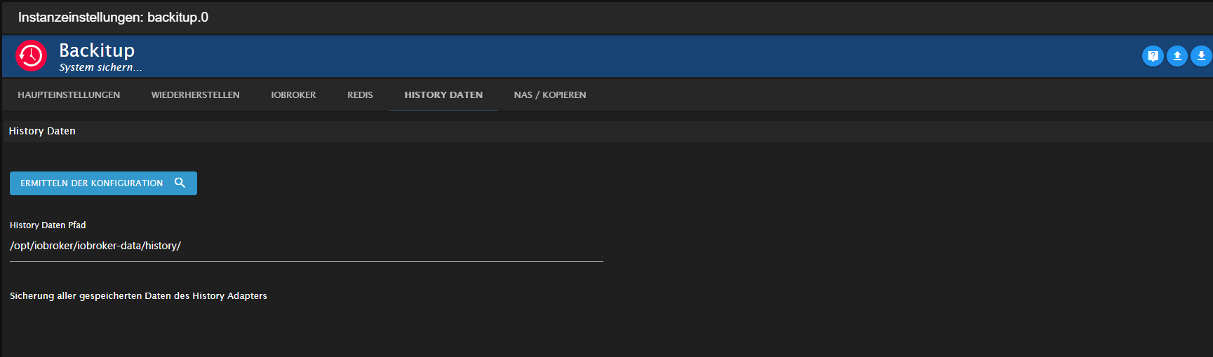

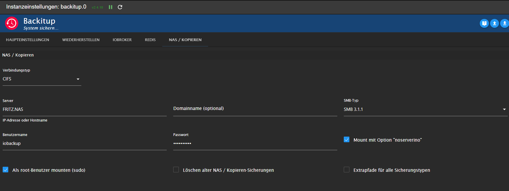

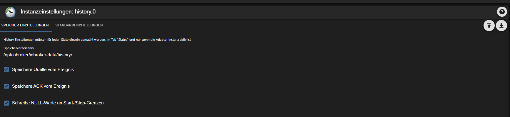

      Jedes Backup erzeugt einen Fehler:
      backitup.0 [iobroker] history json could not be created: TypeError: Cannot read property 'setState' of null
      backitup.0 [iobroker] history json could not be created: TypeError: Cannot read property 'unshift' of undefined
      Jemand eine Idee woran das liegen könnte?
      Es tauchen sonst keine weiteren Fehlermeldungen auf.
      Habe zwischendurch versucht:
      iob fix
      Node v16
      npm v8
      history, backitup adapter und js-controller neu installiert (ohne Fehlermeldungen)
      => alles ohne Veränderung

            @richie
            FritzNAS muss mit den Optionen 'Noserverino' und SMB V 3.1.1 angesprochen werden.
            R 1 Antwort Letzte Antwort

              Adapter    "history"      : 2.2.0    , installed 2.2.0

              Debug Log des Backups:
              Started iobroker ...
              [DEBUG] [mount] start with {"mountType":"CIFS","type":"storage","source":"cifs","mount":"//FRITZ.NAS","debugging":true,"fileDir":"/opt/iobroker/iobroker-data/backitup","wakeOnLAN":false,"macAd":"20:DE:20:DE:20:DE","wolTime":"25","smb":"vers=1.0","sudo":true,"cifsDomain":"","clientInodes":false,"deleteOldBackup":false,"ownDir":false,"dir":"fritz.nas/Volume/ioBrokerAutoBackup","dirMinimal":"sharename/backupDir","user":"iobackup","pass":"****","ignoreErrors":false}
              [DEBUG] [mount] - noserverino option: false
              [DEBUG] [mount] - cifs-mount command: "sudo mount -t cifs -o username=iobackup,password=****,rw,file_mode=0777,dir_mode=0777,vers=1.0 //FRITZ.NAS/fritz.nas/Volume/ioBrokerAutoBackup /opt/iobroker/backups"
              [DEBUG] [mount] - mount successfully completed
              [DEBUG] [mount] - done
              [DEBUG] [iobroker] start with {"type":"creator","time":"02:43","debugging":true,"slaveBackup":"Single","everyXDays":"1","deleteBackupAfter":0,"cifs":{"enabled":true,"mountType":"CIFS","type":"storage","source":"cifs","mount":"//FRITZ.NAS","debugging":true,"fileDir":"/opt/iobroker/iobroker-data/backitup","wakeOnLAN":false,"macAd":"20:DE:20:DE:20:DE","wolTime":"25","smb":"vers=1.0","sudo":true,"cifsDomain":"","clientInodes":false,"deleteOldBackup":false,"ownDir":false,"dir":"/fritz.nas/Volume/ioBrokerAutoBackup","dirMinimal":"sharename/backupDir","user":"iobackup","pass":"****","ignoreErrors":false,"context":{"fileNames":[],"errors":{},"done":["mount"],"types":[]},"adapter":null,"influxDBEvents":[],"mySqlEvents":[],"pgSqlEvents":[]},"ignoreErrors":false,"dir":"/opt/iobroker","redis":{"enabled":true,"type":"creator","ftp":{"enabled":false,"type":"storage","source":"cifs","host":"","debugging":true,"deleteOldBackup":false,"ownDir":false,"dir":"/backupDir","dirMinimal":"/backupDir/iobroker","user":"","pass":"****","port":"21","ignoreErrors":false},"cifs":{"enabled":true,"mountType":"CIFS","type":"storage","source":"cifs","mount":"FRITZ.NAS","debugging":true,"fileDir":"/opt/iobroker/iobroker-data/backitup","wakeOnLAN":false,"macAd":"20:DE:20:DE:20:DE","wolTime":"25","smb":"vers=1.0","sudo":true,"cifsDomain":"","clientInodes":false,"deleteOldBackup":false,"ownDir":false,"dir":"fritz.nas/Volume/ioBrokerAutoBackup","dirMinimal":"sharename/backupDir","user":"iobackup","pass":"****","ignoreErrors":false},"dropbox":{"enabled":false,"type":"storage","source":"cifs","debugging":true,"deleteOldBackup":false,"accessToken":"****","dropboxAccessJson":"","dropboxTokenType":"custom","ownDir":false,"dir":"/backupDir","dirMinimal":"/backupDir/iobroker","ignoreErrors":false},"webdav":{"enabled":false,"type":"storage","source":"cifs","debugging":true,"deleteOldBackup":false,"username":"username","pass":"****","url":"https://example.com/remote.php/dav/files/username/","ownDir":false,"dir":"/backupDir","dirMinimal":"/backupDir/iobroker","signedCertificates":true,"ignoreErrors":false},"googledrive":{"enabled":false,"type":"storage","source":"cifs","debugging":true,"deleteOldBackup":false,"accessJson":"****","ownDir":false,"dir":"/backupDir","dirMinimal":"/backupDir/iobroker","ignoreErrors":false},"aof":false,"nameSuffix":"","slaveSuffix":"","hostType":"Single","path":"/var/lib/redis/dump.rdb","redisType":"local","host":"","port":"6379","user":"","pass":"","ignoreErrors":false},"zigbee":{"enabled":true,"type":"creator","ftp":{"enabled":false,"type":"storage","source":"cifs","host":"","debugging":true,"deleteOldBackup":false,"ownDir":false,"dir":"/backupDir","dirMinimal":"/backupDir/iobroker","user":"","pass":"****","port":"21","ignoreErrors":false},"cifs":{"enabled":true,"mountType":"CIFS","type":"storage","source":"cifs","mount":"FRITZ.NAS","debugging":true,"fileDir":"/opt/iobroker/iobroker-data/backitup","wakeOnLAN":false,"macAd":"20:DE:20:DE:20:DE","wolTime":"25","smb":"vers=1.0","sudo":true,"cifsDomain":"","clientInodes":false,"deleteOldBackup":false,"ownDir":false,"dir":"fritz.nas/Volume/ioBrokerAutoBackup","dirMinimal":"sharename/backupDir","user":"iobackup","pass":"****","ignoreErrors":false},"dropbox":{"enabled":false,"type":"storage","source":"cifs","debugging":true,"deleteOldBackup":false,"accessToken":"****","dropboxAccessJson":"","dropboxTokenType":"custom","ownDir":false,"dir":"/backupDir","dirMinimal":"/backupDir/iobroker","ignoreErrors":false},"webdav":{"enabled":false,"type":"storage","source":"cifs","debugging":true,"deleteOldBackup":false,"username":"username","pass":"****","url":"https://example.com/remote.php/dav/files/username/","ownDir":false,"dir":"/backupDir","dirMinimal":"/backupDir/iobroker","signedCertificates":true,"ignoreErrors":false},"googledrive":{"enabled":false,"type":"storage","source":"cifs","debugging":true,"deleteOldBackup":false,"accessJson":"****","ownDir":false,"dir":"/backupDir","dirMinimal":"/backupDir/iobroker","ignoreErrors":false},"path":"/opt/iobroker/iobroker-data","nameSuffix":"","slaveSuffix":"","hostType":"Single","ignoreErrors":false},"javascripts":{"enabled":true,"type":"creator","ftp":{"enabled":false,"type":"storage","source":"cifs","host":"","debugging":true,"deleteOldBackup":false,"ownDir":false,"dir":"/backupDir","dirMinimal":"/backupDir/iobroker","user":"","pass":"****","port":"21","ignoreErrors":false},"cifs":{"enabled":true,"mountType":"CIFS","type":"storage","source":"cifs","mount":"FRITZ.NAS","debugging":true,"fileDir":"/opt/iobroker/iobroker-data/backitup","wakeOnLAN":false,"macAd":"20:DE:20:DE:20:DE","wolTime":"25","smb":"vers=1.0","sudo":true,"cifsDomain":"","clientInodes":false,"deleteOldBackup":false,"ownDir":false,"dir":"fritz.nas/Volume/ioBrokerAutoBackup","dirMinimal":"sharename/backupDir","user":"iobackup","pass":"****","ignoreErrors":false},"dropbox":{"enabled":false,"type":"storage","source":"cifs","debugging":true,"deleteOldBackup":false,"accessToken":"****","dropboxAccessJson":"","dropboxTokenType":"custom","ownDir":false,"dir":"/backupDir","dirMinimal":"/backupDir/iobroker","ignoreErrors":false},"webdav":{"enabled":false,"type":"storage","source":"cifs","debugging":true,"deleteOldBackup":false,"username":"username","pass":"****","url":"https://example.com/remote.php/dav/files/username/","ownDir":false,"dir":"/backupDir","dirMinimal":"/backupDir/iobroker","signedCertificates":true,"ignoreErrors":false},"googledrive":{"enabled":false,"type":"storage","source":"cifs","debugging":true,"deleteOldBackup":false,"accessJson":"****","ownDir":false,"dir":"/backupDir","dirMinimal":"/backupDir/iobroker","ignoreErrors":false},"slaveSuffix":"","hostType":"Single","nameSuffix":"","ignoreErrors":false},"historyHTML":{"enabled":true,"type":"message","entriesNumber":"50","ignoreErrors":false,"systemLang":"de"},"historyJSON":{"enabled":true,"type":"message","entriesNumber":"50","ignoreErrors":false,"systemLang":"de"},"signal":{"enabled":false,"notificationsType":"Telegram","type":"message","instance":"","NoticeType":"longSignalNotice","onlyError":false,"signalWaiting":0,"hostName":"","ignoreErrors":false,"systemLang":"de"},"backupDir":"/opt/iobroker/backups"}
              [DEBUG] [iobroker] - host.raspberrypi 16629 states saved
              [DEBUG] [iobroker] - host.raspberrypi 16650 objects saved
              [DEBUG] [iobroker] - Backup created: /opt/iobroker/backups/iobroker_2022_08_15-12_16_45_backupiobroker.tar.gz
              [DEBUG] [iobroker] - done
              [DEBUG] [redis] - Start Redis Backup ...
              [DEBUG] [redis] - Created redistmp directory
              [DEBUG] [redis] - detected redis file: dump.rdb | file type: rdb
              [DEBUG] [redis] - Packed 4MB so far...
              [DEBUG] [redis] - Packed 37MB so far...
              [DEBUG] [redis] - Packed 71MB so far...
              [DEBUG] [redis] - Packed 102MB so far...
              [DEBUG] [redis] - Packed 138MB so far...
              [DEBUG] [redis] - Packed 163MB so far...

                @richie
                R Offline
                R Offline
                Richie
                schrieb am zuletzt editiert von Richie
                @thomas-braun
                'Noserverino' und SMB V 3.1.1 hat leider auch nichts gebracht.
                Mir fällt jetzt nur noch ein die geänderten Einstellungen im backuitup mal unter node 16 und npm 8 zu testen...

                          R Offline
                          R Offline
                          Richie
                          @glasfaser
                          Scheint alles korrekt zu sein:
                          • R Richie
                            @glasfaser
                            GlasfaserG Offline
                            GlasfaserG Offline
                            Glasfaser
                            @richie sagte in [iobroker] history json could not be created:
                            Eben nicht , beides mal der gleiche Pfad.

                                • R Richie
                                  @glasfaser
                                  Den Pfad hatte ich im backitup automatisch ermittelt "Ermitteln der Konfiguration".
                                  Aber auch wenn ich eine Änderung vornehme, (glaube laut Forum sollte es in dem Fall so angegeben werden:)
                                  backitup: /opt/iobroker/iobroker-data/history/
                                  history adapter: /opt/iobroker/iobroker-data/iobroker-data/
                                  => gleicher Fehler
                                  auch getestet:
                                  => gleicher Fehler
                                  Backup ohne History: seeehr merkwürdig... bringt den gleichen Fehler !?
                                  Ich bin total verwirrt...

                                    Nach sudo reboot ist die Option im backitup weiterhin deaktiviert, wird aber trotzdem wird die History mit gesichert und selbe Ausgabe im Log.
                                    Habe den Adapter mal komplett deinstalliert, sudo reboot und dann den backitup im stable neu installiert.
