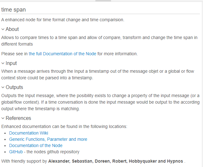

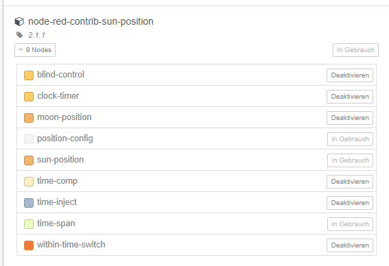

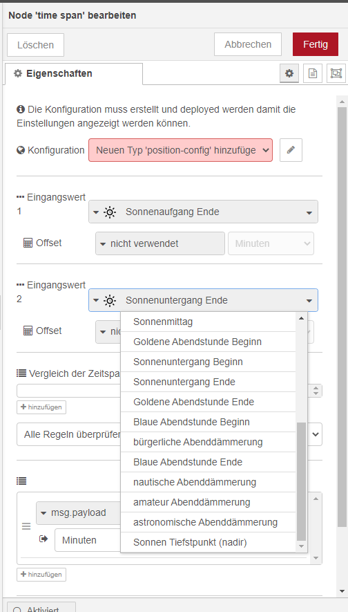

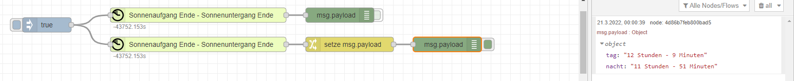

      @hpgo Wenn Du schon diese Nodes installiert hast, warum nutzt die dann nicht ?
      Diese Node ist doch super komfortabel - um solche Aufgaben - out of the box zu lösen:
      In der Hilfe zu der Node gibt es auch ein WIKI um Dir alles erklären zu lassen:

      Ich habe zumindest mit dieser Bibliothek alle diese Nodes installiert bekommen:

               "type": "time-span",
               "z": "e07ec81bf2817d9a",
               "outputs": 1,
               "name": "",
               "positionConfig": "",
               "operand1": "sunriseEnd",
               "operand1Type": "pdsTime",
               "operand1Format": "0",
               "operand1Offset": 0,
               "operand1OffsetType": "none",
               "operand1OffsetMultiplier": 60000,
               "operand2": "sunsetEnd",
               "operand2Type": "pdsTime",
               "operand2Format": "0",
               "operand2Offset": 0,
               "operand2OffsetType": "none",
               "operand2OffsetMultiplier": 60000,
               "rules": [],
               "checkall": "true",
               "results": [
                       "p": "",
                       "pt": "msgPayload",
                       "v": "",
                       "vt": "timespan",
                       "o": "",
                       "oT": "none",
                       "oM": "60000",
                       "fTs": 3,
                       "fTsS": 3,
                       "fTsT": "Stunden",
                       "fTsI": "3",
                       "f": 0,
                       "fS": 0,
                       "fT": "Millisekunden UNIX-Zeit",
                       "fI": "0",
                       "next": false,
                       "days": "*",
                       "months": "*",
                       "onlyEvenDays": false,
                       "onlyOddDays": false,
                       "onlyEvenWeeks": false,
                       "onlyOddWeeks": false

               "id": "25fb26316449d50a",
               "outputs": 1,
               "name": "",
               "rules": [],
               "checkall": "true",
               "results": [
                       "p": "",
                       "pt": "msgPayload",
                       "v": "",
                       "vt": "timespan",
                       "o": "",
                       "oT": "none",
                       "oM": "60000",
                       "fTs": 2,
                       "fTsS": 2,
                       "fTsT": "Minuten",
                       "fTsI": "2",
                       "f": 0,
                       "fS": 0,
                       "fI": "0",
                       "next": false,
                       "days": "*",
                       "months": "*",
               "x": 540,
               "y": 340,
               "wires": [
                       "bf62f0ad31fc54e9"
               "id": "bf62f0ad31fc54e9",
               "type": "change",
               "name": "",
               "rules": [
                       "t": "set",
                       "p": "payload",
                       "pt": "msg",
                       "to": "{ \"tag\": $floor((payload *-1) / 60) & \" Stunden - \" & $round((payload *-1) % 60,0) & \" Minuten\",\t\"nacht\": $floor((1440- payload *-1) / 60) & \" Stunden - \" & $round((1440- payload *-1) % 60,0) & \" Minuten\"}",
                       "tot": "jsonata"
               "action": "",
               "property": "",
               "from": "",
               "to": "",
               "reg": false,
               "x": 850,
               "y": 340,
               "wires": [
                       "4d86b7feb800bad5"

        @mickym
        Vielen herzlichen Dank, ich hatte mir nur die Blind Control Node angeschaut.
