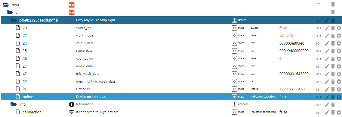

      oFbEQnpoLKKl6mbY5e13
      @kla960
      Zeig mal wenigstens einen Screenshot von den zugehörigen Datenpunkten im Tuya-Adapter.
      K 1 Antwort Letzte Antwort
      • O oFbEQnpoLKKl6mbY5e13
        @kla960
        K Offline
        K Offline
        kla960
        @ofbeqnpolkkl6mby5e13
        O 1 Antwort Letzte Antwort

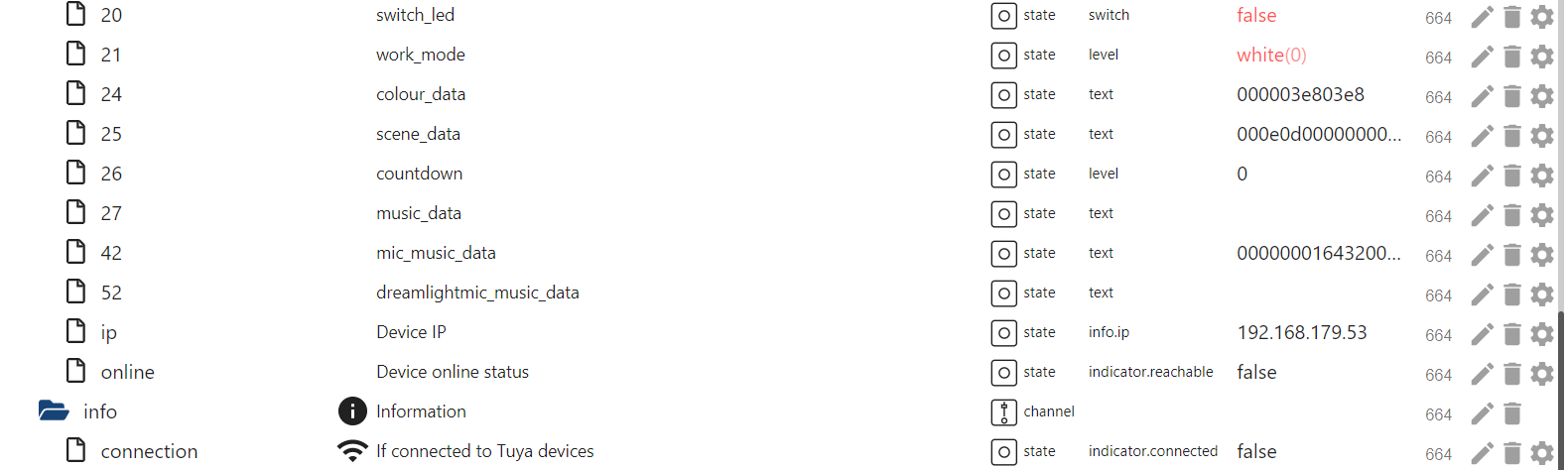

        • K kla960
          O Offline
          O Offline
          @kla960
          online = false
          Ist das ein Batteriegerät?

                        kla960

                                          2022-02-25 17:40:46.669 - debug: tuya.0 (32245) 08200118e868e759568a Register onChange for 24
                                          2022-02-25 17:40:46.670 - debug: tuya.0 (32245) 08200118e868e759568a Register onChange for 25
                                          2022-02-25 17:40:46.670 - debug: tuya.0 (32245) 08200118e868e759568a Register onChange for 26
                                          2022-02-25 17:40:46.671 - debug: tuya.0 (32245) 08200118e868e759568a Register onChange for 27
                                          2022-02-25 17:40:46.671 - debug: tuya.0 (32245) 08200118e868e759568a Register onChange for 28
                                          2022-02-25 17:40:46.672 - debug: tuya.0 (32245) 08200118e868e759568a Register onChange for 101
                                          2022-02-25 17:40:46.672 - debug: tuya.0 (32245) 08200118e868e759568a Register onChange for 102
                                          2022-02-25 17:40:46.673 - debug: tuya.0 (32245) 08200118e868e759568a Register onChange for 106
                                          2022-02-25 17:40:46.675 - debug: tuya.0 (32245) bf69b3293c1edff39ffjsi: Create device objects if not exist
                                          2022-02-25 17:40:46.676 - debug: tuya.0 (32245) bf69b3293c1edff39ffjsi: Objects [{"type":"boolean","read":true,"write":true,"name":"switch_led","id":20,"role":"switch"},{"type":"number","states":{"0":"white","1":"colour","2":"scene","3":"music"},"read":true,"write":true,"name":"work_mode","id":21,"role":"level"},{"type":"string","read":true,"write":true,"name":"colour_data","id":24,"role":"text"},{"type":"string","read":true,"write":true,"name":"scene_data","id":25,"role":"text"},{"type":"number","max":86400,"read":true,"write":true,"name":"countdown","id":26,"role":"level"},{"type":"string","read":true,"write":true,"name":"music_data","id":27,"role":"text"},{"type":"string","read":true,"write":true,"name":"mic_music_data","id":42,"role":"text"},{"type":"string","read":true,"write":true,"name":"dreamlightmic_music_data","id":52,"role":"text"}]
                                          2022-02-25 17:40:46.677 - debug: tuya.0 (32245) bf69b3293c1edff39ffjsi Register onChange for 20
                                          2022-02-25 17:40:46.678 - debug: tuya.0 (32245) bf69b3293c1edff39ffjsi Register onChange for 21
                                          2022-02-25 17:40:46.678 - debug: tuya.0 (32245) bf69b3293c1edff39ffjsi Register onChange for 24
                                          2022-02-25 17:40:46.679 - debug: tuya.0 (32245) bf69b3293c1edff39ffjsi Register onChange for 25
                                          2022-02-25 17:40:46.679 - debug: tuya.0 (32245) bf69b3293c1edff39ffjsi Register onChange for 26
                                          2022-02-25 17:40:46.680 - debug: tuya.0 (32245) bf69b3293c1edff39ffjsi Register onChange for 27
                                          2022-02-25 17:40:46.680 - debug: tuya.0 (32245) bf69b3293c1edff39ffjsi Register onChange for 42
                                          2022-02-25 17:40:46.680 - debug: tuya.0 (32245) bf69b3293c1edff39ffjsi Register onChange for 52
                                          2022-02-25 17:40:46.689 - debug: tuya.0 (32245) connected set to false
                                          2022-02-25 17:40:46.819 - info: tuya.0 (32245) bf69b3293c1edff39ffjsi Init with IP=192.168.179.53, Key=68c09a743f096846, Version=3.3
                                          2022-02-25 17:40:46.867 - info: tuya.0 (32245) 08200118e868e759568a Init with IP=192.168.179.28, Key=f9e4d104d04a30ec, Version=3.3
                                          2022-02-25 17:40:46.868 - info: tuya.0 (32245) Existing devices initialized
                                          2022-02-25 17:40:46.874 - info: tuya.0 (32245) Listen for local Tuya devices on port 6666
                                          2022-02-25 17:40:46.875 - info: tuya.0 (32245) Listen for encrypted local Tuya devices on port 6667
                                          2022-02-25 17:40:46.962 - debug: tuya.0 (32245) 08200118e868e759568a: Connected to device
                                          2022-02-25 17:40:46.980 - debug: tuya.0 (32245) stateChange tuya.0.08200118e868e759568a.online {"val":true,"ack":true,"ts":1645807246975,"q":0,"from":"system.adapter.tuya.0","user":"system.user.admin","lc":1645807246975}
                                          2022-02-25 17:40:46.981 - debug: tuya.0 (32245) stateChange tuya.0.info.connection {"val":true,"ack":true,"ts":1645807246975,"q":0,"from":"system.adapter.tuya.0","user":"system.user.admin","lc":1645807246975}
                                          2022-02-25 17:40:46.982 - debug: tuya.0 (32245) connected set to true
                                          2022-02-25 17:40:47.007 - debug: tuya.0 (32245) 08200118e868e759568a: Received data: {"20":false,"21":"colour","22":1000,"24":"00f003e803e8","25":"00000a00000003e803e800000000","26":0,"101":95,"102":60,"106":"soft"}
                                          2022-02-25 17:40:47.036 - debug: tuya.0 (32245) stateChange tuya.0.08200118e868e759568a.20 {"val":false,"ack":true,"ts":1645807247025,"q":0,"from":"system.adapter.tuya.0","user":"system.user.admin","lc":1645709492529}
                                          2022-02-25 17:40:47.037 - debug: tuya.0 (32245) stateChange tuya.0.08200118e868e759568a.21 {"val":1,"ack":true,"ts":1645807247025,"q":0,"from":"system.adapter.tuya.0","user":"system.user.admin","lc":1645709446161}
                                          2022-02-25 17:40:47.038 - debug: tuya.0 (32245) stateChange tuya.0.08200118e868e759568a.22 {"val":1000,"ack":true,"ts":1645807247026,"q":0,"from":"system.adapter.tuya.0","user":"system.user.admin","lc":1645704489672}
                                          2022-02-25 17:40:47.038 - debug: tuya.0 (32245) stateChange tuya.0.08200118e868e759568a.24 {"val":"00f003e803e8","ack":true,"ts":1645807247026,"q":0,"from":"system.adapter.tuya.0","user":"system.user.admin","lc":1645709486787}
                                          2022-02-25 17:40:47.039 - debug: tuya.0 (32245) stateChange tuya.0.08200118e868e759568a.25 {"val":"00000a00000003e803e800000000","ack":true,"ts":1645807247026,"q":0,"from":"system.adapter.tuya.0","user":"system.user.admin","lc":1645529400234}
                                          2022-02-25 17:40:47.043 - debug: tuya.0 (32245) stateChange tuya.0.08200118e868e759568a.26 {"val":0,"ack":true,"ts":1645807247028,"q":0,"from":"system.adapter.tuya.0","user":"system.user.admin","lc":1645527113063}
                                          2022-02-25 17:40:47.071 - debug: tuya.0 (32245) stateChange tuya.0.08200118e868e759568a.101 {"val":95,"ack":true,"ts":1645807247067,"q":0,"from":"system.adapter.tuya.0","user":"system.user.admin","lc":1645527113087}
                                          2022-02-25 17:40:47.072 - debug: tuya.0 (32245) stateChange tuya.0.08200118e868e759568a.102 {"val":60,"ack":true,"ts":1645807247068,"q":0,"from":"system.adapter.tuya.0","user":"system.user.admin","lc":1645703889410}
                                          2022-02-25 17:40:47.073 - debug: tuya.0 (32245) stateChange tuya.0.08200118e868e759568a.106 {"val":0,"ack":true,"ts":1645807247068,"q":0,"from":"system.adapter.tuya.0","user":"system.user.admin","lc":1645529365339}
                                          2022-02-25 17:40:51.602 - debug: tuya.0 (32245) Discovered encrypted device and store for later usage: 192.168.179.53:53813 - 000055aa00000000000000130000009c00000000d09766676f3369eb10b5e9f132fd802a58ef5662b8d5ed0ce59c56875111dfd0db47deeb95d128ee5671c7659fb0f99062752cccf8912dc171de390d8bc81f4159bd59981c26d5958da187e096d937c840b1058c6d8cd9456f3f7e28eed4932bd684776d4d3bbbcc727ed5338dc70040ebe90a09c0e74796dc81a6517ad39c8f8494c932e298de410f638ed8bf10587ab027a3c60000aa55
                                          2022-02-25 17:40:51.827 - debug: tuya.0 (32245) bf69b3293c1edff39ffjsi: Error from device (0): App still open on your mobile phone? Error: connection timed out
                                          2022-02-25 17:40:51.828 - error: tuya.0 (32245) bf69b3293c1edff39ffjsi: connection timed out
                                          2022-02-25 17:41:26.829 - debug: tuya.0 (32245) bf69b3293c1edff39ffjsi: Error from device (1): App still open on your mobile phone? Error: connection timed out
                                          2022-02-25 17:41:26.831 - warn: tuya.0 (32245) bf69b3293c1edff39ffjsi: Error on Reconnectconnection timed out
                                          2022-02-25 17:41:47.009 - debug: tuya.0 (32245) 08200118e868e759568a request data via get ...
                                          2022-02-25 17:41:47.137 - debug: tuya.0 (32245) 08200118e868e759568a: Received data: {"20":false,"21":"colour","22":1000,"24":"00f003e803e8","25":"00000a00000003e803e800000000","26":0,"101":95,"102":60,"106":"soft"}
                                          2022-02-25 17:41:47.151 - debug: tuya.0 (32245) stateChange tuya.0.08200118e868e759568a.20 {"val":false,"ack":true,"ts":1645807307142,"q":0,"from":"system.adapter.tuya.0","user":"system.user.admin","lc":1645709492529}
                                          2022-02-25 17:41:47.152 - debug: tuya.0 (32245) stateChange tuya.0.08200118e868e759568a.21 {"val":1,"ack":true,"ts":1645807307142,"q":0,"from":"system.adapter.tuya.0","user":"system.user.admin","lc":1645709446161}
                                          2022-02-25 17:41:47.153 - debug: tuya.0 (32245) stateChange tuya.0.08200118e868e759568a.22 {"val":1000,"ack":true,"ts":1645807307143,"q":0,"from":"system.adapter.tuya.0","user":"system.user.admin","lc":1645704489672}
                                          2022-02-25 17:41:47.157 - debug: tuya.0 (32245) stateChange tuya.0.08200118e868e759568a.24 {"val":"00f003e803e8","ack":true,"ts":1645807307144,"q":0,"from":"system.adapter.tuya.0","user":"system.user.admin","lc":1645709486787}
                                          2022-02-25 17:41:47.158 - debug: tuya.0 (32245) stateChange tuya.0.08200118e868e759568a.25 {"val":"00000a00000003e803e800000000","ack":true,"ts":1645807307145,"q":0,"from":"system.adapter.tuya.0","user":"system.user.admin","lc":1645529400234}
                                          2022-02-25 17:41:47.159 - debug: tuya.0 (32245) stateChange tuya.0.08200118e868e759568a.26 {"val":0,"ack":true,"ts":1645807307145,"q":0,"from":"system.adapter.tuya.0","user":"system.user.admin","lc":1645527113063}
                                          2022-02-25 17:41:47.162 - debug: tuya.0 (32245) stateChange tuya.0.08200118e868e759568a.101 {"val":95,"ack":true,"ts":1645807307147,"q":0,"from":"system.adapter.tuya.0","user":"system.user.admin","lc":1645527113087}
                                          2022-02-25 17:41:47.165 - debug: tuya.0 (32245) stateChange tuya.0.08200118e868e759568a.102 {"val":60,"ack":true,"ts":1645807307149,"q":0,"from":"system.adapter.tuya.0","user":"system.user.admin","lc":1645703889410}
                                          2022-02-25 17:41:47.166 - debug: tuya.0 (32245) stateChange tuya.0.08200118e868e759568a.106 {"val":0,"ack":true,"ts":1645807307150,"q":0,"from":"system.adapter.tuya.0","user":"system.user.admin","lc":1645529365339}
