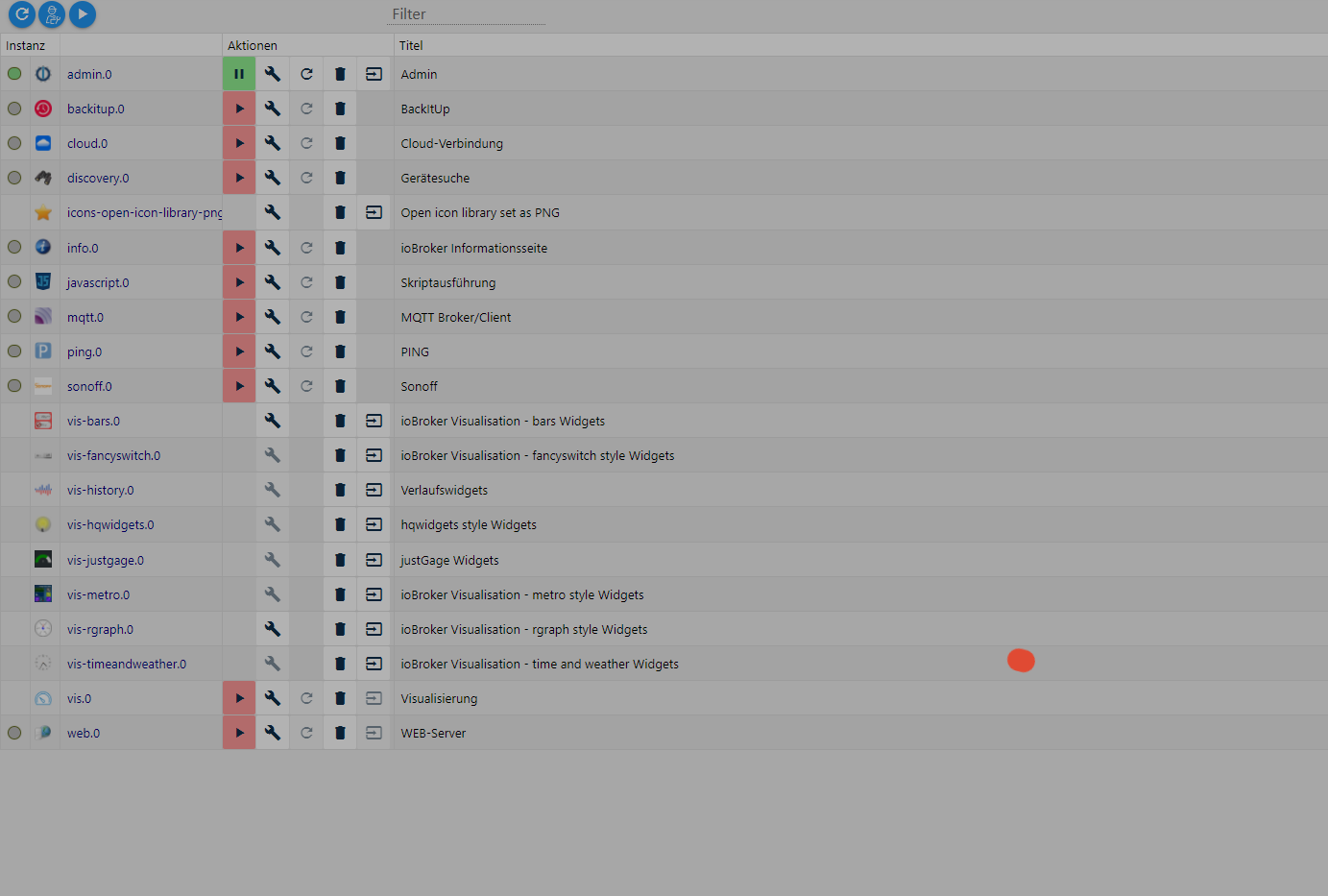

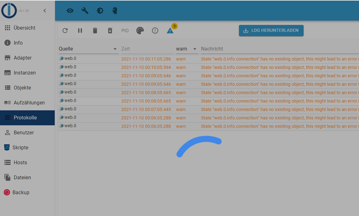

                                      Leider geht es nicht ganz, nach dem Restore.(Wieder alle Minute unterbrüche)
                                      Beim Updaten der Adapter bekomme ich einen Fehler
                                      Und im Log ist auch noch was.

                                      admin.0
                                      2021-11-09 23:31:07.275 warn State "admin.0.info.connection" has no existing object, this might lead to an error in future versions
                                      admin.0
                                      2021-11-09 23:31:06.224 warn State "admin.0.info.connection" has no existing object, this might lead to an error in future versions
                                      web.0
                                      2021-11-09 23:31:05.331 warn State "web.0.info.connection" has no existing object, this might lead to an error in future versions
                                      admin.0
                                      2021-11-09 23:30:06.412 warn State "admin.0.info.connection" has no existing object, this might lead to an error in future versions
                                      admin.0
                                      web.0
                                      2021-11-09 23:30:05.739 warn State "web.0.info.connection" has no existing object, this might lead to an error in future versions
                                      admin.0
                                      2021-11-09 23:29:07.272 warn State "admin.0.info.connection" has no existing object, this might lead to an error in future versions
                                      admin.0
                                      2021-11-09 23:29:06.131 warn State "admin.0.info.connection" has no existing object, this might lead to an error in future versions
                                      web.0
                                      2021-11-09 23:29:05.833 warn State "web.0.info.connection" has no existing object, this might lead to an error in future versions
                                      admin.0
                                      admin.0
                                      web.0
                                      web.0
                                      2021-11-09 23:28:52.083 warn State "web.0.info.connection" has no existing object, this might lead to an error in future versions
                                      web.0
                                      admin.0
                                      2021-11-09 23:28:17.892 warn State "admin.0.info.connection" has no existing object, this might lead to an error in future versions
                                      admin.0
                                      2021-11-09 23:28:12.308 warn State "admin.0.info.connection" has no existing object, this might lead to an error in future versions
                                      admin.0
                                      2021-11-09 23:23:07.281 warn State "admin.0.info.connection" has no existing object, this might lead to an error in future versions
                                      admin.0
                                      2021-11-09 23:23:06.250 warn State "admin.0.info.connection" has no existing object, this might lead to an error in future versions
                                      web.0
                                      2021-11-09 23:23:05.548 warn State "web.0.info.connection" has no existing object, this might lead to an error in future versions

                                        admin.0
                                        admin.0
                                        web.0
                                        admin.0
                                        admin.0
                                        web.0
                                        admin.0
                                        admin.0
                                        web.0
                                        admin.0
                                        admin.0
                                        web.0
                                        web.0
                                        web.0
                                        admin.0
                                        admin.0
                                        admin.0
                                        admin.0
                                        web.0
