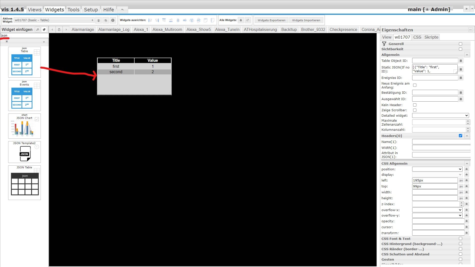

      @dr-pie
      Zum Beispiel:

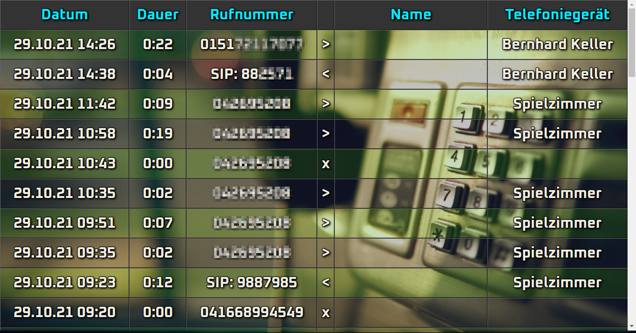

        @dr-pie ein JSON-Tabel Widget.
        Ich nutze das vis-inventwo - JSON Table
        das basic - Table mit dem JSON im Symbol/Namen sollte auch gehen
        Beim inventwo kann man Die Splatenüberschriften setzen, sich nur bestimmte Spalten anzeigen lassen und dadurch auch die Reihenfolge ändern. Nutze ich zum Beispiel für die Anruferliste aus der FritzBox:
        Hier der Widget-Export des Inventwo JSON Widgets:
        [{"tpl":"i-vis-jsontable","data":{"g_fixed":false,"g_visibility":false,"g_css_font_text":true,"g_css_background":false,"g_css_shadow_padding":false,"g_css_border":false,"g_gestures":false,"g_signals":false,"g_last_change":false,"visibility-cond":"==","visibility-val":1,"visibility-groups-action":"hide","iTblRowLimit":"50","iTableRefreshRate":"0","iColCount":"6","iColShow1":"true","iTblTextAlign1":"center","iTblCellFormat1":"normal","iTblCellImageSize1":"200","iTblCellBooleanCheckbox1":"false","iTblCellBooleanColorFalse1":"#ff0000","iTblCellBooleanColorTrue1":"#00ff00","iTblCellNumberDecimals1":"2","iTblCellNumberDecimalSeperator1":".","iTblCellNumberThousandSeperator1":",","iTblCellThresholdsDp1":"","iTblCellThresholdsText1":"","iOpacityAll":"1","iTblRowEvenColor":"rgba(51, 51, 51, 0.3)","iTblRowUnevenColor":"rgba(69, 136, 24, 0.3)","iTblHeaderColor":"#333333","iRowSpacing":"10","iTblRowEvenTextColor":"#eeece1","iTblRowUnevenTextColor":"#eeece1","iTblHeaderTextColor":"#05e8ff","iBorderSize":"1","iBorderStyleLeft":"outset","iBorderStyleRight":"outset","iBorderStyleUp":"outset","iBorderStyleDown":"outset","iBorderColor":"#666666","signals-cond-0":"==","signals-val-0":true,"signals-icon-0":"/vis/signals/lowbattery.png","signals-icon-size-0":0,"signals-blink-0":false,"signals-horz-0":0,"signals-vert-0":0,"signals-hide-edit-0":false,"signals-cond-1":"==","signals-val-1":true,"signals-icon-1":"/vis/signals/lowbattery.png","signals-icon-size-1":0,"signals-blink-1":false,"signals-horz-1":0,"signals-vert-1":0,"signals-hide-edit-1":false,"signals-cond-2":"==","signals-val-2":true,"signals-icon-2":"/vis/signals/lowbattery.png","signals-icon-size-2":0,"signals-blink-2":false,"signals-horz-2":0,"signals-vert-2":0,"signals-hide-edit-2":false,"lc-type":"last-change","lc-is-interval":true,"lc-is-moment":false,"lc-format":"","lc-position-vert":"top","lc-position-horz":"right","lc-offset-vert":0,"lc-offset-horz":0,"lc-font-size":"12px","lc-font-family":"","lc-font-style":"","lc-bkg-color":"","lc-color":"","lc-border-width":"0","lc-border-style":"","lc-border-color":"","lc-border-radius":10,"lc-zindex":0,"oid":"tr-064.0.calllists.all.json","iTblShowHead":true,"iHorScroll":false,"iColShow2":"true","iTblTextAlign2":"center","iTblCellFormat2":"normal","iTblCellImageSize2":"200","iTblCellBooleanCheckbox2":"false","iTblCellBooleanColorFalse2":"#ff0000","iTblCellBooleanColorTrue2":"#00ff00","iTblCellNumberDecimals2":"2","iTblCellNumberDecimalSeperator2":".","iTblCellNumberThousandSeperator2":",","iTblCellThresholdsDp2":"","iTblCellThresholdsText2":"","iColShow3":"true","iTblTextAlign3":"center","iTblCellFormat3":"normal","iTblCellImageSize3":"200","iTblCellBooleanCheckbox3":"false","iTblCellBooleanColorFalse3":"#ff0000","iTblCellBooleanColorTrue3":"#00ff00","iTblCellNumberDecimals3":"2","iTblCellNumberDecimalSeperator3":".","iTblCellNumberThousandSeperator3":",","iTblCellThresholdsDp3":"","iTblCellThresholdsText3":"","iColShow4":"true","iTblTextAlign4":"center","iTblCellFormat4":"normal","iTblCellImageSize4":"200","iTblCellBooleanCheckbox4":"false","iTblCellBooleanColorFalse4":"#ff0000","iTblCellBooleanColorTrue4":"#00ff00","iTblCellNumberDecimals4":"2","iTblCellNumberDecimalSeperator4":".","iTblCellNumberThousandSeperator4":",","iTblCellThresholdsDp4":"","iTblCellThresholdsText4":"","iColShow5":"true","iTblTextAlign5":"center","iTblCellFormat5":"normal","iTblCellImageSize5":"200","iTblCellBooleanCheckbox5":"false","iTblCellBooleanColorFalse5":"#ff0000","iTblCellBooleanColorTrue5":"#00ff00","iTblCellNumberDecimals5":"2","iTblCellNumberDecimalSeperator5":".","iTblCellNumberThousandSeperator5":",","iTblCellThresholdsDp5":"","iTblCellThresholdsText5":"","iColShow6":"true","iTblTextAlign6":"center","iTblCellFormat6":"normal","iTblCellImageSize6":"200","iTblCellBooleanCheckbox6":"false","iTblCellBooleanColorFalse6":"#ff0000","iTblCellBooleanColorTrue6":"#00ff00","iTblCellNumberDecimals6":"2","iTblCellNumberDecimalSeperator6":".","iTblCellNumberThousandSeperator6":",","iTblCellThresholdsDp6":"","iTblCellThresholdsText6":"","iColShow7":"true","iTblTextAlign7":"left","iTblCellFormat7":"normal","iTblCellImageSize7":"200","iTblCellBooleanCheckbox7":"false","iTblCellBooleanColorFalse7":"#ff0000","iTblCellBooleanColorTrue7":"#00ff00","iTblCellNumberDecimals7":"2","iTblCellNumberDecimalSeperator7":".","iTblCellNumberThousandSeperator7":",","iTblCellThresholdsDp7":"","iTblCellThresholdsText7":"","iColShow8":"true","iTblTextAlign8":"left","iTblCellFormat8":"normal","iTblCellImageSize8":"200","iTblCellBooleanCheckbox8":"false","iTblCellBooleanColorFalse8":"#ff0000","iTblCellBooleanColorTrue8":"#00ff00","iTblCellNumberDecimals8":"2","iTblCellNumberDecimalSeperator8":".","iTblCellNumberThousandSeperator8":",","iTblCellThresholdsDp8":"","iTblCellThresholdsText8":"","iColShow9":"true","iTblTextAlign9":"left","iTblCellFormat9":"normal","iTblCellImageSize9":"200","iTblCellBooleanCheckbox9":"false","iTblCellBooleanColorFalse9":"#ff0000","iTblCellBooleanColorTrue9":"#00ff00","iTblCellNumberDecimals9":"2","iTblCellNumberDecimalSeperator9":".","iTblCellNumberThousandSeperator9":",","iTblCellThresholdsDp9":"","iTblCellThresholdsText9":"","iColShow10":"true","iTblTextAlign10":"left","iTblCellFormat10":"normal","iTblCellImageSize10":"200","iTblCellBooleanCheckbox10":"false","iTblCellBooleanColorFalse10":"#ff0000","iTblCellBooleanColorTrue10":"#00ff00","iTblCellNumberDecimals10":"2","iTblCellNumberDecimalSeperator10":".","iTblCellNumberThousandSeperator10":",","iTblCellThresholdsDp10":"","iTblCellThresholdsText10":"","iColShow11":"true","iTblTextAlign11":"left","iTblCellFormat11":"normal","iTblCellImageSize11":"200","iTblCellBooleanCheckbox11":"false","iTblCellBooleanColorFalse11":"#ff0000","iTblCellBooleanColorTrue11":"#00ff00","iTblCellNumberDecimals11":"2","iTblCellNumberDecimalSeperator11":".","iTblCellNumberThousandSeperator11":",","iTblCellThresholdsDp11":"","iTblCellThresholdsText11":"","iColShow12":"true","iTblTextAlign12":"left","iTblCellFormat12":"normal","iTblCellImageSize12":"200","iTblCellBooleanCheckbox12":"false","iTblCellBooleanColorFalse12":"#ff0000","iTblCellBooleanColorTrue12":"#00ff00","iTblCellNumberDecimals12":"2","iTblCellNumberDecimalSeperator12":".","iTblCellNumberThousandSeperator12":",","iTblCellThresholdsDp12":"","iTblCellThresholdsText12":"","iColShow13":"true","iTblTextAlign13":"left","iTblCellFormat13":"normal","iTblCellImageSize13":"200","iTblCellBooleanCheckbox13":"false","iTblCellBooleanColorFalse13":"#ff0000","iTblCellBooleanColorTrue13":"#00ff00","iTblCellNumberDecimals13":"2","iTblCellNumberDecimalSeperator13":".","iTblCellNumberThousandSeperator13":",","iTblCellThresholdsDp13":"","iTblCellThresholdsText13":"","iColShow14":"true","iTblTextAlign14":"left","iTblCellFormat14":"normal","iTblCellImageSize14":"200","iTblCellBooleanCheckbox14":"false","iTblCellBooleanColorFalse14":"#ff0000","iTblCellBooleanColorTrue14":"#00ff00","iTblCellNumberDecimals14":"2","iTblCellNumberDecimalSeperator14":".","iTblCellNumberThousandSeperator14":",","iTblCellThresholdsDp14":"","iTblCellThresholdsText14":"","iColAttr1":"date","iColName1":"Datum","iColAttr2":"duration","iColName2":"Dauer","iColAttr3":"caller","iColName3":"Rufnummer","iColAttr4":"sym","iColAttr5":"name","iColName4":" ","iColName5":"Name","iTblCellDatetimeFormat1":"dd.mm.yy HH:ii","iBorderRemoveDouble":false,"iTblFixedHead":true,"iVertScroll":true,"iColAttr6":"device","iColName6":"Telefoniegerät"},"style":{"left":"0px","top":"130px","width":"1280px","height":"666px","z-index":"12","text-shadow":"1px 1px 0 #000000, 1px -1px 0 #000000, -1px 1px 0 #000000, -1px -1px 0 #000000, 1px 0px 0 #000000, 0px 1px 0 #000000, -1px 0px 0 #000000, 0px -1px 0 #000000, 1px 1px 4px #000000, 2px 2px 4px #000000","font-family":"Oxanium","font-size":"30px","overflow-x":"hidden","overflow-y":"scroll"},"widgetSet":"vis-inventwo"}]
        In der Spalte Name taucht nur was auf falls der Anrufer im FritzBox Telefonbuch ist
