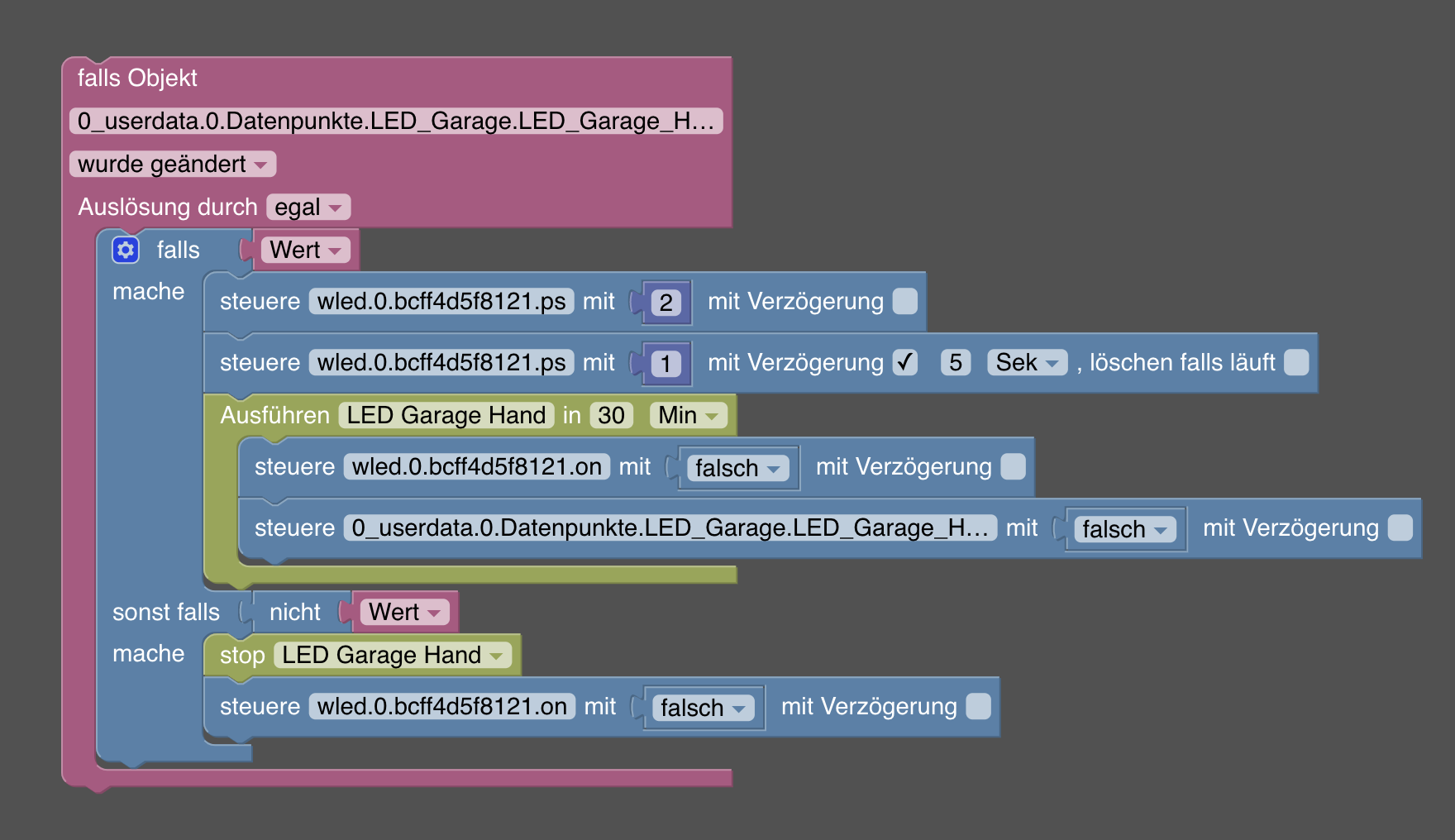

          Ich habe es in Blockly programmiert. Weiß aber gerade nicht, wie ich Blockly hochladen soll. Hier einmal mein Skript als Code:
          var LED_Garage_Hand;
          on({id: "0_userdata.0.Datenpunkte.LED_Garage.LED_Garage_Hand"/*LED Garage Hand*/, change: "ne"}, async function (obj) {
            var value = obj.state.val;
            if (getState("0_userdata.0.Datenpunkte.LED_Garage.LED_Garage_Hand").val == true) {
              setState("wled.0.bcff4d5f8121.ps"/*ID of currently set preset*/, 2);
              setStateDelayed("wled.0.bcff4d5f8121.ps"/*ID of currently set preset*/, 1, 5000, false);
              LED_Garage_Hand = setTimeout(async function () {
                setState("wled.0.bcff4d5f8121.on"/*On / Off*/, (!true));
                setState("0_userdata.0.Datenpunkte.LED_Garage.LED_Garage_Hand"/*LED Garage Hand*/, (!true));
              }, 1800000);
            } else if (getState("0_userdata.0.Datenpunkte.LED_Garage.LED_Garage_Hand").val == !true) {
              (function () {if (LED_Garage_Hand) {clearTimeout(LED_Garage_Hand); LED_Garage_Hand = null;}})();
          getState("0_userdata.0.Datenpunkte.LED_Garage.LED_Garage_Hand").val;
          //JTNDeG1sJTIweG1sbnMlM0QlMjJodHRwcyUzQSUyRiUyRmRldmVsb3BlcnMuZ29vZ2xlLmNvbSUyRmJsb2NrbHklMkZ4bWwlMjIlM0UlM0N2YXJpYWJsZXMlM0UlM0N2YXJpYWJsZSUyMHR5cGUlM0QlMjJ0aW1lb3V0JTIyJTIwaWQlM0QlMjJMRUQlMjBHYXJhZ2UlMjBIYW5kJTIyJTNFTEVEJTIwR2FyYWdlJTIwSGFuZCUzQyUyRnZhcmlhYmxlJTNFJTNDJTJGdmFyaWFibGVzJTNFJTNDYmxvY2slMjB0eXBlJTNEJTIyb24lMjIlMjBpZCUzRCUyMlUybSUyNVNXJTNGJTI1ZCU2MDdfMnpISy1zMnUlMjIlMjB4JTNEJTIyLTY2MiUyMiUyMHklM0QlMjItNDEyJTIyJTNFJTNDZmllbGQlMjBuYW1lJTNEJTIyT0lEJTIyJTNFMF91c2VyZGF0YS4wLkRhdGVucHVua3RlLkxFRF9HYXJhZ2UuTEVEX0dhcmFnZV9IYW5kJTNDJTJGZmllbGQlM0UlM0NmaWVsZCUyMG5hbWUlM0QlMjJDT05ESVRJT04lMjIlM0VuZSUzQyUyRmZpZWxkJTNFJTNDZmllbGQlMjBuYW1lJTNEJTIyQUNLX0NPTkRJVElPTiUyMiUzRSUzQyUyRmZpZWxkJTNFJTNDc3RhdGVtZW50JTIwbmFtZSUzRCUyMlNUQVRFTUVOVCUyMiUzRSUzQ2Jsb2NrJTIwdHlwZSUzRCUyMmNvbnRyb2xzX2lmJTIyJTIwaWQlM0QlMjIlNDAlM0QlN0QlMkZ1aiUzREFzdmUlN0QlN0JsSi5DSyp1JTIyJTNFJTNDbXV0YXRpb24lMjBlbHNlaWYlM0QlMjIxJTIyJTNFJTNDJTJGbXV0YXRpb24lM0UlM0N2YWx1ZSUyMG5hbWUlM0QlMjJJRjAlMjIlM0UlM0NibG9jayUyMHR5cGUlM0QlMjJsb2dpY19jb21wYXJlJTIyJTIwaWQlM0QlMjJGJTJGd1I4SC1GY0R3JTVCZCUyNG5LWDZLaCUyMiUzRSUzQ2ZpZWxkJTIwbmFtZSUzRCUyMk9QJTIyJTNFRVElM0MlMkZmaWVsZCUzRSUzQ3ZhbHVlJTIwbmFtZSUzRCUyMkElMjIlM0UlM0NibG9jayUyMHR5cGUlM0QlMjJnZXRfdmFsdWUlMjIlMjBpZCUzRCUyMiU3QkglM0YlNUIlNUUlMjREJTIzdlVSRmNLUENTdnglNjAlMjIlM0UlM0NmaWVsZCUyMG5hbWUlM0QlMjJBVFRSJTIyJTNFdmFsJTNDJTJGZmllbGQlM0UlM0NmaWVsZCUyMG5hbWUlM0QlMjJPSUQlMjIlM0UwX3VzZXJkYXRhLjAuRGF0ZW5wdW5rdGUuTEVEX0dhcmFnZS5MRURfR2FyYWdlX0hhbmQlM0MlMkZmaWVsZCUzRSUzQyUyRmJsb2NrJTNFJTNDJTJGdmFsdWUlM0UlM0N2YWx1ZSUyMG5hbWUlM0QlMjJCJTIyJTNFJTNDYmxvY2slMjB0eXBlJTNEJTIybG9naWNfYm9vbGVhbiUyMiUyMGlkJTNEJTIydmtjaCU1QnFOJTdCODVZUXJUeFBfNXZJJTIyJTNFJTNDZmllbGQlMjBuYW1lJTNEJTIyQk9PTCUyMiUzRVRSVUUlM0MlMkZmaWVsZCUzRSUzQyUyRmJsb2NrJTNFJTNDJTJGdmFsdWUlM0UlM0MlMkZibG9jayUzRSUzQyUyRnZhbHVlJTNFJTNDc3RhdGVtZW50JTIwbmFtZSUzRCUyMkRPMCUyMiUzRSUzQ2Jsb2NrJTIwdHlwZSUzRCUyMmNvbnRyb2wlMjIlMjBpZCUzRCUyMlVsciUzQiU1RH4lNUJxWHlGbjJNYnklN0RrLU0lMjIlM0UlM0NtdXRhdGlvbiUyMHhtbG5zJTNEJTIyaHR0cCUzQSUyRiUyRnd3dy53My5vcmclMkYxOTk5JTJGeGh0bWwlMjIlMjBkZWxheV9pbnB1dCUzRCUyMmZhbHNlJTIyJTNFJTNDJTJGbXV0YXRpb24lM0UlM0NmaWVsZCUyMG5hbWUlM0QlMjJPSUQlMjIlM0V3bGVkLjAuYmNmZjRkNWY4MTIxLnBzJTNDJTJGZmllbGQlM0UlM0NmaWVsZCUyMG5hbWUlM0QlMjJXSVRIX0RFTEFZJTIyJTNFRkFMU0UlM0MlMkZmaWVsZCUzRSUzQ3ZhbHVlJTIwbmFtZSUzRCUyMlZBTFVFJTIyJTNFJTNDYmxvY2slMjB0eXBlJTNEJTIybWF0aF9udW1iZXIlMjIlMjBpZCUzRCUyMiUzRGpUenJSMihjYipvJTIzJTdDJTdCTE9yTFAlMjIlM0UlM0NmaWVsZCUyMG5hbWUlM0QlMjJOVU0lMjIlM0UyJTNDJTJGZmllbGQlM0UlM0MlMkZibG9jayUzRSUzQyUyRnZhbHVlJTNFJTNDbmV4dCUzRSUzQ2Jsb2NrJTIwdHlwZSUzRCUyMmNvbnRyb2wlMjIlMjBpZCUzRCUyMkQ0JTVESUslM0ZSJTNEUC1GJTI1JTdEOTNvdF9VJTdDJTIyJTNFJTNDbXV0YXRpb24lMjB4bWxucyUzRCUyMmh0dHAlM0ElMkYlMkZ3d3cudzMub3JnJTJGMTk5OSUyRnhodG1sJTIyJTIwZGVsYXlfaW5wdXQlM0QlMjJ0cnVlJTIyJTNFJTNDJTJGbXV0YXRpb24lM0UlM0NmaWVsZCUyMG5hbWUlM0QlMjJPSUQlMjIlM0V3bGVkLjAuYmNmZjRkNWY4MTIxLnBzJTNDJTJGZmllbGQlM0UlM0NmaWVsZCUyMG5hbWUlM0QlMjJXSVRIX0RFTEFZJTIyJTNFVFJVRSUzQyUyRmZpZWxkJTNFJTNDZmllbGQlMjBuYW1lJTNEJTIyREVMQVlfTVMlMjIlM0U1JTNDJTJGZmllbGQlM0UlM0NmaWVsZCUyMG5hbWUlM0QlMjJVTklUJTIyJTNFc2VjJTNDJTJGZmllbGQlM0UlM0NmaWVsZCUyMG5hbWUlM0QlMjJDTEVBUl9SVU5OSU5HJTIyJTNFRkFMU0UlM0MlMkZmaWVsZCUzRSUzQ3ZhbHVlJTIwbmFtZSUzRCUyMlZBTFVFJTIyJTNFJTNDYmxvY2slMjB0eXBlJTNEJTIybWF0aF9udW1iZXIlMjIlMjBpZCUzRCUyMlRxNSUyQjdwJTNELU8wdSU2MFlqJTNBViU1RSolNjAlNUUlMjIlM0UlM0NmaWVsZCUyMG5hbWUlM0QlMjJOVU0lMjIlM0UxJTNDJTJGZmllbGQlM0UlM0MlMkZibG9jayUzRSUzQyUyRnZhbHVlJTNFJTNDbmV4dCUzRSUzQ2Jsb2NrJTIwdHlwZSUzRCUyMnRpbWVvdXRzX3NldHRpbWVvdXQlMjIlMjBpZCUzRCUyMiUzQk9vcS1vdEEzTSUzRE0lMkNuUiUyQ1hnJTJGNyUyMiUzRSUzQ2ZpZWxkJTIwbmFtZSUzRCUyMk5BTUUlMjIlM0VMRUQlMjBHYXJhZ2UlMjBIYW5kJTNDJTJGZmllbGQlM0UlM0NmaWVsZCUyMG5hbWUlM0QlMjJERUxBWSUyMiUzRTMwJTNDJTJGZmllbGQlM0UlM0NmaWVsZCUyMG5hbWUlM0QlMjJVTklUJTIyJTNFbWluJTNDJTJGZmllbGQlM0UlM0NzdGF0ZW1lbnQlMjBuYW1lJTNEJTIyU1RBVEVNRU5UJTIyJTNFJTNDYmxvY2slMjB0eXBlJTNEJTIyY29udHJvbCUyMiUyMGlkJTNEJTIyJTQwWUxtYX50YlZYKDBDJTJDdkhaJTVFUUwlMjIlM0UlM0NtdXRhdGlvbiUyMHhtbG5zJTNEJTIyaHR0cCUzQSUyRiUyRnd3dy53My5vcmclMkYxOTk5JTJGeGh0bWwlMjIlMjBkZWxheV9pbnB1dCUzRCUyMmZhbHNlJTIyJTNFJTNDJTJGbXV0YXRpb24lM0UlM0NmaWVsZCUyMG5hbWUlM0QlMjJPSUQlMjIlM0V3bGVkLjAuYmNmZjRkNWY4MTIxLm9uJTNDJTJGZmllbGQlM0UlM0NmaWVsZCUyMG5hbWUlM0QlMjJXSVRIX0RFTEFZJTIyJTNFRkFMU0UlM0MlMkZmaWVsZCUzRSUzQ3ZhbHVlJTIwbmFtZSUzRCUyMlZBTFVFJTIyJTNFJTNDYmxvY2slMjB0eXBlJTNEJTIybG9naWNfbmVnYXRlJTIyJTIwaWQlM0QlMjJoWEVISTBIRlJtJTJCT0tVcTlxUyUyNWwlMjIlM0UlM0N2YWx1ZSUyMG5hbWUlM0QlMjJCT09MJTIyJTNFJTNDYmxvY2slMjB0eXBlJTNEJTIybG9naWNfYm9vbGVhbiUyMiUyMGlkJTNEJTIyJTI0VzYqeElDVUJlLSU2MEYlM0ZVcF8lNDBlbCUyMiUzRSUzQ2ZpZWxkJTIwbmFtZSUzRCUyMkJPT0wlMjIlM0VUUlVFJTNDJTJGZmllbGQlM0UlM0MlMkZibG9jayUzRSUzQyUyRnZhbHVlJTNFJTNDJTJGYmxvY2slM0UlM0MlMkZ2YWx1ZSUzRSUzQ25leHQlM0UlM0NibG9jayUyMHR5cGUlM0QlMjJjb250cm9sJTIyJTIwaWQlM0QlMjIlMjNYUWJ3YnlIOUMtaWYlNDAlN0JFLUclMkY4JTIyJTNFJTNDbXV0YXRpb24lMjB4bWxucyUzRCUyMmh0dHAlM0ElMkYlMkZ3d3cudzMub3JnJTJGMTk5OSUyRnhodG1sJTIyJTIwZGVsYXlfaW5wdXQlM0QlMjJmYWxzZSUyMiUzRSUzQyUyRm11dGF0aW9uJTNFJTNDZmllbGQlMjBuYW1lJTNEJTIyT0lEJTIyJTNFMF91c2VyZGF0YS4wLkRhdGVucHVua3RlLkxFRF9HYXJhZ2UuTEVEX0dhcmFnZV9IYW5kJTNDJTJGZmllbGQlM0UlM0NmaWVsZCUyMG5hbWUlM0QlMjJXSVRIX0RFTEFZJTIyJTNFRkFMU0UlM0MlMkZmaWVsZCUzRSUzQ3ZhbHVlJTIwbmFtZSUzRCUyMlZBTFVFJTIyJTNFJTNDYmxvY2slMjB0eXBlJTNEJTIybG9naWNfbmVnYXRlJTIyJTIwaWQlM0QlMjJOJTIzdCFCNjhjcVFZWHUlNURqQm9ZJTJDMiUyMiUzRSUzQ3ZhbHVlJTIwbmFtZSUzRCUyMkJPT0wlMjIlM0UlM0NibG9jayUyMHR5cGUlM0QlMjJsb2dpY19ib29sZWFuJTIyJTIwaWQlM0QlMjJoJTdCJTI1eSU1RSU3QnAlMkYtU1dwJTVCbiU1RWVxb2ExJTIyJTNFJTNDZmllbGQlMjBuYW1lJTNEJTIyQk9PTCUyMiUzRVRSVUUlM0MlMkZmaWVsZCUzRSUzQyUyRmJsb2NrJTNFJTNDJTJGdmFsdWUlM0UlM0MlMkZibG9jayUzRSUzQyUyRnZhbHVlJTNFJTNDJTJGYmxvY2slM0UlM0MlMkZuZXh0JTNFJTNDJTJGYmxvY2slM0UlM0MlMkZzdGF0ZW1lbnQlM0UlM0MlMkZibG9jayUzRSUzQyUyRm5leHQlM0UlM0MlMkZibG9jayUzRSUzQyUyRm5leHQlM0UlM0MlMkZibG9jayUzRSUzQyUyRnN0YXRlbWVudCUzRSUzQ3ZhbHVlJTIwbmFtZSUzRCUyMklGMSUyMiUzRSUzQ2Jsb2NrJTIwdHlwZSUzRCUyMmxvZ2ljX2NvbXBhcmUlMjIlMjBpZCUzRCUyMnFuc3RSTFNLOXMlMkN5YiUzQnE1biUyNCU3RE8lMjIlM0UlM0NmaWVsZCUyMG5hbWUlM0QlMjJPUCUyMiUzRUVRJTNDJTJGZmllbGQlM0UlM0N2YWx1ZSUyMG5hbWUlM0QlMjJBJTIyJTNFJTNDYmxvY2slMjB0eXBlJTNEJTIyZ2V0X3ZhbHVlJTIyJTIwaWQlM0QlMjJqd3pKMiUyNHRWVi5MWV96dWl1cUt3JTIyJTNFJTNDZmllbGQlMjBuYW1lJTNEJTIyQVRUUiUyMiUzRXZhbCUzQyUyRmZpZWxkJTNFJTNDZmllbGQlMjBuYW1lJTNEJTIyT0lEJTIyJTNFMF91c2VyZGF0YS4wLkRhdGVucHVua3RlLkxFRF9HYXJhZ2UuTEVEX0dhcmFnZV9IYW5kJTNDJTJGZmllbGQlM0UlM0MlMkZibG9jayUzRSUzQyUyRnZhbHVlJTNFJTNDdmFsdWUlMjBuYW1lJTNEJTIyQiUyMiUzRSUzQ2Jsb2NrJTIwdHlwZSUzRCUyMmxvZ2ljX25lZ2F0ZSUyMiUyMGlkJTNEJTIyQ2tzJTNEVk5JRDBhN0NOWmhSazclNjBKJTIyJTNFJTNDdmFsdWUlMjBuYW1lJTNEJTIyQk9PTCUyMiUzRSUzQ2Jsb2NrJTIwdHlwZSUzRCUyMmxvZ2ljX2Jvb2xlYW4lMjIlMjBpZCUzRCUyMn4lMjMpJTI1ViU3QkpmJTNCZUhTQ2EhSFElNjAlM0Y0JTIyJTNFJTNDZmllbGQlMjBuYW1lJTNEJTIyQk9PTCUyMiUzRVRSVUUlM0MlMkZmaWVsZCUzRSUzQyUyRmJsb2NrJTNFJTNDJTJGdmFsdWUlM0UlM0MlMkZibG9jayUzRSUzQyUyRnZhbHVlJTNFJTNDJTJGYmxvY2slM0UlM0MlMkZ2YWx1ZSUzRSUzQ3N0YXRlbWVudCUyMG5hbWUlM0QlMjJETzElMjIlM0UlM0NibG9jayUyMHR5cGUlM0QlMjJ0aW1lb3V0c19jbGVhcnRpbWVvdXQlMjIlMjBpZCUzRCUyMlhvaSUyNTVqUVlHZWNvTzRpKWQtekYlMjIlM0UlM0NmaWVsZCUyMG5hbWUlM0QlMjJOQU1FJTIyJTNFTEVEJTIwR2FyYWdlJTIwSGFuZCUzQyUyRmZpZWxkJTNFJTNDbmV4dCUzRSUzQ2Jsb2NrJTIwdHlwZSUzRCUyMmNvbnRyb2wlMjIlMjBpZCUzRCUyMnV5bip6c0VZaXBVc21uJTdDJTVEISUzQXAlNjAlMjIlM0UlM0NtdXRhdGlvbiUyMHhtbG5zJTNEJTIyaHR0cCUzQSUyRiUyRnd3dy53My5vcmclMkYxOTk5JTJGeGh0bWwlMjIlMjBkZWxheV9pbnB1dCUzRCUyMmZhbHNlJTIyJTNFJTNDJTJGbXV0YXRpb24lM0UlM0NmaWVsZCUyMG5hbWUlM0QlMjJPSUQlMjIlM0V3bGVkLjAuYmNmZjRkNWY4MTIxLm9uJTNDJTJGZmllbGQlM0UlM0NmaWVsZCUyMG5hbWUlM0QlMjJXSVRIX0RFTEFZJTIyJTNFRkFMU0UlM0MlMkZmaWVsZCUzRSUzQ3ZhbHVlJTIwbmFtZSUzRCUyMlZBTFVFJTIyJTNFJTNDYmxvY2slMjB0eXBlJTNEJTIybG9naWNfbmVnYXRlJTIyJTIwaWQlM0QlMjJFNXhEJTI1ViU1RCU3RGZZSjFhJTJDXyUzRjhiUjklMjIlM0UlM0N2YWx1ZSUyMG5hbWUlM0QlMjJCT09MJTIyJTNFJTNDYmxvY2slMjB0eXBlJTNEJTIybG9naWNfYm9vbGVhbiUyMiUyMGlkJTNEJTIyJTdCJTNGSXdVJTIzVG5tJTVCbi0lN0MlM0Q5dypmJTVEdiUyMiUzRSUzQ2ZpZWxkJTIwbmFtZSUzRCUyMkJPT0wlMjIlM0VUUlVFJTNDJTJGZmllbGQlM0UlM0MlMkZibG9jayUzRSUzQyUyRnZhbHVlJTNFJTNDJTJGYmxvY2slM0UlM0MlMkZ2YWx1ZSUzRSUzQyUyRmJsb2NrJTNFJTNDJTJGbmV4dCUzRSUzQyUyRmJsb2NrJTNFJTNDJTJGc3RhdGVtZW50JTNFJTNDJTJGYmxvY2slM0UlM0MlMkZzdGF0ZW1lbnQlM0UlM0MlMkZibG9jayUzRSUzQ2Jsb2NrJTIwdHlwZSUzRCUyMmdldF92YWx1ZSUyMiUyMGlkJTNEJTIyJTdDTCUyQkpmUSklNjBiZFRvSWV0eWIlMkJSJTI1JTIyJTIweCUzRCUyMi01MDAlMjIlMjB5JTNEJTIyLTIwJTIyJTNFJTNDZmllbGQlMjBuYW1lJTNEJTIyQVRUUiUyMiUzRXZhbCUzQyUyRmZpZWxkJTNFJTNDZmllbGQlMjBuYW1lJTNEJTIyT0lEJTIyJTNFMF91c2VyZGF0YS4wLkRhdGVucHVua3RlLkxFRF9HYXJhZ2UuTEVEX0dhcmFnZV9IYW5kJTNDJTJGZmllbGQlM0UlM0MlMkZibG9jayUzRSUzQyUyRnhtbCUzRQ==

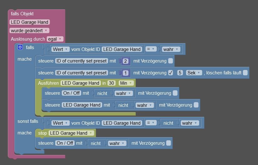

                  Wie startest Du die Sequenz? In diesem Script ist ja nur die Handfunktion. Ich würde mal versuchen, die beiden in einem Script zu vereinen. Dann könntest Du mit dem Trigger für die Sequenz auch die Timeoutfunktion wieder zurücksetzen. Oder Du setzt Deinen Datenpunkt für Hand Ein mit dem Trigger der Sequenz wieder zurück.
                    Ziel ist es, mit der Änderung auf true die LED-Leiste mit preset 2 (alle LED's an) und nach 5 Sekunden mit preset 1 (LED's als Spot) zu schalten. Nach 30 Minuten sollen sie wieder aus gehen. Sollte während dieser Zeit ein false kommen, sollen sie sofort ausgehen. Funktioniert auch soweit. Allerdings fehlt mir die Idee zum "retriggern". Ich könnte die LED's mit false ausschalten und mit true von vorne starten. Sollte aber auch anders gehen. Als zusätzlichen Nebeneffekt schalten die LED's nach 30 Minuten aus, wenn sie über den sunset eingeschaltet werden. Das sollte so auch nict sein. Deshalb ist die Idee mit dem Zusammenführen beider Skipte gar nicht so schlecht. Die Idee zwei Skripte zu erstellen um diesesauber zu trennen.

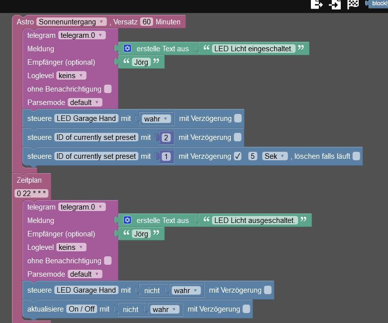

                      So ist´s ein bissl hübscher:
