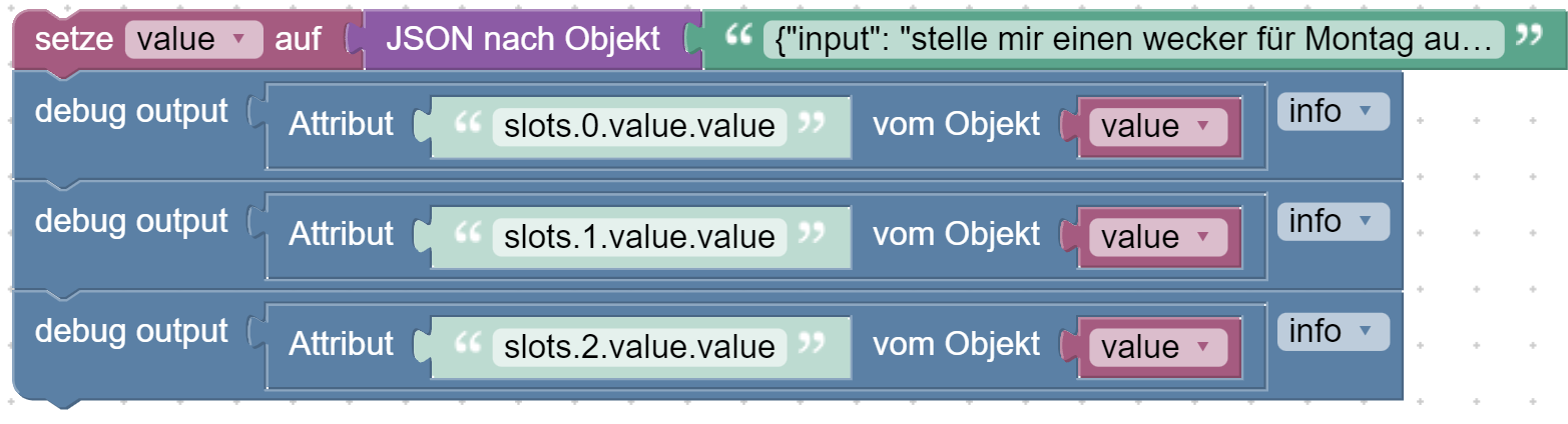

    ich möchte gerne folgendes Json auslesen:
    {"input": "stelle mir einen wecker für Montag auf 6 uhr 10",
    "intent": {
       		"intentName": "SetAlarm",
       		"confidenceScore": 1.0},
       		"siteId": "Wohnzimmer",
       		"id": "f19",
       		"slots":
       				"entity": "rhasspy/days",
       				"value": {"kind": "Unknown", "value": "Montag"},
       				"slotName": "Tag",
       				"rawValue": "Montag",
       				"confidence": 1.0,
       				"range": {"start": 28, "end": 34, "rawStart": 28, "rawEnd": 34}
       				"entity": "rhasspy/number",
       				"value": {"kind": "Number", "value": 6},
       				"slotName": "stunde",
       				"rawValue": "sechs",
       				"confidence": 1.0,
       				"range": {"start": 39, "end": 40, "rawStart": 39, "rawEnd": 44}
       				"value": {"kind": "Number", "value": 10},
       				"slotName": "minute",
       				"rawValue": "zehn",
       				"confidence": 1.0,
       				"range": {"start": 45, "end": 47, "rawStart": 49, "rawEnd": 53}
       		"sessionId": "f194af5b-c162-4643-92e8-7a746c95c676",
       		"customData": null,
       		"asrTokens": [
       				"value": "stelle",
       				"confidence": 1.0,
       				"rangeStart": 0,
       				"rangeEnd": 6,
       				"time": null
       				"value": "mir",
       				"confidence": 1.0,
       				"rangeStart": 7,
       				"rangeEnd": 10,
       				"time": null
       				"value": "einen",
       				"confidence": 1.0,
       				"rangeStart": 11,
       				"rangeEnd": 16,
       				"time": null
       				"value": "wecker",
       				"confidence": 1.0,
       				"rangeStart": 17,
       				"rangeEnd": 23,
       				"time": null
       				"value": "für",
       				"confidence": 1.0,
       				"rangeStart": 24,
       				"rangeEnd": 27,
       				"time": null
       				"value": "Montag",
       				"confidence": 1.0,
       				"rangeStart": 28,
       				"rangeEnd": 34,
       				"time": null
       				"value": "auf",
       				"confidence": 1.0,
       				"rangeStart": 35,
       				"rangeEnd": 38,
       				"time": null
       				"value": "6",
       				"confidence": 1.0,
       				"rangeStart": 39,
       				"rangeEnd": 40,
       				"time": null
       				"value": "uhr",
       				"confidence": 1.0,
       				"rangeStart": 41,
       				"rangeEnd": 44,
       				"time": null
       				"value": "10",
       				"confidence": 1.0,
       				"rangeStart": 45,
       				"rangeEnd": 47,
       				"time": null
       		"asrConfidence": null,
       		"rawInput": "stelle mir einen Wecker für Montag auf 6 Uhr 10",
       		"wakewordId": null,
       		"lang": null
    Jetzt habe ich es schon mal so weit hinbekommen, dass ich die Stunde im Datenpunkt angezeigt bekomme.

    Meine Frage wäre aber nun, wie ich aus dem "im Text XXX suche erstes...." zu "im Text XXX suche zweites..." machen kann?
    Würde mir bitte jemand helfen?

      @jwerlsdf das json kannst du so auswerten

        jwerlsdf
        schrieb am zuletzt editiert von jwerlsdf
        @fastfoot
        vielen Dank mit Attribut ging es :)
