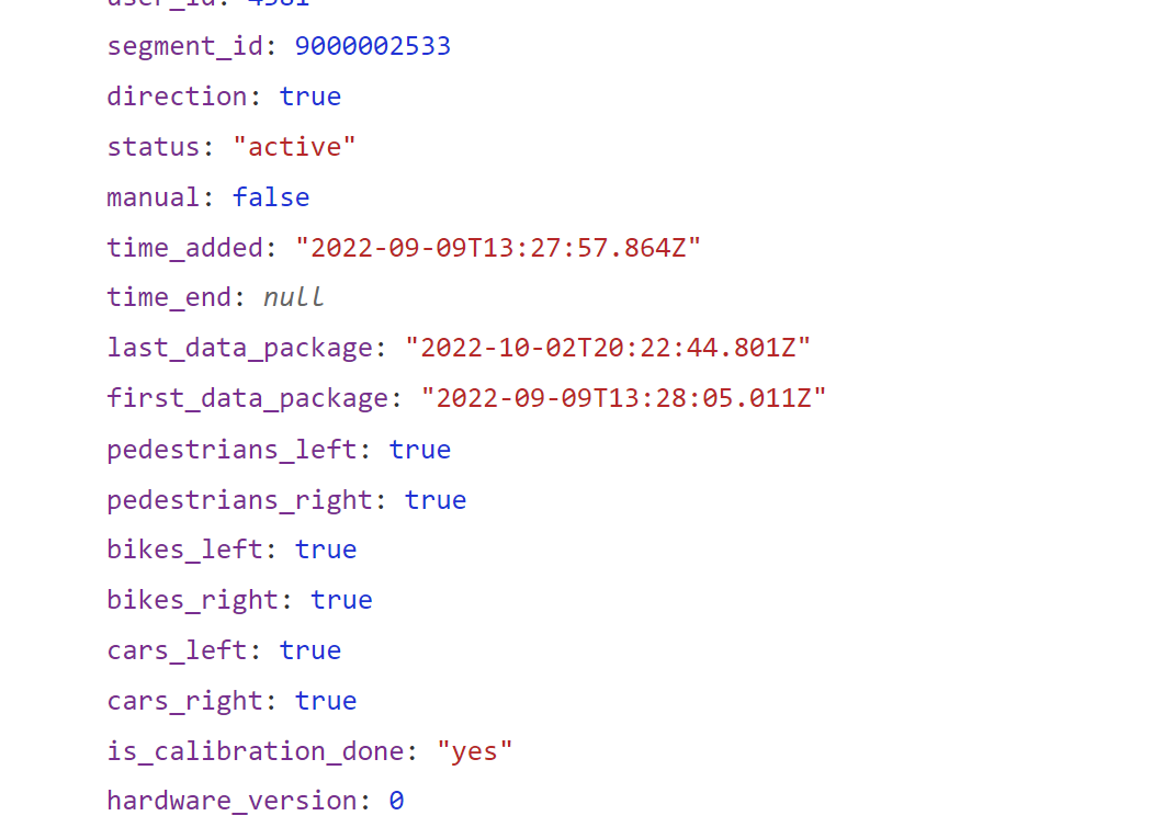

    ok, kommt das
    {"status_code":200,"message":"ok","camera":[{"instance_id":5843,"mac":202481599336532,"user_id":4381,"segment_id":9000002533,"direction":true,"status":"active","manual":false,"time_added":"2022-09-09T13:27:57.864Z","time_end":null,"last_data_package":"2022-10-02T20:22:44.801Z","first_data_package":"2022-09-09T13:28:05.011Z","pedestrians_left":true,"pedestrians_right":true,"bikes_left":true,"bikes_right":true,"cars_left":true,"cars_right":true,"is_calibration_done":"yes","hardware_version":0},{"instance_id":4013,"mac":202481592368789,"user_id":4381,"segment_id":9000002533,"direction":true,"status":"non_active","manual":false,"time_added":"2021-08-07T16:54:47.641Z","time_end":null,"last_data_package":"2021-10-15T10:08:29.443Z","first_data_package":"2021-08-07T17:00:00.000Z","pedestrians_left":true,"pedestrians_right":true,"bikes_left":true,"bikes_right":true,"cars_left":true,"cars_right":true,"is_calibration_done":"partial","hardware_version":1},{"instance_id":4012,"mac":202481599336532,"user_id":4381,"segment_id":9000002533,"direction":true,"status":"non_active","manual":false,"time_added":"2021-08-07T14:53:04.598Z","time_end":"2021-08-07T16:54:47.641Z","last_data_package":"2021-08-07T16:54:09.477Z","first_data_package":"2021-08-07T15:00:00.000Z","pedestrians_left":true,"pedestrians_right":false,"bikes_left":false,"bikes_right":false,"cars_left":true,"cars_right":false,"is_calibration_done":"no","hardware_version":1}]}

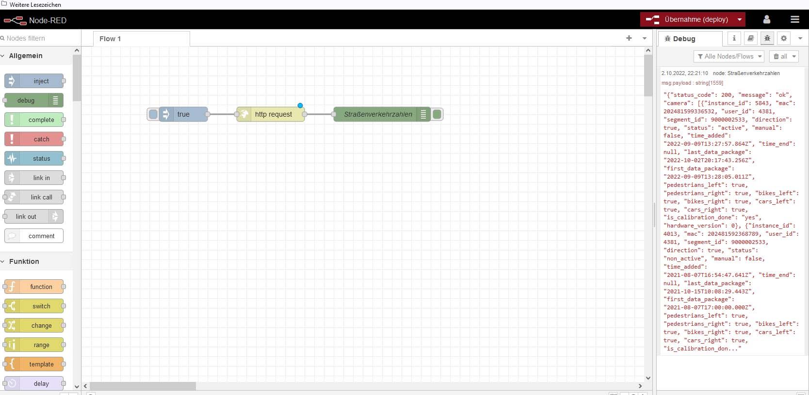

      @beowolf sagte in Straßenverkehr - Zählen des Verkehrsaufkommen - Adapter?:
      OK - weiss nicht was Du für eine URL abgesetzt hast - aber hier wird nichts gezählt wie Du siehst, sondern nur true oder false ausgegeben - scheinen 3 Kameras zu sein. Egal auf den Inhalt kann ich eh nichts sagen. Die Interpretation liegt bei Dir.
      Es wird also nur quasi Einstellungen wiedergegeben aber keine Zahlen.
      Aber egal ich zeig Dir wie Du aus dem Objekt nun Datenpunkte erstellst.

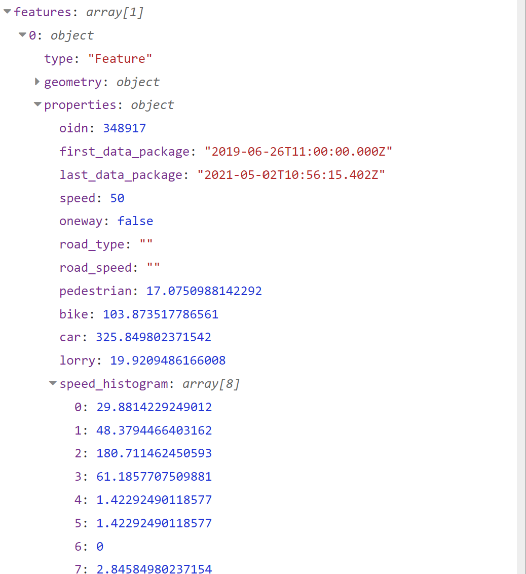

      In der ursprünglichen URL - die Du mit CURL gepostet hast, da kamen dann ja Anzahl raus und ein Histogramm mit der Geschwindigkeitsverteilung.

        @beowolf Im Prinzip würden wir aus dem Aufruf dann folgende Struktur in den iobroker schreiben:
        evtl. halt nochmal überprüfen, ob es die richtige URL ist für die Ausgabe.
        Aber im Prinzip funktioniert es, wie ich mir das vorgestellt habe - schau Dir halt ggf. noch die Doku an. Ich denke mal Du willst ja NodeRed gar nicht groß nutzen, sondern nur möglichst schnell Datenpunkte haben, die Du dann weiterverarbeiten kannst.

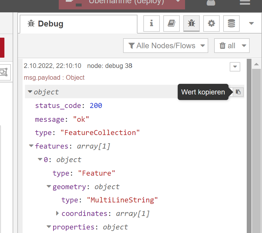

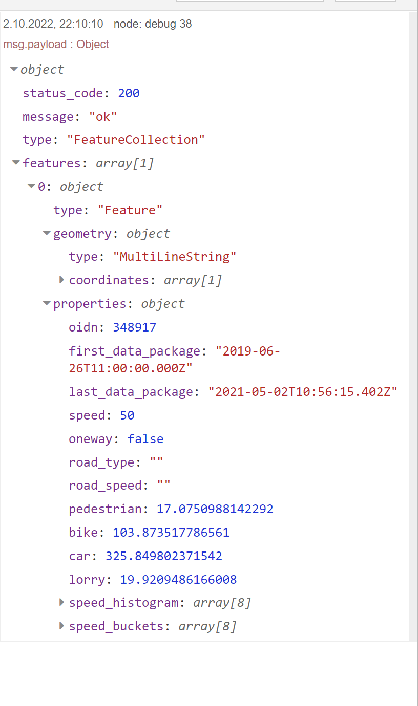

          Wenn ich den Link wie beim ersten mal eingebe, kommt das
          {"status_code":400,"message":"area must be either \"lon,lat,radius\" (for segments within a circle around point with given radius in km) or \"lon_ul,lat_ul,lon_br,lat_br\" (for segments inside the specified bounding box)"}
          Müssen an dem Link noch weitere Parameter übergeben werden?

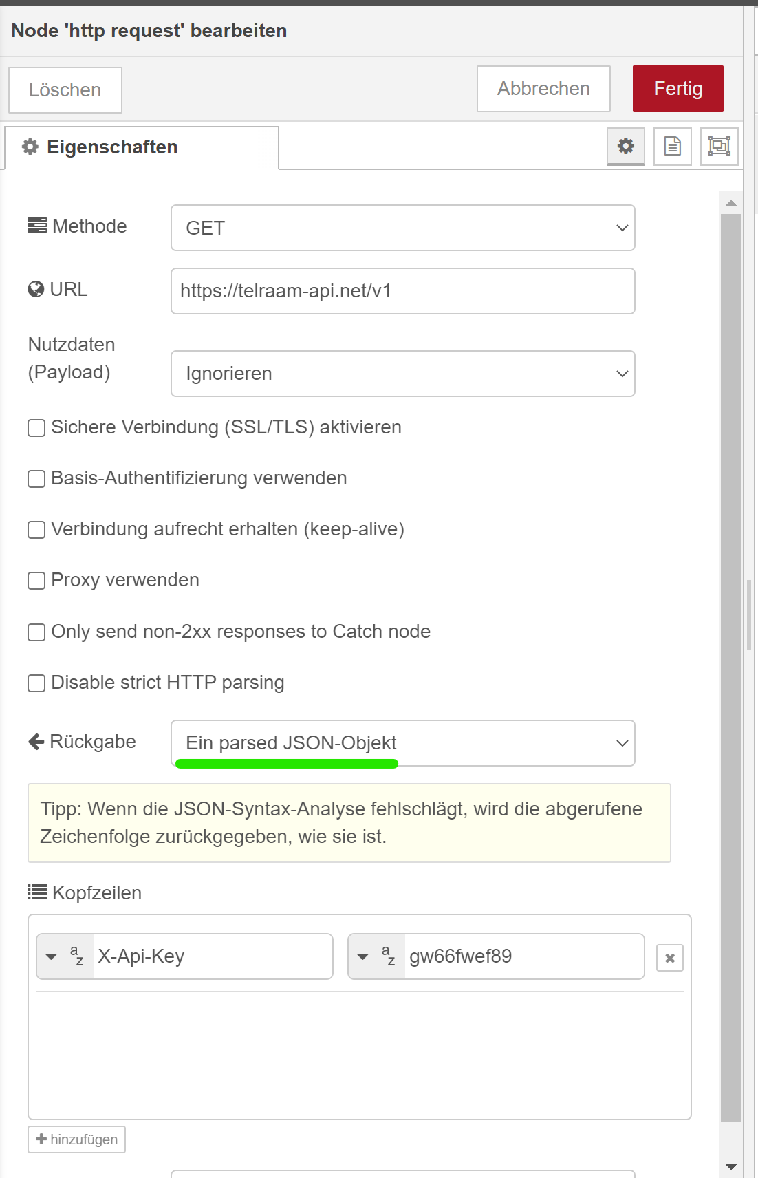

          Ach ja, ich musste von GET auf POST umstellen. Sonst sagt er mir das der Token fehlt

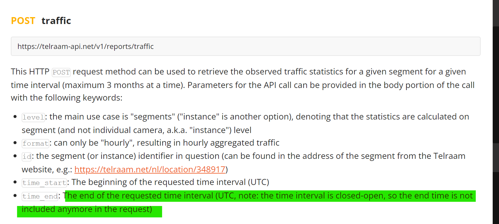

            @beowolf Ja steht ja da -
            Nein bei POST musst Du ein JSON mitgeben Nur bei traffic snapshot musst Du POST nehmen. Du müsstest halt mal sagen, welche Befehl der API Du nutzen willst.

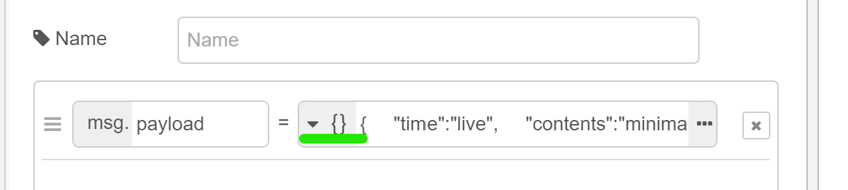

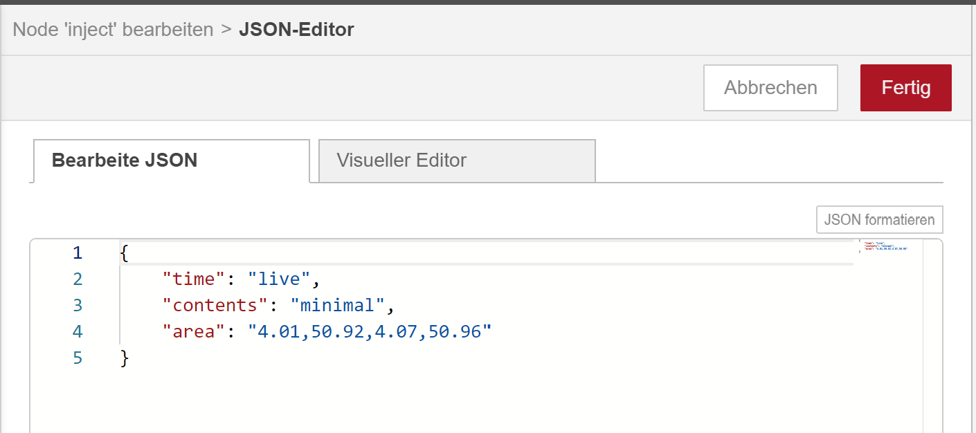

                Da stehgt ja auch wie Du ein Gebiet eingeben musst.
                Um ein JSON mit POST und die Methode ändern mit zugeben - musst das den JSON in die Inject Node in die payload schreiben:
                und auf Objekt stellen.

                      @beowolf Na Du kannst wie ich den JSON rauskopieren und in die Inject Node kopieren.
                          "time":"live",
                          "contents":"minimal",
                          "area":"4.01,50.92,4.07,50.96"

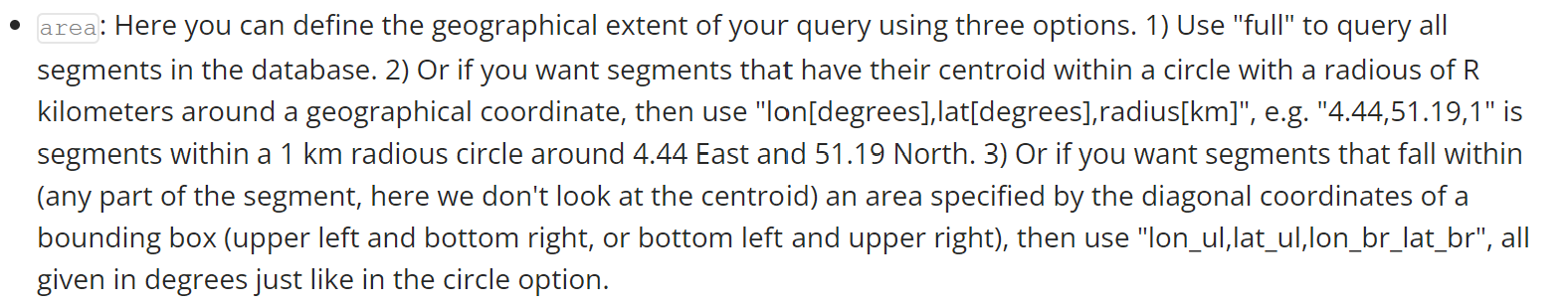

                      Aber unten als Beispiel gibts Du das Gebiet wie folgt an:
                      Längengrad, Breitgrad, Radius in km. Ansonsten ist ein Gebiet halt rechteckig und Du musst halt die gegenüberliegenden Ecken in Längen und Breitengrad angeben.

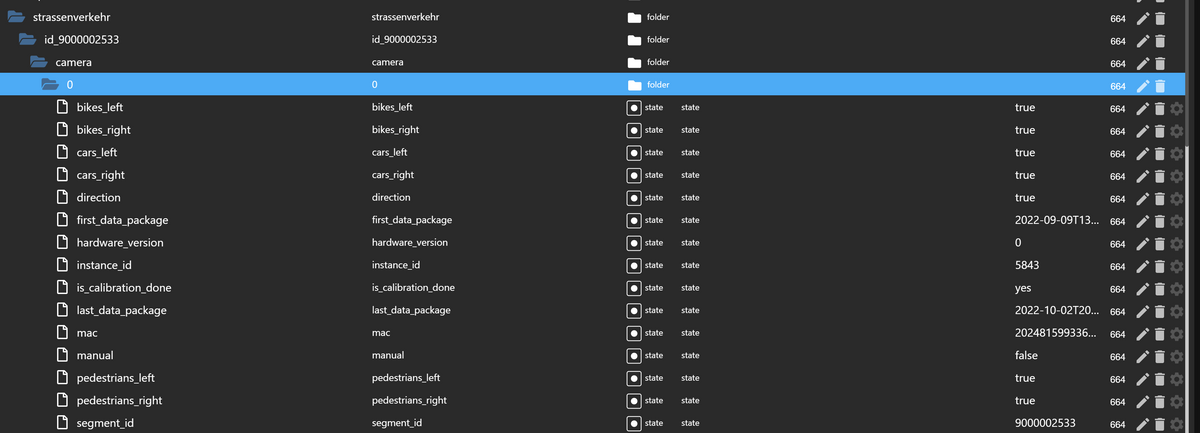

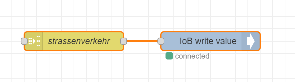

                          @beowolf Gut ich habe den Punkt jetzt Stassenverkehr genannt, der dann unter 0_userdata.0 erstellt wird.

                                @beowolf Also Du musst halt die API genauer lesen. Ein snapshot gibts kein time_start und time_end. Da musst lesen was bei time und live drin steht. Ansonsten kann man eine Zeitvorgeben.
                                Ansonsten darf man halt nicht den snapshot nehmen. Sondern halt nur traffic - dann kann man den Zeitraum exakt eingeben oder ende ist offen vom Start weg.

                                      Habe das mit dem snapshot falsch hier ins Forum kopiert. Ist geändert.
                                      Als Rückgabe kommt das.
                                      {"segment_id":9000002533,"last_data_package":"2022-10-03 20:47:51.149100+00:00","timezone":"Europe/Berlin","date":"2022-10-03 19:00:00+00:00","period":"hourly","uptime":0,"heavy":0,"car":0,"bike":0,"pedestrian":0}

                                      @beowolf Wie gesagt - das musst halt ausprobieren - ich kann auch nur die Beschreibung zum normalen Traffic Aufruf lesen:
                                      Ist doch in dem JSON
                                      data-raw '{
                                        "level": "segments",
                                        "format": "per-hour",
                                        "id": "348917",
                                        "time_start": "2020-10-30 07:00:00Z",
                                        "time_end": "2020-10-30 09:00:00Z"
                                      • B Beowolf
                                        @mickym sagte in Straßenverkehr - Zählen des Verkehrsaufkommen - Adapter?:
                                        Wenn ich traffic nehme, und einen Zeitraum eintrage (z.B. von 7 - 18 Uhr), erscheinen im ioBroker die Daten für jede Stunde einzeln, also für 11 Stunden.

                                        Steht ja auch so in der API
                                        format: can only be "hourly", resulting in hourly aggregated traffic

                                          Ich hatte das auch so gelesen.
                                          Deshalb hatte ich geschrieben, das das was ich wollte die API nicht direkt zur Verfügung stellt.
