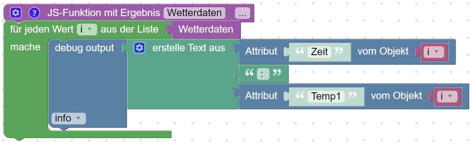

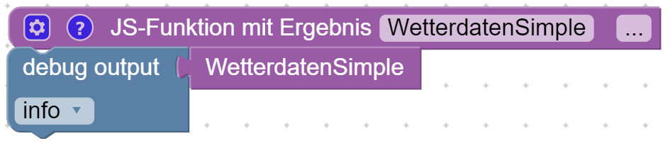

      fastfoot
      @iobaer Zwei Versionen, eine welche dir nur das HTML liefert, die andere baut aus dem Html eine JSON, dafür musst du aber in der JS-Instanz cheerio installieren. Die zweite Tabelle(Summen) wird hier aber nicht behandelt, das kannst du selbst rauspfriemeln :-)
       <block type="procedures_defcustomreturn" id="~!MZMJ@vtEc+NEYf.fqu" x="63" y="38">
         <mutation statements="false"></mutation>
         <field name="NAME">WetterdatenSimple</field>
         <field name="SCRIPT">Ly8gQWdyYXJtZXRlb3JvbG9naWUgUmhlaW5sYW5kLVBmYWx6DQpsZXQgdXJsPSdodHRwczovL2Rsci13ZWItZGF0ZW4xLmFzcGRpZW5zdGUuZGUvY2dpLWJpbi93ZXR0ZXIubWluNS5wbCc7DQpsZXQgYm9keT0iYz05ICZzaWQ9MyZ0PTEsMiw2LDksNyw4JmhoPTEiOw0KbGV0IHJlcyA9ICdGZWhsZXIhJzsNCmxldCBvcHRzID0gew0KICAgIHVybCwNCiAgICBoZWFkZXJzOiB7DQogICAgICAgICdDb250ZW50LVR5cGUnOiAnYXBwbGljYXRpb24veC13d3ctZm9ybS11cmxlbmNvZGVkJywNCiAgICAgICAgJ1VzZXItQWdlbnQnOidpb2Jyb2tlci1zY3JpcHQnDQogICAgfSwNCiAgICBib2R5OmJvZHkNCn0NCg0KcmVxdWVzdC5wb3N0KG9wdHMsKGVycixyZXNwLGJvZHkpPT57DQogICAgLy9sb2coYm9keSk7DQogICAgcmVzID0gYm9keTsNCn0pDQphd2FpdCB3YWl0KDEwMDApOw0KcmV0dXJuIHJlczs=</field>
       </block>
       <block type="debug" id="F3-LvtSOvx@ilObd9)Gy" x="62" y="63">
         <value name="TEXT">
           <shadow type="text" id=":|L#U,)-6m=bkgWD8Cih">
           </shadow>
           <block type="procedures_callcustomreturn" id="{xxO[8LgjzyF{o*w-vLZ">
             <mutation name="WetterdatenSimple"></mutation>
           </block>
         </value>
       </block>
      </xml>
         <field name="NAME">Wetterdaten</field>
         <field name="SCRIPT">Ly8gQWdyYXJtZXRlb3JvbG9naWUgUmhlaW5sYW5kLVBmYWx6DQpjb25zdCBjaGVlcmlvID0gcmVxdWlyZSgnY2hlZXJpbycpOw0KbGV0IHJlcyA9IFtdOw0KbGV0IHVybD0naHR0cHM6Ly9kbHItd2ViLWRhdGVuMS5hc3BkaWVuc3RlLmRlL2NnaS1iaW4vd2V0dGVyLm1pbjUucGwnOw0KbGV0IGJvZHk9ImM9OSAmc2lkPTMmdD0xLDIsNiw5LDcsOCZoaD0xIjsNCmxldCBvcHRzID0gew0KICAgIHVybCwNCiAgICBoZWFkZXJzOiB7DQogICAgICAgICdDb250ZW50LVR5cGUnOiAnYXBwbGljYXRpb24veC13d3ctZm9ybS11cmxlbmNvZGVkJywNCiAgICAgICAgJ1VzZXItQWdlbnQnOidpb2Jyb2tlcicNCiAgICB9LA0KICAgIGJvZHk6Ym9keQ0KfQ0KbGV0IGNvbHM9WyJEYXR1bSIsIlplaXQiLCJUZW1wMSIsIlRlbXAyIiwiTHVmdGZldWNodGUiLCJXaW5kIiwiQmxhdHRuYWVzc2UiLCJOaWVkZXJzY2hsYWciLCJaZWl0Il0NCmNvbnN0IG1hcFJvd3MgPSAoXywgcm93KSA9PiB7DQoJY29uc3QgZGF0YSA9IHt9Ow0KCWNoZWVyaW8ocm93KS5jaGlsZHJlbigndGQnKS5lYWNoKChpbmRleCwgY2VsbCkgPT4gew0KCQljZWxsID0gY2hlZXJpby5sb2FkKGNlbGwpOw0KCQlzd2l0Y2ggKGluZGV4KSB7DQoJCQljYXNlIDA6IHsNCgkJCQlkYXRhW2NvbHNbaW5kZXhdXSA9IGNlbGwudGV4dCgpOw0KCQkJCWJyZWFrOw0KCQkJfQ0KCQkJZGVmYXVsdDogew0KCQkJCWRhdGFbY29sc1tpbmRleF1dID0gY2VsbC50ZXh0KCk7DQoJCQl9DQoJCX0NCgl9KTsNCgljaGVlcmlvKHJvdykuY2hpbGRyZW4oJ3RoJykuZWFjaCgoaW5kZXgsIGNlbGwpID0+IHsNCgkJY2VsbCA9IGNoZWVyaW8ubG9hZChjZWxsKTsNCgkJc3dpdGNoIChpbmRleCkgew0KCQkJY2FzZSAwOiB7DQoJCQkJZGF0YVtjb2xzW2luZGV4XV0gPSBjZWxsLnRleHQoKTsNCgkJCQlicmVhazsNCgkJCX0NCgkJCWRlZmF1bHQ6IHsNCgkJCQlkYXRhW2NvbHNbaW5kZXhdXSA9IGNlbGwudGV4dCgpOw0KCQkJfQ0KCQl9DQoJfSk7DQoJcmV0dXJuIGRhdGE7DQp9Ow0KDQpyZXF1ZXN0LnBvc3Qob3B0cywoZXJyLHJlc3AsYm9keSk9PnsNCiAgICBsZXQgRGF0dW07DQogICAgbGV0IGh0bWwgPSBjaGVlcmlvLmxvYWQoYm9keSk7DQogICAgbGV0IGRhdGEgPSBodG1sKGB0YWJsZS5hbWApLmNoaWxkcmVuKCd0Ym9keTpmaXJzdC1vZi10eXBlJykuY2hpbGRyZW4oJ3RyJykubWFwKG1hcFJvd3MpLmdldCgpOw0KICAgIGRhdGEuZm9yRWFjaCgocm93LGlkeCk9PnsNCiAgICAgICAgaWYoaWR4PT0wKSBEYXR1bT1yb3cuRGF0dW07DQogICAgICAgIHJlcy5wdXNoKHsNCiAgICAgICAgICAgIE5yOmlkeCwNCiAgICAgICAgICAgIERhdHVtOkRhdHVtLA0KICAgICAgICAgICAgWmVpdDpyb3cuWmVpdCwNCiAgICAgICAgICAgIFRlbXAxOnJvdy5UZW1wMSwNCiAgICAgICAgICAgIFRlbXAyOnJvdy5UZW1wMiwNCiAgICAgICAgICAgIEx1ZnRmZXVjaHRlOnJvdy5MdWZ0ZmV1Y2h0ZSwNCiAgICAgICAgICAgIFdpbmQ6cm93LldpbmQsDQogICAgICAgICAgICBCbGF0dG5hZXNzZTpyb3cuQmxhdHRuYWVzc2UsDQogICAgICAgICAgICBOaWVkZXJzY2hsYWc6cm93Lk5pZWRlcnNjaGxhZw0KICAgICAgICB9KQ0KICAgIH0pDQogICAgLy9sb2coSlNPTi5zdHJpbmdpZnkocmVzWzVdKSk7DQp9KQ0KYXdhaXQgd2FpdCgxMDAwKTsNCnJldHVybiByZXM7</field>
       </block>
       <block type="controls_forEach" id="%pUBh.E%7$:YK7IzoS_Y" x="63" y="62">
         <field name="VAR" id="IPnS@P,KgBomXU1$aJ.w">i</field>
         <value name="LIST">
             <mutation name="Wetterdaten"></mutation>
           </block>
         </value>
         <statement name="DO">
           <block type="debug" id="F3-LvtSOvx@ilObd9)Gy">
             <value name="TEXT">
               </shadow>
               <block type="text_join" id=":6Po8q:-}L#*:Npknd(+">
                 <value name="ADD0">
                   <block type="get_attr" id="pX;7:[_TLXHvur:}]`=q">
                     <value name="PATH">
                       <shadow type="text" id="w.*t3,(!E%e0sJ$^71:m">
                         <field name="TEXT">Zeit</field>
                       </shadow>
                     </value>
                     <value name="OBJECT">
                       <block type="variables_get" id="}8r[tYcC/dk6EImj)cTs">
                       </block>
                     </value>
                   </block>
                 </value>
                 <value name="ADD1">
                   <block type="text" id="HF?}sO%jIdxBe*~j@58R">
                     <field name="TEXT">: </field>
                   </block>
                 </value>
                 <value name="ADD2">
                   <block type="get_attr" id="XGdf`5jOIJ^qa$McWtRT">
                     <value name="PATH">
                       <shadow type="text" id="y-w!W53_YB;*nw8~4HBE">
                         <field name="TEXT">Temp1</field>
                       </shadow>
                     </value>
                       <block type="variables_get" id="=-@#f!e`8t*)8c{r8O=o">
                       </block>
                     </value>
                   </block>
                 </value>
               </block>
             </value>
           </block>
         </statement>
       </block>
      </xml>
