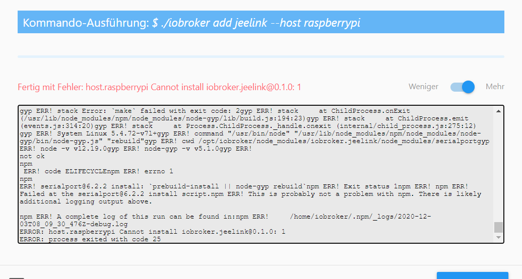

      Guten Morgen an alle,
      habe mir wie im einen Außentemperatursender gekauft von techno line. Möchte diese in meiner Vis einbinden. Sobald ich den Adapter "Jeelink-Adapter" installieren möchte bekomme ich folgende Fehlermeldung:
      $ ./iobroker add jeelink  --host raspberrypi
      NPM version: 6.14.8
      npm install iobroker.jeelink@0.1.0 --loglevel error --prefix "/opt/iobroker" (System call)
      ../src/serialport.cpp: In function ‘Nan::NAN_METHOD_RETURN_TYPE Open(Nan::NAN_METHOD_ARGS_TYPE)’:../src/serialport.cpp:41:48: error: no matching function for call to ‘v8::Value::ToString()’   v8::String::Utf8Value path(info[0]->ToString());                                                ^In file included from /home/iobroker/.cache/node-gyp/12.19.0/include/node/node.h:67,                 from ../../../../nan/nan.h:56,                 from ../src/./serialport.h:6,                 from ../src/serialport.cpp:1:/home/iobroker/.cache/node-gyp/12.19.0/include/node/v8.h:2668:44: note: candidate: ‘v8::MaybeLocal<v8::String> v8::Value::ToString(v8::Local<v8::Context>) const’   V8_WARN_UNUSED_RESULT MaybeLocal<String> ToString(                                            ^~~~~~~~/home/iobroker/.cache/node-gyp/12.19.0/include/node/v8.h:2668:44: note:   candidate expects 1 argument, 0 providedIn file included from /home/iobroker/.cache/node-gyp/12.19.0/include/node/v8-internal.h:14,                 from /home/iobroker/.cache/node-gyp/12.19.0/include/node/v8.h:27,                 from /home/iobroker/.cache/node-gyp/12.19.0/include/node/node.h:67,                 from ../../../../nan/nan.h:56,                 from ../src/./serialport.h:6,                 from ../src/serialport.cpp:1:/home/iobroker/.cache/node-gyp/12.19.0/include/node/v8.h:2684:31: note: candidate: ‘v8::Local<v8::String> v8::Value::ToString(v8::Isolate*) const’                 Local<String> ToString(Isolate* isolate) const);                               ^~~~~~~~/home/iobroker/.cache/node-gyp/12.19.0/include/node/v8config.h:328:3: note: in definition of macro ‘V8_DEPRECATED’   declarator __attribute__((deprecated(message)))   ^~~~~~~~~~/home/iobroker/.cache/node-gyp/12.19.0/include/node/v8.h:2684:31: note:   candidate expects 1 argument, 0 provided                 Local<String> ToString(Isolate* isolate) const);                               ^~~~~~~~/home/iobroker/.cache/node-gyp/12.19.0/include/node/v8config.h:328:3: note: in definition of macro ‘V8_DEPRECATED’   declarator __attribute__((deprecated(message)))   ^~~~~~~~~~../src/serialport.cpp:48:53: error: no matching function for call to ‘v8::Value::ToObject()’   v8::Local<v8::Object> options = info[1]->ToObject();                                                     ^In file included from /home/iobroker/.cache/node-gyp/12.19.0/include/node/node.h:67,                 from ../../../../nan/nan.h:56,                 from ../src/./serialport.h:6,                 from ../src/serialport.cpp:1:/home/iobroker/.cache/node-gyp/12.19.0/include/node/v8.h:2672:44: note: candidate: ‘v8::MaybeLocal<v8::Object> v8::Value::ToObject(v8::Local<v8::Context>) const’   V8_WARN_UNUSED_RESULT MaybeLocal<Object> ToObject(                                            ^~~~~~~~/home/iobroker/.cache/node-gyp/12.19.0/include/node/v8.h:2672:44: note:   candidate expects 1 argument, 0 providedIn file included from /home/iobroker/.cache/node-gyp/12.19.0/include/node/v8-internal.h:14,                 from /home/iobroker/.cache/node-gyp/12.19.0/include/node/v8.h:27,                 from /home/iobroker/.cache/node-gyp/12.19.0/include/node/node.h:67,                 from ../../../../nan/nan.h:56,                 from ../src/./serialport.h:6,                 from ../src/serialport.cpp:1:/home/iobroker/.cache/node-gyp/12.19.0/include/node/v8.h:2686:31: note: candidate: ‘v8::Local<v8::Object> v8::Value::ToObject(v8::Isolate*) const’                 Local<Object> ToObject(Isolate* isolate) const);                               ^~~~~~~~/home/iobroker/.cache/node-gyp/12.19.0/include/node/v8config.h:328:3: note: in definition of macro ‘V8_DEPRECATED’   declarator __attribute__((deprecated(message)))   ^~~~~~~~~~/home/iobroker/.cache/node-gyp/12.19.0/include/node/v8.h:2686:31: note:   candidate expects 1 argument, 0 provided                 Local<Object> ToObject(Isolate* isolate) const);                               ^~~~~~~~/home/iobroker/.cache/node-gyp/12.19.0/include/node/v8config.h:328:3: note: in definition of macro ‘V8_DEPRECATED’   declarator __attribute__((deprecated(message)))   ^~~~~~~~~~
      ../src/serialport.cpp:78:69: warning: cast between incompatible function types from ‘void (*)(uv_work_t*)’ {aka ‘void (*)(uv_work_s*)’} to ‘uv_after_work_cb’ {aka ‘void (*)(uv_work_s*, int)’} [-Wcast-function-type]   uv_queue_work(uv_default_loop(), req, EIO_Open, (uv_after_work_cb)EIO_AfterOpen);                                                                     ^~~~~~~~~~~~~
      ../src/serialport.cpp: In function ‘void EIO_AfterOpen(uv_work_t*)’:../src/serialport.cpp:95:30: warning: ‘v8::Local<v8::Value> Nan::Callback::Call(int, v8::Local<v8::Value>*) const’ is deprecated [-Wdeprecated-declarations]   data->callback.Call(2, argv);                              ^In file included from ../src/./serialport.h:6,                 from ../src/serialport.cpp:1:../../../../nan/nan.h:1742:3: note: declared here   Call(int argc, v8::Local<v8::Value> argv[]) const {   ^~~~
      ../src/serialport.cpp: In function ‘Nan::NAN_METHOD_RETURN_TYPE Update(Nan::NAN_METHOD_ARGS_TYPE)’:../src/serialport.cpp:113:53: error: no matching function for call to ‘v8::Value::ToObject()’   v8::Local<v8::Object> options = info[1]->ToObject();                                                     ^In file included from /home/iobroker/.cache/node-gyp/12.19.0/include/node/node.h:67,                 from ../../../../nan/nan.h:56,                 from ../src/./serialport.h:6,                 from ../src/serialport.cpp:1:/home/iobroker/.cache/node-gyp/12.19.0/include/node/v8.h:2672:44: note: candidate: ‘v8::MaybeLocal<v8::Object> v8::Value::ToObject(v8::Local<v8::Context>) const’   V8_WARN_UNUSED_RESULT MaybeLocal<Object> ToObject(                                            ^~~~~~~~/home/iobroker/.cache/node-gyp/12.19.0/include/node/v8.h:2672:44: note:   candidate expects 1 argument, 0 providedIn file included from /home/iobroker/.cache/node-gyp/12.19.0/include/node/v8-internal.h:14,                 from /home/iobroker/.cache/node-gyp/12.19.0/include/node/v8.h:27,                 from /home/iobroker/.cache/node-gyp/12.19.0/include/node/node.h:67,                 from ../../../../nan/nan.h:56,                 from ../src/./serialport.h:6,                 from ../src/serialport.cpp:1:/home/iobroker/.cache/node-gyp/12.19.0/include/node/v8.h:2686:31: note: candidate: ‘v8::Local<v8::Object> v8::Value::ToObject(v8::Isolate*) const’                 Local<Object> ToObject(Isolate* isolate) const);                               ^~~~~~~~/home/iobroker/.cache/node-gyp/12.19.0/include/node/v8config.h:328:3: note: in definition of macro ‘V8_DEPRECATED’   declarator __attribute__((deprecated(message)))   ^~~~~~~~~~/home/iobroker/.cache/node-gyp/12.19.0/include/node/v8.h:2686:31: note:   candidate expects 1 argument, 0 provided                 Local<Object> ToObject(Isolate* isolate) const);                               ^~~~~~~~/home/iobroker/.cache/node-gyp/12.19.0/include/node/v8config.h:328:3: note: in definition of macro ‘V8_DEPRECATED’   declarator __attribute__((deprecated(message)))   ^~~~~~~~~~
      ../src/serialport.cpp:135:71: warning: cast between incompatible function types from ‘void (*)(uv_work_t*)’ {aka ‘void (*)(uv_work_s*)’} to ‘uv_after_work_cb’ {aka ‘void (*)(uv_work_s*, int)’} [-Wcast-function-type]   uv_queue_work(uv_default_loop(), req, EIO_Update, (uv_after_work_cb)EIO_AfterUpdate);                                                                       ^~~~~~~~~~~~~~~
      ../src/serialport.cpp: In function ‘void EIO_AfterUpdate(uv_work_t*)’:../src/serialport.cpp:150:30: warning: ‘v8::Local<v8::Value> Nan::Callback::Call(int, v8::Local<v8::Value>*) const’ is deprecated [-Wdeprecated-declarations]   data->callback.Call(1, argv);                              ^In file included from ../src/./serialport.h:6,                 from ../src/serialport.cpp:1:../../../../nan/nan.h:1742:3: note: declared here   Call(int argc, v8::Local<v8::Value> argv[]) const {   ^~~~
      ../src/serialport.cpp: In function ‘Nan::NAN_METHOD_RETURN_TYPE Close(Nan::NAN_METHOD_ARGS_TYPE)’:../src/serialport.cpp:175:70: warning: cast between incompatible function types from ‘void (*)(uv_work_t*)’ {aka ‘void (*)(uv_work_s*)’} to ‘uv_after_work_cb’ {aka ‘void (*)(uv_work_s*, int)’} [-Wcast-function-type]   uv_queue_work(uv_default_loop(), req, EIO_Close, (uv_after_work_cb)EIO_AfterClose);                                                                      ^~~~~~~~~~~~~~
      ../src/serialport.cpp: In function ‘void EIO_AfterClose(uv_work_t*)’:../src/serialport.cpp:188:30: warning: ‘v8::Local<v8::Value> Nan::Callback::Call(int, v8::Local<v8::Value>*) const’ is deprecated [-Wdeprecated-declarations]   data->callback.Call(1, argv);                              ^In file included from ../src/./serialport.h:6,                 from ../src/serialport.cpp:1:../../../../nan/nan.h:1742:3: note: declared here   Call(int argc, v8::Local<v8::Value> argv[]) const {   ^~~~
      ../src/serialport.cpp: In function ‘Nan::NAN_METHOD_RETURN_TYPE Flush(Nan::NAN_METHOD_ARGS_TYPE)’:../src/serialport.cpp:215:70: warning: cast between incompatible function types from ‘void (*)(uv_work_t*)’ {aka ‘void (*)(uv_work_s*)’} to ‘uv_after_work_cb’ {aka ‘void (*)(uv_work_s*, int)’} [-Wcast-function-type]   uv_queue_work(uv_default_loop(), req, EIO_Flush, (uv_after_work_cb)EIO_AfterFlush);                                                                      ^~~~~~~~~~~~~~
      ../src/serialport.cpp: In function ‘void EIO_AfterFlush(uv_work_t*)’:../src/serialport.cpp:231:30: warning: ‘v8::Local<v8::Value> Nan::Callback::Call(int, v8::Local<v8::Value>*) const’ is deprecated [-Wdeprecated-declarations]   data->callback.Call(1, argv);                              ^In file included from ../src/./serialport.h:6,                 from ../src/serialport.cpp:1:../../../../nan/nan.h:1742:3: note: declared here   Call(int argc, v8::Local<v8::Value> argv[]) const {   ^~~~
      ../src/serialport.cpp: In function ‘Nan::NAN_METHOD_RETURN_TYPE Set(Nan::NAN_METHOD_ARGS_TYPE)’:../src/serialport.cpp:250:53: error: no matching function for call to ‘v8::Value::ToObject()’   v8::Local<v8::Object> options = info[1]->ToObject();                                                     ^In file included from /home/iobroker/.cache/node-gyp/12.19.0/include/node/node.h:67,                 from ../../../../nan/nan.h:56,                 from ../src/./serialport.h:6,                 from ../src/serialport.cpp:1:/home/iobroker/.cache/node-gyp/12.19.0/include/node/v8.h:2672:44: note: candidate: ‘v8::MaybeLocal<v8::Object> v8::Value::ToObject(v8::Local<v8::Context>) const’   V8_WARN_UNUSED_RESULT MaybeLocal<Object> ToObject(                                            ^~~~~~~~/home/iobroker/.cache/node-gyp/12.19.0/include/node/v8.h:2672:44: note:   candidate expects 1 argument, 0 providedIn file included from /home/iobroker/.cache/node-gyp/12.19.0/include/node/v8-internal.h:14,                 from /home/iobroker/.cache/node-gyp/12.19.0/include/node/v8.h:27,                 from /home/iobroker/.cache/node-gyp/12.19.0/include/node/node.h:67,                 from ../../../../nan/nan.h:56,                 from ../src/./serialport.h:6,                 from ../src/serialport.cpp:1:/home/iobroker/.cache/node-gyp/12.19.0/include/node/v8.h:2686:31: note: candidate: ‘v8::Local<v8::Object> v8::Value::ToObject(v8::Isolate*) const’                 Local<Object> ToObject(Isolate* isolate) const);                               ^~~~~~~~/home/iobroker/.cache/node-gyp/12.19.0/include/node/v8config.h:328:3: note: in definition of macro ‘V8_DEPRECATED’   declarator __attribute__((deprecated(message)))   ^~~~~~~~~~/home/iobroker/.cache/node-gyp/12.19.0/include/node/v8.h:2686:31: note:   candidate expects 1 argument, 0 provided                 Local<Object> ToObject(Isolate* isolate) const);                               ^~~~~~~~/home/iobroker/.cache/node-gyp/12.19.0/include/node/v8config.h:328:3: note: in definition of macro ‘V8_DEPRECATED’   declarator __attribute__((deprecated(message)))   ^~~~~~~~~~
      ../src/serialport.cpp:270:68: warning: cast between incompatible function types from ‘void (*)(uv_work_t*)’ {aka ‘void (*)(uv_work_s*)’} to ‘uv_after_work_cb’ {aka ‘void (*)(uv_work_s*, int)’} [-Wcast-function-type]   uv_queue_work(uv_default_loop(), req, EIO_Set, (uv_after_work_cb)EIO_AfterSet);                                                                    ^~~~~~~~~~~~
      ../src/serialport.cpp: In function ‘void EIO_AfterSet(uv_work_t*)’:../src/serialport.cpp:285:30: warning: ‘v8::Local<v8::Value> Nan::Callback::Call(int, v8::Local<v8::Value>*) const’ is deprecated [-Wdeprecated-declarations]   data->callback.Call(1, argv);                              ^In file included from ../src/./serialport.h:6,                 from ../src/serialport.cpp:1:../../../../nan/nan.h:1742:3: note: declared here   Call(int argc, v8::Local<v8::Value> argv[]) const {   ^~~~
      ../src/serialport.cpp: In function ‘Nan::NAN_METHOD_RETURN_TYPE Get(Nan::NAN_METHOD_ARGS_TYPE)’:../src/serialport.cpp:314:68: warning: cast between incompatible function types from ‘void (*)(uv_work_t*)’ {aka ‘void (*)(uv_work_s*)’} to ‘uv_after_work_cb’ {aka ‘void (*)(uv_work_s*, int)’} [-Wcast-function-type]   uv_queue_work(uv_default_loop(), req, EIO_Get, (uv_after_work_cb)EIO_AfterGet);                                                                    ^~~~~~~~~~~~
      ../src/serialport.cpp: In function ‘void EIO_AfterGet(uv_work_t*)’:../src/serialport.cpp:329:96: warning: ‘bool v8::Object::Set(v8::Local<v8::Value>, v8::Local<v8::Value>)’ is deprecated: Use maybe version [-Wdeprecated-declarations]     results->Set(Nan::New<v8::String>("cts").ToLocalChecked(), Nan::New<v8::Boolean>(data->cts));                                                                                                ^In file included from /home/iobroker/.cache/node-gyp/12.19.0/include/node/v8-internal.h:14,                 from /home/iobroker/.cache/node-gyp/12.19.0/include/node/v8.h:27,                 from /home/iobroker/.cache/node-gyp/12.19.0/include/node/node.h:67,                 from ../../../../nan/nan.h:56,                 from ../src/./serialport.h:6,                 from ../src/serialport.cpp:1:/home/iobroker/.cache/node-gyp/12.19.0/include/node/v8.h:3499:22: note: declared here                 bool Set(Local<Value> key, Local<Value> value));                      ^~~/home/iobroker/.cache/node-gyp/12.19.0/include/node/v8config.h:328:3: note: in definition of macro ‘V8_DEPRECATED’   declarator __attribute__((deprecated(message)))   ^~~~~~~~~~
      ../src/serialport.cpp:330:96: warning: ‘bool v8::Object::Set(v8::Local<v8::Value>, v8::Local<v8::Value>)’ is deprecated: Use maybe version [-Wdeprecated-declarations]     results->Set(Nan::New<v8::String>("dsr").ToLocalChecked(), Nan::New<v8::Boolean>(data->dsr));                                                                                                ^In file included from /home/iobroker/.cache/node-gyp/12.19.0/include/node/v8-internal.h:14,                 from /home/iobroker/.cache/node-gyp/12.19.0/include/node/v8.h:27,                 from /home/iobroker/.cache/node-gyp/12.19.0/include/node/node.h:67,                 from ../../../../nan/nan.h:56,                 from ../src/./serialport.h:6,                 from ../src/serialport.cpp:1:/home/iobroker/.cache/node-gyp/12.19.0/include/node/v8.h:3499:22: note: declared here                 bool Set(Local<Value> key, Local<Value> value));                      ^~~/home/iobroker/.cache/node-gyp/12.19.0/include/node/v8config.h:328:3: note: in definition of macro ‘V8_DEPRECATED’   declarator __attribute__((deprecated(message)))   ^~~~~~~~~~../src/serialport.cpp:331:96: warning: ‘bool v8::Object::Set(v8::Local<v8::Value>, v8::Local<v8::Value>)’ is deprecated: Use maybe version [-Wdeprecated-declarations]     results->Set(Nan::New<v8::String>("dcd").ToLocalChecked(), Nan::New<v8::Boolean>(data->dcd));                                                                                                ^In file included from /home/iobroker/.cache/node-gyp/12.19.0/include/node/v8-internal.h:14,                 from /home/iobroker/.cache/node-gyp/12.19.0/include/node/v8.h:27,                 from /home/iobroker/.cache/node-gyp/12.19.0/include/node/node.h:67,                 from ../../../../nan/nan.h:56,                 from ../src/./serialport.h:6,                 from ../src/serialport.cpp:1:/home/iobroker/.cache/node-gyp/12.19.0/include/node/v8.h:3499:22: note: declared here                 bool Set(Local<Value> key, Local<Value> value));                      ^~~/home/iobroker/.cache/node-gyp/12.19.0/include/node/v8config.h:328:3: note: in definition of macro ‘V8_DEPRECATED’   declarator __attribute__((deprecated(message)))   ^~~~~~~~~~../src/serialport.cpp:336:30: warning: ‘v8::Local<v8::Value> Nan::Callback::Call(int, v8::Local<v8::Value>*) const’ is deprecated [-Wdeprecated-declarations]   data->callback.Call(2, argv);                              ^In file included from ../src/./serialport.h:6,                 from ../src/serialport.cpp:1:../../../../nan/nan.h:1742:3: note: declared here   Call(int argc, v8::Local<v8::Value> argv[]) const {   ^~~~
      ../src/serialport.cpp: In function ‘Nan::NAN_METHOD_RETURN_TYPE GetBaudRate(Nan::NAN_METHOD_ARGS_TYPE)’:../src/serialport.cpp:363:76: warning: cast between incompatible function types from ‘void (*)(uv_work_t*)’ {aka ‘void (*)(uv_work_s*)’} to ‘uv_after_work_cb’ {aka ‘void (*)(uv_work_s*, int)’} [-Wcast-function-type]   uv_queue_work(uv_default_loop(), req, EIO_GetBaudRate, (uv_after_work_cb)EIO_AfterGetBaudRate);                                                                            ^~~~~~~~~~~~~~~~~~~~
      ../src/serialport.cpp: In function ‘void EIO_AfterGetBaudRate(uv_work_t*)’:../src/serialport.cpp:378:106: warning: ‘bool v8::Object::Set(v8::Local<v8::Value>, v8::Local<v8::Value>)’ is deprecated: Use maybe version [-Wdeprecated-declarations]     results->Set(Nan::New<v8::String>("baudRate").ToLocalChecked(), Nan::New<v8::Integer>(data->baudRate));                                                                                                          ^In file included from /home/iobroker/.cache/node-gyp/12.19.0/include/node/v8-internal.h:14,                 from /home/iobroker/.cache/node-gyp/12.19.0/include/node/v8.h:27,                 from /home/iobroker/.cache/node-gyp/12.19.0/include/node/node.h:67,                 from ../../../../nan/nan.h:56,                 from ../src/./serialport.h:6,                 from ../src/serialport.cpp:1:/home/iobroker/.cache/node-gyp/12.19.0/include/node/v8.h:3499:22: note: declared here                 bool Set(Local<Value> key, Local<Value> value));                      ^~~/home/iobroker/.cache/node-gyp/12.19.0/include/node/v8config.h:328:3: note: in definition of macro ‘V8_DEPRECATED’   declarator __attribute__((deprecated(message)))   ^~~~~~~~~~../src/serialport.cpp:383:30: warning: ‘v8::Local<v8::Value> Nan::Callback::Call(int, v8::Local<v8::Value>*) const’ is deprecated [-Wdeprecated-declarations]   data->callback.Call(2, argv);                              ^In file included from ../src/./serialport.h:6,                 from ../src/serialport.cpp:1:../../../../nan/nan.h:1742:3: note: declared here   Call(int argc, v8::Local<v8::Value> argv[]) const {   ^~~~
      ../src/serialport.cpp: In function ‘Nan::NAN_METHOD_RETURN_TYPE Drain(Nan::NAN_METHOD_ARGS_TYPE)’:../src/serialport.cpp:409:70: warning: cast between incompatible function types from ‘void (*)(uv_work_t*)’ {aka ‘void (*)(uv_work_s*)’} to ‘uv_after_work_cb’ {aka ‘void (*)(uv_work_s*, int)’} [-Wcast-function-type]   uv_queue_work(uv_default_loop(), req, EIO_Drain, (uv_after_work_cb)EIO_AfterDrain);                                                                      ^~~~~~~~~~~~~~
      ../src/serialport.cpp: In function ‘void EIO_AfterDrain(uv_work_t*)’:../src/serialport.cpp:424:30: warning: ‘v8::Local<v8::Value> Nan::Callback::Call(int, v8::Local<v8::Value>*) const’ is deprecated [-Wdeprecated-declarations]   data->callback.Call(1, argv);                              ^In file included from ../src/./serialport.h:6,                 from ../src/serialport.cpp:1:../../../../nan/nan.h:1742:3: note: declared here   Call(int argc, v8::Local<v8::Value> argv[]) const {   ^~~~../src/serialport.cpp: At global scope:../src/serialport.cpp:430:28: warning: unnecessary parentheses in declaration of ‘ToParityEnum’ [-Wparentheses] SerialPortParity NAN_INLINE(ToParityEnum(const v8::Local<v8::String>& v8str)) {                            ^
      ../src/serialport.cpp:449:30: warning: unnecessary parentheses in declaration of ‘ToStopBitEnum’ [-Wparentheses] SerialPortStopBits NAN_INLINE(ToStopBitEnum(double stopBits)) {                              ^../src/serialport.cpp:460:17: error: variable or field ‘init’ declared void   void init(v8::Handle<v8::Object> target) {                 ^~~~~~../src/serialport.cpp:460:17: error: ‘Handle’ is not a member of ‘v8’
      ../src/serialport.cpp:460:34: error: expected primary-expression before ‘>’ token   void init(v8::Handle<v8::Object> target) {                                  ^../src/serialport.cpp:460:36: error: ‘target’ was not declared in this scope   void init(v8::Handle<v8::Object> target) {                                    ^~~~~~
      ../src/serialport.cpp:460:36: note: suggested alternative: ‘tzset’   void init(v8::Handle<v8::Object> target) {                                    ^~~~~~                                    tzsetIn file included from ../../../../nan/nan.h:56,                 from ../src/./serialport.h:6,                 from ../src/serialport.cpp:1:../src/serialport.cpp:485:25: error: ‘init’ was not declared in this scope NODE_MODULE(serialport, init);                         ^~~~/home/iobroker/.cache/node-gyp/12.19.0/include/node/node.h:727:36: note: in definition of macro ‘NODE_MODULE_X’       (node::addon_register_func) (regfunc),                          \                                    ^~~~~~~../src/serialport.cpp:485:1: note: in expansion of macro ‘NODE_MODULE’ NODE_MODULE(serialport, init); ^~~~~~~~~~~
      ../src/serialport.cpp:485:25: note: suggested alternative: ‘int’ NODE_MODULE(serialport, init);                         ^~~~/home/iobroker/.cache/node-gyp/12.19.0/include/node/node.h:727:36: note: in definition of macro ‘NODE_MODULE_X’       (node::addon_register_func) (regfunc),                          \                                    ^~~~~~~../src/serialport.cpp:485:1: note: in expansion of macro ‘NODE_MODULE’ NODE_MODULE(serialport, init); ^~~~~~~~~~~
      make: *** [serialport.target.mk:112: Release/obj.target/serialport/src/serialport.o] Fehler 1
      gyp
       ERR! build error
      gyp ERR! stack Error: `make` failed with exit code: 2gyp ERR! stack     at ChildProcess.onExit (/usr/lib/node_modules/npm/node_modules/node-gyp/lib/build.js:194:23)gyp ERR! stack     at ChildProcess.emit (events.js:314:20)gyp ERR! stack     at Process.ChildProcess._handle.onexit (internal/child_process.js:275:12)
      gyp ERR! System Linux 5.4.72-v7l+gyp ERR! command "/usr/bin/node" "/usr/lib/node_modules/npm/node_modules/node-gyp/bin/node-gyp.js" "rebuild"gyp ERR! cwd /opt/iobroker/node_modules/iobroker.jeelink/node_modules/serialportgyp ERR! node -v v12.19.0gyp ERR! node-gyp -v v5.1.0gyp ERR!
      not ok
      npm
       ERR! code ELIFECYCLEnpm ERR! errno 1
      npm
      ERR! serialport@6.2.2 install: `prebuild-install || node-gyp rebuild`npm ERR! Exit status 1npm ERR! npm ERR! Failed at the serialport@6.2.2 install script.npm ERR! This is probably not a problem with npm. There is likely additional logging output above.
      npm ERR! A complete log of this run can be found in:npm ERR!     /home/iobroker/.npm/_logs/2020-12-03T08_09_30_476Z-debug.log
      ERROR: host.raspberrypi Cannot install iobroker.jeelink@0.1.0: 1
      ERROR: process exited with code 25
      Jemand eine Idee?

        UncleSam Developer @atheos last edited by
        @atheos sagte in techno line Kabellose Fernübertragung der Außentemperatur.:
        Installationsart:
        Manuell
        Was heisst das? Hast du ioBroker nicht mit dem "Einzeiler" auf der Kommandozeile installiert?
        curl -sL https://iobroker.net/install.sh | bash -

          ah doch habs dann falsch verstanden. Ändere ich ab.
          Und kann man jetzt mit dem Code was anfangen oder brauch man da noch mehr Infos?
          UncleSam 1 Reply Last reply Reply Quote 1
          • UncleSam
            UncleSam Developer @atheos last edited by UncleSam
            @atheos OK, es scheint als würde der Autor neue Versionen nicht mehr auf NPM veröffentlichen. Dort ist die neuste Version 0.1.0. Es bleibt dir also nichts anderes übrig als die aktuellste Version (mit einer aktuellen Version von serialport) von GitHub zu installieren:
            https://github.com/foxthefox/ioBroker.jeelink/

              Perfekt das hat jetzt funktioniert. Vielen Dank dir. Jetzt muss ich den Techno Line TX 35-IT da irgendwie reinbringen.
              Dann mache ich auf der Vis Seite weiter wo ich bereits ein Topic dazu auf hab.
              Vielen Dank
