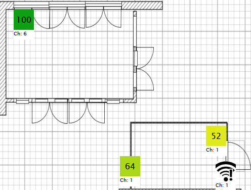

        @Crazy32 ich mach das so:
        [{"tpl":"tplJustgageValueColored","data":{"g_fixed":false,"g_visibility":true,"g_css_font_text":true,"g_css_background":false,"g_css_shadow_padding":false,"g_css_border":false,"g_gestures":false,"g_signals":false,"g_last_change":false,"visibility-cond":"==","visibility-val":1,"visibility-groups-action":"hide","is_tdp":false,"factor":"1","balance1":"30","balance2":"50","signals-cond-0":"==","signals-val-0":true,"signals-icon-0":"/vis/signals/lowbattery.png","signals-icon-size-0":0,"signals-blink-0":false,"signals-horz-0":0,"signals-vert-0":0,"signals-hide-edit-0":false,"signals-cond-1":"==","signals-val-1":true,"signals-icon-1":"/vis/signals/lowbattery.png","signals-icon-size-1":0,"signals-blink-1":false,"signals-horz-1":0,"signals-vert-1":0,"signals-hide-edit-1":false,"signals-cond-2":"==","signals-val-2":true,"signals-icon-2":"/vis/signals/lowbattery.png","signals-icon-size-2":0,"signals-blink-2":false,"signals-horz-2":0,"signals-vert-2":0,"signals-hide-edit-2":false,"lc-type":"last-change","lc-is-interval":true,"lc-is-moment":false,"lc-format":"","lc-position-vert":"top","lc-position-horz":"right","lc-offset-vert":0,"lc-offset-horz":0,"lc-font-size":"12px","lc-font-family":"","lc-font-style":"","lc-bkg-color":"","lc-color":"","lc-border-width":"0","lc-border-style":"","lc-border-color":"","lc-border-radius":10,"lc-zindex":0,"oid":"sonoff.0.BluRay.Wifi_RSSI","digits":"0","min_oid":"","mid_oid":"","max_oid":"","color1":"#ee1111","color2":"#e9ed1d","color3":"#0da012","changeBgColor":true,"is_comma":"true","visibility-oid":"sonoff.0.BluRay.alive"},"style":{"left":"943px","top":"540px","z-index":"3","width":"40px","height":"40px","color":"#000000","font-family":"\"Lucida Sans Unicode\", \"Lucida Grande\", sans-serif","text-align":"center"},"widgetSet":"justgage"}]
        die Sichtbarkeit steuere ich weil ich hinter dem Bild dann noch ein Symbol für kein WLAN habe, das sieht dann z.B. so aus in der VIS:
