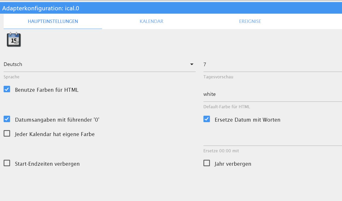

              Kannst du die Instanz mal stoppen, die ical Objekte löschen, dann Instanz wieder starten und davon das log (Bitte als Text in Code-Tags) posten und schauen ob die Objekte danach befüllt werden?
              Zusätzlich wäre ein Screenshot der Adapter Einstellung hilfreich.

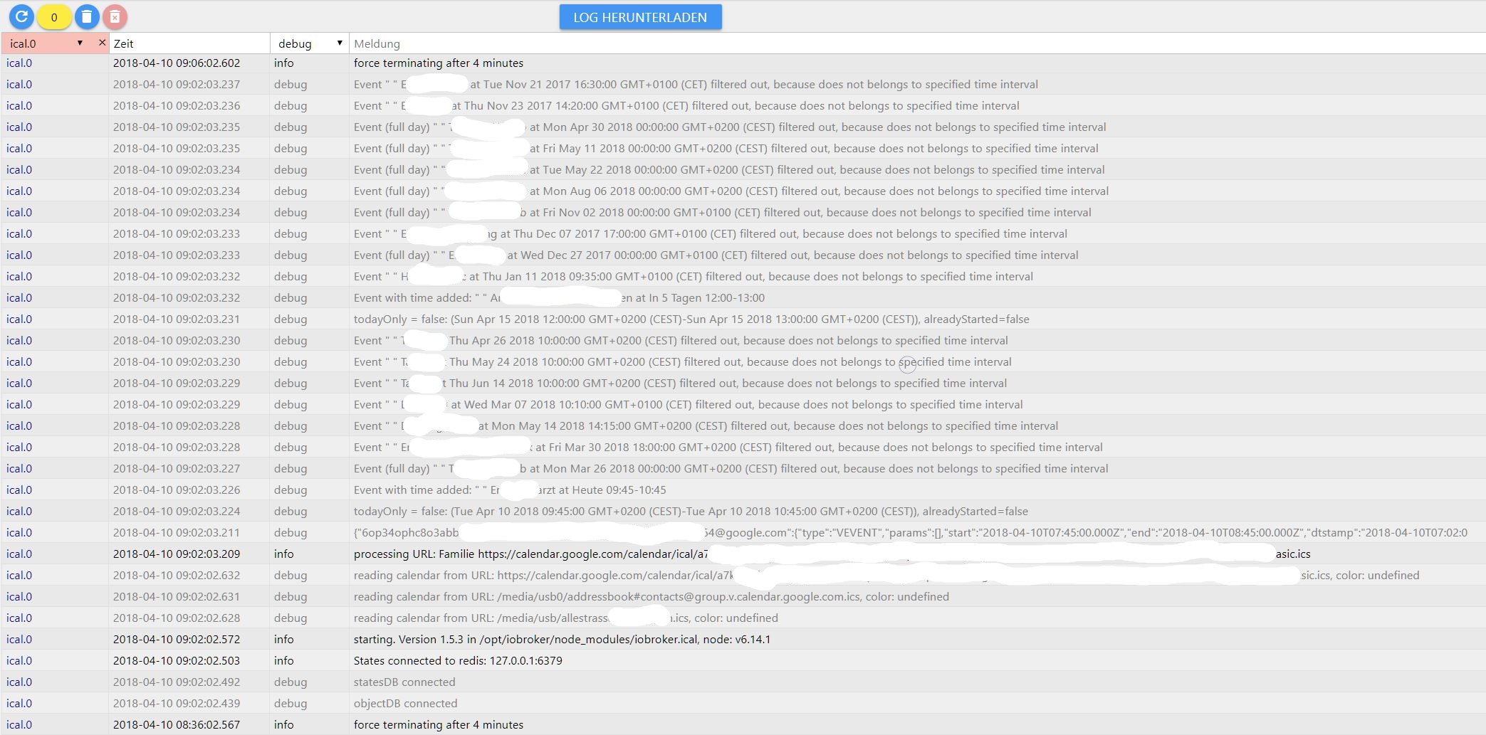

                host.ioBroker-Pi	2018-04-10 11:38:00.033	warn	instance system.adapter.ical.0 already running with pid 12962
                ical.0				2018-04-10 11:37:26.711	debug	Event " " Exxx at Tue Nov 21 2017 16:30:00 GMT+0100 (CET) filtered out, because does not belongs to specified time interval
                ical.0				2018-04-10 11:37:26.710	debug	Event " " Exxx at Thu Nov 23 2017 14:20:00 GMT+0100 (CET) filtered out, because does not belongs to specified time interval
                ical.0				2018-04-10 11:37:26.709	debug	Event (full day) " " Txxxb at Mon Apr 30 2018 00:00:00 GMT+0200 (CEST) filtered out, because does not belongs to specified time interval
                ical.0				2018-04-10 11:37:26.709	debug	Event (full day) " " Txxxb at Fri May 11 2018 00:00:00 GMT+0200 (CEST) filtered out, because does not belongs to specified time interval
                ical.0				2018-04-10 11:37:26.708	debug	Event (full day) " " Txxxb at Tue May 22 2018 00:00:00 GMT+0200 (CEST) filtered out, because does not belongs to specified time interval
                ical.0				2018-04-10 11:37:26.708	debug	Event (full day) " " Txxxb at Mon Aug 06 2018 00:00:00 GMT+0200 (CEST) filtered out, because does not belongs to specified time interval
                ical.0				2018-04-10 11:37:26.708	debug	Event (full day) " " Txxxb at Fri Nov 02 2018 00:00:00 GMT+0100 (CET) filtered out, because does not belongs to specified time interval
                ical.0				2018-04-10 11:37:26.707	debug	Event " " Exxxng at Thu Dec 07 2017 17:00:00 GMT+0100 (CET) filtered out, because does not belongs to specified time interval
                ical.0				2018-04-10 11:37:26.707	debug	Event (full day) " " Exxxub at Wed Dec 27 2017 00:00:00 GMT+0100 (CET) filtered out, because does not belongs to specified time interval
                ical.0				2018-04-10 11:37:26.706	debug	Event " " Haxxxc at Thu Jan 11 2018 09:35:00 GMT+0100 (CET) filtered out, because does not belongs to specified time interval
                ical.0				2018-04-10 11:37:26.706	debug	Event with time added: " " Arxxxxn at In 5 Tagen 12:00-13:00
                ical.0				2018-04-10 11:37:26.703	debug	todayOnly = false: (Sun Apr 15 2018 12:00:00 GMT+0200 (CEST)-Sun Apr 15 2018 13:00:00 GMT+0200 (CEST)), alreadyStarted=false
                ical.0				2018-04-10 11:37:26.696	debug	Event " " Taxxxat Thu Apr 26 2018 10:00:00 GMT+0200 (CEST) filtered out, because does not belongs to specified time interval
                ical.0				2018-04-10 11:37:26.696	debug	Event " " Taxxxo at Thu May 24 2018 10:00:00 GMT+0200 (CEST) filtered out, because does not belongs to specified time interval
                ical.0				2018-04-10 11:37:26.696	debug	Event " " Txxxx at Thu Jun 14 2018 10:00:00 GMT+0200 (CEST) filtered out, because does not belongs to specified time interval
                ical.0				2018-04-10 11:37:26.695	debug	Event " " ExxxxxNO at Wed Mar 07 2018 10:10:00 GMT+0100 (CET) filtered out, because does not belongs to specified time interval
                ical.0				2018-04-10 11:37:26.695	debug	Event " " Exxxxt at Mon May 14 2018 14:15:00 GMT+0200 (CEST) filtered out, because does not belongs to specified time interval
                ical.0				2018-04-10 11:37:26.694	debug	Event " " Erxxxxxox at Fri Mar 30 2018 18:00:00 GMT+0200 (CEST) filtered out, because does not belongs to specified time interval
                ical.0				2018-04-10 11:37:26.694	debug	Event (full day) " " Txxxb at Mon Mar 26 2018 00:00:00 GMT+0200 (CEST) filtered out, because does not belongs to specified time interval
                ical.0				2018-04-10 11:37:26.693	debug	Event " " xxxxxzt at Tue Apr 10 2018 09:45:00 GMT+0200 (CEST) filtered out, because does not belongs to specified time interval
                ical.0				2018-04-10 11:37:26.686	debug	{"6op3xxxxxxxxxx64@google.com":{"type":"VEVENT","params":[],"start":"2018-04-10T07:45:00.000Z","end":"2018-04-10T08:45:00.000Z","dtstamp":"2018-04-10T09:37:2
                ical.0				2018-04-10 11:37:26.684	info	processing URL: Familie https://calendar.google.com/calendar/ical/a7ki2q8bxxxxxxxxxxxgroup.calendar.google.com/private-2f3xxxxxxxxxxxxx98e/basic.ics
                ical.0				2018-04-10 11:37:26.472	info	Event "ical.0.events.Vacation" created
                ical.0				2018-04-10 11:37:26.074	debug	reading calendar from URL: https://calendar.google.com/calendar/ical/a7ki2q8bsbxxxxxxxxxx0group.calendar.google.com/private-2fxxxxxxxxe598e/basic.ics, color: undefined
                ical.0				2018-04-10 11:37:26.073	debug	reading calendar from URL: /media/usb0/addressbook#contacts@group.v.calendar.google.com.ics, color: undefined
                ical.0				2018-04-10 11:37:26.068	debug	reading calendar from URL: /media/usb/allestrassxxxxxch.ics, color: undefined
                ical.0				2018-04-10 11:37:25.944	info	starting. Version 1.5.3 in /opt/iobroker/node_modules/iobroker.ical, node: v6.14.1
                ical.0				2018-04-10 11:37:25.882	info	States connected to redis: 127.0.0.1:6379
                ical.0				2018-04-10 11:37:25.871	debug	statesDB connected
                ical.0				2018-04-10 11:37:25.818	debug	objectDB connected
                host.ioBroker-Pi	2018-04-10 11:37:23.538	info	instance system.adapter.ical.0 started with pid 12962
                host.ioBroker-Pi	2018-04-10 11:37:23.504	info	instance scheduled system.adapter.ical.0 8,38 * * * *
                host.ioBroker-Pi	2018-04-10 11:37:20.917	warn	stopInstance system.adapter.ical.0 not scheduled
                host.ioBroker-Pi	2018-04-10 11:37:20.916	info	stopInstance system.adapter.ical.0
                host.ioBroker-Pi	2018-04-10 11:37:20.915	info	object change system.adapter.ical.0
                host.ioBroker-Pi	2018-04-10 11:37:18.117	warn	stopInstance system.adapter.ical.0 not scheduled
                host.ioBroker-Pi	2018-04-10 11:37:18.117	info	stopInstance system.adapter.ical.0
                Das Objekt ical.0 wird gleich angelegt, der Unterpunkt events/vacation wird nach ca. 5-10 Minuten angelegt, ical.0/data wurde bis jetzt (ca 30 Minuten später) noch nicht angelegt. Weiß nicht wie lange es gestern gedauert hat, wurde dann aber irgendwann angelegt, die Datenpunkte darunter (siehe Bild erster Post) blieben aber leer

                  Laut logfile sehe ich aktuell nur einen Termin der ausgelesen wurde, in der Zukunft liegt und sichtbar sein sollte.

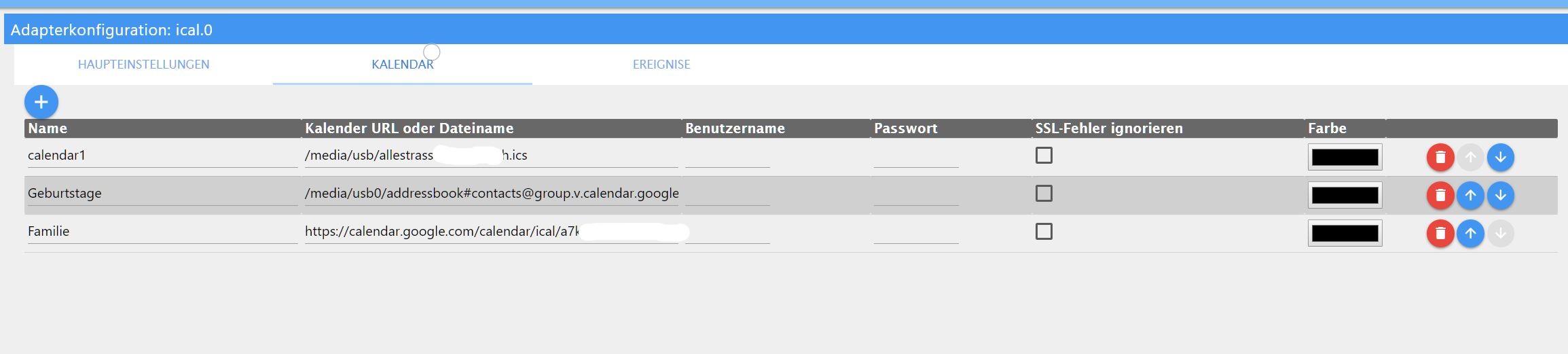

                  Kannst du nur zum Testen mal die Kalender aus der Konfig löschen in denen dieser Eintrag nicht vorkommt?
                  Bist du sicher das du den Haken bei "Ignoriere SSL Fehler" nicht benötigst um die HTTPS Kalender auszulesen?
                  Ich nutze noch eine Version 1.5.0 mit Admin 3.3.5 und JS-Controller 1.3.0 laufen, da funktioniert das füllen der Objekte noch.

                        Bitte sicherstellen das auch wirklich alle Pfade und URLs erreichbar sind und das File jeweilige File liefern. Es sieht mir irgendwie aus als ob er die eine URL verarbeiten kann, aber dann den Pfad nicht kriegt und es dann irgendwie timeouts gibt, weil nach 4 Minuten wird er gekillt.

                            Der Fehler ist gefunden. Und zwar war ein lokaler Kalender, der auf dem gesteckten USB-Stick war, warum auch immer, nicht mehr vorhanden. Ich habe ihn erneut rüberkopiert, eingerichtet und nun läuft es.
