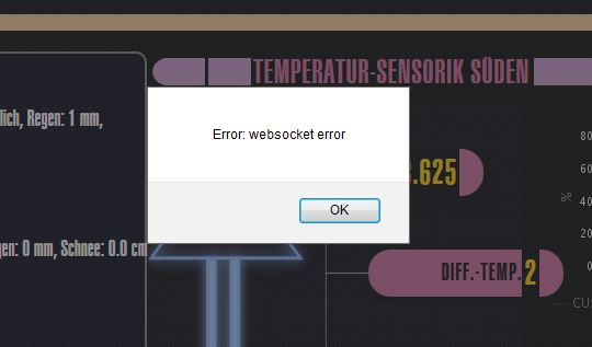

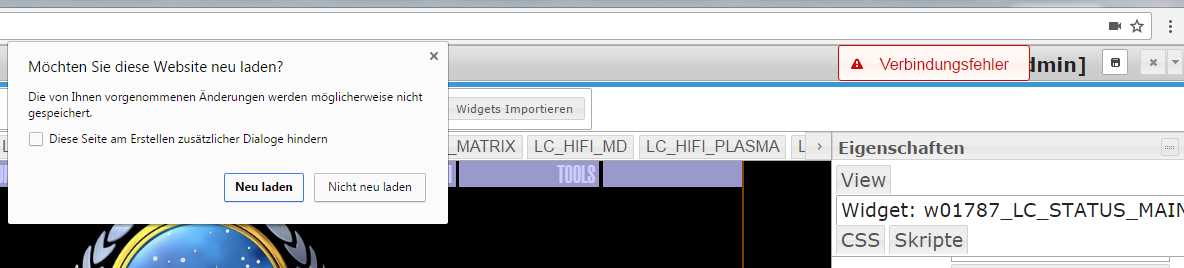

          Allerdings habe ich immer noch Probleme mit VIS:
          Selbst mit Kabel am Bapi kommt immer wieder das hier:
          und danach wird der Verbindungsfehler angezeigt (siehe Bild in dem anderen Post).
          Im Log kommt auch weiterhin der Fehler
          host.ioBroker-BPi	2017-01-09 13:31:15.697	error	instance system.adapter.javascript.0 terminated with code 0 (OK)
          javascript.0	2017-01-09 13:31:15.652	info	terminating
          javascript.0	2017-01-09 13:31:15.630	error	at Zlib.callback (zlib.js:625:5)
          javascript.0	2017-01-09 13:31:15.630	error	at TransformState.afterTransform (_stream_transform.js:54:12)
          javascript.0	2017-01-09 13:31:15.630	error	at afterTransform (_stream_transform.js:79:3)
          javascript.0	2017-01-09 13:31:15.630	error	at WritableState.onwrite (_stream_writable.js:89:5)
          javascript.0	2017-01-09 13:31:15.630	error	at onwrite (_stream_writable.js:345:7)
          javascript.0	2017-01-09 13:31:15.630	error	at afterWrite (_stream_writable.js:354:3)
          javascript.0	2017-01-09 13:31:15.630	error	at /opt/iobroker/node_modules/iobroker.js-controller/node_modules/socket.io-client/node_modules/engine.io-client/node_modules/ws/lib/PerMessageDeflate.js:249:5
          javascript.0	2017-01-09 13:31:15.630	error	at /opt/iobroker/node_modules/iobroker.js-controller/node_modules/socket.io-client/node_modules/engine.io-client/node_modules/ws/lib/Receiver.js:368:7
          javascript.0	2017-01-09 13:31:15.630	error	at /opt/iobroker/node_modules/iobroker.js-controller/node_modules/socket.io-client/node_modules/engine.io-client/node_modules/ws/lib/Receiver.js:536:18
          javascript.0	2017-01-09 13:31:15.630	error	at Receiver.ontext (/opt/iobroker/node_modules/iobroker.js-controller/node_modules/socket.io-client/node_modules/engine.io-client/node_modules/ws/lib/WebSocket.js:841:10)
          javascript.0	2017-01-09 13:31:15.630	error	at WebSocket.emit (events.js:172:7)
          javascript.0	2017-01-09 13:31:15.630	error	at emitTwo (events.js:87:13)
          javascript.0	2017-01-09 13:31:15.630	error	at WebSocket.onMessage (/opt/iobroker/node_modules/iobroker.js-controller/node_modules/socket.io-client/node_modules/engine.io-client/node_modules/ws/lib/WebSocket.js:442:14)
          javascript.0	2017-01-09 13:31:15.630	error	at WebSocket.ws.onmessage (/opt/iobroker/node_modules/iobroker.js-controller/node_modules/socket.io-client/node_modules/engine.io-client/lib/transports/websocket.js:146:10)
          javascript.0	2017-01-09 13:31:15.630	error	at WS.Transport.onData (/opt/iobroker/node_modules/iobroker.js-controller/node_modules/socket.io-client/node_modules/engine.io-client/lib/transport.js:137:8)
          javascript.0	2017-01-09 13:31:15.630	error	at WS.Transport.onPacket (/opt/iobroker/node_modules/iobroker.js-controller/node_modules/socket.io-client/node_modules/engine.io-client/lib/transport.js:145:8)
          javascript.0	2017-01-09 13:31:15.630	error	at WS.Emitter.emit (/opt/iobroker/node_modules/iobroker.js-controller/node_modules/socket.io-client/node_modules/component-emitter/index.js:133:20)
          javascript.0	2017-01-09 13:31:15.630	error	at WS. (/opt/iobroker/node_modules/iobroker.js-controller/node_modules/socket.io-client/node_modules/engine.io-client/lib/socket.js:268:10)
          javascript.0	2017-01-09 13:31:15.630	error	at Socket.onPacket (/opt/iobroker/node_modules/iobroker.js-controller/node_modules/socket.io-client/node_modules/engine.io-client/lib/socket.js:451:14)
          javascript.0	2017-01-09 13:31:15.630	error	at Socket.Emitter.emit (/opt/iobroker/node_modules/iobroker.js-controller/node_modules/socket.io-client/node_modules/component-emitter/index.js:133:20)
          javascript.0	2017-01-09 13:31:15.630	error	at Socket. (/opt/iobroker/node_modules/iobroker.js-controller/node_modules/socket.io-client/node_modules/component-bind/index.js:21:15)
          javascript.0	2017-01-09 13:31:15.630	error	at Manager.ondata (/opt/iobroker/node_modules/iobroker.js-controller/node_modules/socket.io-client/lib/manager.js:322:16)
          javascript.0	2017-01-09 13:31:15.630	error	at Decoder.add (/opt/iobroker/node_modules/iobroker.js-controller/node_modules/socket.io-client/node_modules/socket.io-parser/index.js:246:12)
          javascript.0	2017-01-09 13:31:15.630	error	at Decoder.Emitter.emit (/opt/iobroker/node_modules/iobroker.js-controller/node_modules/socket.io-client/node_modules/socket.io-parser/node_modules/component-emitter/index.js:134:20)
          javascript.0	2017-01-09 13:31:15.630	error	at Decoder. (/opt/iobroker/node_modules/iobroker.js-controller/node_modules/socket.io-client/node_modules/component-bind/index.js:21:15)
          javascript.0	2017-01-09 13:31:15.630	error	at Manager.ondecoded (/opt/iobroker/node_modules/iobroker.js-controller/node_modules/socket.io-client/lib/manager.js:332:8)
          javascript.0	2017-01-09 13:31:15.630	error	at Manager.Emitter.emit (/opt/iobroker/node_modules/iobroker.js-controller/node_modules/socket.io-client/node_modules/component-emitter/index.js:133:20)
          javascript.0	2017-01-09 13:31:15.630	error	at Manager. (/opt/iobroker/node_modules/iobroker.js-controller/node_modules/socket.io-client/node_modules/component-bind/index.js:21:15)
          javascript.0	2017-01-09 13:31:15.630	error	at Socket.onpacket (/opt/iobroker/node_modules/iobroker.js-controller/node_modules/socket.io-client/lib/socket.js:236:12)
          javascript.0	2017-01-09 13:31:15.630	error	at Socket.onack (/opt/iobroker/node_modules/iobroker.js-controller/node_modules/socket.io-client/lib/socket.js:312:9)
          javascript.0	2017-01-09 13:31:15.630	error	at Socket. (/opt/iobroker/node_modules/iobroker.javascript/javascript.js:316:37)
          javascript.0	2017-01-09 13:31:15.630	error	at load (/opt/iobroker/node_modules/iobroker.javascript/javascript.js:2600:20)
          javascript.0	2017-01-09 13:31:15.630	error	at prepareScript (/opt/iobroker/node_modules/iobroker.javascript/javascript.js:2575:41)
          javascript.0	2017-01-09 13:31:15.630	error	at Object.module.exports.compiler.fromSource (/opt/iobroker/node_modules/iobroker.javascript/node_modules/coffee-compiler/coffee-compiler.js:31:38)
          javascript.0	2017-01-09 13:31:15.630	error	TypeError: coffee.helpers.prettyErrorMessage is not a function
          javascript.0	2017-01-09 13:31:15.605	error	uncaught exception: coffee.helpers.prettyErrorMessage is not a function
          javascript.0	2017-01-09 13:31:15.441	info	received all objects
          javascript.0	2017-01-09 13:31:13.984	info	received all states
