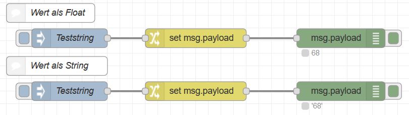

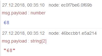

        Und hier noch die Lösung mit einem change-Node. Damit tue ich mich noch etwas schwerer. Aber ich lerne täglich dazu.
        [{"id":"1233a82b.0f69f8","type":"change","z":"3f55344e.eced9c","name":"","rules":[{"t":"set","p":"payload","pt":"msg","to":"(\t$n := $substringAfter(payload, "strValue=");\t$n2 := $substringBefore($n, " unit");\t$n3 := $substring($n2, 1);\t$l := $length($n3)-1;\t$n4 := $substring($n3, -0, $l);\t$nf := $number($n4);\t)","tot":"jsonata"}],"action":"","property":"","from":"","to":"","reg":false,"x":360,"y":676,"wires":[["ec0f7be6.0f69b"]]},{"id":"3f388d3c.679f92","type":"inject","z":"3f55344e.eced9c","name":"Teststring","topic":"","payload":" <eta version="&quot;1.0&quot;" xmlns="&quot;http://www.eta.co.at/rest/v1\&quot;"><value uri="&quot;//user/var/120/10601/0/0/13434&quot;" strvalue="&quot;68&quot;" unit="&quot;°C&quot;" decplaces="&quot;0&quot;" scalefactor="&quot;10&quot;" advtextoffset="&quot;0&quot;">680</value></eta>","payloadType":"str","repeat":"","crontab":"","once":false,"onceDelay":0.1,"x":160,"y":676,"wires":[["1233a82b.0f69f8"]]},{"id":"ec0f7be6.0f69b","type":"debug","z":"3f55344e.eced9c","name":"","active":true,"tosidebar":true,"console":false,"tostatus":true,"complete":"payload","x":590,"y":676,"wires":[]},{"id":"b424926b.04b468","type":"comment","z":"3f55344e.eced9c","name":"Wert als Float","info":"","x":130,"y":636,"wires":[]},{"id":"2f5177.8ac9f68a","type":"change","z":"3f55344e.eced9c","name":"","rules":[{"t":"set","p":"payload","pt":"msg","to":"(\t$n := $substringAfter(payload, "strValue=");\t$n2 := $substringBefore($n, " unit");\t$n3 := $substring($n2, 1);\t$l := $length($n3)-1;\t$n4 := $substring($n3, -0, $l);\t)","tot":"jsonata"}],"action":"","property":"","from":"","to":"","reg":false,"x":360,"y":760,"wires":[["46bccbb1.e5a214"]]},{"id":"2448112.7f9af6e","type":"inject","z":"3f55344e.eced9c","name":"Teststring","topic":"","payload":" <eta version="&quot;1.0&quot;" xmlns="&quot;http://www.eta.co.at/rest/v1\&quot;"><value uri="&quot;//user/var/120/10601/0/0/13434&quot;" strvalue="&quot;68&quot;" unit="&quot;°C&quot;" decplaces="&quot;0&quot;" scalefactor="&quot;10&quot;" advtextoffset="&quot;0&quot;">680</value></eta>","payloadType":"str","repeat":"","crontab":"","once":false,"onceDelay":0.1,"x":160,"y":760,"wires":[["2f5177.8ac9f68a"]]},{"id":"46bccbb1.e5a214","type":"debug","z":"3f55344e.eced9c","name":"","active":true,"tosidebar":true,"console":false,"tostatus":true,"complete":"payload","x":590,"y":760,"wires":[]},{"id":"2f50c72e.a10b8","type":"comment","z":"3f55344e.eced9c","name":"Wert als String","info":"","x":140,"y":720,"wires":[]}]
         ![3639_sc23.jpg](/assets/uploads/files/3639_sc23.jpg)
         ![3639_sc24.jpg](/assets/uploads/files/3639_sc24.jpg)
