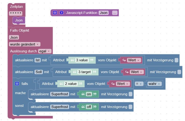

    Moin,
    wer Liebherr Smart Device Geräte hat, möchte diese eventuell in ioBroker einbinden.
    So kann man die Werte bekommen.
    Optionen in der Liebherr App aktivieren
    1. Es wird die Device-ID benötigt (unter Geräte)
    2. Betatest muss aktiviert werden (Den API-Key sofort kopieren und sichern, wird nur einmal angezeigt)
    Blockly Beispiel

     <block type="procedures_defcustomnoreturn" id="58E*=$3Hjml7hK,wSSKR" x="288" y="113">
       <mutation statements="false"></mutation>
       <field name="NAME">Json</field>
       <field name="SCRIPT">Y29uc3QgaHR0cCA9IHJlcXVpcmUoImh0dHBzIik7DQoNCmNvbnN0IG9wdGlvbnMgPSB7DQogICJtZXRob2QiOiAiR0VUIiwNCiAgImhvc3RuYW1lIjogImhvbWUtYXBpLnNtYXJ0ZGV2aWNlLmxpZWJoZXJyLmNvbSIsDQogICJwb3J0IjogbnVsbCwNCiAgInBhdGgiOiAiL3YxL2RldmljZXMvWFguWFhYLlhYWC5YL2NvbnRyb2xzIiwNCiAgImhlYWRlcnMiOiB7DQogICAgImFjY2VwdCI6ICIqLyoiLA0KICAgICJhcGkta2V5IjogIlhYWFhYWFhYWFhYWFhYWFhYWFhYWFhYWFhYWFhYWFhYWFhYWFhYWFhYWCINCiAgICAgICAgICAgICAgICANCiAgfQ0KfTsNCg0KY29uc3QgcmVxID0gaHR0cC5yZXF1ZXN0KG9wdGlvbnMsIGZ1bmN0aW9uIChyZXMpIHsNCiAgY29uc3QgY2h1bmtzID0gW107DQoNCiAgcmVzLm9uKCJkYXRhIiwgZnVuY3Rpb24gKGNodW5rKSB7DQogICAgY2h1bmtzLnB1c2goY2h1bmspOw0KICB9KTsNCg0KICByZXMub24oImVuZCIsIGZ1bmN0aW9uICgpIHsNCiAgICBjb25zdCBib2R5ID0gQnVmZmVyLmNvbmNhdChjaHVua3MpOw0KICAgIHNldFN0YXRlKCcwX3VzZXJkYXRhLjAuR2VmcmllcnNjaHJhbmsuSnNvbicsIChib2R5LnRvU3RyaW5nKCkpLCB0cnVlKTsNCiAgfSk7DQp9KTsNCg0KcmVxLmVuZCgpOw==</field>
     </block>
    </xml>
    Die Funktion muss angepasst werden
    1. Device-ID
    2. API-Key
    3. Speicherpfad für's json
    const http = require("https");
    const options = {
     "method": "GET",
     "hostname": "home-api.smartdevice.liebherr.com",
     "port": null,
     "path": "/v1/devices/XX.XXX.XXX.X/controls",
     "headers": {
       "accept": "*/*",
       "api-key": "XXXXXXXXXXXXXXXXXXXXXXXXXXXXXXXXXXXXXXXXXX"
    const req = http.request(options, function (res) {
     const chunks = [];
     res.on("data", function (chunk) {
       chunks.push(chunk);
     res.on("end", function () {
       const body = Buffer.concat(chunks);
       setState('0_userdata.0.Gefrierschrank.Json', (body.toString()), true);
    req.end();
    Die/Das Json sieht dann bei mir so aus
    Das Blockly schreibt die Werte dann entsprechend
    Mehr Optionen sind hier zu finden
    https://developer.liebherr.com/apis/smartdevice-homeapi/swagger-ui/
    Wobei Swagger bei mir nicht funktioniert hat.

      @stenmic
      Cool, dass Du eine Möglichkeit gefunden hast, die Liebherr-API abzufragen.
      Ich wollte mir das schnell nachbauen, es kommt nun aber zu diesen Fehlermeldungen:
      Device-IP und API-Key sind gemäß Deiner guten Anleitung aus der Liebherr-App generiert und korrekt in der JSON-Funktion eingetragen.
      Ich vermute, ich habe noch einen Fehler beim Anlegen des json-Datenpunktes (?)
      Wie muss der denn richtig angelegt werden?
      Vielleicht kannst Du mir "auf die Sprünge helfen" ? - Danke.

                    @bullemausberlin ich denke Du hast alles richtig eingebaut. Es liegt vermutlich daran dass Dein Gerät im Json einen anderen Aufbau hat und daher die Reihenfolge der Values angepasst werden muss. Das war es z.B. bei mir. Mit diesen Anpassungen hat es dann funktioniert. Damit du es testen kannst musst du einen wert im Json ändern damit das Skript überhaupt wieder läuft
                    Du siehst in meinem Fall war es 3.value und 3.target für die Temperatur und 2.value für superfrost. Sonst schick doch mal ein Bild von Deinem Json dann kann man das genau sagen.
