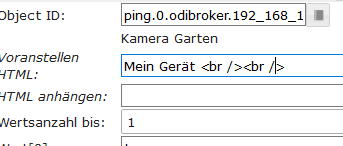

        Importiere Dir mal dieses Widget (im .vis oben rechts, wenn du oben links den Reiter "Widget"aktiviert hast:
        [{"tpl":"tplValueListHtml8","data":{"oid":"ping.0.odibroker.192_168_1_222","visibility-cond":"==","visibility-val":"1","count":"1","value0":"false","value1":"true","style0":"background: radial-gradient(ellipse at center, #ffd6d6 0%,#d82b2b 45%,#ed0000 100%);","style1":"background: radial-gradient(ellipse at center, #ade6ad 0%,#00aa00 100%);","test_list":"1","html_prepend":"Mein Gerät ","value2":"2","style2":"","visibility-oid":"","name":"Statusanzeige Ping Mein Gerät","comment":"Wird rot oder grün gemäß Ping-Status","signals-cond-0":"==","signals-val-0":true,"signals-icon-0":"/vis/signals/lowbattery.png","signals-icon-size-0":0,"signals-blink-0":false,"signals-horz-0":0,"signals-vert-0":0,"signals-hide-edit-0":false,"signals-cond-1":"==","signals-val-1":true,"signals-icon-1":"/vis/signals/lowbattery.png","signals-icon-size-1":0,"signals-blink-1":false,"signals-horz-1":0,"signals-vert-1":0,"signals-hide-edit-1":false,"signals-cond-2":"==","signals-val-2":true,"signals-icon-2":"/vis/signals/lowbattery.png","signals-icon-size-2":0,"signals-blink-2":false,"signals-horz-2":0,"signals-vert-2":0,"signals-hide-edit-2":false},"style":{"left":"643px","top":"405px","width":"94px","height":"56px","color":"#fcfffa","text-align":"center","font-size":"","line-height":"1.8","background":"","border-width":"2px","border-color":"#fdfced","border-style":"solid","border-radius":"2px","opacity":"0.9","z-index":"7","font-family":"","font-style":"","font-variant":"","font-weight":"bold","margin-top":"","padding-top":""},"widgetSet":"basic"}]
        Dann musst Du rechts in der Auswahl: Allgemein/Object ID nur noch Dein Object Auswählen.
        Dieses Widget wird dann rot oder grün, so wie der Status des Pings halt ist.
        Ich habe gleich mal ein bischen CSS mit rein gepackt, so dass ein Farbverlauf da ist. Wenn Du das nicht magst, dann einfach die STIL[0 oder 1] Zeile anpassen.
         ![578_2016-10-10_21_14_25-edit_vis.png](/assets/uploads/files/578_2016-10-10_21_14_25-edit_vis.png)   ![578_2016-10-10_21_23_46-edit_vis.png](/assets/uploads/files/578_2016-10-10_21_23_46-edit_vis.png)
        Der Wert (hier also true oder false) wird angezeigt, wie in meinen Bildern zu sehen. Wenn das nicht gewünscht, dann füge einfach noch ein paar Zeilenumbrüche (
        ) ein, wie hier im Bild zu sehen:
         ![578_2016-10-10_21_15_51-edit_vis.png](/assets/uploads/files/578_2016-10-10_21_15_51-edit_vis.png)
        Das Widget weiter oben hat diese gleich drinnen.
        Hoffe das hilft für den Start?
