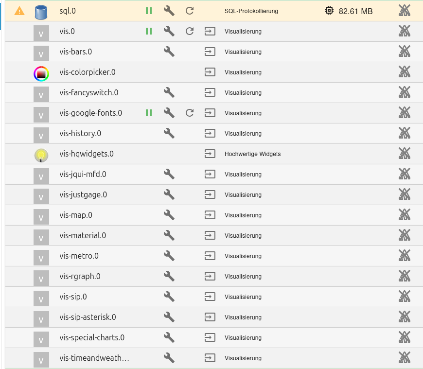

      Hallo ich habe es aktuell noch nicht abgeschaltet, da ich bis alles läuft noch einen Monitor angeschlossen habe.
      Nun zur nicht funktionierenden VIS.
      Weder die Runtime noch der Editor öffnen sich.
      Adapter Übersicht:
      Er verweist, ständig auf 1.4.16
      Log Files
      2025-08-11T12_00_01_241Z-debug-0.log 2025-08-11T12_00_09_838Z-debug-0.log 2025-08-11T12_00_14_511Z-debug-0.log 2025-08-11T12_00_19_475Z-debug-0.log 2025-08-11T12_00_24_390Z-debug-0.log 2025-08-11T12_00_29_111Z-debug-0.log 2025-08-11T12_00_33_982Z-debug-0.log 2025-08-11T12_00_40_074Z-debug-0.log 2025-08-11T12_00_49_556Z-debug-0.log 2025-08-11T12_01_02_108Z-debug-0.log 2025-08-11T12_01_11_370Z-debug-0.log

      2025-08-11 13:55:47.651  - error: host.NUC iobroker npm-install: npm error code ETARGETnpm error notarget No matching version found for iobroker.vis-history@1.4.16.npm error notarget In most cases you or one of your dependencies are requestingnpm error notarget a package version that doesn't exist.npm error A complete log of this run can be found in: /home/iobroker/.npm/_logs/2025-08-11T11_55_44_488Z-debug-0.loghost.NUC Cannot install iobroker.vis-history@1.4.16: 1
      2025-08-11 13:55:48.532  - info: host.NUC instance system.adapter.history.0 in version "3.0.1" started with pid 11104
      2025-08-11 13:55:48.667  - info: host.NUC iobroker npm-install: exit 25

      2025-08-11 13:55:49.668  - warn: host.NUC startInstance cannot find adapter "vis-timeandweather@1.4.16". Try to install it... 1 attempt
      2025-08-11 13:55:49.668  - info: host.NUC iobroker install vis-timeandweather@1.4.16 using installedVersion
      2025-08-11 13:55:50.568  - info: host.NUC iobroker npm-install: NPM version: 10.8.2
      2025-08-11 13:55:50.569  - info: host.NUC iobroker npm-install: Installing iobroker.vis-timeandweather@1.4.16... (System call)
      2025-08-11 13:55:52.557  - info: host.NUC instance system.adapter.javascript.0 in version "8.9.2" started with pid 11153
      2025-08-11 13:55:53.660  - info: javascript.0 (11153) starting. Version 8.9.2 in /opt/iobroker/node_modules/iobroker.javascript, node: v20.19.4, js-controller: 7.0.6
      2025-08-11 13:55:53.826  - error: host.NUC iobroker npm-install: npm error code ETARGETnpm error notarget No matching version found for iobroker.vis-timeandweather@1.4.16.npm error notarget In most cases you or one of your dependencies are requestingnpm error notarget a package version that doesn't exist.npm error A complete log of this run can be found in: /home/iobroker/.npm/_logs/2025-08-11T11_55_50_633Z-debug-0.log
      2025-08-11 13:55:53.828  - error: host.NUC iobroker npm-install: host.NUC Cannot install iobroker.vis-timeandweather@1.4.16: 1
      2025-08-11 13:55:54.848  - info: host.NUC iobroker npm-install: exit 25
      2025-08-11 13:55:55.849  - warn: host.NUC startInstance cannot find adapter "vis-sip-asterisk@1.4.16". Try to install it... 1 attempt
      2025-08-11 13:55:55.850  - info: host.NUC iobroker install vis-sip-asterisk@1.4.16 using installedVersion
      2025-08-11 13:55:56.590  - info: host.NUC instance system.adapter.javascript.1 in version "8.9.2" started with pid 11190
      2025-08-11 13:55:56.918  - error: host.NUC iobroker npm-install: host.NUC Unknown packet name vis-sip-asterisk. Please install packages from outside the repository using "iobroker url <url-or-package>"!
      2025-08-11 13:55:56.926  - error: host.NUC iobroker npm-install: adapter "vis-sip-asterisk" cannot be installed: Unknown packet name vis-sip-asterisk. Please install packages from outside the repository using "iobroker url <url-or-package>"!
      2025-08-11 13:55:57.741  - info: javascript.1 (11190) starting. Version 8.9.2 in /opt/iobroker/node_modules/iobroker.javascript, node: v20.19.4, js-controller: 7.0.6
      2025-08-11 13:55:57.950  - info: host.NUC iobroker npm-install: exit 12
      2025-08-11 13:55:58.951  - warn: host.NUC startInstance cannot find adapter "vis-material@1.4.16". Try to install it... 1 attempt
      2025-08-11 13:55:58.951  - info: host.NUC iobroker install vis-material@1.4.16 using installedVersion
      2025-08-11 13:56:00.242  - info: host.NUC iobroker npm-install: NPM version: 10.8.2
      2025-08-11 13:56:00.243  - info: host.NUC iobroker npm-install: Installing iobroker.vis-material@1.4.16... (System call)

      majorkamy@NuC:/$ iobroker enable web
      iobroker [command]
      Commands:
        iobroker setup                                               Setup ioBroker
        iobroker start [all|<adapter>.<instance>|<adapter>]          Starts the js-controller or a specified adapter instance or all instances of an adapter
        iobroker stop [<adapter>.<instance>|<adapter>]               stops the js-controller or a specified adapter instance or all instances of an adapter
        iobroker restart [<adapter>.<instance>|<adapter>]            Restarts js-controller or a specified adapter instance or all instances of an adapter  [aliases: r]
        iobroker debug <adapter>[.<instance>]                        Starts a Node.js debugging session for the adapter instance
        iobroker info                                                Shows the host info
        iobroker logs [<adapter>]                                    Monitor log
        iobroker add <adapter> [desiredNumber]                       Add instance of adapter  [aliases: a]
        iobroker install <adapter>                                   Installs a specified adapter  [aliases: i]
        iobroker rebuild [<module>]                                  Rebuild all native modules or path
        iobroker url <url> [<name>]                                  Install adapter from specified url, e.g. GitHub, if a package name is provided instead of an url, it will be installed from npm
        iobroker del <adapter>                                       Remove adapter and all instances from this host  [aliases: delete]
        iobroker del <adapter>.<instance>                            Remove adapter instance  [aliases: delete]
        iobroker update [<repositoryUrl>]                            Update repository and list adapters
        iobroker upgrade                                             Upgrade management
        iobroker upload [all|<adapter>]                              Upload management  [aliases: u]
        iobroker object                                              Object management  [aliases: o]
        iobroker state                                               State management  [aliases: s]
        iobroker message <adapter>[.instance] <command> [<message>]  Send message to adapter instance/s
        iobroker list <type> [<filter>]                              List all entries, like objects
        iobroker chmod <mode> <file>                                 Change file rights
        iobroker chown <user> <group> <file>                         Change file ownership
        iobroker touch <file>                                        Touch file
        iobroker rm <file>                                           Remove file
        iobroker file                                                File management
        iobroker user                                                User commands
        iobroker group                                               group management
        iobroker host <hostname>                                     Set host to given hostname
        iobroker set <adapter>.<instance>                            Change settings of adapter config
        iobroker license <license.file or license.text>              Update license by given file
        iobroker cert                                                Certificate management
        iobroker clean <yes>                                         Clears all objects and states
        iobroker backup                                              Create backup
        iobroker restore <backup name or path>                       Restore a specified backup
        iobroker validate <backup name or path>                      Validate a specified backup
        iobroker status [all|<adapter>.<instance>]                   Status of ioBroker or adapter instance  [aliases: isrun]
        iobroker repo                                                Show repo information
        iobroker uuid                                                Show uuid of the installation  [aliases: id]
        iobroker unsetup                                             Reset license, installation secret and language
        iobroker fix                                                 Execute the installation fixer script, this updates your ioBroker installation
        iobroker nodejs-update [<major-version>]                     Upgrade the Node.JS installation to the current LTS
        iobroker multihost                                           Multihost management
        iobroker compact                                             compact group management
        iobroker plugin                                              Plugin management
        iobroker vendor <passphrase> [<vendor.json>]                 Update the vendor information using given passphrase
        iobroker version [<adapter>]                                 Show version of js-controller or specified adapter  [aliases: v]
      Options:
        --help  Show help  [boolean]
      majorkamy@NuC:/$ iobroker start vis
      majorkamy@NuC:/$
      Es erscheint kein sichtbarer Fehler aber die Vis bleibt inaktiv.
      und nein ich habe keinen direkten Monitor dran.
      Die Visualisierung lief bzw soll auch wieder über einen RasperiPi über einen Kioskbrowser und Touchbildschirm laufen.
      Soll ich es über iob fix deaktivieren?
      posted in ioBroker Allgemein
