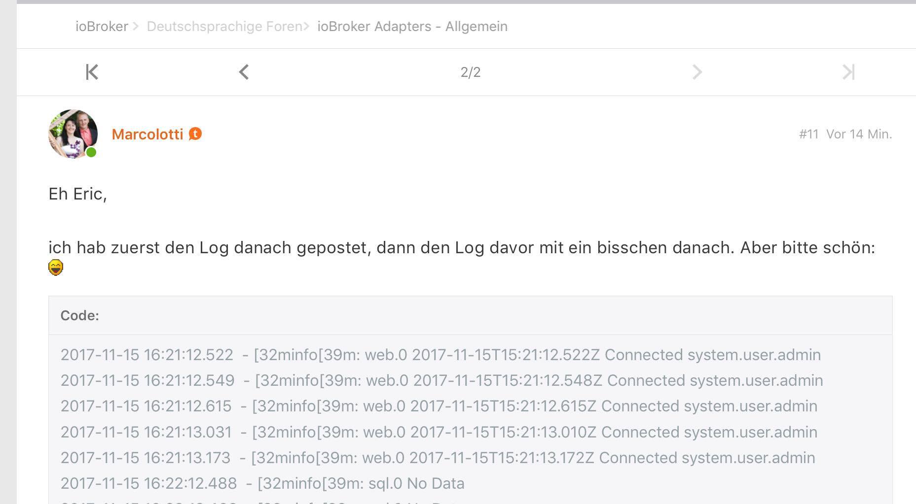

              Marcolotti
              Bitte Code-Tags verwenden!
              <code>2017-11-15 16:15:12.622  - [32minfo[39m: hm-rpc.1 Connected
              2017-11-15 16:15:17.666  - [32minfo[39m: host.iobroker2 instance system.adapter.weatherunderground.0 terminated with code 0 (OK)
              2017-11-15 16:15:18.899  - [32minfo[39m: host.iobroker2 instance system.adapter.ical.0 terminated with code 0 (OK)
              2017-11-15 16:17:34.815  - [31merror[39m: cloud.0 Ping timeout
              2017-11-15 16:17:34.836  - [32minfo[39m: cloud.0 Connection changed: DISCONNECTED3
              2017-11-15 16:17:34.843  - [32minfo[39m: cloud.0 Connection changed: DISCONNECTED1
              2017-11-15 16:17:44.900  - [31merror[39m: Caught by controller[0]: 2017-11-15 16:17:34.826  -  cloud.0 Ping timeout
              2017-11-15 16:17:44.901  - [31merror[39m: host.iobroker2 instance system.adapter.cloud.0 terminated with code 156 ()
              2017-11-15 16:17:44.901  - [32minfo[39m: host.iobroker2 Restart adapter system.adapter.cloud.0 because enabled
              2017-11-15 16:17:45.927  - [32minfo[39m: host.iobroker2 instance system.adapter.cloud.0 started with pid 30338
              2017-11-15 16:17:50.296  - [32minfo[39m: cloud.0 starting. Version 2.0.6 in /opt/iobroker/node_modules/iobroker.cloud, node: v6.11.4
              2017-11-15 16:17:50.871  - [32minfo[39m: cloud.0 Connecting with https://iobroker.net:10555 with "**********"
              2017-11-15 16:17:55.683  - [32minfo[39m: cloud.0 2017-11-15T15:17:55.682Z Connected system.user.admin
              2017-11-15 16:18:05.315  - [31merror[39m: cloud.0 Error while connecting to cloud: timeout
              2017-11-15 16:18:12.651  - [32minfo[39m: hm-rpc.1 Disconnected
              2017-11-15 16:18:14.384  - [32minfo[39m: hm-rpc.1 binrpc -> listDevices 78
              2017-11-15 16:18:14.466  - [32minfo[39m: hm-rpc.1 new CUxD devices/channels after filter: 0
              2017-11-15 16:18:14.468  - [32minfo[39m: hm-rpc.1 Connected
              2017-11-15 16:18:18.211  - [31merror[39m: cloud.0 Error while connecting to cloud: timeout
              2017-11-15 16:18:38.230  - [31merror[39m: cloud.0 Error while connecting to cloud: timeout
              2017-11-15 16:18:58.251  - [31merror[39m: cloud.0 Error while connecting to cloud: timeout
              2017-11-15 16:19:18.276  - [31merror[39m: cloud.0 Error while connecting to cloud: timeout
              2017-11-15 16:19:38.298  - [31merror[39m: cloud.0 Error while connecting to cloud: timeout
              2017-11-15 16:19:58.320  - [31merror[39m: cloud.0 Error while connecting to cloud: timeout
              2017-11-15 16:20:07.803  - [31merror[39m: Caught by controller[1]: ReferenceError: error is not defined
              2017-11-15 16:20:07.804  - [31merror[39m: Caught by controller[1]:     at Request._callback (script.js.Ilm-Pegelstand:7:34)
              2017-11-15 16:20:07.805  - [31merror[39m: Caught by controller[1]:     at self.callback (/opt/iobroker/node_modules/iobroker.javascript/node_modules/request/request.js:188:22)
              2017-11-15 16:20:07.805  - [31merror[39m: Caught by controller[1]:     at emitOne (events.js:96:13)
              2017-11-15 16:20:07.806  - [31merror[39m: Caught by controller[1]:     at Request.emit (events.js:188:7)
              2017-11-15 16:20:07.806  - [31merror[39m: Caught by controller[1]:     at Request.onRequestError (/opt/iobroker/node_modules/iobroker.javascript/node_modules/request/request.js:884:8)
              2017-11-15 16:20:07.807  - [31merror[39m: Caught by controller[1]:     at emitOne (events.js:96:13)
              2017-11-15 16:20:07.808  - [31merror[39m: Caught by controller[1]:     at ClientRequest.emit (events.js:188:7)
              2017-11-15 16:20:07.808  - [31merror[39m: Caught by controller[1]:     at TLSSocket.socketErrorListener (_http_client.js:310:9)
              2017-11-15 16:20:07.809  - [31merror[39m: Caught by controller[1]:     at emitOne (events.js:96:13)
              2017-11-15 16:20:07.809  - [31merror[39m: Caught by controller[1]:     at TLSSocket.emit (events.js:188:7)
              2017-11-15 16:20:07.809  - [31merror[39m: Caught by controller[2]: 2017-11-15 16:20:07.717  -  javascript.0 uncaught exception: error is not defined
              2017-11-15 16:20:07.810  - [31merror[39m: Caught by controller[3]: 2017-11-15 16:20:07.722  -  javascript.0 ReferenceError: error is not defined
              2017-11-15 16:20:07.810  - [31merror[39m: Caught by controller[3]:     at Request._callback (script.js.Ilm-Pegelstand:7:34)
              2017-11-15 16:20:07.810  - [31merror[39m: Caught by controller[3]:     at self.callback (/opt/iobroker/node_modules/iobroker.javascript/node_modules/request/request.js:188:22)
              2017-11-15 16:20:07.811  - [31merror[39m: Caught by controller[3]:     at emitOne (events.js:96:13)
              2017-11-15 16:20:07.811  - [31merror[39m: Caught by controller[3]:     at Request.emit (events.js:188:7)
              2017-11-15 16:20:07.811  - [31merror[39m: Caught by controller[3]:     at Request.onRequestError (/opt/iobroker/node_modules/iobroker.javascript/node_modules/request/request.js:884:8)
              2017-11-15 16:20:07.812  - [31merror[39m: Caught by controller[3]:     at emitOne (events.js:96:13)
              2017-11-15 16:20:07.812  - [31merror[39m: Caught by controller[3]:     at ClientRequest.emit (events.js:188:7)
              2017-11-15 16:20:07.812  - [31merror[39m: Caught by controller[3]:     at TLSSocket.socketErrorListener (_http_client.js:310:9)
              2017-11-15 16:20:07.813  - [31merror[39m: Caught by controller[3]:     at TLSSocket.emit (events.js:188:7)
              2017-11-15 16:20:07.813  - [31merror[39m: host.iobroker2 instance system.adapter.javascript.0 terminated with code 0 (OK)
              2017-11-15 16:20:07.813  - [32minfo[39m: host.iobroker2 Restart adapter system.adapter.javascript.0 because enabled

                        Marcolotti
                        Eh Eric,
                        ich hab zuerst den Log danach gepostet, dann den Log davor mit ein bisschen danach. Aber bitte schön: :lol:
                        <code>2017-11-15 15:15:10.545  - [32minfo[39m: ical.0 processing URL: calendar1 https://www.google.com/calendar/ical/*******.com/*******/basic.ics

                              Jetzt hab ich's gesehen …
                              Wie Du an meiner Signatur gesehen hast, war ich nicht am PC, sondern mobil unterwegs.
                              Tapatalk zeigt die Logs nicht so an, wie sie am PC zu sehen sind .... siehe Screenshot:
                              Jetzt, am Mac, sehe ich die "richtigen" Logs.
