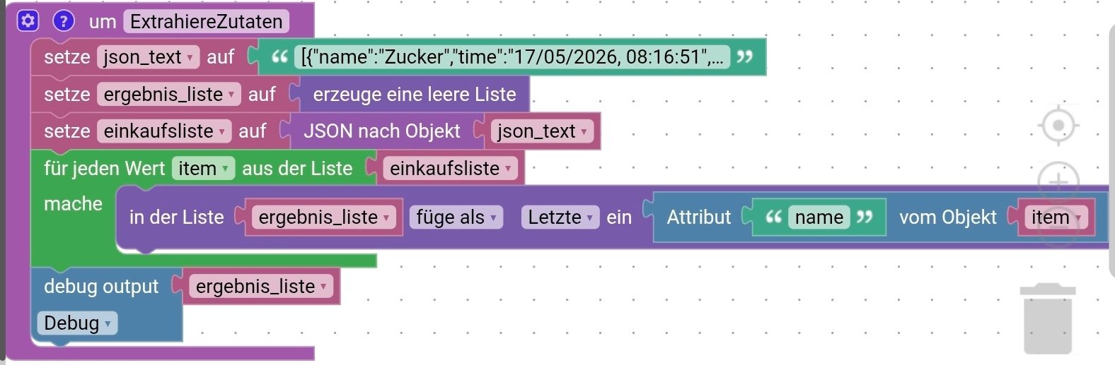

      Ich nutze kein Blockly. Gemini hat aus den Vorgaben oben folgenden Blockly-Export erzeugt:
       <variables>
         <variable id="j)LhS{l7$G,pXF9UoV{+">json_text</variable>
         <variable id="8;g{v9m^I9`~M_Z-~fK,">einkaufsliste</variable>
         <variable id="7;S`V6;6Zf`S6*?8u8S5">item</variable>
         <variable id="?fJ$3S,fS,u8S;6Zf`S6">ergebnis_liste</variable>
       </variables>
       <block type="procedures_defnoreturn" id="main" x="113" y="88">
         <field name="NAME">ExtrahiereZutaten</field>
         <comment pinned="false" h="80" w="160">Extrahiert die Namen aus dem Alexa-JSON</comment>
         <statement name="STACK">
           <block type="variables_set" id="set_json">
             <field name="VAR" id="j)LhS{l7$G,pXF9UoV{+">json_text</field>
             <value name="VALUE">
               <block type="text" id="json_content">
                 <field name="TEXT">[{"name":"Zucker","time":"17/05/2026, 08:16:51","ts":1778998611270,"id":"e43597e2-3ce0-4d6c-8a65-b6f9fdc11202","pos":1,"buttonmove":"..."},{"name":"Eier","time":"17/05/2026, 08:17:01","ts":1778998621424,"id":"..."},{"name":"Milch","time":"17/05/2026, 08:17:09","ts":1778998629725,"id":"..."}]</field>
               </block>
             </value>
             <next>
               <block type="variables_set" id="create_empty_list">
                 <field name="VAR" id="?fJ$3S,fS,u8S;6Zf`S6">ergebnis_liste</field>
                   <block type="lists_create_empty" id="empty_list"></block>
                 </value>
                 <next>
                   <block type="variables_set" id="parse_json">
                     <field name="VAR" id="8;g{v9m^I9`~M_Z-~fK,">einkaufsliste</field>
                       <block type="convert_json2object" id="json2obj">
                           <block type="variables_get" id="get_json_var">
                           </block>
                         </value>
                       </block>
                     </value>
                     <next>
                       <block type="controls_forEach" id="loop_list">
                         <field name="VAR" id="7;S`V6;6Zf`S6*?8u8S5">item</field>
                         <value name="LIST">
                           <block type="variables_get" id="get_list_var">
                           </block>
                         </value>
                         <statement name="DO">
                           <block type="lists_setIndex" id="add_to_list">
                             <mutation at="false"></mutation>
                             <field name="MODE">INSERT</field>
                             <field name="WHERE">LAST</field>
                             <value name="LIST">
                               <block type="variables_get" id="get_erg_list">
                               </block>
                             </value>
                             <value name="TO">
                               <block type="get_attr" id="get_name_attr">
                                 <value name="PATH">
                                   <block type="text" id="attr_name">
                                     <field name="TEXT">name</field>
                                   </block>
                                 </value>
                                 <value name="OBJECT">
                                   <block type="variables_get" id="get_item">
                                   </block>
                                 </value>
                               </block>
                             </value>
                           </block>
                         </statement>
                         <next>
                           <block type="debug" id="log_out">
                             <value name="TEXT">
                               <block type="variables_get" id="get_final_list">
                               </block>
                             </value>
                           </block>
                         </next>
                       </block>
                     </next>
                   </block>
                 </next>
               </block>
             </next>
           </block>
         </statement>
       </block>
      </xml>

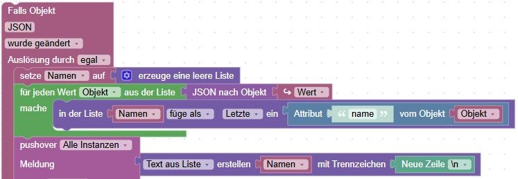

        @Deltaforce007 [sagte]: Werte die unter NAME stehen auslesen?
          Deltaforce007
          Vielen Dank, ich habe es mit euerer Hilfe und Copilot geschafft :-)
