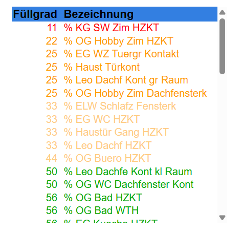

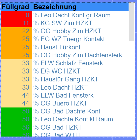

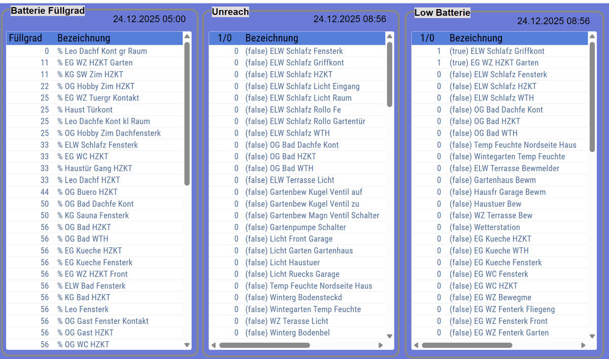

    ich möchte angehängte Listen farbig je nach Wert in Spalte 1 darstellen.
    Die Listen wurden in Blockly erstellt und in einen Objekt geschrieben.

        Für die beiden Listen "unreach" und "low batterie" wollt ich eigentlich noch Bilder einfügen in die erste Spalte, bzw. kleine Pictogramm!

                Folgende möglich Einteilung:
                < 20% rot
                20 bis 30 % orange
                30 bis 50 % hellorange
                50% grün
                Anbei Export Widget
                [{"tpl":"tplVis-materialdesign-Table","data":{"oid":"0_userdata.0.Diverses.Batteriefuellgrad","g_fixed":false,"g_visibility":false,"g_css_font_text":false,"g_css_background":false,"g_css_shadow_padding":false,"g_css_border":false,"g_gestures":false,"g_signals":false,"g_last_change":false,"countCols":"1","tableLayout":"standard","showHeader":true,"roundBorder":"true","headerTextSize":"#mdwTheme:vis-materialdesign.0.fontSizes.table.header","headerFontFamily":"#mdwTheme:vis-materialdesign.0.fonts.table.header","colorBackground":"#mdwTheme:vis-materialdesign.0.colors.table.background","colorHeaderRowBackground":"#337fe1","colorHeaderRowText":"#000000","colorRowBackground":"#mdwTheme:vis-materialdesign.0.colors.table.row_background","colorRowBackgroundHover":"#mdwTheme:vis-materialdesign.0.colors.table.row_hover","colorRowText":"#mdwTheme:vis-materialdesign.0.colors.table.row_text","borderColor":"#mdwTheme:vis-materialdesign.0.colors.table.border","dividers":"#mdwTheme:vis-materialdesign.0.colors.table.dividers","showColumn0":"true","colType0":"text","textAlign0":"right","colTextSize0":"#mdwTheme:vis-materialdesign.0.fontSizes.table.row","fontFamily0":"#mdwTheme:vis-materialdesign.0.fonts.table.row","showColumn1":"true","colType1":"text","textAlign1":"left","colTextSize1":"#mdwTheme:vis-materialdesign.0.fontSizes.table.row","fontFamily1":"#mdwTheme:vis-materialdesign.0.fonts.table.row","lc-type":"last-change","lc-is-interval":true,"lc-is-moment":false,"lc-format":"","lc-position-vert":"top","lc-position-horz":"right","lc-offset-vert":0,"lc-offset-horz":0,"lc-font-size":"12px","lc-font-family":"","lc-font-style":"","lc-bkg-color":"","lc-color":"","lc-border-width":"0","lc-border-style":"","lc-border-color":"","lc-border-radius":10,"lc-zindex":0,"showColumn2":"true","colType2":"text","textAlign2":"center","colTextSize2":"#mdwTheme:vis-materialdesign.0.fontSizes.table.row","fontFamily2":"#mdwTheme:vis-materialdesign.0.fonts.table.row","showColumn3":"true","colType3":"text","textAlign3":"center","colTextSize3":"#mdwTheme:vis-materialdesign.0.fontSizes.table.row","fontFamily3":"#mdwTheme:vis-materialdesign.0.fonts.table.row","fixedHeader":true,"label0":"Füllgrad","label1":"Bezeichnung","columnWidth0":"89","headerRowHeight":"8","colNoWrap0":false,"padding_left0":"0","padding_right1":"-6","visibility-cond":"==","visibility-val":1,"visibility-groups-action":"hide","rowHeight":"0","padding_right0":"2","colTextColor1":"","imageSize0":"0","columnWidth1":"520","signals-cond-0":"==","signals-val-0":true,"signals-icon-0":"/vis/signals/lowbattery.png","signals-icon-size-0":0,"signals-blink-0":false,"signals-horz-0":0,"signals-vert-0":0,"signals-hide-edit-0":false,"signals-cond-1":"==","signals-val-1":true,"signals-icon-1":"/vis/signals/lowbattery.png","signals-icon-size-1":0,"signals-blink-1":false,"signals-horz-1":0,"signals-vert-1":0,"signals-hide-edit-1":false,"signals-cond-2":"==","signals-val-2":true,"signals-icon-2":"/vis/signals/lowbattery.png","signals-icon-size-2":0,"signals-blink-2":false,"signals-horz-2":0,"signals-vert-2":0,"signals-hide-edit-2":false,"imageSize1":"0"},"style":{"left":"30px","top":"54px","width":"357px","height":"612px","z-index":2},"widgetSet":"materialdesign"}]
                Hoffe das passt so.
                Wir fangen mal mit der linken Tabelle an, ev. bring ich dann die beiden
                anderen Tabellen selbst hin, da geht es ja nur noch um true und false, bzw. 0 und 1.
                VG Axel

                  Anbei Export Widget
                  Hoffe das passt so.

                    AFiA Offline
                    AFiA Offline
                    AFi
                    schrieb am zuletzt editiert von AFi

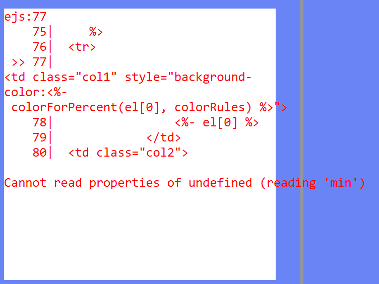

                    @OliverIO Hi, erst mal herzlichen Dank für den ersten Entwurf. Was ist das für eine Sprache?
                    Leider sind noch Fehler vorhanden, im VIS Editor sieht es noch gut aus, jedoch VIS runtime bringt Fehler.
                    Zur Ergänzung wären folgende Wünsche / Anmerkungen offen:
                    • du sortierst die Liste nochmals, wenn ich dies richtig sehe, sollte nicht nötig sein, da in Blockly vorsortiert
                    • mir wäre doch lieber, wenn die Texte farbig sind und natürlich beide Spalten.
                    VG Axel

                      OliverIOO Offline
                      OliverIOO Offline
                      OliverIO
                      @AFi
                      so hier die korrigierte Version.
                      Da hat leider der binding mechanismus von vis zugeschlagen.
                      der mag komprimierte JSON-Notation nicht so bzw. interpretiert das als binding.
                      Die Sortierung habe ich auskommentiert
                      Die Farbgebung habe ich nun auf Spalte 1 und Spalte 2 angewendet
                      Anstatt den Hintergrund habe ich nun die Schrift eingefärbt. Die eine Farbe müsste man wahrscheinlich noch anpassen, die ist vor Weißem Hintergrund schlecht lesbar.
                      [{"tpl":"tplJSONTemplate4","data":{"g_fixed":true,"g_visibility":false,"g_css_font_text":true,"g_css_background":true,"g_css_shadow_padding":false,"g_css_border":false,"g_gestures":false,"g_signals":false,"g_last_change":false,"visibility-cond":"==","visibility-val":1,"visibility-groups-action":"hide","json_dpCount":"1","signals-cond-0":"==","signals-val-0":true,"signals-icon-0":"/vis/signals/lowbattery.png","signals-icon-size-0":0,"signals-blink-0":false,"signals-horz-0":0,"signals-vert-0":0,"signals-hide-edit-0":false,"signals-cond-1":"==","signals-val-1":true,"signals-icon-1":"/vis/signals/lowbattery.png","signals-icon-size-1":0,"signals-blink-1":false,"signals-horz-1":0,"signals-vert-1":0,"signals-hide-edit-1":false,"signals-cond-2":"==","signals-val-2":true,"signals-icon-2":"/vis/signals/lowbattery.png","signals-icon-size-2":0,"signals-blink-2":false,"signals-horz-2":0,"signals-vert-2":0,"signals-hide-edit-2":false,"lc-type":"last-change","lc-is-interval":true,"lc-is-moment":false,"lc-format":"","lc-position-vert":"top","lc-position-horz":"right","lc-offset-vert":0,"lc-offset-horz":0,"lc-font-size":"12px","lc-font-family":"","lc-font-style":"","lc-bkg-color":"","lc-color":"","lc-border-width":"0","lc-border-style":"","lc-border-color":"","lc-border-radius":10,"lc-zindex":0,"json_template":"<% \nconst colorRules = [\n  { \n    max: 20,\n    color: \"#ff0000\" \n  }, // < 20%  -> rot\n  { \n    min: 20, \n    max: 30,\n    color: \"#ff9900\"\n  }, // 20-30% -> orange\n  {\n    min: 30,\n    max: 50,\n    color: \"#ffcc80\"\n  }, // 30-50% -> hellorange\n  // optional: \"default\"-Regel für alles darüber\n  {\n    min: 50,\n    color: \"#00aa00\"\n  }  // Beispiel: >= 50% -> grün\n];\nfunction colorForPercent(value, rules) {\n  const v = Number(value);\n\n  for (const rule of rules) {\n    const minOk = rule.min === undefined || v >= rule.min;\n    const maxOk = rule.max === undefined || v < rule.max;\n\n    if (minOk && maxOk) return rule.color;\n  }\n\n  return null; // oder eine Default-Farbe wie \"#000\"\n}\n%>\n\n<style>\n#<%- widgetID %> {\n    .table-wrapper{\n      height: 100%;          /* nutzt die 237px von #w00001 */\n      overflow-y: auto;      /* vertikal scrollen */\n      overflow-x: auto;      /* optional horizontal */\n    }\n    table {\n        color:#44739e;\n        box-sizing:border-box;\n        border-collapse: collapse;\n        white-space: normal;\n        height:100%\n    }\n    thead {\n\n    }\n    thead th {\n        height: 8px;\n        font-size:110%;\n        position: sticky;\n        top: 0;\n        z-index: 2;\n        color:#000000;\n        background-color:#337fe1;\n    }\n    td,th {\n        padding-left:2px;\n        padding-right:8px;\n    }\n    .col1 {\n        text-align:right;\n    }\n}\n</style>\n<div class=\"table-wrapper\">\n  <table>\n\t<thead>\n\t\t<tr>\n\t\t\t<th style=\"text-align: right;\">\n\t\t\t  Füllgrad\n\t\t\t</th>\n\t\t\t<th style=\"text-align: left;\">\n                Bezeichnung\n\t\t\t</th>\n\t\t</tr>\n\t</thead>\n\t<tbody>\n    <%\n    //data=data.sort((a, b) => a[0] - b[0]);\n    for (var i = 0; i < data.length ; i++ ) {\n    let el=data[i] \n    %>\n\t\t<tr>\n\t\t\t<td class=\"col1\" style=\"color:<%- colorForPercent(el[0], colorRules) %>\">\n                <%- el[0] %>\n            </td>\n\t\t\t<td class=\"col2\"style=\"color:<%- colorForPercent(el[0], colorRules) %>\">\n                <%- el[1] %>\n            </td>\n\t\t</tr>\n    <% } %>\n\t</tbody>\n</table>\n</div>\n","class":"","json_oid":"0_userdata.0.table"},"style":{"left":"43px","top":"33px","width":"388px","height":"337px","background-color":"","color":"","font-style":"","background":"#ffffff"},"widgetSet":"vis-jsontemplate"}]

                      • AFiA Offline
                        AFiA Offline
                        AFi
                        super, passt Danke.
