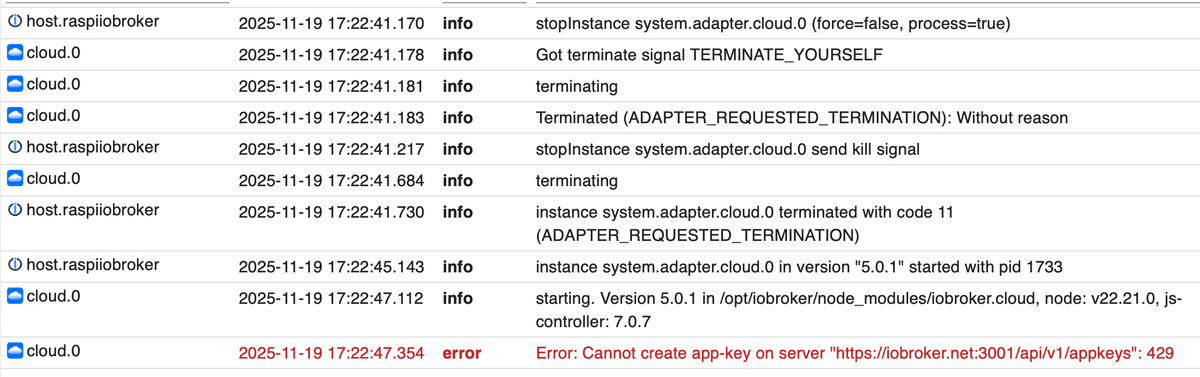

        jjmargis
        @Thomas-Braun

          @jjmargis
          Bitte keine Screenshots, sondern als TEXT (in CodeTags eingebettet) hier reinkopieren.

              jjmargis
              @Thomas-Braun
              Sorry, nicht dran gedacht
              2025-11-19 17:30:35.729 - info: host.raspiiobroker stopInstance system.adapter.cloud.0 (force=false, process=true)
              2025-11-19 17:30:35.734 - info: cloud.0 (1733) Got terminate signal TERMINATE_YOURSELF
              2025-11-19 17:30:35.736 - info: cloud.0 (1733) terminating
              2025-11-19 17:30:35.737 - info: cloud.0 (1733) Terminated (ADAPTER_REQUESTED_TERMINATION): Without reason
              2025-11-19 17:30:35.774 - info: host.raspiiobroker stopInstance system.adapter.cloud.0 send kill signal
              2025-11-19 17:30:36.239 - info: cloud.0 (1733) terminating
              2025-11-19 17:30:36.287 - info: host.raspiiobroker instance system.adapter.cloud.0 terminated with code 11 (ADAPTER_REQUESTED_TERMINATION)
              2025-11-19 17:30:39.726 - info: host.raspiiobroker instance system.adapter.cloud.0 in version "5.0.1" started with pid 1769
              2025-11-19 17:30:41.737 - info: cloud.0 (1769) starting. Version 5.0.1 in /opt/iobroker/node_modules/iobroker.cloud, node: v22.21.0, js-controller: 7.0.7
              2025-11-19 17:30:41.973 - error: cloud.0 (1769) Error: Cannot create app-key on server "https://iobroker.net:3001/api/v1/appkeys": 429
