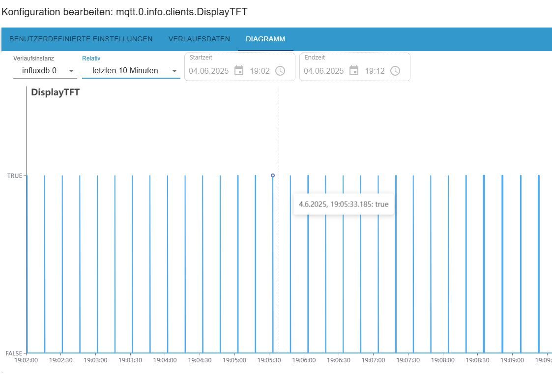

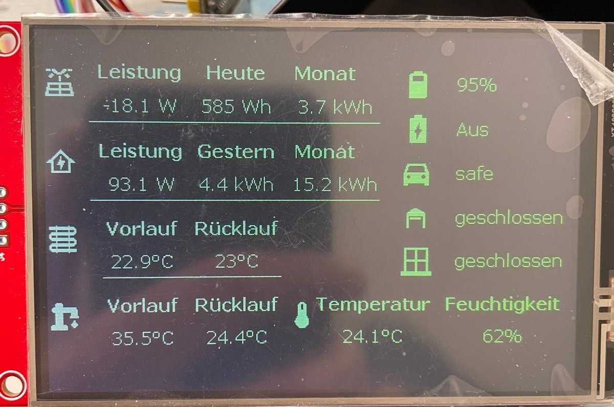

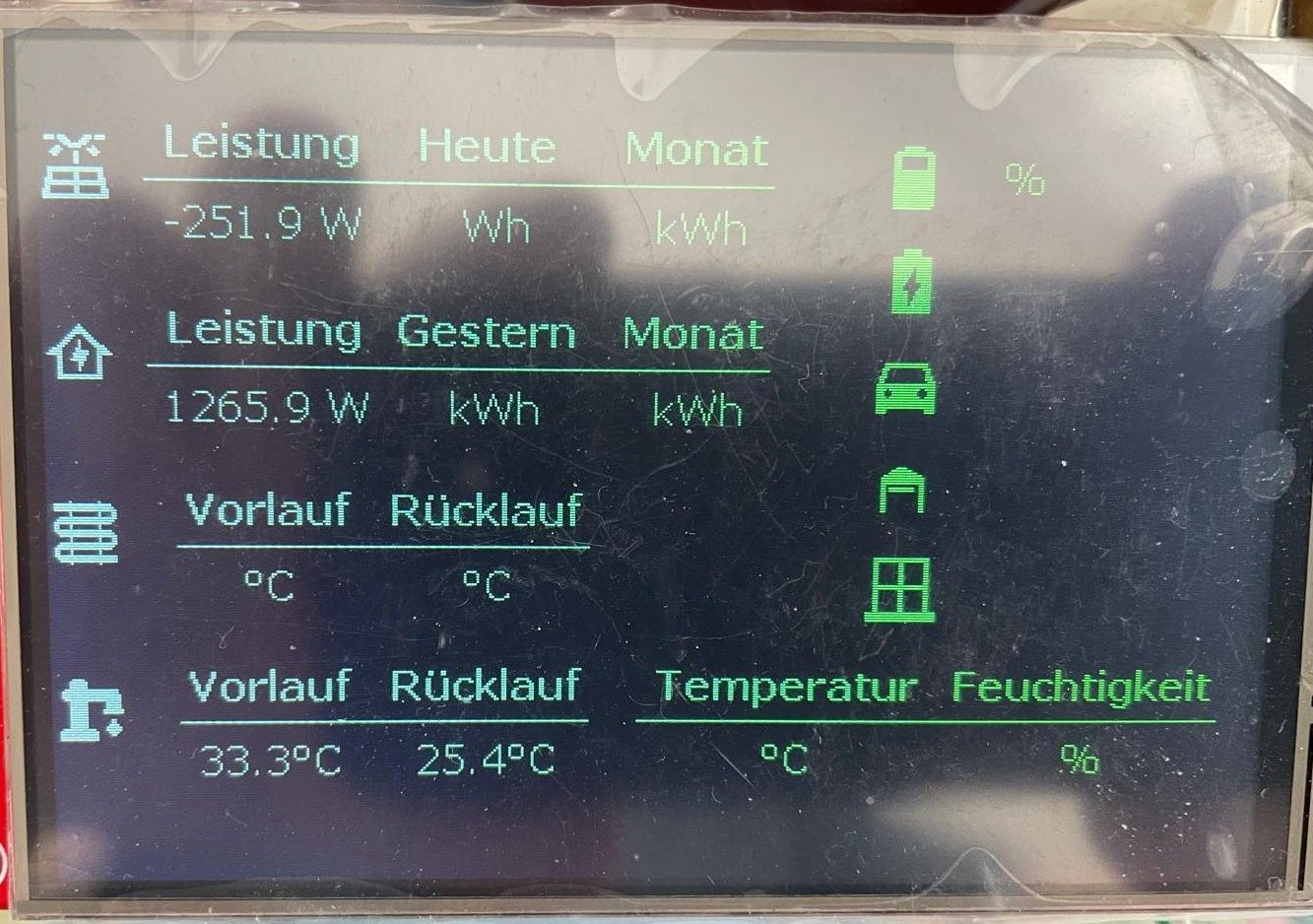

    Hallo Forum, ich habe ein Problem mit einem Display und ESPHome auch mit der v0.6.1: : manchmal sind alle Anzeigen sichtbar, manchmal aber nur wenige oder gar keine:
    Meine displaytft_s3.yaml
    Es kommen immer wieder sehr viele MQTT-Warnmeldungen wie diese:
    Client [DisplayTFT] Message 64489 deleted after 13 retries
    Nach dem Restart der Instanz kommt diese Fehlermeldung:
    esphome has an invalid jsonConfig: [{"instancePath":"/items/devices/items/encryptionKey",
    "schemaPath":"#/definitions/passwordProps/additionalProperties",
    "keyword":"additionalProperties",
    "params":{"additionalProperty":"freeSolo"},
    "message":"must NOT have additional properties"},{"instancePath":"/items/devices",
    "schemaPath":"#/properties/items/patternProperties/%5E.%2B/allOf/9/if","keyword":"if",
    "params":{"failingKeyword":"then"},
    "message":"must match \"then\" schema"},{"instancePath":"",
    "schemaPath":"#/if","keyword":"if",
    Die MQTT-Werte sind da und werden über ein Skript aktualisiert.

    [12:04:41][D][esp-idf:000]: E (660662) MQTT_CLIENT: Client has not connected
    [12:04:41][D][esp-idf:000]: E (660669) MQTT_CLIENT: Client has not connected
    [12:04:41][D][esp-idf:000]: E (660676) MQTT_CLIENT: Client has not connected
    [12:04:41][D][esp-idf:000]: E (660683) MQTT_CLIENT: Client has not connected
    [12:04:41][D][esp-idf:000]: E (660690) MQTT_CLIENT: Client has not connected
    [12:04:41][D][esp-idf:000]: E (660697) MQTT_CLIENT: Client has not connected
    [12:04:41][W][component:257]: Component mqtt took a long time for an operation (323 ms).
    [12:04:41][W][component:258]: Components should block for at most 30 ms.
    [12:04:41][D][text_sensor:064]: 'Solar_Einspeisung_Jetzt': Sending state '-18.6'
    [12:04:41][D][text_sensor:064]: 'Solar_Einspeisung_Heute': Sending state '78'
    [12:04:41][D][text_sensor:064]: 'Netz_Verbrauch_Jetzt': Sending state '71.2'
    [12:04:41][D][text_sensor:064]: 'Heizung_VL_Temperatur_Warmwasser': Sending state '33.6'
    [12:04:41][D][text_sensor:064]: 'Heizung_RL_Temperatur_Warmwasser': Sending state '29.3'
    [12:04:41][E][mqtt.idf:162]: MQTT_EVENT_ERROR
    [12:04:41][E][mqtt.idf:164]: Last error code reported from esp-tls: 0x0
    [12:04:41][E][mqtt.idf:165]: Last tls stack error number: 0x0
    [12:04:41][E][mqtt.idf:167]: Last captured errno : 0 (Success)
    [12:04:41][W][mqtt:344]: MQTT Disconnected: TCP disconnected.
    [12:04:41][I][mqtt:254]: Connecting to MQTT...
    [12:04:42][W][component:182]: Component mqtt cleared Warning flag
    [12:04:56][I][mqtt:295]: MQTT Connected!
    [12:04:56][D][text_sensor:064]: 'Solar_Einspeisung_Jetzt': Sending state '-18.9'
    [12:04:56][D][text_sensor:064]: 'Solar_Einspeisung_Heute': Sending state '78'
    [12:04:56][D][text_sensor:064]: 'Netz_Verbrauch_Jetzt': Sending state '87.9'
    [12:04:56][D][text_sensor:064]: 'Heizung_VL_Temperatur_Warmwasser': Sending state '33.6'
    [12:04:56][D][text_sensor:064]: 'Heizung_RL_Temperatur_Warmwasser': Sending state '29.3'
    [12:04:56][E][mqtt.idf:162]: MQTT_EVENT_ERROR
    [12:04:56][E][mqtt.idf:164]: Last error code reported from esp-tls: 0x0
    [12:04:56][E][mqtt.idf:165]: Last tls stack error number: 0x0
    [12:04:56][E][mqtt.idf:167]: Last captured errno : 0 (Success)
    [12:04:56][W][mqtt:344]: MQTT Disconnected: TCP disconnected.
    [12:04:56][W][component:167]: Component mqtt set Warning flag: unspecified
    [12:04:56][I][mqtt:254]: Connecting to MQTT...

    Auch in der Client-Liste von MQTT scheint die Verbindung ständig unterbrochen zu werden:
    Hat da jemand eine Idee?
