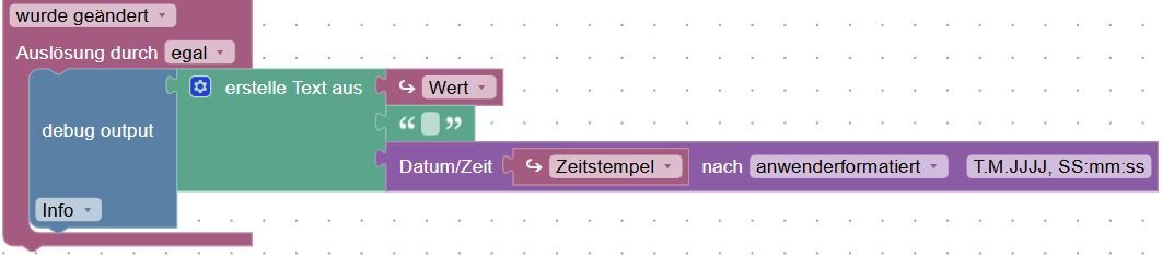

    Folgender Code erzeugt als Timestamp anscheinend definitiv keinen "LocaleString" kann jemand helfen?
    on({ id: [].concat(['mqtt.0.thermostat.logmsg']), change: 'ne' }, async (obj) => {
      let value = obj.state.val;
      let oldValue = obj.oldState.val;
      console.info(([(obj.state ? obj.state.val : ''),' ',(obj.state ? obj.state.ts.toLocaleString() : '')].join('')));
    2025-03-13 17:43:37.048  - info: javascript.0 (299058) script.js.Geräteüberwachung: Thermosensor[1] regained (3C1E0457CBD0) 1,741,884,217,032
