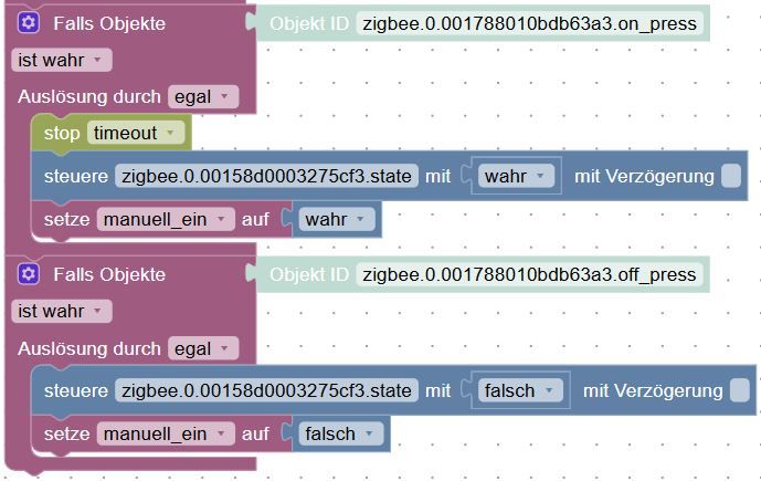

    im neuen sind es 2 unterschiedliche
      <block type="on_ext" id="3)0xb@gM3^9`aYO+ddjs" x="87" y="-112">
        <value name="OID0">
          <shadow type="field_oid" id="MUE-tV{njdV4VS:^YuW#">
            <field name="oid">zigbee.0.001788010bdb63a3.on_press</field>
          </shadow>
        </value>
        <statement name="STATEMENT">
          <block type="control" id="hH#8KL}T2emPgo!YHqwM">
            <field name="OID">zigbee.0.00158d0003275cf3.state</field>
            <value name="VALUE">
              <block type="logic_boolean" id=",Al96J;tkLE+[!tOC_TT">
              </block>
            </value>
          </block>
        </statement>
        <next>
          <block type="on_ext" id="bu0Nedy?)lN++yIzSXYy">
            <value name="OID0">
              <shadow type="field_oid" id="y$w*dkn%~kg)b.vi2LGJ">
                <field name="oid">zigbee.0.001788010bdb63a3.off_press</field>
              </shadow>
            </value>
              <block type="control" id="b9)`|#xwOkHj#J8H|x4}">
                  <block type="logic_boolean" id="#1]Qdl:%w-*|bvSGgjNJ">
                  </block>
                </value>
              </block>
            </statement>
          </block>
        </next>
      </block>
    </xml>
          <value name="OID0">
            </shadow>
          </value>
                </block>
              </value>
            </block>
          </statement>
          <next>
              <value name="OID0">
                </shadow>
              </value>
                    </block>
                  </value>
                </block>
              </statement>
            </block>
          </next>
        </block>
      </xml>

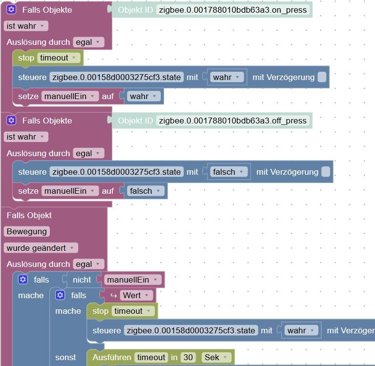

        Das ist das alte script mit bewegungsmelder
          <variables>
            <variable id="oSQQ2fSPDU*qU`rN:}(2">manuell_ein</variable>
            <variable type="timeout" id="timeout">timeout</variable>
          </variables>
          <block type="on_ext" id=")7viWO.,ae+4/i$Su{v1" x="123" y="-645">
            <value name="OID0">
              <shadow type="field_oid" id="C{a`XU,:c^M[AsDI7qnt">
                <field name="oid">zigbee.0.bc33acfffec14868.occupancy</field>
              </shadow>
            </value>
              <block type="controls_if" id="9DsA`f[*y[El#p^C2%KJ">
                <value name="IF0">
                  <block type="logic_negate" id="]lJ$,j5ZAt!F_OH~3dPJ">
                    <value name="BOOL">
                      <block type="variables_get" id=".ga$.J5quUYHnJ$p!JMm">
                        <field name="VAR" id="oSQQ2fSPDU*qU`rN:}(2">manuell_ein</field>
                      </block>
                    </value>
                  </block>
                </value>
                <statement name="DO0">
                  <block type="controls_if" id="_LepHk2DO1;iMdeh~a2%">
                    <value name="IF0">
                      <block type="logic_operation" id="al@D4zbs@a1Hl4,p2,=#" inline="false">
                        <field name="OP">AND</field>
                        <value name="B">
                          <block type="on_source" id="Ky@{xEqs3cF|h-fMkq0s">
                          </block>
                        </value>
                      </block>
                    </value>
                      <block type="timeouts_cleartimeout" id="0I-sY/$R5#4_j|mwo80c">
                        <next>
                          <block type="controls_if" id="7M)STun%Th0%[,s830xz">
                            <value name="IF0">
                              <block type="logic_negate" id="X[cT]3:Cqum?`;{Qo!5N">
                                <value name="BOOL">
                                  <block type="get_value" id="Tj5cklBH,7}eUyV46O,0">
                                  </block>
                                </value>
                              </block>
                            </value>
                              <block type="control" id="pfAa@mhg2tdjGForYOK(">
                                  <block type="logic_boolean" id="cpv%OP+fg[x*Qd`Gr6NN">
                                  </block>
                                </value>
                                <next>
                                  <block type="control" id="qD)6D1AMS,$W,~NY:RD$">
                                    <field name="OID">zigbee.0.00158d0003275cf3.brightness</field>
                                      <block type="get_value" id="%V{6.cnTS#f,1r!EM?vL">
                                        <field name="OID">0_userdata.0.Sonstieges.Farbtemperatur.Helldunkel_nach_Zeit</field>
                                      </block>
                                    </value>
                                    <next>
                                      <block type="control" id="I/s7EPsv2CY=Hv?Ua-R#">
                                        <field name="OID">zigbee.0.00158d0003275cf3.colortemp</field>
                                          <block type="get_value" id="`,;7T7Is)a*Kl~roS~Fg">
                                            <field name="OID">0_userdata.0.Sonstieges.Farbtemperatur.Kalt_Warm</field>
                                          </block>
                                        </value>
                                      </block>
                                    </next>
                                  </block>
                                </next>
                              </block>
                            </statement>
                          </block>
                        </next>
                      </block>
                    </statement>
                    <statement name="ELSE">
                      <block type="timeouts_settimeout" id="1;lyA@b?X+`r[NP8asP%">
                        <field name="DELAY">2</field>
                        <field name="UNIT">min</field>
                          <block type="controls_if" id="wye@q.,:qFUo-yr{qC/;">
                            <value name="IF0">
                              <block type="get_value" id="ZG#|FoPrKpBt2=an^%6T">
                              </block>
                            </value>
                              <block type="control" id="nh8Y1!h#oxfCpka$9MOP">
                                  <block type="logic_boolean" id="KzzUYq@FR=cqOTZ$JFrl">
                                  </block>
                                </value>
                              </block>
                            </statement>
                          </block>
                        </statement>
                      </block>
                    </statement>
                  </block>
                </statement>
              </block>
            </statement>
            <next>
              <block type="on_ext" id="ov}D(Be]`(nzX#Js!}]h">
                <value name="OID0">
                  <shadow type="field_oid" id="SAKP82;OM?2N%*fzz[{{">
                  </shadow>
                </value>
                  <block type="control" id="y7[mgz]-NK5R{5ajJg|4">
                      <block type="on_source" id="x}P/*I%sVvM{9=$Nd)ln">
                      </block>
                    </value>
                    <next>
                      <block type="variables_set" id="iA|yzw[fYyfX#3gi%pcq">
                          <block type="on_source" id="Rx]e4#tp[EJaM4_]T6Y^">
                          </block>
                        </value>
                        <next>
                          <block type="controls_if" id="?[IJ/6:3lbB5u-m,QzBJ">
                            <value name="IF0">
                              <block type="variables_get" id="ku~F=kmsW^D]e/3T{6]5">
                              </block>
                            </value>
                              <block type="timeouts_cleartimeout" id="j9UA4-ObYtdM3kj4!fvq">
                              </block>
                            </statement>
                          </block>
                        </next>
                      </block>
                    </next>
                  </block>
                </statement>
              </block>
            </next>
          </block>
        </xml>

          @horst-böttcher sagte: Das ist das alte script mit bewegungsmelder
          ... und das funktioniert nicht?
          Wie verhalten sich "on_press" und "off_press"?
          Horst BöttcherH 1 Antwort Letzte Antwort
            Horst BöttcherH Offline
            Horst Böttcher
            Press on und off gehen kurz auf True und dann wieder auf false
            das ist dieser Taster
            ioBroker auf Proxmox (Debian) auf LENOVO PC Thinkcentre als Produktivsystem
            • Horst BöttcherH Horst Böttcher

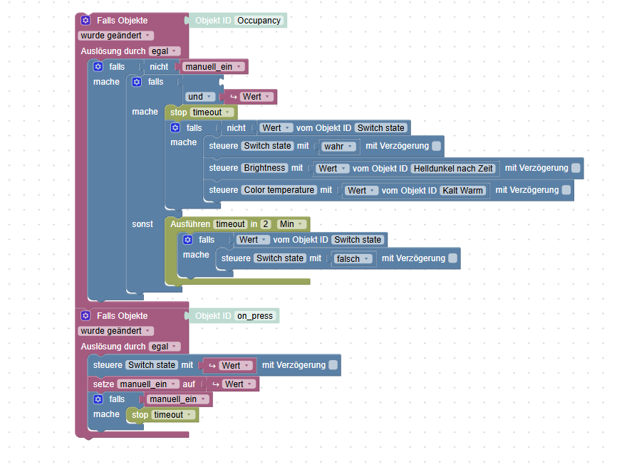

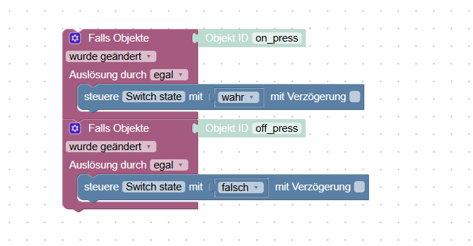

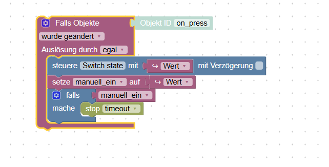

              @horst-böttcher sagte: das alte script mit bewegungsmelder
              ... Press on und off gehen kurz auf True und dann wieder auf false
              Dann ersetze den unteren Trigger durch folgende:
              Horst BöttcherH 2 Antworten Letzte Antwort

                  @paul53 dank dir geht super
