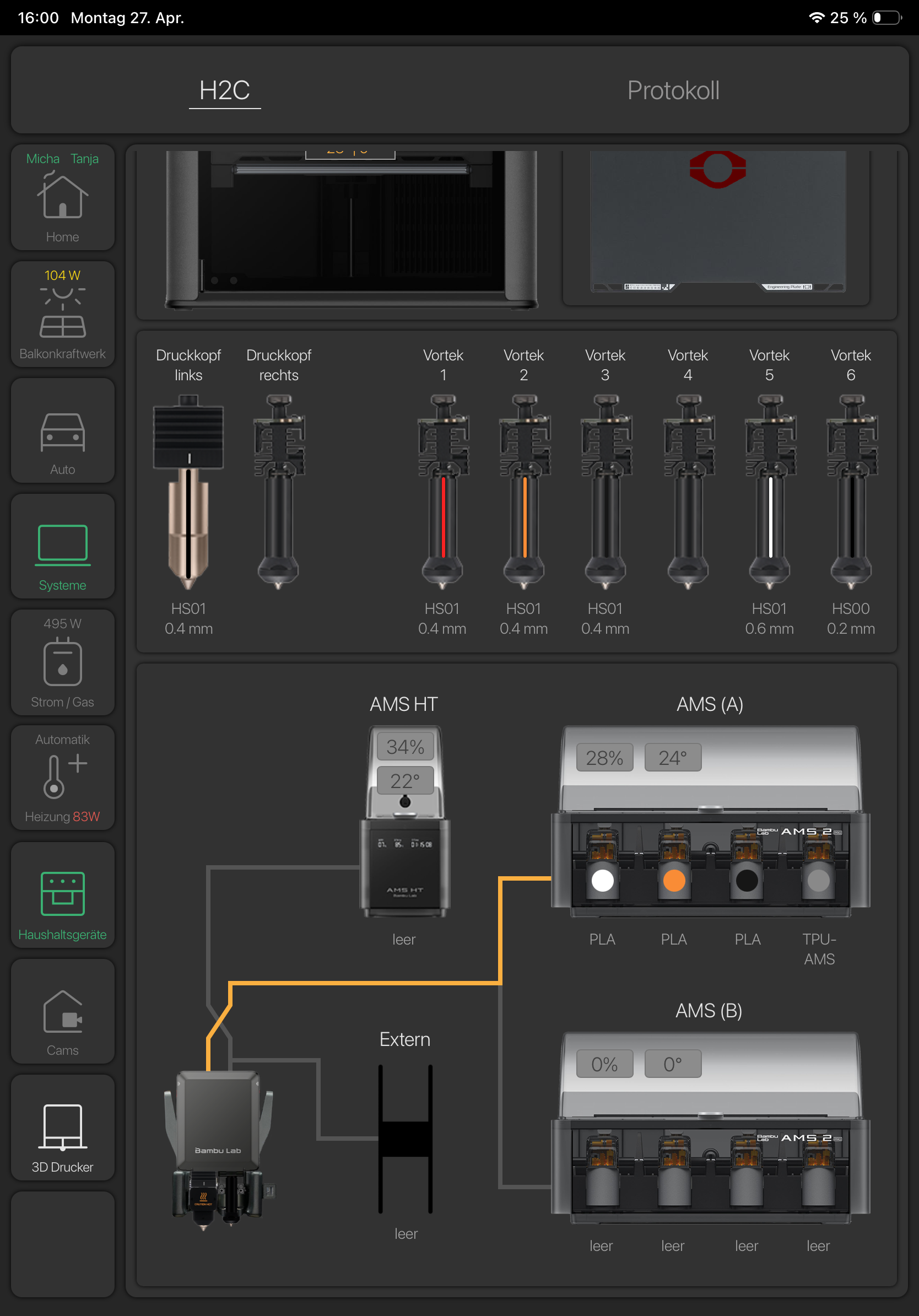

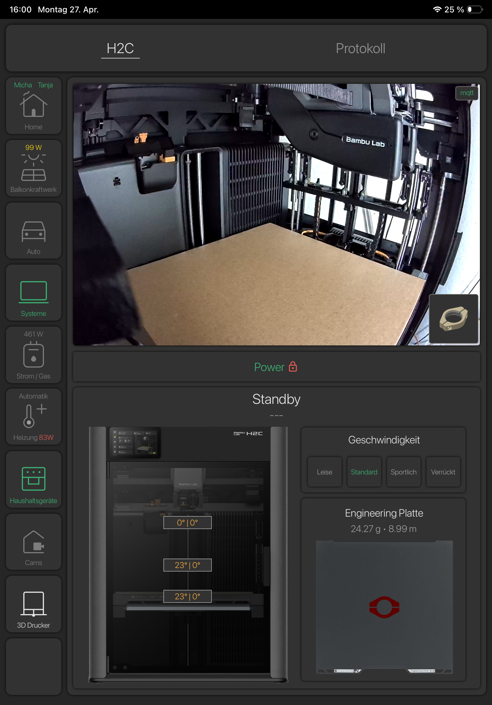

      ... update :)
      Meine neue VIS für ein ausrangiertes Tablet im Büro:
      Die Haupt-VIS:
      Die Handy-VIS:

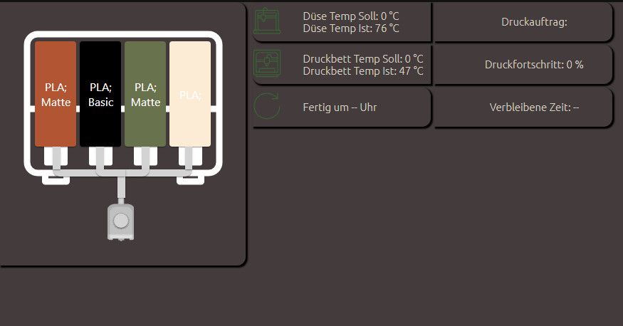

                  Hallo zusammen, habe hier meine Bambulab VIS:
                  ![Bild Text](da64e99c-da8e-4852-b59e-8128ec19c8e0-image.jpeg Bild Link)
                  Habe dieses Skript
                  • BambuLab AMS 0 + TEMP + PRINT + MEROSS
                  • Komplett-Skript ohne AMS 1
                  • Enthält:
                    • AMS 0 Tray 0 bis 3
                    • Farben + Schriftfarben
                    • Werte: Materialtyp;Filament-Untertyp
                    • aktiver Tray
                    • Temperatur
                    • Druckstatus
                    • Meross Adaptersteuerung
                  const printerId = '01S00C321500283';
                  const baseBambu = bambulab.0.${printerId};
                  const baseAMS = '0_userdata.0.Bambulab.AMS';
                  const baseTemp = '0_userdata.0.Bambulab.Temp';
                  const basePrint = '0_userdata.0.Bambulab.Print';
                  const merossId = 'meross.0.2303167546755151200348e1e9beebff.0';
                  const adapterId = 'system.adapter.bambulab.0';
                  const trayNowId = ${baseBambu}.ams.tray_now;
                  const trayCount = 4;
                  const defaultColor = '#D3D3D3';
                  const refreshMs = 10000;
                  const tempSources = {
                  bedActual: ${baseBambu}.bed_temper,
                  bedTarget: ${baseBambu}.bed_target_temper,
                  nozzleActual: ${baseBambu}.nozzle_temper,
                  nozzleTarget: ${baseBambu}.nozzle_target_temper
                  const printSources = {
                  percent: ${baseBambu}.mc_percent,
                  file: ${baseBambu}.gcode_file,
                  state: ${baseBambu}.gcode_state,
                  remaining: ${baseBambu}.mc_remaining_time
                  // Hilfsfunktionen
                  function create(id, def, type = null, role = 'state') {
                  if (!existsState(id)) {
                  createState(id, {
                  type: type || typeof def,
                  role,
                  read: true,
                  write: true,
                  def
                  }, () => setState(id, def, true));
                  function get(id) {
                  const state = getState(id);
                  return state ? state.val : undefined;
                  function set(id, val) {
                  if (!state || state.val !== val) {
                      setState(id, val, true);
                  function normalizeColor(raw) {
                  let c = String(raw ?? '').replace('#', '').trim();
                  c = c.replace(/[^0-9A-Fa-f]/g, '');
                  if (c.length >= 6) {
                      return `#${c.substring(0, 6)}`.toUpperCase();
                  return defaultColor;
                  function getTextColor(color) {
                  return String(color).toLowerCase() === '#000000' ? '#FFFFFF' : '#000000';
                  function formatTemp(v) {
                  const n = Number(v);
                  return isNaN(n) ? '-- °C' : ${Math.floor(n)} °C;
                  function parseRemaining(value) {
                  if (value === null || value === undefined || value === '') return 0;
                  const s = String(value).trim();
                  const hm = s.match(/^(\d+):(\d+)$/);
                  if (hm) return Number(hm[1]) * 60 + Number(hm[2]);
                  if (!isNaN(Number(s))) return Number(s);
                  return 0;
                  function formatRemaining(value) {
                  const minutes = parseRemaining(value);
                  if (minutes <= 0) return '--';
                  const h = Math.floor(minutes / 60);
                  const m = Math.floor(minutes % 60);
                  return h > 0 ? `${h}h ${m}m` : `${m} min`;
                  function finishTime(value) {
                  const end = new Date(Date.now() + minutes * 60000);
                  return end.toLocaleTimeString('de-DE', {
                      hour: '2-digit',
                      minute: '2-digit'
                  // Datenpunkte erstellen
                  function createStates() {
                  // AMS allgemein
                  create(`${baseAMS}.Aktiver_Tray`, 255, 'number', 'value');
                  create(`${baseAMS}.Farbe_aktiv`, defaultColor, 'string', 'value.color');
                  create(`${baseAMS}.AMS_Farbe_aktiv`, defaultColor, 'string', 'value.color');
                  // Aktive Tray-Boolean-Datenpunkte nur AMS 0
                  create(`${baseAMS}.AMS0_Tray0`, false, 'boolean', 'indicator');
                  create(`${baseAMS}.AMS0_Tray1`, false, 'boolean', 'indicator');
                  create(`${baseAMS}.AMS0_Tray2`, false, 'boolean', 'indicator');
                  create(`${baseAMS}.AMS0_Tray3`, false, 'boolean', 'indicator');
                  // AMS 0 Tray 0 bis 3
                  for (let tray = 0; tray < trayCount; tray++) {
                      // Struktur mit .0.
                      create(`${baseAMS}.0.Farbe_Tray_${tray}`, defaultColor, 'string', 'value.color');
                      create(`${baseAMS}.0.Schriftfarbe_Tray_${tray}`, '#000000', 'string', 'value.color');
                      create(`${baseAMS}.0.Werte_Tray_${tray}`, '', 'string', 'text');
                      // Einfache Struktur
                      create(`${baseAMS}.Farbe_Tray_${tray}`, defaultColor, 'string', 'value.color');
                      create(`${baseAMS}.Schriftfarbe_Tray_${tray}`, '#000000', 'string', 'value.color');
                      create(`${baseAMS}.Werte_Tray_${tray}`, '', 'string', 'text');
                  // Temperaturen
                  create(`${baseTemp}.Ist_Druckbett`, '-- °C', 'string', 'text');
                  create(`${baseTemp}.Soll_Druckbett`, '-- °C', 'string', 'text');
                  create(`${baseTemp}.Ist_Duese`, '-- °C', 'string', 'text');
                  create(`${baseTemp}.Soll_Duese`, '-- °C', 'string', 'text');
                  // Print
                  create(`${basePrint}.Fortschritt`, 0, 'number', 'value');
                  create(`${basePrint}.Datei`, '', 'string', 'text');
                  create(`${basePrint}.Status`, 'BEREIT', 'string', 'text');
                  create(`${basePrint}.Restzeit`, '--', 'string', 'text');
                  create(`${basePrint}.Fertig_um`, '--', 'string', 'text');
                  // AMS Farben + Schriftfarben + Werte
                  function updateAMS() {
                      updateAmsTrayColor(tray);
                      updateAmsTrayWerte(tray);
                  updateActiveAmsTray();
                  function updateAmsTrayColor(tray) {
                  const sourceColorId = `${baseBambu}.ams.ams.0.tray.${tray}.tray_color`;
                  const color = normalizeColor(get(sourceColorId));
                  const textColor = getTextColor(color);
                  // Struktur mit .0.
                  set(`${baseAMS}.0.Farbe_Tray_${tray}`, color);
                  set(`${baseAMS}.0.Schriftfarbe_Tray_${tray}`, textColor);
                  set(`${baseAMS}.Farbe_Tray_${tray}`, color);
                  set(`${baseAMS}.Schriftfarbe_Tray_${tray}`, textColor);
                  function updateAmsTrayWerte(tray) {
                  const trayType = get(`${baseBambu}.ams.ams.0.tray.${tray}.tray_type`) ?? '';
                  const subBrands = get(`${baseBambu}.ams.ams.0.tray.${tray}.tray_sub_brands`) ?? '';
                  // Nur Materialtyp und Filament-Untertyp
                  const wert = `${trayType};${subBrands}`;
                  // Struktur mit .0.
                  set(`${baseAMS}.0.Werte_Tray_${tray}`, wert);
                  set(`${baseAMS}.Werte_Tray_${tray}`, wert);
                  // Aktives AMS / aktiver Tray
                  function updateActiveAmsTray() {
                  const trayNow = Number(get(trayNowId));
                  const trayStateNames = [
                      'AMS0_Tray0',
                      'AMS0_Tray1',
                      'AMS0_Tray2',
                      'AMS0_Tray3'
                  // Erst alle Trays auf false setzen
                  for (const name of trayStateNames) {
                      set(`${baseAMS}.${name}`, false);
                  // Kein aktiver Tray oder ungültiger Wert
                  if (isNaN(trayNow) || trayNow === 255 || trayNow < 0 || trayNow > 3) {
                      set(`${baseAMS}.Aktiver_Tray`, 255);
                      set(`${baseAMS}.Farbe_aktiv`, defaultColor);
                      set(`${baseAMS}.AMS_Farbe_aktiv`, defaultColor);
                      return;
                  // Aktiven Tray setzen
                  set(`${baseAMS}.Aktiver_Tray`, trayNow);
                  set(`${baseAMS}.${trayStateNames[trayNow]}`, true);
                  const activeColor = get(`${baseAMS}.0.Farbe_Tray_${trayNow}`) || defaultColor;
                  set(`${baseAMS}.Farbe_aktiv`, activeColor);
                  set(`${baseAMS}.AMS_Farbe_aktiv`, activeColor);
                  // Temperaturen
                  function updateTemp() {
                  set(${baseTemp}.Ist_Druckbett, formatTemp(get(tempSources.bedActual)));
                  set(${baseTemp}.Soll_Druckbett, formatTemp(get(tempSources.bedTarget)));
                  set(${baseTemp}.Ist_Duese, formatTemp(get(tempSources.nozzleActual)));
                  set(${baseTemp}.Soll_Duese, formatTemp(get(tempSources.nozzleTarget)));
                  // Druckstatus
                  function updatePrint() {
                  const percent = Number(get(printSources.percent)) || 0;
                  const file = String(get(printSources.file) ?? '');
                  const rawState = String(get(printSources.state) ?? '').toUpperCase();
                  const remainingRaw = get(printSources.remaining);
                  const remaining = parseRemaining(remainingRaw);
                  let status = rawState || 'BEREIT';
                  if (remaining > 0 && percent > 0 && percent < 100) {
                      status = 'DRUCKT';

                    @mdumbsky Hi habe ein wenig deine Blckly Skripte geändert in Java Skript vielleicht ist das was für dich:
                    * BambuLab AMS 0 + TEMP + PRINT + MEROSS
                    * Komplett-Skript ohne AMS 1
                    * Enthält:
                    * - AMS 0 Tray 0 bis 3
                    * - Farben + Schriftfarben
                    * - Werte: Materialtyp;Filament-Untertyp
                    * - aktiver Tray
                    * - Temperatur
                    * - Druckstatus
                    * - Meross Adaptersteuerung
                    const baseBambu = `bambulab.0.${printerId}`;
                    const trayNowId = `${baseBambu}.ams.tray_now`;
                       bedActual: `${baseBambu}.bed_temper`,
                       bedTarget: `${baseBambu}.bed_target_temper`,
                       nozzleActual: `${baseBambu}.nozzle_temper`,
                       nozzleTarget: `${baseBambu}.nozzle_target_temper`
                       percent: `${baseBambu}.mc_percent`,
                       file: `${baseBambu}.gcode_file`,
                       state: `${baseBambu}.gcode_state`,
                       remaining: `${baseBambu}.mc_remaining_time`
                    // Hilfsfunktionen
                           createState(id, {
                               role,
                               read: true,
                               write: true,
                               def
                    function get(id) {
                       return isNaN(n) ? '-- °C' : `${Math.floor(n)} °C`;
                       return 0;
                           hour: '2-digit',
                           minute: '2-digit'
                       // AMS allgemein
                           // Struktur mit .0.
                       // Temperaturen
                       // Print
                       // Struktur mit .0.
                       // Struktur mit .0.
                           'AMS0_Tray0',
                           'AMS0_Tray1',
                           'AMS0_Tray2',
                           'AMS0_Tray3'
                           return;
                    // Temperaturen
                       set(`${baseTemp}.Ist_Druckbett`, formatTemp(get(tempSources.bedActual)));
                       set(`${baseTemp}.Soll_Druckbett`, formatTemp(get(tempSources.bedTarget)));
                       set(`${baseTemp}.Ist_Duese`, formatTemp(get(tempSources.nozzleActual)));
                       set(`${baseTemp}.Soll_Duese`, formatTemp(get(tempSources.nozzleTarget)));
                    // Druckstatus
                           status = 'DRUCKT';
                       } else if (percent >= 100) {
                           status = 'FERTIG';
                       } else if (
                           rawState.includes('FAIL') ||
                           rawState.includes('CANCEL') ||
                           rawState.includes('ABORT')
                           status = 'ABGEBROCHEN';
                       } else if (remaining <= 0 && percent <= 0) {
                           status = 'BEREIT';
                       set(`${basePrint}.Status`, status);
                       if (status === 'DRUCKT') {
                           set(`${basePrint}.Fortschritt`, percent);
                           set(`${basePrint}.Datei`, file);
                           set(`${basePrint}.Restzeit`, formatRemaining(remainingRaw));
                           set(`${basePrint}.Fertig_um`, finishTime(remainingRaw));
                       } else {
                           set(`${basePrint}.Fortschritt`, 0);
                           set(`${basePrint}.Datei`, '');
                           set(`${basePrint}.Restzeit`, '--');
                           set(`${basePrint}.Fertig_um`, '--');
                    // Alles aktualisieren
                    function updateAll() {
                       updateAMS();
                       updateTemp();
                       updatePrint();
                    // Trigger
                    // Meross Steckdose / BambuLab Adapter
                    on({ id: merossId, change: 'any' }, obj => {
                       const isOn = obj.state.val === true || obj.state.val === 1 || obj.state.val === 'true';
                       setState(`${adapterId}.alive`, isOn);
                       if (isOn) {
                           setTimeout(updateAll, 8000);
                    // AMS Änderungen nur AMS 0
                    on({
                           trayNowId,
                           new RegExp(`^bambulab\\.0\\.${printerId}\\.ams\\.ams\\.0\\.tray\\.[0-3]\\.`),
                           `${baseBambu}.sequence_id`
                       change: 'any'
                    }, updateAMS);
                    // Temperatur Änderungen
                    on({
                       change: 'any'
                    }, updateTemp);
                    // Druckstatus Änderungen
                    on({
                       change: 'any'
                    }, updatePrint);
                    // Start
                    createStates();
                    setTimeout(updateAll, 3000);
                    setInterval(updateAll, refreshMs);

                      ich bin noch nicht ganz fertig, aber so wird meine aussehen.

                        Frage: woher bekomme ich die Icons der AMS ?

                          @stenmic Das sieht klasse aus. Kannst du die beiden Views und die Bilder zur Verfügung stellen?
