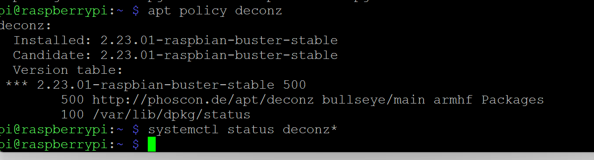

          @Thomas Braun
          • M Mico
            @Thomas Braun

              Mico
              @thomas-braun
              So richtig:
              pi@raspberrypi:~ $ sudo apt update
              Hit:1 http://phoscon.de/apt/deconz bullseye InRelease
              Hit:2 http://raspbian.raspberrypi.org/raspbian bullseye InRelease
              Hit:3 http://archive.raspberrypi.org/debian bullseye InRelease
              Get:4 https://deb.nodesource.com/node_18.x bullseye InRelease [4,586 B]
              Fetched 4,586 B in 1s (4,647 B/s)
              Reading package lists... Done
              Building dependency tree... Done
              Reading state information... Done
              5 packages can be upgraded. Run 'apt list --upgradable' to see them.
              pi@raspberrypi:~ $ apt policy deconz
              deconz:
                Installed: 2.23.01-raspbian-buster-stable
                Candidate: 2.23.01-raspbian-buster-stable
                Version table:
               *** 2.23.01-raspbian-buster-stable 500
                      500 http://phoscon.de/apt/deconz bullseye/main armhf Packages
                      100 /var/lib/dpkg/status
              pi@raspberrypi:~ $ systemctl status deconz*
              pi@raspberrypi:~ $

                @mico sagte in Cobee II Instalation auf Raspberry 4:
                Schmeiß die Updates auf das System.
                sudo systemctl unhide deconz
