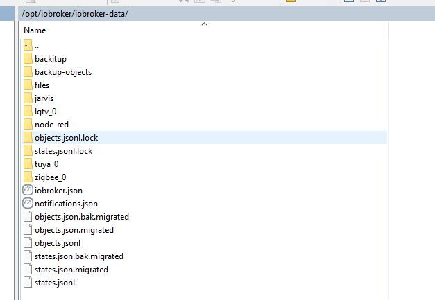

          • 1Topf1 1Topf
            @thomas-braun
            iobroker@ioBroker:~$ ls -lah /opt/iobroker/iobroker-data/
            ls: Zugriff auf '/opt/iobroker/iobroker-data/history' nicht möglich: Datei oder Verzeichnis nicht gefunden
            insgesamt 32M
            drwxrwxrwx+ 13 iobroker iobroker 4,0K 17. Sep 23:49 .
            drwxrwxr-x+  6 iobroker iobroker 4,0K 17. Sep 22:41 ..
            drwxrwxrwx+  2 iobroker iobroker 4,0K 25. Feb 2022  backitup
            drwxrwxrwx+  2 iobroker iobroker  12K 17. Sep 20:48 backup-objects
            drwxrwxrwx+ 92 iobroker iobroker 4,0K 17. Sep 22:49 files
            d??????????  ? ?        ?           ?             ? history
            -rwxrwxrwx+  1 iobroker iobroker 3,6K 23. Nov 2022  iobroker.json
            drwxrwxrwx+  3 iobroker iobroker 4,0K  7. Mai 2022  jarvis
            drwxrwxrwx+  2 iobroker iobroker 4,0K 23. Dez 2022  lgtv_0
            drwxrwxrwx+  4 iobroker iobroker 4,0K 21. Nov 2021  node-red
            -rwxrwxrwx+  1 iobroker iobroker    3 17. Sep 22:38 notifications.json
            -rwxrwxrwx+  1 iobroker iobroker 6,0M  4. Mär 2022  objects.json.bak.migrated
            -rw-rw-r--+  1 iobroker iobroker  14M 17. Sep 23:52 objects.jsonl
            drwxrwxr-x+  2 iobroker iobroker 4,0K 17. Sep 23:55 objects.jsonl.lock
            -rwxrwxrwx+  1 iobroker iobroker 6,0M  4. Mär 2022  objects.json.migrated
            -rwxrwxrwx+  1 iobroker iobroker 1,1M  4. Mär 2022  states.json.bak.migrated
            -rw-rw-r--+  1 iobroker iobroker 3,6M 17. Sep 23:54 states.jsonl
            drwxrwxr-x+  2 iobroker iobroker 4,0K 17. Sep 23:55 states.jsonl.lock
            -rwxrwxrwx+  1 iobroker iobroker 1,1M  4. Mär 2022  states.json.migrated
            drwxrwxrwx+  4 iobroker iobroker 4,0K 12. Okt 2022  tuya_0
            drwxrwxrwx+  2 iobroker iobroker 4,0K 23. Nov 2022  zigbee_0

            find: '/opt/iobroker/iobroker-data/history': No such file or directory
            14M     /opt/iobroker/iobroker-data/objects.jsonl
            6.0M    /opt/iobroker/iobroker-data/objects.json.migrated
            6.0M    /opt/iobroker/iobroker-data/objects.json.bak.migrated
            7.6M    /opt/iobroker/iobroker-data/states.jsonl
            1.1M    /opt/iobroker/iobroker-data/states.json.migrated
            1.1M    /opt/iobroker/iobroker-data/states.json.bak.migrated

              der mount paßt, da hat sich nix geändert. Es gibt aber keinen Ordner mehr unter "iobroker-data". Den gab es immer. Wieso ist der augenscheinlich nicht mehr sichtbar? Laut Konsole gibt es ihn, laut "iob fix" nicht.
              Das ganze lief ja auch bis vorgestern. Dann habe ich nachts auf JS-Controller 5 hochgezogen und 3 od. 4 Updates im ioB gemacht.
              2023-09-17 00:48:53.011  - info: host.ioBroker instance system.adapter.history.0 started with pid 3596738
              2023-09-17 00:49:16.328  - info: history.0 (3596738) starting. Version 2.2.6 in /opt/iobroker/node_modules/iobroker.history, node: v18.17.1, js-controller: 5.0.12
              2023-09-17 00:51:44.940  - error: history.0 (3596738) Cannot store file /opt/iobroker/iobroker-data/history/20230917/history.enigma2.0.enigma2.STANDBY.json: Error: ENOENT: no such file or directory, mkdir '/opt/iobroker/iobroker-data/history/20230917'
              2023-09-17 00:51:44.965  - warn: history.0 (3596738) Error reading data directory /opt/iobroker/iobroker-data/history/: Error: ENOENT: no such file or directory, scandir '/opt/iobroker/iobroker-data/history/'
              So, jetzt fällt mir was auf. Auf dem NAS wurde wieder ein Ordner für den heutigen Tag angelegt und mit Daten gefüllt. Ordner auf ioB-Rechner fehlt weiterhin.

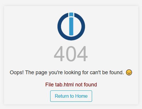

              ABER sämtliche ECharts drehen sich zu tote, und die Adaptereinstellungen lassen sich nicht aufrufen.
              Also vermutlich läuft History wieder, aber da jetzt der EChartsadapter spinnt, bekomm ich nix angezeigt. Ich glaub, ich mach keine Updates mehr ... 😁 ... sehe gerade, daß Admin heut auch ein Update will ... 🤞
              Ist irgendein Prob mit dem EChartsadapter bekannt? Ich brauch ein Bier ...

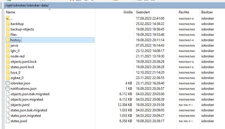

                    Es liegt wohl am EChartsadapt. Den hab ich gelöscht (Instanz + Adapter). Dann neue Adapterinstallation angestuppst -> System hat sich komplett aufgehängt. Ich mußte den Rechner per Knopfdruck neu starten, weil ich nicht mal per WinSCP drauf kam. Dann war auch plötzlich mein Historyordner wieder da inkl. allen Unterordnern.
                    Nun ECharts Instanz hinzufügen angeklickt, Installation beginnt, Rechner hängt wieder (ca. 5 Minuten), dann kann man ioB wider erreichen. Es gibt aber keine EChartsinstanz. Das scheint (zumindest bei mir) alles mit dem Update vom JS-Controller zu tun zu haben. Vorher lief alles seit Monaten problemlos ☹ . Auf Github gibt es ja neuere Versionen als die 1.5.1. Ob ich das "Risiko" mal eingehe und die installiere? Die 1.5.1 läuft bei mir jedenfalls nicht mehr. @Bluefox
