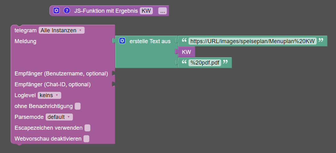

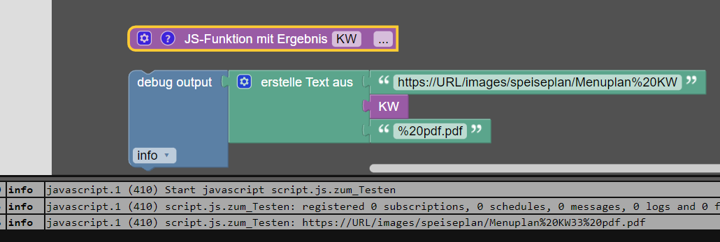

      @darkdevil so vielleicht
      in der Funktion dann das
      var date = new Date();
      var currentThursday = new Date(date.getTime() +(3-((date.getDay()+6) % 7)) * 86400000);
      var yearOfThursday = currentThursday.getFullYear();
      var firstThursday = new Date(new Date(yearOfThursday,0,4).getTime() +(3-((new Date(yearOfThursday,0,4).getDay()+6) % 7)) * 86400000);
      var weekNumber = Math.floor(1 + 0.5 + (currentThursday.getTime() - firstThursday.getTime()) / 86400000/7);
      return (weekNumber);
      Gruß Nordischerjung
