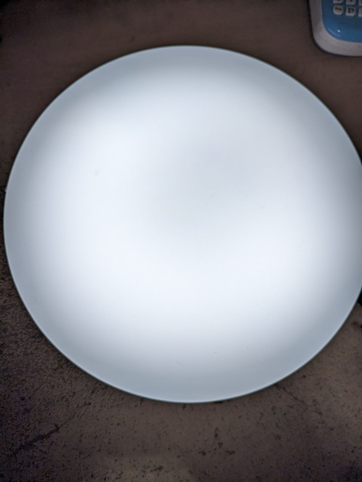

                  22:02:24.172 CMD: ZbSend { "Device":"0x8706", "Endpoint":"0x01", "Send":{"Power":"on"} }
                  22:02:24.180 MQT: stat/tasmota_9D8AC7/RESULT = {"ZbSend":"Done"}
                  22:02:24.822 MQT: tele/tasmota_9D8AC7/SENSOR = {"ZbReceived":{"0x8706":{"Device":"0x8706","Name":" Hintergrundbeleuchtung","Power":1,"Endpoint":1,"LinkQuality":16}}}
                  Lampe = An
                  22:03:45.014 CMD: ZbSend { "Device":"0x8706", "Endpoint":"0x01", "Send":{"Power":"off"} }
                  22:03:45.022 MQT: stat/tasmota_9D8AC7/RESULT = {"ZbSend":"Done"}
                  22:03:45.730 MQT: tele/tasmota_9D8AC7/SENSOR = {"ZbReceived":{"0x8706":{"Device":"0x8706","Name":" Hintergrundbeleuchtung","Power":0,"Endpoint":1,"LinkQuality":16}}}
                  Lampe = Aus
