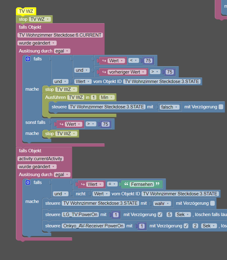

          @wendy2702 Ich habe es auch nur in Blockly
          Gruß Nordischerjung

            wendy2702
            @nordischerjung Danke.
            Ob du mir auch einen Export zur Verfügung stellen kannst?

                  @wendy2702 sagte in Womit aktuell Homematic Gerät über Harmony steuern?:
                   <variables>
                     <variable type="timeout" id="TV WZ">TV WZ</variable>
                   </variables>
                   <block type="comment" id="3uRGC-cUkRx5[NHMsd%9" x="363" y="488">
                     <field name="COMMENT">TV WZ</field>
                     <next>
                       <block type="timeouts_cleartimeout" id="usUeg]a02@A+6BIg,ZkY">
                         <field name="NAME">TV WZ</field>
                         <next>
                           <block type="on" id="0p0gWYduh(J-vrdx_AI3">
                             <field name="OID">hm-rpc.2.0034DF2991DE13.6.CURRENT</field>
                             <statement name="STATEMENT">
                               <block type="controls_if" id="5GD!SF{90SxkL#sJR}lo">
                                 <value name="IF0">
                                   <block type="logic_operation" id="vuTMLnk)A@s=7h7F*m27" inline="false">
                                     <field name="OP">AND</field>
                                     <value name="A">
                                       <block type="logic_operation" id="yA?mcRn_z)TgVaZ2z?kS" inline="false">
                                         <value name="A">
                                           <block type="logic_compare" id="rjii(d9{t?{~z~rq;Ew%">
                                             <field name="OP">LT</field>
                                             <value name="A">
                                               <block type="on_source" id="QBrA;AKK%eyef[W8g|:+">
                                               </block>
                                             </value>
                                             <value name="B">
                                               <block type="math_number" id="y~W8J^s%24VNGV9ZSyW3">
                                                 <field name="NUM">75</field>
                                               </block>
                                             </value>
                                           </block>
                                         </value>
                                         <value name="B">
                                           <block type="logic_compare" id="yB@B4S`Rw-9neJ~)aV0u">
                                             <field name="OP">GT</field>
                                             <value name="A">
                                               <block type="on_source" id="yFE;^Z,mS:#7,Y@FMWHF">
                                                 <field name="ATTR">oldState.val</field>
                                               </block>
                                             </value>
                                             <value name="B">
                                               <block type="math_number" id="iJz!0^VR)DaSSVUc0wmn">
                                               </block>
                                             </value>
                                           </block>
                                         </value>
                                       </block>
                                     </value>
                                     <value name="B">
                                       <block type="get_value" id="d$)cj{|/c1`P/cj[[D{$">
                                         <field name="OID">hm-rpc.2.0034DF2991DE13.3.STATE</field>
                                       </block>
                                     </value>
                                   </block>
                                 </value>
                                 <statement name="DO0">
                                   <block type="timeouts_cleartimeout" id="2H],f]gpi5v{w%16S`E9">
                                     <next>
                                       <block type="timeouts_settimeout" id="]v@@T%L/ac1~[?DNI^Q*">
                                         <field name="DELAY">1</field>
                                         <field name="UNIT">min</field>
                                           <block type="control" id="TS0C8Rb[M)lfhSQA.oPw">
                                             <value name="VALUE">
                                               <block type="logic_boolean" id=")rnv=}T*9)?OYhB+qimd">
                                               </block>
                                             </value>
                                           </block>
                                         </statement>
                                       </block>
                                     </next>
                                   </block>
                                 </statement>
                                 <value name="IF1">
                                   <block type="logic_compare" id="UYP:uDId@aZd$],eL.;o">
                                     <value name="A">
                                       <block type="on_source" id="t2A4#kE7+nWI`D57]lIF">
                                       </block>
                                     </value>
                                     <value name="B">
                                       <block type="math_number" id="]`.IB;/j|ZC5:HE@P5`e">
                                       </block>
                                     </value>
                                   </block>
                                 </value>
                                 <statement name="DO1">
                                   <block type="timeouts_cleartimeout" id="/%.b`wpz,S_K!Nj[XL%*">
                                   </block>
                                 </statement>
                               </block>
                             </statement>
                             <next>
                               <block type="on" id="XJvu@WEku*Mt;*i.:ya1">
                                 <field name="OID">harmony.0.Harmony.activities.currentActivity</field>
                                   <block type="controls_if" id="3_c%R9OD_zncCi$e.4Nr">
                                     <value name="IF0">
                                       <block type="logic_operation" id="IQ_-DzW@p5:crQVZPi[#" inline="false">
                                         <value name="A">
                                           <block type="logic_compare" id="g(7WB1d1lOsyDUNqE=Mb">
                                             <field name="OP">EQ</field>
                                             <value name="A">
                                               <block type="on_source" id="jv;frp)*A0(yd;+Fv^vN">
                                               </block>
                                             </value>
                                             <value name="B">
                                               <block type="text" id="_Z%[`A=+H-aMONPvi4{i">
                                                 <field name="TEXT">Fernsehen</field>
                                               </block>
                                             </value>
                                           </block>
                                         </value>
                                         <value name="B">
                                           <block type="logic_negate" id="QZsPZeN[H-Fn}55szg=V">
                                             <value name="BOOL">
                                               <block type="get_value" id="re=wi{ALX0fvkRR5XsM$">
                                               </block>
                                             </value>
                                           </block>
                                         </value>
                                       </block>
                                     </value>
                                       <block type="control" id="+9Fgq*9Qm)mwp0S3Ge8/">
                                           <block type="logic_boolean" id="jwFTfnY0%=RYN=]=B9hp">
                                           </block>
                                         </value>
                                         <next>
                                           <block type="control" id="QFZW$isb:R7.918DDC]^">
                                             <mutation xmlns="http://www.w3.org/1999/xhtml" delay_input="true"></mutation>
                                             <field name="OID">harmony.0.Harmony.LG_TV.PowerOn</field>
                                             <field name="DELAY_MS">5</field>
                                             <field name="CLEAR_RUNNING">TRUE</field>
                                               <block type="math_number" id="DhXhqB-F-Q{QZ.Wf9r1u">
                                                 <field name="NUM">1</field>
                                               </block>
                                             </value>
                                             <next>
                                               <block type="control" id="cMMVMT3P1}xR8dZTRHaF">
                                                 <field name="OID">harmony.0.Harmony.Onkyo_AV-Receiver.PowerOn</field>
                                                 <field name="DELAY_MS">2</field>
                                                   <block type="math_number" id="%#%XG0K9e=CVw`Gj0SoC">
                                                   </block>
                                                 </value>
                                               </block>
                                             </next>
                                           </block>
                                         </next>
                                       </block>
                                     </statement>
                                   </block>
                                 </statement>
                               </block>
                             </next>
                           </block>
                         </next>
                       </block>
                     </next>
                   </block>
                  </xml>

                    wendy2702W Online
                    wendy2702W Online
                    wendy2702
                    • wendy2702W Online
                      wendy2702W Online
                      wendy2702
                      ^Habe es geschafft Roku ins Harmony zu bekommen.
                      Jetzt mal eine meiner Aktionen bearbeiten und schauen ob das Schalten funktioniert.
                      Danke für eure Kommentare
                      UweRLPU 1 Antwort Letzte Antwort
                      • wendy2702W wendy2702
                        UweRLPU Offline
                        UweRLPU Offline
                        UweRLP
                        @wendy2702 Wie ist den Homematic eingebunden im ioBroker? Habe hier bei mir das "Problem" schon seid längerem gelöst. Benutze dazu eine CCU3 und eine Mess-Zwischenstecker die mit dem HM-Adapter eingebunden ist. Dazu noch den Adapter für die Logitech in ioBroker. Dann einen Datenpunkt in ioBroker erzeugt für TV-On. Ist der auf wahr wird geprüft ob die HM-Steckdose an ist. Bei Bedarf erst anschalten und verzögert mit dem Logitech Adapter die IRs senden. Beim Ausschalten wird in der CCU3 die Leistung verarbeitet wenn dieser >150 Watt war und dann <65 Watt wird die Steckdose ausgeschaltet. Über 150 Watt komme ich wenn ich meine Geräte mittels Logitech eingeschaltet unter die 65 Watt komme ich wenn ich die Geräte dann wieder mittels IR ausgeschaltet habe.
                        Hilft das?
                        • wendy2702W Online
                          wendy2702W Online
                          wendy2702
                          @uwerlp sagte in Womit aktuell Homematic Gerät über Harmony steuern?:
                          Mein Konfig ist ähnlich.
                          Wie aber stellst du den DP auf "true" ?
                          Manuell oder auch per Harmony?
                            UweRLPU Offline
                            UweRLPU Offline
                            UweRLP
                            z.B. über Alexa (mittels iot Adapter) oder auch im VIS
                            • UweRLPU UweRLP
                              wendy2702W Online
                              wendy2702W Online
                              wendy2702
                              @uwerlp OK.
                              ich habe kein Alexa und den Weg zur Vis wollte ich mir sparen.
                              Ziel ist es halt beim Starten der Activity per Harmony auch die Steckdose einzuschalten.
                              Das sollte jetzt mit dem Roku funktionieren denke ich.
                              Werde berichten
                                @uwerlp OK.
                                Werde berichten
                                UweRLPU Offline
                                UweRLPU Offline
                                UweRLP
                                @wendy2702 Alles klar. Möglicherweise geht es auch über zweit Dummy Activities in der Harmony. Die Activities werden ja als Datenpunkte dargestellt und könnten dann auch als Auslöser für die Steckdose wirken.
                                370
