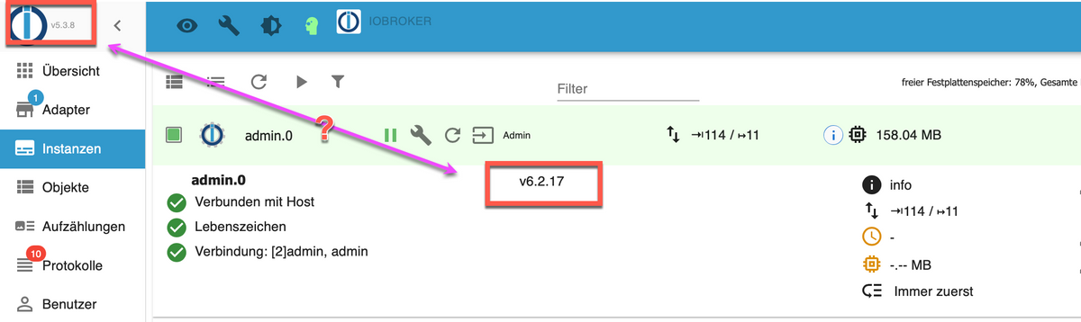

    Bin etwas verwirrt, was meine admin version nach einem update anzeigt.
    Die Instance zeigt:
    iobroker log admin zeigt:
    2022-08-31 19:01:09.739  - info: admin.0 (444) starting. Version 5.3.8 in /opt/iobroker/node_modules/iobroker.admin, node: v16.17.0, js-controller: 4.0.23
    2022-08-31 19:01:09.870  - info: admin.0 (444) requesting all states
    2022-08-31 19:01:09.874  - info: admin.0 (444) requesting all objects
    2022-08-31 19:01:11.337  - info: admin.0 (444) Request actual repository...
    2022-08-31 19:01:14.725  - info: admin.0 (444) received all objects
    2022-08-31 19:01:15.248  - info: admin.0 (444) http server listening on port 8081
    2022-08-31 19:01:15.251  - info: admin.0 (444) Use link "http://localhost:8081" to configure.
    2022-08-31 19:01:16.293  - info: admin.0 (444) Repository received successfully.
    2022-08-31 19:01:16.468  - info: admin.0 (444) State value to set for "admin.0.info.connection" has to be type "boolean" but received type "string"
    Wie kann ich das bereinigen?

                Soll ich direkt nochmal den upgrade machen?
                @rewenode
                iobroker upgrade admin --debug
                R 1 Antwort Letzte Antwort
                  @rewenode
                  R Offline
                  R Offline
                  rewenode
                  schrieb am zuletzt editiert von rewenode
                  Ich schätze mal, jetzt den Löscheinzeiler und dann nochmal probieren?
                  iobroker@iobroker:~$ iobroker upgrade admin --debug
                  This upgrade of "admin" will at least introduce the following changes:
                  -> 6.2.17:
                  Corrected GUI bug on intro tab
                  -> 6.2.16:
                  Corrected many GUI issues
                  Added `stable` flag for repositories
                  Added reset button for repositories
                  Improved `writeFile` function for socket communication
                  -> 6.2.14:
                  Fix for OAuth2 authentication response success page
                  -> 6.2.13:
                  Corrected JSON config
                  -> 6.2.12:
                  Corrected the Text input field in JSON configuration
                  -> 6.2.6:
                  Implemented Oauth2 workflow for adapters
                  Corrected encrypt/decrypt functions
                  -> 6.2.4:
                  Corrected yahka settings
                  BE CAREFUL: THIS IS A MAJOR UPGRADE, WHICH WILL MOST LIKELY INTRODUCE BREAKING CHANGES!
                  Would you like to upgrade admin from @5.3.8 to @6.2.17 now? [(y)es, (n)o]: y
                  Update admin from @5.3.8 to @6.2.17
                  host.iobroker Adapter "system.adapter.admin.0" is stopped.
                  NPM version: 8.15.0
                  Installing iobroker.admin@6.2.17... (System call)
                  npm WARN deprecated dgram@1.0.1: npm is holding this package for security reasons. As it's a core Node module, we will not transfer it over to other users. You may safely remove the package from your dependencies.
                  npm WARN deprecated request-promise-native@1.0.9: request-promise-native has been deprecated because it extends the now deprecated request package, see https://github.com/request/request/issues/3142
                  npm WARN deprecated har-validator@5.1.5: this library is no longer supported
                  npm WARN deprecated json3@3.3.2: Please use the native JSON object instead of JSON 3
                  npm WARN deprecated querystring@0.2.1: The querystring API is considered Legacy. new code should use the URLSearchParams API instead.
                  npm WARN deprecated node-inspect@2.0.0: This module is part of Node.js core and does not need to be installed separately. It is now unmaintained.
                  npm WARN deprecated debug@4.1.1: Debug versions >=3.2.0 <3.2.7 || >=4 <4.3.1 have a low-severity ReDos regression when used in a Node.js environment. It is recommended you upgrade to 3.2.7 or 4.3.1. (https://github.com/visionmedia/debug/issues/797)
                  npm WARN deprecated uuid@3.4.0: Please upgrade  to version 7 or higher.  Older versions may use Math.random() in certain circumstances, which is known to be problematic.  See https://v8.dev/blog/math-random for details.
                  npm WARN deprecated request@2.88.2: request has been deprecated, see https://github.com/request/request/issues/3142
                  npm ERR! code ENOTEMPTY
                  npm ERR! syscall rename
                  npm ERR! path /opt/iobroker/node_modules/node-red-node-email/node_modules/encoding-japanese/src
                  npm ERR! dest /opt/iobroker/node_modules/.node-red-node-email-1lk8B7Gi/node_modules/encoding-japanese/src
                  npm ERR! errno -39
                  npm ERR! ENOTEMPTY: directory not empty, rename '/opt/iobroker/node_modules/node-red-node-email/node_modules/encoding-japanese/src' -> '/opt/iobroker/node_modules/.node-red-node-email-1lk8B7Gi/node_modules/encoding-japanese/src'
                  npm ERR!     /opt/iobroker/.npm/_logs/2022-08-31T18_29_44_299Z-debug-0.log
                  host.iobroker Cannot install iobroker.admin@6.2.17: 217
                  Sry keine Ahnung wo hier die Links herkommen;-(

                    @rewenode
                    https://forum.iobroker.net/topic/57337/fehler-25-bei-adapter-install-update-mit-npm8
                    • R Offline
                      R Offline
                      rewenode
                      @thomas-braun Ok, das war jetzt was Größeres. Bin wie folgt vorgegangen:
                      iobroker@iobroker:~/node_modules$ for i in $(find /opt/iobroker/node_modules -type d -iname ".*-????????" ! -iname ".local-chromium"); do rm -rf ${i%%/}; done
                      iobroker@iobroker:~/node_modules$ iobroker upgrade admin --debug
                      Adapter "admin"          is up to date.
                      Also hat iob die Version v6.2.17 irgendwo als aktuelle version registriert, obwohl die Installation abbrach. Ich denke, daher der Versionsmissmatch.
                      Also:
                      iobroker@iobroker:~/node_modules$ iobroker upgrade admin@6.2.17 --debug
                      Would you like to reinstall version 6.2.17 of admin now? [(y)es, (n)o]: y
                      Update admin from @6.2.17 to @6.2.17
                      NPM version: 8.15.0
                      changed 1181 packages, and audited 1223 packages in 10m
                      95 packages are looking for funding
                        run `npm fund` for details
                      35 vulnerabilities (12 low, 15 moderate, 8 high)
                      To address issues that do not require attention, run:
                        npm audit fix
                      To address all issues possible (including breaking changes), run:
                        npm audit fix --force
                      Some issues need review, and may require choosing
                      a different dependency.
                      Run `npm audit` for details.
                      Update "system.adapter.admin.0"
                      upload [51] admin.admin /opt/iobroker/node_modules/iobroker.admin/admin/admin.png admin.png image/png
                      upload [50] admin.admin /opt/iobroker/node_modules/iobroker.admin/admin/custom/customComponents.js custom/customComponents.jsapplication/javascript
                      upload [40] admin.admin /opt/iobroker/node_modules/iobroker.admin/admin/custom/i18n/ru.json custom/i18n/ru.json application/json
                      upload [30] admin.admin /opt/iobroker/node_modules/iobroker.admin/admin/custom/static/js/node_modules_prop-types_index_js.512eddf9.chunk.js custom/static/js/node_modules_prop-types_index_js.512eddf9.chunk.js application/javascript
                      upload [20] admin.admin /opt/iobroker/node_modules/iobroker.admin/admin/custom/static/js/vendors-node_modules_mui_material_Accordion_index_js-node_modules_mui_material_AccordionDetai-57e02d.0886b730.chunk.js custom/static/js/vendors-node_modules_mui_material_Accordion_index_js-node_modules_mui_material_AccordionDetai-57e02d.0886b730.chunk.js application/javascript
                      upload [19] admin.admin /opt/iobroker/node_modules/iobroker.admin/admin/custom/static/js/vendors-node_modules_mui_material_Accordion_index_js-node_modules_mui_material_AccordionDetai-57e02d.0886b730.chunk.js.map custom/static/js/vendors-node_modules_mui_material_Accordion_index_js-node_modules_mui_material_AccordionDetai-57e02d.0886b730.chunk.js.map application/json
                      upload [18] admin.admin /opt/iobroker/node_modules/iobroker.admin/admin/custom/static/js/vendors-node_modules_mui_material_index_js.40e01f69.chunk.js custom/static/js/vendors-node_modules_mui_material_index_js.40e01f69.chunk.js application/javascript
                      upload [17] admin.admin /opt/iobroker/node_modules/iobroker.admin/admin/custom/static/js/vendors-node_modules_mui_material_index_js.40e01f69.chunk.js.map custom/static/js/vendors-node_modules_mui_material_index_js.40e01f69.chunk.js.map application/json
                      upload [16] admin.admin /opt/iobroker/node_modules/iobroker.admin/admin/custom/static/js/vendors-node_modules_mui_styles_index_js-node_modules_mui_utils_esm_capitalize_js-node_module-19fe07.82575832.chunk.js custom/static/js/vendors-node_modules_mui_styles_index_js-node_modules_mui_utils_esm_capitalize_js-node_module-19fe07.82575832.chunk.js application/javascript
                      upload [15] admin.admin /opt/iobroker/node_modules/iobroker.admin/admin/custom/static/js/vendors-node_modules_mui_styles_index_js-node_modules_mui_utils_esm_capitalize_js-node_module-19fe07.82575832.chunk.js.map custom/static/js/vendors-node_modules_mui_styles_index_js-node_modules_mui_utils_esm_capitalize_js-node_module-19fe07.82575832.chunk.js.map application/json
                      upload [14] admin.admin /opt/iobroker/node_modules/iobroker.admin/admin/custom/static/js/vendors-node_modules_mui_styles_withStyles_withStyles_js.6d998ff2.chunk.js custom/static/js/vendors-node_modules_mui_styles_withStyles_withStyles_js.6d998ff2.chunk.js application/javascript
                      upload [13] admin.admin /opt/iobroker/node_modules/iobroker.admin/admin/custom/static/js/vendors-node_modules_mui_styles_withStyles_withStyles_js.6d998ff2.chunk.js.map custom/static/js/vendors-node_modules_mui_styles_withStyles_withStyles_js.6d998ff2.chunk.js.map application/json
                      upload [12] admin.admin /opt/iobroker/node_modules/iobroker.admin/admin/custom/static/js/vendors-node_modules_react-dom_index_js.51544235.chunk.js custom/static/js/vendors-node_modules_react-dom_index_js.51544235.chunk.js application/javascript
                      upload [11] admin.admin /opt/iobroker/node_modules/iobroker.admin/admin/custom/static/js/vendors-node_modules_react-dom_index_js.51544235.chunk.js.map custom/static/js/vendors-node_modules_react-dom_index_js.51544235.chunk.js.map application/json
                      upload [10] admin.admin /opt/iobroker/node_modules/iobroker.admin/admin/i18n/de/translations.json i18n/de/translations.json application/json
                      upload [9] admin.admin /opt/iobroker/node_modules/iobroker.admin/admin/i18n/en/translations.json i18n/en/translations.json application/json
                      upload [8] admin.admin /opt/iobroker/node_modules/iobroker.admin/admin/i18n/es/translations.json i18n/es/translations.json application/json
                      upload [7] admin.admin /opt/iobroker/node_modules/iobroker.admin/admin/i18n/fr/translations.json i18n/fr/translations.json application/json
                      upload [6] admin.admin /opt/iobroker/node_modules/iobroker.admin/admin/i18n/it/translations.json i18n/it/translations.json application/json
                      upload [5] admin.admin /opt/iobroker/node_modules/iobroker.admin/admin/i18n/nl/translations.json i18n/nl/translations.json application/json
                      upload [4] admin.admin /opt/iobroker/node_modules/iobroker.admin/admin/i18n/pl/translations.json i18n/pl/translations.json application/json
                      upload [3] admin.admin /opt/iobroker/node_modules/iobroker.admin/admin/i18n/pt/translations.json i18n/pt/translations.json application/json
                      upload [2] admin.admin /opt/iobroker/node_modules/iobroker.admin/admin/i18n/ru/translations.json i18n/ru/translations.json application/json
                      upload [1] admin.admin /opt/iobroker/node_modules/iobroker.admin/admin/i18n/zh-cn/translations.json i18n/zh-cn/translations.json application/json
                      upload [0] admin.admin /opt/iobroker/node_modules/iobroker.admin/admin/jsonConfig.json5 jsonConfig.json5 application/json5
                      Sieht mal gut aus, allerdings wird admin nicht gestartet. Ist evtl. durch die vorangegangene abgebrochene Installation noch gestoppt.
                      iobroker@iobroker:~$ iob list instances
                        system.adapter.admin.0                  : admin                 : iobroker                                 - disabled, port: 8081, bind: 0.0.0.0, run as: admin
                      Also von Hand gestartet.
                      iobroker@iobroker:~$ iob start admin
                      The adapter "admin.0" was started.
                      Sieht alles gut aus. Versionen stimmen jetzt.
                      Danke für die Hilfe.
                      Reiner
                        Reiner

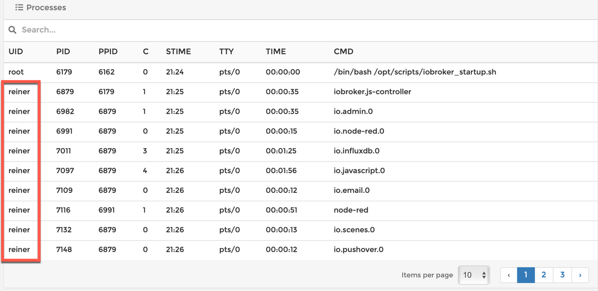

                                        @thomas-braun Na ich bin jetzt NICHT der ausgewiesene Docker Experte, aber der container selber sollte als normaler user (Reiner) starten. Der hat die GID/UID 1000 und damit wird der Container defaultmäßig gestartet.
                                        Meine info Kachel zeigt dann auch den richtigen Pfad:
                                        PlatformBetriebssystem:linux
                                        Architektur:arm64
                                        CPUs:4
                                        Geschwindigkeit:1296 MHz
                                        Modell:Cortex-A53
                                        RAM:3.8 GB
                                        System-Betriebszeit:62 T. 12:13:26
                                        Node.js:v16.17.0
                                        time:1661974154400
                                        timeOffset:-120
                                        Adapter-Anzahl:431
                                        NPM:v8.15.0
                                        Datenträgergröße:226.9 GB
                                        Freier Festplattenspeicher:178.1 GB
                                        Betriebszeit:00:03:30
                                        Aktive Instanzen:21
                                        Pfad:/opt/iobroker/
                                        aktiv:true
                                        Und die Prozesse innerhalb des Containers laufen dann auch unter dem user reiner.
                                        Eine andere Sache ist es, wie ich mich per docker-exec an die Container-Konsole connecte.
                                        Das brauche ich i.d.R. gar nicht, da alle administrativen Sachen ja über den Admin laufen.
                                        Falls ich da doch mal was nachschauen will, mach das über portainer als root.
                                        Warum?
                                        Weil ich mit docker exec defaultmäßig als root connecte. Und ich da als root nichts aktives mache.
                                        reiner@rock64:~/docker_iob$ docker exec -ti iobroker bash
                                        root@iobroker:/opt/iobroker#
                                        Kann mich auch mit
                                        reiner@rock64:~/docker_iob$ docker exec -u 1000 -ti iobroker bash
                                        iobroker@iobroker:~$pwd
                                        /opt/iobroker
                                        connecten. Dann lande ich auch im /opt/iobroker
                                        Und das habe ich hier bei der Updaterei gemacht.
                                        Was ich noch nicht rausgefunden habe, warum connected der user reiner innerhalb des containers automatisch als user iobroker?
                                        Reiner
