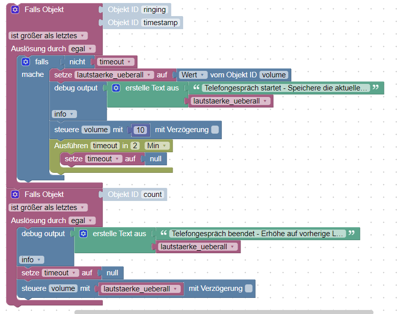

    Ich bekomme diese Fehlermeldung:
    2022-04-29 20:31:26.263  - info: javascript.0 (1154) script.js.common.telefon_klingelt: Telefongespräch beendet - Erhöhe auf vorherige Lautstärke undefined
    2022-04-29 20:31:26.265  - warn: javascript.0 (1154) You are assigning a undefined to the state "alexa2.0.Echo-Devices.0026485aaf2447eb99c27f9e19e6909d.Player.volume" which expects a number. Please fix your code to use a number or change the state type to undefined. This warning might become an error in future versions.
    2022-04-29 20:31:26.547  - warn: javascript.0 (1154)     at setState (/opt/iobroker/node_modules/iobroker.javascript/lib/sandbox.js:1530:20)
    2022-04-29 20:31:26.548  - warn: javascript.0 (1154)     at Object.<anonymous> (script.js.common.telefon_klingelt:19:3)
    2022-04-29 20:31:26.548  - warn: javascript.0 (1154)     at Object.callback (/opt/iobroker/node_modules/iobroker.javascript/lib/sandbox.js:1167:38)
    2022-04-29 20:31:26.549  - warn: javascript.0 (1154)     at Object.stateChange (/opt/iobroker/node_modules/iobroker.javascript/main.js:586:29)
    2022-04-29 20:31:26.549  - warn: javascript.0 (1154)     at Immediate._onImmediate (/opt/iobroker/node_modules/@iobroker/js-controller-adapter/src/lib/adapter/adapter.js:5909:56)
    2022-04-29 20:31:26.549  - warn: javascript.0 (1154)     at processImmediate (node:internal/timers:466:21)
    2022-04-29 20:31:41.848  - info: javascript.0 (1154) script.js.common.telefon_klingelt: Telefongespräch startet - Speichere die aktuelle Lautstärke 40
    2022-04-29 20:31:51.253  - info: javascript.0 (1154) script.js.common.telefon_klingelt: Telefongespräch beendet - Erhöhe auf vorherige Lautstärke 40
    zu diesem Blockly:
    var lautstaerke_ueberall, timeout;
    on({id: new RegExp('tr-064\\.0\\.callmonitor\\.ringing' + "$|" + 'tr-064\\.0\\.callmonitor\\.outbound\\.timestamp' + "$"), change: "gt"}, async function (obj) {
        if (!timeout) {
        lautstaerke_ueberall = getState("alexa2.0.Echo-Devices.G2A0QU0574340BU1.Player.volume").val;
        console.log(('Telefongespräch startet - Speichere die aktuelle Lautstärke ' + String(lautstaerke_ueberall)));
        setState("alias.0.alexa_ueberall_gruppe.volume"/*volume*/, 10);
        timeout = setTimeout(async function () {
          timeout = null;
        }, 120000);
    on({id: 'tr-064.0.calllists.all.count', change: "gt"}, async function (obj) {
      var value = obj.state.val;
      console.log(('Telefongespräch beendet - Erhöhe auf vorherige Lautstärke ' + String(lautstaerke_ueberall)));
      timeout = null;
      setState("alexa2.0.Echo-Devices.0026485aaf2447eb99c27f9e19e6909d.Player.volume"/*volume*/, lautstaerke_ueberall);
    Wo muss denn der Typ angepasst werden? Meine Schatzkarte für die Java-Piraten-Insel ist da etwas löchrig...

      @thomas-braun sagte in Java ist eine Insel...:
      wenn ich das tichtig sehe ist das
      setState("alexa2.0.Echo-Devices.0026485aaf2447eb99c27f9e19e6909d.Player.volume"/volume/, lautstaerke_ueberall)
      dann ist lautstärke überall nicht initialisiert
      was hatte denn der debug ausgeworfen?
        @homoran sagte in Java ist eine Insel...:
        ? Das Log ist vollständig, inkl. Debug-Meldungen.
          hast du das Skript gestartet als du am telefonieten warst?
          und dann das Telefonat beendet?
          dann konnte das Skript die bisherige Lautstärke nicht kennen. weil die noch nicht definiert war = undefined
          mach mal oberhalb dercTrigger einenen setze lautstaerke-ueberall auf 40 block
            Das skript lungert die ganze Zeit rum. Was skripte halt so tun.
            Ich hab das Gespräch beendet.
              @thomas-braun hab editiert
                Hat sich erledigt. Hab die Datenpunkte aus dem tr-064 Adapter nochmal neueingelesen. Hat wohl nach einem Update der FritzLabor-Firmware irgendwie geklemmt.
