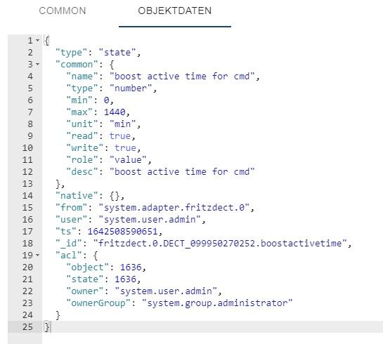

        Nach einem Neustart des Adapters kam nun das ?
        fritzdect.0
        2022-01-18 13:41:19.331	info	State value to set for "fritzdect.0.DECT_099950276783.boostactivetime" has to be type "number" but received type "string"
        fritzdect.0
        2022-01-18 13:41:19.297	info	State value to set for "fritzdect.0.DECT_099950276783.windowopenactivetime" has to be type "number" but received type "string"
        fritzdect.0
        2022-01-18 13:41:19.296	info	State value to set for "fritzdect.0.DECT_099950696353.boostactivetime" has to be type "number" but received type "string"
        fritzdect.0
        2022-01-18 13:41:19.295	info	State value to set for "fritzdect.0.DECT_099950696353.windowopenactivetime" has to be type "number" but received type "string"
        fritzdect.0
        2022-01-18 13:41:19.294	info	State value to set for "fritzdect.0.DECT_133560170728.boostactivetime" has to be type "number" but received type "string"
        fritzdect.0
        2022-01-18 13:41:19.289	info	State value to set for "fritzdect.0.DECT_133560170728.windowopenactivetime" has to be type "number" but received type "string"
        fritzdect.0
        2022-01-18 13:41:19.289	info	State value to set for "fritzdect.0.DECT_133560175984.boostactivetime" has to be type "number" but received type "string"
        fritzdect.0
        2022-01-18 13:41:19.288	info	State value to set for "fritzdect.0.DECT_133560175984.windowopenactivetime" has to be type "number" but received type "string"
        fritzdect.0
        2022-01-18 13:41:19.287	info	State value to set for "fritzdect.0.DECT_133560155800.boostactivetime" has to be type "number" but received type "string"
        fritzdect.0
        2022-01-18 13:41:19.286	info	State value to set for "fritzdect.0.DECT_133560155800.windowopenactivetime" has to be type "number" but received type "string"
        aber warum das sollte doch eine Zahl sein
