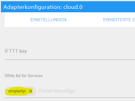

    Hallo ich bin etwas ratlos, habe eine neue Windows10 Installation aufgesetzt und versuche so nach und nach alles was auf der alten Maschine lief, nun auch auf der neuen Maschine ans laufen zu bekommen.
    Folgendes Script sollte Daten aus einem entfernten Rechner holen:
    /*****Castrop saugt Daten aus Giethoorn *****************
    **    Mai 2021
    **    Cloud-Adapter, Zigbee
    **    angelegt:03.05.21
    **    geändert:04.05.21; 12.07.21
    //Temperatur Außen
    schedule("* * * * *", function () {
    var request = require('request');
    const linkOS = "https://iobroker.pro/service/simpleApi/@pro_michaelxxxx@web.de_71de5ba0-989f-11e8-xxxx-1998b1185xxx/getPlainValue/hm-rpc.2.00185BE98B3FCA.1.ACTUAL_TEMPERATURE";
    request(linkOS, function(error, response, body) {
          if (error) {
              log('Error from request:' + error, 'error');
          } else {
              var result = JSON.parse(body);
                        setState("javascript.0.Castrop.OS", result);
              log("Temp. Außen: " +result +" °C");
    Der log des Scriptes sieht so aus:
    11:22:00.342	info	javascript.0 (7996) script.js.Castrop.Daten_Castrop: setForeignState(id=javascript.0.Castrop.OS, state={"val":{"error":"blocked"},"ack":false,"c":"script.js.Castrop.Daten_Castrop"})
    11:22:00.343	info	javascript.0 (7996) script.js.Castrop.Daten_Castrop: Temp. Außen: [object Object] °C
    cloud.0	2022-01-05 11:26:06.723	warn	(5300) Received service "simpleApi", but it is not found in whitelist
    cloud.0	2022-01-05 11:26:06.722	warn	(5300) Received service "simpleApi", but it is not found in whitelist
    cloud.0	2022-01-05 11:26:06.721	warn	(5300) Received service "simpleApi", but it is not found in whitelist
    cloud.0	2022-01-05 11:26:06.720	warn	(5300) Received service "simpleApi", but it is not found in whitelist
    cloud.0	2022-01-05 11:26:06.719	warn	(5300) Received service "simpleApi", but it is not found in whitelist
    cloud.0	2022-01-05 11:26:06.718	warn	(5300) Received service "simpleApi", but it is not found in whitelist
    cloud.0	2022-01-05 11:26:06.717	warn	(5300) Received service "simpleApi", but it is not found in whitelist
    cloud.0	2022-01-05 11:26:06.716	warn	(5300) Received service "simpleApi", but it is not found in whitelist
    cloud.0	2022-01-05 11:26:06.715	warn	(5300) Received service "simpleApi", but it is not found in whitelist
    cloud.0	2022-01-05 11:26:06.714	warn	(5300) Received service "simpleApi", but it is not found in whitelist
    cloud.0	2022-01-05 11:26:06.713	warn	(5300) Received service "simpleApi", but it is not found in whitelist
    Edit: Hier ist die Whitelist und muss der entsprechende Services zu hinterlegt, war falsch geschrieben :man-shrugging:

      A Offline
      A Offline
      Ahnungsbefreit
      @michihorn Schau mal in den Einstellungen des iot-Adapters, im Tab "Services und IFTTT". Da ist sowohl die richtige URL-Syntax definiert, als auch die Whitelist.
