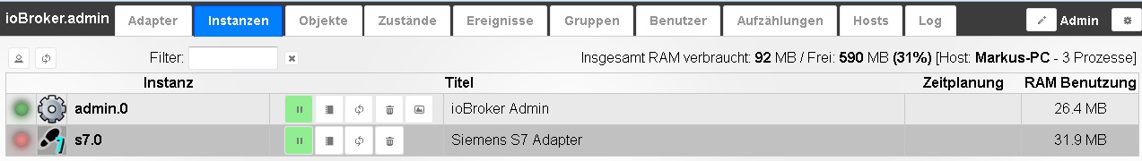

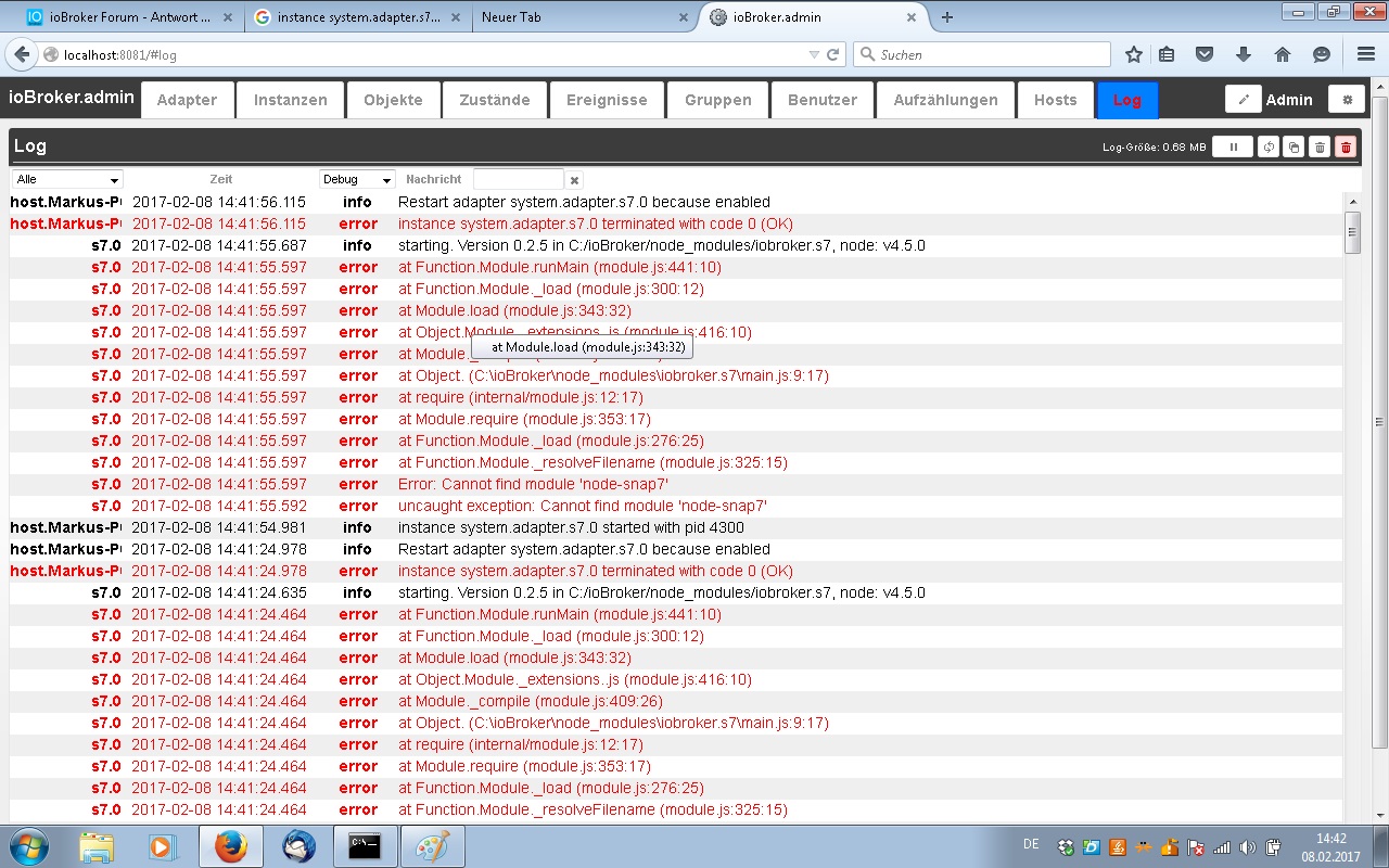

          • apollon77A Online
            apollon77A Online
            apollon77
            seems like an incomplete installation because a node module seems to be missing. Install it again (http://www.iobroker.net/docu/?page_id=3 … stallieren) and look for error son installig the npm packages
