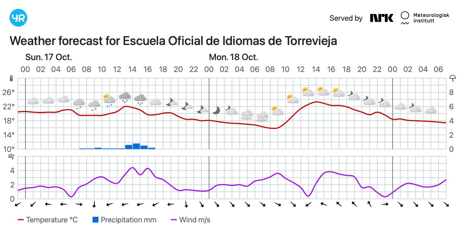

        @jensbhb Hallo,
        ich nutze den Graphen seit langer Zeit und war auch ziemlich überrascht.
        Du kannst auf der Yr.no Seite für ganz Deutschland oder auch einzelne Orte die neue Grafik zB als SVG ausgeben lassen und verwenden:
        https://www.yr.no/en/forecast/graph/2-2921044/Germany
        Und zwar ganz ohne Adapter oder API
        Hier ist mal die Vorhersage für irgendeinen Ort als SVG in VIS als Widget:
        [{"tpl":"tplHtml","data":{"g_fixed":true,"g_visibility":false,"g_css_font_text":false,"g_css_background":true,"g_css_shadow_padding":false,"g_css_border":false,"g_gestures":false,"g_signals":false,"visibility-cond":"==","visibility-val":1,"visibility-groups-action":"hide","refreshInterval":"0","signals-cond-0":"==","signals-val-0":true,"signals-icon-0":"/vis/signals/lowbattery.png","signals-icon-size-0":0,"signals-blink-0":false,"signals-horz-0":0,"signals-vert-0":0,"signals-hide-edit-0":false,"signals-cond-1":"==","signals-val-1":true,"signals-icon-1":"/vis/signals/lowbattery.png","signals-icon-size-1":0,"signals-blink-1":false,"signals-horz-1":0,"signals-vert-1":0,"signals-hide-edit-1":false,"signals-cond-2":"==","signals-val-2":true,"signals-icon-2":"/vis/signals/lowbattery.png","signals-icon-size-2":0,"signals-blink-2":false,"signals-horz-2":0,"signals-vert-2":0,"signals-hide-edit-2":false,"html":"<div id=\"yr-home-div\">\n    <img src=\"https://www.yr.no/en/content/2-8351443/meteogram.svg\" id=\"yr-home-widget-image\" scrolling=\"no\">\n</div>\n\n\n<style>\n#yr-home-div\n{\n    width    : 495px;\n    height   : 215px;\n    overflow : hidden;\n    position : relative;\n}\n\n#yr-home-widget-image\n{\n    position : absolute;\n    top      : -58px;\n    left     : 0;\n    width    : 499px;\n    height   : 300px;\n}\n</style>","name":"YR Wettervorhersage Widget Ausschnitt","lc-type":"last-change","lc-is-interval":true,"lc-is-moment":false,"lc-format":"","lc-position-vert":"top","lc-position-horz":"right","lc-offset-vert":0,"lc-offset-horz":0,"lc-font-size":"12px","lc-font-family":"","lc-font-style":"","lc-bkg-color":"","lc-color":"","lc-border-width":"0","lc-border-style":"","lc-border-color":"","lc-border-radius":10,"lc-zindex":0,"comment":"SVG","class":"xxxyrdiagramm"},"style":{"left":"520px","top":"70px","z-index":"25","background-color":"blue","width":"495px","height":"215px"},"widgetSet":"basic"}]
        Das Widget schneidet gleich den überflüssigen Text oben ab, so wird das Widget nicht so groß
        Pix
        D 1 Antwort Letzte Antwort
