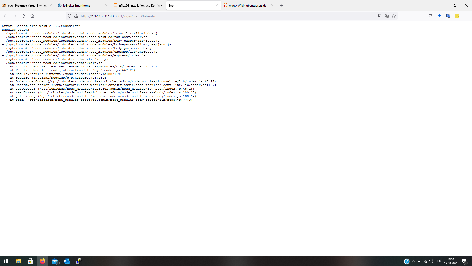

      Gut ok habe das Backup eingespielt, möchte Iobroker starten - geht nicht 😕
      Gut ich installiere ne VM neu mit Debian 10.6.0 und spiele das Backup per Backit Up wieder ein...
      dann erhalte ich folgende ausgabe:
      Error: Cannot find module '../encodings'
      Require stack:
      - /opt/iobroker/node_modules/iobroker.admin/node_modules/iconv-lite/lib/index.js
      - /opt/iobroker/node_modules/iobroker.admin/node_modules/raw-body/index.js
      - /opt/iobroker/node_modules/iobroker.admin/node_modules/body-parser/lib/read.js
      - /opt/iobroker/node_modules/iobroker.admin/node_modules/body-parser/lib/types/json.js
      - /opt/iobroker/node_modules/iobroker.admin/node_modules/body-parser/index.js
      - /opt/iobroker/node_modules/iobroker.admin/node_modules/express/lib/express.js
      - /opt/iobroker/node_modules/iobroker.admin/node_modules/express/index.js
      - /opt/iobroker/node_modules/iobroker.admin/lib/web.js
      - /opt/iobroker/node_modules/iobroker.admin/main.js
          at Function.Module._resolveFilename (internal/modules/cjs/loader.js:815:15)
          at Function.Module._load (internal/modules/cjs/loader.js:667:27)
          at Module.require (internal/modules/cjs/loader.js:887:19)
          at require (internal/modules/cjs/helpers.js:74:18)
          at Object.getCodec (/opt/iobroker/node_modules/iobroker.admin/node_modules/iconv-lite/lib/index.js:65:27)
          at Object.getDecoder (/opt/iobroker/node_modules/iobroker.admin/node_modules/iconv-lite/lib/index.js:127:23)
          at getDecoder (/opt/iobroker/node_modules/iobroker.admin/node_modules/raw-body/index.js:45:18)
          at readStream (/opt/iobroker/node_modules/iobroker.admin/node_modules/raw-body/index.js:180:15)
          at getRawBody (/opt/iobroker/node_modules/iobroker.admin/node_modules/raw-body/index.js:108:12)
          at read (/opt/iobroker/node_modules/iobroker.admin/node_modules/body-parser/lib/read.js:77:3)
      kann mir wer helfen bitte?

      • Thomas Braun
        Thomas Braun Most Active @Wurzeldoktor last edited by
        @wurzeldoktor
        Such nach dem [Mini-HowTo]
        Das sieht danach aus...
        W 1 Reply Last reply Reply Quote 1

          • W
            Wurzeldoktor @Thomas Braun last edited by
            @thomas-braun
            Mensch Danke haha
            hat spitze funktioniert 🙂 vielen Dank
