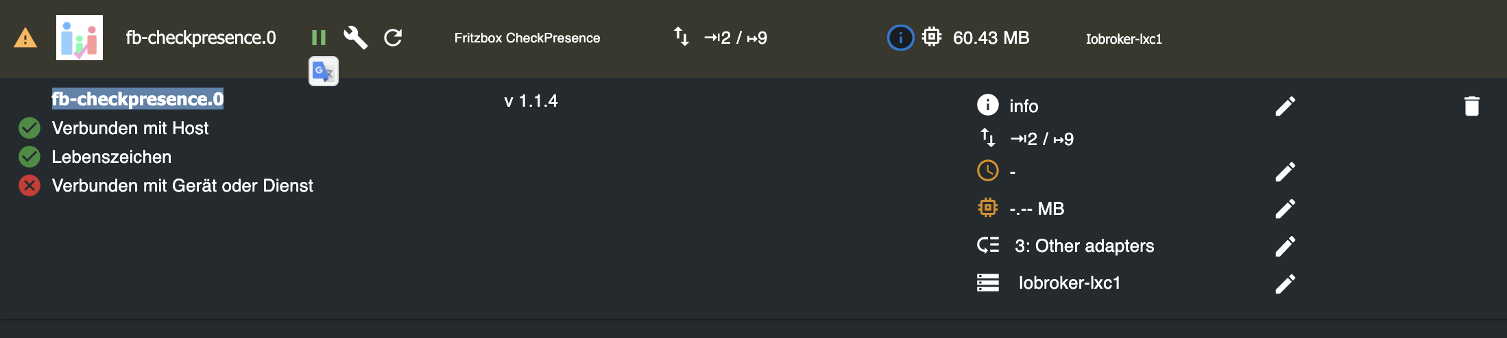

    habe das Problem, dass ich den fb-checkpresence nicht zum laufen bringe.
    Startet kurz und wird nach diesem Zustand, dann komplett beendet.
    Hier der Log:
    2021-05-28 10:47:46.869	info	instance system.adapter.fb-checkpresence.0 terminated with code 11 (ADAPTER_REQUESTED_TERMINATION)
    host.IOBROKER-LXC1
    2021-05-28 10:47:46.742	info	stopInstance system.adapter.fb-checkpresence.0 killing pid 31686
    fb-checkpresence.0
    2021-05-28 10:47:46.245	info	Terminated (ADAPTER_REQUESTED_TERMINATION): Without reason
    fb-checkpresence.0
    2021-05-28 10:47:46.244	info	terminating
    fb-checkpresence.0
    2021-05-28 10:47:45.743	info	cleaned everything up ...
    fb-checkpresence.0
    2021-05-28 10:47:45.741	info	Got terminate signal TERMINATE_YOURSELF
    host.IOBROKER-LXC1
    2021-05-28 10:47:45.741	info	stopInstance system.adapter.fb-checkpresence.0 send kill signal
    host.IOBROKER-LXC1
    2021-05-28 10:47:45.732	info	stopInstance system.adapter.fb-checkpresence.0 (force=false, process=true)
    host.IOBROKER-LXC1
    2021-05-28 10:47:45.731	info	"system.adapter.fb-checkpresence.0" disabled
    fb-checkpresence.0
    2021-05-28 10:47:45.683	warn	onReady: Fb init: getSSLPort: DeviceInfo:1 GetSecurityPort timeout of 6000ms exceeded
    fb-checkpresence.0
    2021-05-28 10:47:39.588	info	starting. Version 1.1.4 in /opt/iobroker/node_modules/iobroker.fb-checkpresence, node: v12.22.1, js-controller: 3.2.16
    host.IOBROKER-LXC1
    2021-05-28 10:47:37.800	info	instance system.adapter.fb-checkpresence.0 started with pid 31686
    host.IOBROKER-LXC1
    2021-05-28 10:47:37.524	info	"system.adapter.fb-checkpresence.0" enabled
    host.IOBROKER-LXC1
    2021-05-28 10:46:07.791	info	instance system.adapter.daswetter.0 terminated with code 0 (NO_ERROR)
    host.IOBROKER-LXC1
    2021-05-28 10:45:46.435	info	instance system.adapter.coronavirus-statistics.0 terminated with code 11 (ADAPTER_REQUESTED_TERMINATION)

      ich hatte das selbe Problem. Lade dir die neueste Version über die Github-Cat runter. Danach lief es bei mir wieder.
      Siehe auch https://github.com/afuerhoff/ioBroker.fb-checkpresence/issues/46
