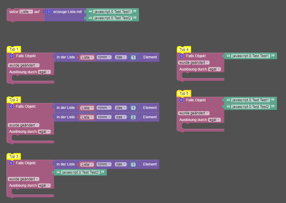

    Hallo Zusammen,
    folgender Fehler ist mir aufgefallen, kann das bitte jemand mal verifizieren?
    hier die XML-Version
    <block xmlns="https://developers.google.com/blockly/xml" type="on_ext" id=".cAwNxA.y)PzO7qSdubS" x="163" y="513">
    <mutation xmlns="http://www.w3.org/1999/xhtml" items="2"></mutation>
    <value name="OID0">
    <shadow type="field_oid" id="nI^Yy_gM_h)Q^tw3AOyc">
    </shadow>
    <block type="lists_getIndex" id="kW)Xl~k!2nZ)XR#p@Zw"> <mutation statement="false" at="true"></mutation> <field name="MODE">GET</field> <field name="WHERE">FROM_START</field> <value name="VALUE"> <block type="variables_get" id="4ux?ZqmcD5aEH@X|M!t">
    <field name="VAR" id="6EBjJ)iQ1:#CX=`DzzZ2">Liste</field>
    </block>
    </value>
    <value name="AT">
    <block type="math_number" id="pM[./:wg|Rc1izY#/cmb">
    <field name="NUM">1</field>
    </block>
    </value>
    </block>
    </value>
    <value name="OID1">
    <shadow type="field_oid" id="guMHVNGspORB|;tDd}^,">
    </shadow>
    <block type="text" id="pV3k/9[b1R-qen|Y$M0w">
    <field name="TEXT">wxyz</field>
    </block>
    </value>
    </block>
    Dieses einfache Blockly läuft auf diesen Fehler
    javascript.0	2021-03-29 17:28:20.917	error	(1190) at processImmediate (internal/timers.js:463:21)
    javascript.0	2021-03-29 17:28:20.917	error	(1190) at Immediate._onImmediate (/opt/iobroker/node_modules/iobroker.javascript/main.js:1238:17)
    javascript.0	2021-03-29 17:28:20.917	error	(1190) at /opt/iobroker/node_modules/iobroker.javascript/main.js:1722:17
    javascript.0	2021-03-29 17:28:20.916	error	(1190) at prepareScript (/opt/iobroker/node_modules/iobroker.javascript/main.js:1621:37)
    javascript.0	2021-03-29 17:28:20.916	error	(1190) at createVM (/opt/iobroker/node_modules/iobroker.javascript/main.js:1383:28)
    javascript.0	2021-03-29 17:28:20.916	error	(1190) at Object.createScript (vm.js:261:10)
    javascript.0	2021-03-29 17:28:20.916	error	(1190) at new Script (vm.js:88:7)
    javascript.0	2021-03-29 17:28:20.916	error	(1190) SyntaxError: Invalid or unexpected token
    javascript.0	2021-03-29 17:28:20.916	error	(1190) ^^^^^^
    javascript.0	2021-03-29 17:28:20.915	error	(1190) on({id: new RegExp(Liste\\[0] + "$|" + 'wxyz' + "$"), change: "ne"}, async function (obj) {
    javascript.0	2021-03-29 17:28:20.915	error	at script.js.Meine_Schalter.AAA_Test3:11
    javascript.0	2021-03-29 17:28:20.915	error	(1190) script.js.Meine_Schalter.AAA_Test3 compile failed:
    Für mich stellt sich das so dar:
    • der obere Trigger allein funktioniert ohne den unteren (einfach mal deaktivieren) perfekt
    • der Fehler wird NUR vom unteren ausgelöst
    • entferne ich vom unteren den Listenaufruf und setze was x-beliebiges ein, dann funktioniert es auch
    --> sobald ein mehrfach Trigger (dieser Art) mind. ein Listenaufruf beinhaltet, kann es nicht mehr compiliert werden.
    Könnt ihr das bitte mal prüfen?
    Aktuell hab ich Version 5.0.14 installiert ... glaube aber, dass dieses Problem auch schon mit Version 4.x bestanden hat.
    Herzlichen Dank :-)
    Grüße Plasma
    P.S.: habe weder in der Suche hier im Forum noch in den Issues in Github was dazu gefunden!

      @plasmachef
      Der Mehrfachtrigger ist für so exotische Verwendung nicht ausgelegt: Entweder Mehrfachtrigger mit Datenpunkt-IDs (verwendet RegExp) oder ein Array of IDs.
      • HomoranH Nicht stören
        @plasmachef sagte in Mehrfach Trigger mit Listenelementen schlägt fehl:
        das ist definitiv kein einfaches Blockly
        Der einzige Fehler liegt in der Verwendung des Triggers.
        Der kann nur auf IDs triggern, nicht auf "Wert von..." und auch nicht auf einen String
        PlasmachefP 1 Antwort Letzte Antwort

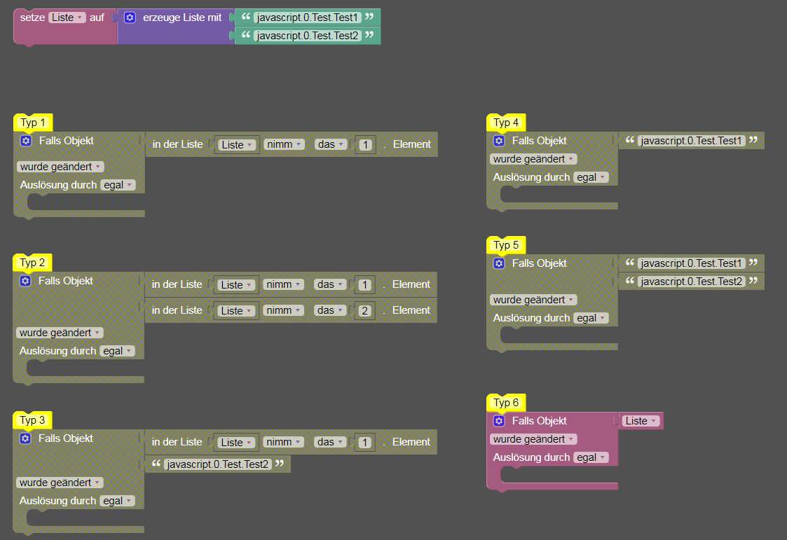

          Danke, dass ihr euch damit beschäftigt!
          Vielleicht verstehe ich das ganze auch falsch ... es geht hier nicht um den Inhalt der Strings ...
          Um dieses Missverständnis auszuräumen habe ich das Blockly angepasst:
          Hier die XML-Datei um es nachzustellen

          Typ 1 klappt
          Typ 2 läuft auf Fehler
          Typ 3 läuft auf Fehler
          Typ 4 klappt
          Typ 5 klappt
            <variables>
            <variable id="6EBjJ)iQ1:#CX=DzzZ2">Liste</variable> </variables> <block type="variables_set" id="9^#!z1DanX_N?wmtg}Jq" x="163" y="163"> <field name="VAR" id="6EBjJ)iQ1:#CX=DzzZ2">Liste</field>

            Typ 1 klappt
            Typ 4 klappt
            Typ 5 klappt

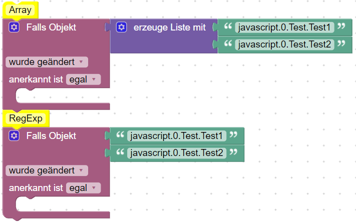

            @plasmachef
            Typen 1 und 4 verwenden kein RegExp, da kein Mehrfachtrigger.
            Typ 5 verwendet RegExp.
            Die Kombination von RegExp und Array-Elementen (Typen 2, 3) funktioniert nicht.
            Was funktioniert:
              @plasmachef
              Was funktioniert:

              Herzlichen Dank, ich glaub, ich habs verstanden!
              ... und verwende ab sofort Typ 6 als Alternative zu Typ 2
              Nochmals Danke und einen schönen Abend noch :-)
              Grüße Plasma
