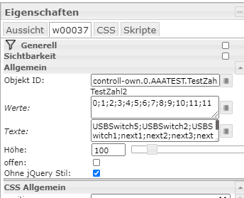

      valuelist widget:

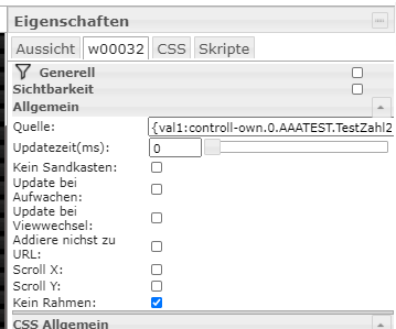

      iframe widget:
      {val1:controll-own.0.AAATEST.TestZahl2;  val1=="0" ? "http://192.168.178.171/" : val1=="1" ? "http://192.168.178.161" :  val1=="2" ? "http://192.168.178.152/" : val1=="3" ? "http://192.168.178.98" : val1=="4" ? "http://192.168.178.78" : val1=="5" ? "http://192.168.178.122" : val1=="6" ? "http://192.168.178.123" : val1=="7" ? "http://192.168.178.99" : val1=="8" ? "http://192.168.178.139" : val1=="9" ? "http://192.168.178.152" : val1=="10" ? "http://192.168.178.160" : val1=="11" ? "http://192.168.178.170" : "http://192.168.178.78"}

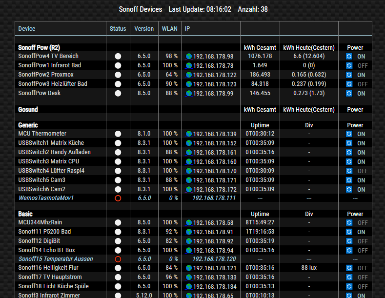

          ps: die anzeige der sonoffs habe ich übrigens anders gelöst: https://forum.iobroker.net/topic/28953/sonoff-geräte-als-html-tabelle-vis-iqontrol

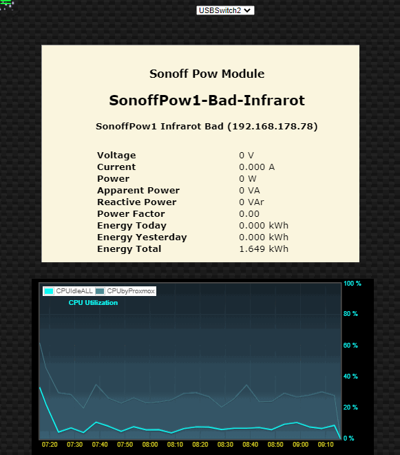

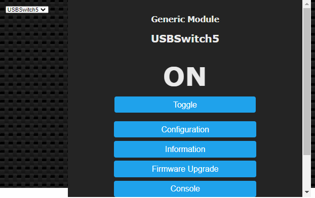

            @leachim
            hier siehst du das problem mit verschiedenen größen der sonoff anzeigeanim-gif22.gif

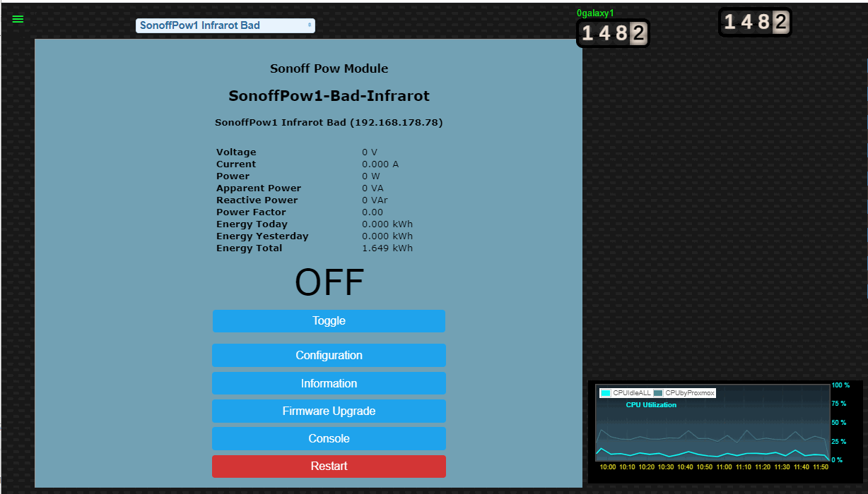

              hab ein kleines script definiert und 2 zusätzliche datenpunkte
              schaut jetzt so aus
              widget:
              [{"tpl":"tplHtml","data":{"g_fixed":false,"g_visibility":false,"g_css_font_text":false,"g_css_background":true,"g_css_shadow_padding":false,"g_css_border":false,"g_gestures":false,"g_signals":false,"g_last_change":false,"visibility-cond":"==","visibility-val":1,"visibility-groups-action":"hide","refreshInterval":"0","signals-cond-0":"==","signals-val-0":true,"signals-icon-0":"/vis/signals/lowbattery.png","signals-icon-size-0":0,"signals-blink-0":false,"signals-horz-0":0,"signals-vert-0":0,"signals-hide-edit-0":false,"signals-cond-1":"==","signals-val-1":true,"signals-icon-1":"/vis/signals/lowbattery.png","signals-icon-size-1":0,"signals-blink-1":false,"signals-horz-1":0,"signals-vert-1":0,"signals-hide-edit-1":false,"signals-cond-2":"==","signals-val-2":true,"signals-icon-2":"/vis/signals/lowbattery.png","signals-icon-size-2":0,"signals-blink-2":false,"signals-horz-2":0,"signals-vert-2":0,"signals-hide-edit-2":false,"lc-type":"last-change","lc-is-interval":true,"lc-is-moment":false,"lc-format":"","lc-position-vert":"top","lc-position-horz":"right","lc-offset-vert":0,"lc-offset-horz":0,"lc-font-size":"12px","lc-font-family":"","lc-font-style":"","lc-bkg-color":"","lc-color":"","lc-border-width":"0","lc-border-style":"","lc-border-color":"","lc-border-radius":10,"lc-zindex":0,"html":"{controll-own.0.AAATEST.TestUrl}"},"style":{"left":"52px","top":"59px","width":"936px","height":"768px","background-color":"#73a2b5","transform":""},"widgetSet":"basic"},{"tpl":"tplJquiSelectList","data":{"oid":"controll-own.0.AAATEST.TestZahl2","g_fixed":false,"g_visibility":false,"g_css_font_text":false,"g_css_background":false,"g_css_shadow_padding":false,"g_css_border":false,"g_gestures":false,"g_signals":false,"g_last_change":false,"visibility-cond":"==","visibility-val":1,"visibility-groups-action":"hide","values":"0;1;2;3;4;5;6;7;8;9;10;11;11;12;13;14;15;16;17;18;19;20;21;22","texts":"SonoffPow4 TV Bereich;SonoffPow1 Infrarot Bad;SonoffPow2 Proxmox;WLEDRund;ESPEasy1;next3;next4;next5;next6;next7;next8;next9;USBSwitch5;USBSwitch2;USBSwitch1;next1;next2;next3;next4;next5;next6;next7;next8","height":"357","signals-cond-0":"==","signals-val-0":true,"signals-icon-0":"/vis/signals/lowbattery.png","signals-icon-size-0":0,"signals-blink-0":false,"signals-horz-0":0,"signals-vert-0":0,"signals-hide-edit-0":false,"signals-cond-1":"==","signals-val-1":true,"signals-icon-1":"/vis/signals/lowbattery.png","signals-icon-size-1":0,"signals-blink-1":false,"signals-horz-1":0,"signals-vert-1":0,"signals-hide-edit-1":false,"signals-cond-2":"==","signals-val-2":true,"signals-icon-2":"/vis/signals/lowbattery.png","signals-icon-size-2":0,"signals-blink-2":false,"signals-horz-2":0,"signals-vert-2":0,"signals-hide-edit-2":false,"lc-type":"last-change","lc-is-interval":true,"lc-is-moment":false,"lc-format":"","lc-position-vert":"top","lc-position-horz":"right","lc-offset-vert":0,"lc-offset-horz":0,"lc-font-size":"12px","lc-font-family":"","lc-font-style":"","lc-bkg-color":"","lc-color":"","lc-border-width":"0","lc-border-style":"","lc-border-color":"","lc-border-radius":10,"lc-zindex":0,"no_style":false},"style":{"left":"225px","top":"23px","width":"307px","height":"28px","z-index":"10"},"widgetSet":"jqui"},{"tpl":"tplIFrame","data":{"g_fixed":false,"g_visibility":false,"g_css_font_text":false,"g_css_background":false,"g_css_shadow_padding":false,"g_css_border":false,"g_gestures":false,"g_signals":false,"g_last_change":false,"visibility-cond":"==","visibility-val":1,"visibility-groups-action":"hide","refreshInterval":"0","seamless":"true","signals-cond-0":"==","signals-val-0":true,"signals-icon-0":"/vis/signals/lowbattery.png","signals-icon-size-0":0,"signals-blink-0":false,"signals-horz-0":0,"signals-vert-0":0,"signals-hide-edit-0":false,"signals-cond-1":"==","signals-val-1":true,"signals-icon-1":"/vis/signals/lowbattery.png","signals-icon-size-1":0,"signals-blink-1":false,"signals-horz-1":0,"signals-vert-1":0,"signals-hide-edit-1":false,"signals-cond-2":"==","signals-val-2":true,"signals-icon-2":"/vis/signals/lowbattery.png","signals-icon-size-2":0,"signals-blink-2":false,"signals-horz-2":0,"signals-vert-2":0,"signals-hide-edit-2":false,"lc-type":"last-change","lc-is-interval":true,"lc-is-moment":false,"lc-format":"","lc-position-vert":"top","lc-position-horz":"right","lc-offset-vert":0,"lc-offset-horz":0,"lc-font-size":"12px","lc-font-family":"","lc-font-style":"","lc-bkg-color":"","lc-color":"","lc-border-width":"0","lc-border-style":"","lc-border-color":"","lc-border-radius":10,"lc-zindex":0,"src":"{controll-own.0.AAATEST.TestGraph}"},"style":{"left":"997px","top":"643px","width":"470px","height":"176px"},"widgetSet":"basic"}]
              script:
              let device= [{"num":0,"name":"SonoffPow4 TV Bereich","url":"http://192.168.178.98/","hoehe":"1000","breite":"1000","graph":"http://192.168.178.59:8082/flot/index.html?l%5B0%5D%5Bid%5D=javascript.0.GETPROCESS.MemoryFree&l%5B0%5D%5Binstance%5D=sql.0&l%5B0%5D%5Boffset%5D=0&l%5B0%5D%5Baggregate%5D=minmax&l%5B0%5D%5Bcolor%5D=%23EE5757&l%5B0%5D%5Bmin%5D=0&l%5B0%5D%5Bmax%5D=3000&l%5B0%5D%5Bthickness%5D=3&l%5B0%5D%5Bshadowsize%5D=3&l%5B0%5D%5BafterComma%5D=0&l%5B0%5D%5Bdashes%5D=false&l%5B0%5D%5BdashLength%5D=10&l%5B0%5D%5BspaceLength%5D=10&l%5B0%5D%5Byticks%5D=20&l%5B0%5D%5Bfill%5D=0&l%5B1%5D%5Bid%5D=javascript.0.GETPROCESS.MemoryUsed&l%5B1%5D%5Binstance%5D=sql.0&l%5B1%5D%5Boffset%5D=0&l%5B1%5D%5Baggregate%5D=minmax&l%5B1%5D%5Bcolor%5D=%230000FF&l%5B1%5D%5Bmin%5D=0&l%5B1%5D%5Bmax%5D=3000&l%5B1%5D%5Bthickness%5D=3&l%5B1%5D%5Bshadowsize%5D=3&l%5B1%5D%5Byaxe%5D=off&l%5B1%5D%5Bxaxe%5D=off&l%5B1%5D%5BafterComma%5D=0&l%5B1%5D%5Bdashes%5D=false&l%5B1%5D%5BdashLength%5D=10&l%5B1%5D%5BspaceLength%5D=10&l%5B2%5D%5Bid%5D=javascript.0.GETPROCESS.MemoryAvail&l%5B2%5D%5Boffset%5D=0&l%5B2%5D%5Baggregate%5D=minmax&l%5B2%5D%5Bcolor%5D=%2383c1e5&l%5B2%5D%5Bmin%5D=0&l%5B2%5D%5Bmax%5D=3000&l%5B2%5D%5Bthickness%5D=3&l%5B2%5D%5Bshadowsize%5D=3&l%5B2%5D%5Bxaxe%5D=off&l%5B2%5D%5Byaxe%5D=off&l%5B2%5D%5Binstance%5D=sql.0&l%5B3%5D%5Bid%5D=javascript.0.GETPROCESS.SwapSize&l%5B3%5D%5Binstance%5D=sql.0&l%5B3%5D%5Boffset%5D=0&l%5B3%5D%5Baggregate%5D=minmax&l%5B3%5D%5Bcolor%5D=%23FFFF00&l%5B3%5D%5Bmin%5D=0&l%5B3%5D%5Bmax%5D=3000&l%5B3%5D%5Bthickness%5D=3&l%5B3%5D%5Bshadowsize%5D=3&l%5B3%5D%5Bxaxe%5D=off&l%5B3%5D%5Byaxe%5D=off&timeType=relative&relativeEnd=now&range=120&aggregateType=count&aggregateSpan=300&hoverDetail=true&useComma=false&zoom=false&noedit=true&animation=0&barColor=%23fefefe&legBg=%23fefefe&live=30&window_bg=%23000000&bg=5&timeFormat=%25H%3A%25M&noBorder=noborder&x_labels_color=%23d7cf23&y_labels_color=%23d7cf23&start=2019-02-22&start_time=06%3A00&end_time=01%3A30&titlePos=top%3A50%3Bleft%3A65&legend=nw&titleColor=%2300efbf&barFontColor=200&legColumns=5&legBgOpacity=%23FF0000&barLabels=bottom&barWidth=15&barFontSize=15&title=MEMORY&titleSize=14"},
                          {"num":1,"name":"SonoffPow1 Infrarot Bad","url":"http://192.168.178.78/","hoehe":"1000","breite":"1000","graph":"http://192.168.178.59:8082/flot/index.html?l%5B0%5D%5Bid%5D=javascript.0.GETPROCESS.CPUIdleALL&l%5B0%5D%5Binstance%5D=sql.0&l%5B0%5D%5Boffset%5D=0&l%5B0%5D%5Baggregate%5D=average&l%5B0%5D%5Bcolor%5D=%230efbf6&l%5B0%5D%5Bthickness%5D=2&l%5B0%5D%5Bshadowsize%5D=3&l%5B0%5D%5Byaxe%5D=rightColor&l%5B0%5D%5Bfill%5D=0&l%5B0%5D%5BafterComma%5D=0&l%5B0%5D%5Bdashes%5D=false&l%5B0%5D%5BdashLength%5D=10&l%5B0%5D%5BspaceLength%5D=10&l%5B0%5D%5Bmin%5D=0&l%5B0%5D%5Bmax%5D=100&l%5B0%5D%5BchartType%5D=line&l%5B0%5D%5BignoreNull%5D=false&l%5B1%5D%5Bid%5D=javascript.0.GETPROCESS.CPUbyProxmox&l%5B1%5D%5Boffset%5D=0&l%5B1%5D%5Baggregate%5D=average&l%5B1%5D%5Bcolor%5D=%234f8b94&l%5B1%5D%5Bmin%5D=0&l%5B1%5D%5Bmax%5D=100&l%5B1%5D%5Bthickness%5D=1&l%5B1%5D%5Bshadowsize%5D=1&l%5B1%5D%5Byaxe%5D=off&l%5B1%5D%5BafterComma%5D=0&l%5B1%5D%5Bdashes%5D=false&l%5B1%5D%5BdashLength%5D=10&l%5B1%5D%5BspaceLength%5D=10&l%5B1%5D%5ByOffset%5D=0&l%5B1%5D%5Bxaxe%5D=off&l%5B1%5D%5Binstance%5D=sql.0&l%5B1%5D%5BignoreNull%5D=false&timeType=relative&relativeEnd=1minute&range=120&aggregateType=step&hoverDetail=true&useComma=false&zoom=true&noedit=false&animation=300&barColor=%23fefefe&barLabels=topover&barWidth=15&legBg=%23fefefe&window_bg=%23000000&bg=5&timeFormat=%25H%3A%25M&noBorder=noborder&x_labels_color=%23d7cf23&y_labels_color=%23d7cf23&start=2019-02-22&start_time=06%3A00&end_time=01%3A30&barFontSize=15&titlePos=top%3A35%3Bleft%3A65&legend=nw&titleColor=%230efbf6&barFontColor=200&title=CPU+Utilization&legColumns=3&legBgOpacity=%23FF0000&titleSize=12&aggregateSpan=300"},
                          {"num":2,"name":"SonoffPow2 Proxmox","url":"http://192.168.178.122/","hoehe":"1000","breite":"1000","graph":""},
                          {"num":3,"name":"WLEDRund","url":"http://192.168.178.129/","hoehe":"1000","breite":"1000","graph":""},
                          {"num":4,"name":"ESPEasy1","url":"http://192.168.178.163/","hoehe":"1000","breite":"1440","graph":""}
              on({id: "controll-own.0.AAATEST.TestZahl2", change: "any"},  function (obj) {
                 let mynum=getState("controll-own.0.AAATEST.TestZahl2").val
              setState("controll-own.0.AAATEST.TestUrl",`<iframe src="${device[mynum].url}" height="${device[mynum].hoehe}" width="${device[mynum].breite}" ></iframe>`)
              setState("controll-own.0.AAATEST.TestGraph",device[mynum].graph)
              L 1 Reply Last reply

                  @leachim ja so simple - einfach ein neues script (java) anlegen - der name ist egal - reinkopieren - und aktivieren
                  du kannst die datenpunkte auch unter userdata_0 anlegen und im script angleichen - controll-own ist von mir und schon früher angelegt - eigerne datenpunkte sollten unter 0_userdata.0. sein
                  z.b.
                  0_userdata.0.iframeAnzeige.TestGraph
                  und diesen dann im script austauschen
