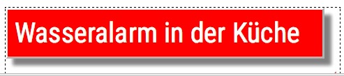

          hier mal zwei Beispiele fürs Blinken mit CSS
          <u>Text</u>
          Widget:
          [{"tpl":"tplHtml","data":{"visibility-cond":">","visibility-val":"0","refreshInterval":"0","visibility-oid":"hm-rpc.0.HEQ0088317.1.STATE","html":"\nWasseralarm in der Küche\n","comment":"hm-rpc.0.HEQ0088317.1.STATE","name":"Meldung Alarm Wassermelder","gestures-offsetX":0,"gestures-offsetY":0,"signals-cond-0":"==","signals-val-0":true,"signals-icon-0":"/vis/signals/lowbattery.png","signals-icon-size-0":0,"signals-blink-0":false,"signals-horz-0":0,"signals-vert-0":0,"signals-hide-edit-0":false,"signals-cond-1":"==","signals-val-1":true,"signals-icon-1":"/vis/signals/lowbattery.png","signals-icon-size-1":0,"signals-blink-1":false,"signals-horz-1":0,"signals-vert-1":0,"signals-hide-edit-1":false,"signals-cond-2":"==","signals-val-2":true,"signals-icon-2":"/vis/signals/lowbattery.png","signals-icon-size-2":0,"signals-blink-2":false,"signals-horz-2":0,"signals-vert-2":0,"signals-hide-edit-2":false,"visibility-groups-action":"hide"},"style":{"left":"22px","top":"462px","z-index":"50","width":"479px","height":"104px","font-size":"40px","color":"white","padding":"","margin-left":""},"widgetSet":"basic"}]
          Wichtig ist dieser HTML Code:````
          Dann im CSS Reiter diesen COde einfügen:

          Sieht dann wie im angehängten Video aus (mov-Datei, hier Screenshot) ![261_bildschirmfoto_2016-11-16_um_19.23.54.jpg](/assets/uploads/files/261_bildschirmfoto_2016-11-16_um_19.23.54.jpg)  ![261_blinktext.mov.zip](/assets/uploads/files/261_blinktext.mov.zip)
          Pix
