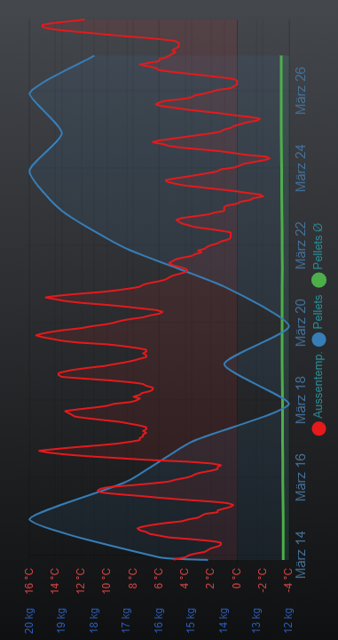

        Und so sieht das Widget aus:
        [{"tpl":"tplVis-materialdesign-Chart-Line-History","data":{"g_fixed":true,"g_visibility":false,"g_css_font_text":false,"g_css_background":false,"g_css_shadow_padding":false,"g_css_border":false,"g_gestures":false,"g_signals":false,"g_last_change":false,"dataCount":"2","aggregate":"average","timeIntervalToShow":"14 days","refreshMethod":"realtime","refreshTimeInterval":"1 hour","pointStyle":"circle","showLegend":"true","legendPosition":"bottom","legendPointStyle":"true","showTooltip":true,"tooltipTimeFormats":"{\"millisecond\":\"lll:ss\",\"second\":\"lll:ss\",\"minute\":\"lll\",\"hour\":\"lll\",\"day\":\"lll\",\"week\":\"lll\",\"month\":\"lll\",\"quarter\":\"lll\",\"year\":\"lll\"}","tooltipShowColorBox":"true","lineSpanGaps0":true,"lineSpanGaps1":true,"xAxisPosition":"bottom","xAxisBounds":"dataSet","xAxisTimeFormats":"{\"minute\":\"HH:mm [Uhr\\\\n] DD.MM[.]\",\"hour\":\"H:00 [Uhr\\\\n] DD.MM[.]\"}","xAxisValueDistanceToAxis":"0","xAxisShowAxis":"true","xAxisShowAxisLabels":"true","xAxisShowGridLines":"true","xAxisShowTicks":"true","yAxisValueDistanceToAxis":"4","showYAxis0":"true","yAxisPosition0":"left","yAxisShowGridLines0":"true","yAxisShowTicks0":"true","yAxisShowAxisBorder0":"true","showYAxis1":"true","yAxisPosition1":"left","yAxisShowGridLines1":"true","yAxisShowTicks1":"true","yAxisShowAxisBorder1":"true","showValues0":false,"valuesPositionAnchor0":"end","valuesPositionAlign0":"top","valuesTextAlign0":"center","showValues1":false,"valuesPositionAnchor1":"end","valuesPositionAlign1":"top","valuesTextAlign1":"center","signals-cond-0":"==","signals-val-0":true,"signals-icon-0":"/vis/signals/lowbattery.png","signals-icon-size-0":0,"signals-blink-0":false,"signals-horz-0":0,"signals-vert-0":0,"signals-hide-edit-0":false,"signals-cond-1":"==","signals-val-1":true,"signals-icon-1":"/vis/signals/lowbattery.png","signals-icon-size-1":0,"signals-blink-1":false,"signals-horz-1":0,"signals-vert-1":0,"signals-hide-edit-1":false,"signals-cond-2":"==","signals-val-2":true,"signals-icon-2":"/vis/signals/lowbattery.png","signals-icon-size-2":0,"signals-blink-2":false,"signals-horz-2":0,"signals-vert-2":0,"signals-hide-edit-2":false,"lc-type":"last-change","lc-is-interval":true,"lc-is-moment":false,"lc-format":"","lc-position-vert":"top","lc-position-horz":"right","lc-offset-vert":0,"lc-offset-horz":0,"lc-font-size":"12px","lc-font-family":"","lc-font-style":"","lc-bkg-color":"","lc-color":"","lc-border-width":"0","lc-border-style":"","lc-border-color":"","lc-border-radius":10,"lc-zindex":0,"oid0":"parser.0.ETA_Aussentemperatur","oid1":"javascript.0.ETA_Vebrauch_letzer_Tag","historyAdapterInstance":"sql.0","maxDataPoints":"300","useFillColor0":true,"lineTension1":"0.2","valuesMaxDecimals0":"1","valuesFontSize0":"11","valuesMaxDecimals1":"1","valuesFontSize1":"11","minTimeInterval":"","commonYAxis0":"0","commonYAxis1":"1","colorScheme":"brewer.SetOne","pointSize":"0","legendFontColor":"#2a8992","legendFontSize":"13","lineTension0":"0.1","lineThikness0":"2","legendText0":"Aussentemp.   ","lineThikness1":"2","legendText1":"Pellets    ","valuesRotation0":"0","valuesAppendText0":" °C","valuesAppendText1":" kg","globalColor":"","tooltipBodyFontSize":"0","legendPadding":"-3","xAxisMaxLabel":"","yAxisValueAppendText1":" kg","yAxisValueAppendText0":" °C","yAxisMinValue0":"","yAxisTitleFontSize":"0","yAxisValueFontSize":"12","yAxisValueColor0":"#cd4242","yAxisValueColor1":"#2c5dba","lineSpanGaps2":"true","showYAxis2":"true","yAxisPosition2":"left","yAxisShowGridLines2":"true","yAxisShowTicks2":"true","yAxisShowAxisBorder2":"true","showValues2":false,"valuesPositionAnchor2":"end","valuesPositionAlign2":"top","valuesTextAlign2":"center","oid2":"javascript.0.ETA_Verbrauch_Daily_AVG_ALL","commonYAxis2":"1","legendText2":"Pellets Ø","visibility-cond":"==","visibility-val":1,"visibility-groups-action":"hide","class":"rotate270"},"style":{"left":"-144px","top":"202px","width":"700px","height":"350px"},"widgetSet":"materialdesign"}]
