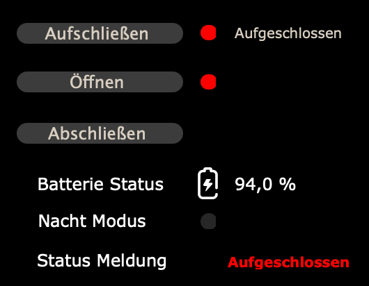

              Mein Beitrag war aus dem März - inzwischen habe ich das NUKI visualisiert ;)

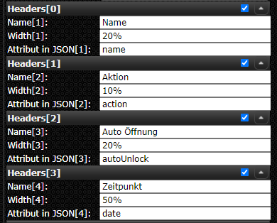

              Die angesprochene json ist zwar ganz nett, aber noch besser wäre es wenn diese bei Aktion Klarnamen ausspucken würde. Ich weiß zwar welche Nummer was bedeutet (geöffnet, geschlossen usw.), aber wie gesagt, Klarnamen wäre nice.

                Erstelle Dir doch einen neuen Datenpunkt und ein Script, was das JSON bearbeitet und dann in den neuen DP stellt. Dieses verwendest Du dann in der View.

                    Ach vergiss es - ist zu früh am Morgen - hatte Tomaten auf den Augen.
                    [{"tpl":"tplFrame","data":{"visibility-cond":"==","visibility-val":1,"title":"NUKI - Haustür","title_color":"#d7cec1","title_top":"-30","title_left":"0","header_height":"0","header_color":"","title_back":"","gestures-offsetX":0,"gestures-offsetY":0,"signals-cond-0":"==","signals-val-0":true,"signals-icon-0":"/vis.0/main/lowbattery.png","signals-icon-size-0":0,"signals-blink-0":false,"signals-horz-0":0,"signals-vert-0":0,"signals-hide-edit-0":false,"signals-cond-1":"==","signals-val-1":true,"signals-icon-1":"/vis.0/main/lowbattery.png","signals-icon-size-1":0,"signals-blink-1":false,"signals-horz-1":0,"signals-vert-1":0,"signals-hide-edit-1":false,"signals-cond-2":"==","signals-val-2":true,"signals-icon-2":"/vis.0/main/lowbattery.png","signals-icon-size-2":0,"signals-blink-2":false,"signals-horz-2":0,"signals-vert-2":0,"signals-hide-edit-2":false,"visibility-groups-action":"hide","lc-type":"last-change","lc-is-interval":true,"lc-is-moment":false,"lc-format":"","lc-position-vert":"top","lc-position-horz":"right","lc-offset-vert":0,"lc-offset-horz":0,"lc-font-size":"12px","lc-font-family":"","lc-font-style":"","lc-bkg-color":"","lc-color":"","lc-border-width":"0","lc-border-style":"","lc-border-color":"","lc-border-radius":10,"lc-zindex":0,"visibility-oid":""},"style":{"left":"678px","top":"100px","width":"584px","height":"327px","font-family":"Verdana, Geneva, sans-serif","font-style":"normal","font-variant":"normal","font-weight":"normal","font-size":"large","z-index":"0","text-shadow":"none","color":"","background":"rgba(39, 39, 39, 50)","border-style":"none","box-shadow":"2px 2px 3px rgba(20, 20, 20, 50)","border-radius":"20px"},"widgetSet":"basic"},{"tpl":"tplJquiToogle","data":{"oid":"nuki-extended.0.info.connection","g_fixed":false,"g_visibility":false,"g_css_font_text":true,"g_css_background":true,"g_css_shadow_padding":false,"g_css_border":true,"g_gestures":false,"g_signals":true,"g_last_change":false,"signals-cond-0":"==","signals-val-0":"false","signals-icon-0":"/vis.0/main/icons/geoeffnet.png","signals-icon-size-0":"120","signals-blink-0":false,"signals-horz-0":0,"signals-vert-0":0,"signals-hide-edit-0":false,"signals-cond-1":"==","signals-val-1":"true","signals-icon-1":"/vis.0/main/icons/verschlossen.png","signals-icon-size-1":"120","signals-blink-1":false,"signals-horz-1":0,"signals-vert-1":0,"signals-hide-edit-1":false,"signals-cond-2":"==","signals-val-2":"false","signals-icon-2":"/vis.0/main/icons/entriegelt.png","signals-icon-size-2":"120","signals-blink-2":false,"signals-horz-2":0,"signals-vert-2":0,"signals-hide-edit-2":false,"lc-type":"last-change","lc-is-interval":true,"lc-is-moment":false,"lc-format":"","lc-position-vert":"top","lc-position-horz":"right","lc-offset-vert":0,"lc-offset-horz":0,"lc-font-size":"12px","lc-font-family":"","lc-font-style":"","lc-bkg-color":"","lc-color":"","lc-border-width":"0","lc-border-style":"","lc-border-color":"","lc-border-radius":10,"lc-zindex":0,"src_true":"true","src_false":"","signals-oid-2":"nuki-extended.0.smartlocks.haustür.state.locked","label":"","signals-oid-1":"nuki-extended.0.smartlocks.haustür.state.locked","signals-oid-0":"nuki-extended.0.smartlocks.haustür.state.closed","visibility-cond":"==","visibility-val":1,"visibility-groups-action":"hide"},"style":{"left":"728px","top":"165px","background":"rgba(60, 60, 60, 20)","border-radius":"20px","border-width":"0px","z-index":"44","width":"132px","height":"214px","position":"","color":""},"widgetSet":"jqui"},{"tpl":"tplValueList","data":{"oid":"nothing_selected","g_fixed":false,"g_visibility":false,"g_css_font_text":true,"g_css_background":false,"g_css_shadow_padding":false,"g_css_border":false,"g_gestures":false,"g_signals":false,"g_last_change":false,"visibility-cond":"==","visibility-val":1,"visibility-groups-action":"hide","signals-cond-0":"==","signals-val-0":true,"signals-icon-0":"/vis.0/main/lowbattery.png","signals-icon-size-0":0,"signals-blink-0":false,"signals-horz-0":0,"signals-vert-0":0,"signals-hide-edit-0":false,"signals-cond-1":"==","signals-val-1":true,"signals-icon-1":"/vis.0/main/lowbattery.png","signals-icon-size-1":0,"signals-blink-1":false,"signals-horz-1":0,"signals-vert-1":0,"signals-hide-edit-1":false,"signals-cond-2":"==","signals-val-2":true,"signals-icon-2":"/vis.0/main/lowbattery.png","signals-icon-size-2":0,"signals-blink-2":false,"signals-horz-2":0,"signals-vert-2":0,"signals-hide-edit-2":false,"lc-type":"last-change","lc-is-interval":true,"lc-is-moment":false,"lc-format":"","lc-position-vert":"top","lc-position-horz":"right","lc-offset-vert":0,"lc-offset-horz":0,"lc-font-size":"12px","lc-font-family":"","lc-font-style":"","lc-bkg-color":"","lc-color":"","lc-border-width":"0","lc-border-style":"","lc-border-color":"","lc-border-radius":10,"lc-zindex":0,"html_prepend":"Status Verschluss"},"style":{"left":"973px","top":"113px","font-family":"Verdana, Geneva, sans-serif","font-style":"normal","font-variant":"normal","font-weight":"normal","font-size":"large","color":"#FFFFFF","text-align":"left","z-index":"21","width":"170px"},"widgetSet":"basic"},{"tpl":"tplValueListHtml8","data":{"oid":"nuki-extended.0.smartlocks.haustür.state.locked","count":"1","value0":"true","value1":"false","style1":"background-color: green","style0":"background-color: red","value2":"","style2":"background-color: red","test_list":"1","gestures-offsetX":0,"gestures-offsetY":0,"signals-cond-0":"==","signals-val-0":true,"signals-icon-0":"/vis.0/main/lowbattery.png","signals-icon-size-0":0,"signals-blink-0":false,"signals-horz-0":0,"signals-vert-0":0,"signals-hide-edit-0":false,"signals-cond-1":"==","signals-val-1":true,"signals-icon-1":"/vis.0/main/lowbattery.png","signals-icon-size-1":0,"signals-blink-1":false,"signals-horz-1":0,"signals-vert-1":0,"signals-hide-edit-1":false,"signals-cond-2":"==","signals-val-2":true,"signals-icon-2":"/vis.0/main/lowbattery.png","signals-icon-size-2":0,"signals-blink-2":false,"signals-horz-2":0,"signals-vert-2":0,"signals-hide-edit-2":false,"lc-type":"last-change","lc-is-interval":true,"lc-is-moment":false,"lc-format":"","lc-position-vert":"top","lc-position-horz":"right","lc-offset-vert":0,"lc-offset-horz":0,"lc-font-size":"12px","lc-font-family":"","lc-font-style":"","lc-bkg-color":"","lc-color":"","lc-border-width":"2","lc-border-style":"","lc-border-color":"","lc-border-radius":"0","lc-zindex":0,"g_visibility":true,"visibility-cond":"==","visibility-val":"false","visibility-groups-action":"hide","visibility-oid":"nuki-extended.0.smartlocks.haustür.state.locked"},"style":{"left":"1079px","top":"169px","color":"transparent","text-align":"left","font-family":"Verdana, Geneva, sans-serif","font-style":"normal","font-variant":"normal","font-weight":"","font-size":"x-small","width":"15px","height":"15px","z-index":"20","overflow-x":"","border-radius":"50px"},"widgetSet":"basic"},{"tpl":"tplValueListHtml8","data":{"oid":"nuki-extended.0.smartlocks.haustür.state.locked","count":"1","value0":"false","value1":"true","style1":"background-color: green","style0":"background-color: red","value2":"","style2":"background-color: red","test_list":"0","gestures-offsetX":0,"gestures-offsetY":0,"signals-cond-0":"==","signals-val-0":true,"signals-icon-0":"/vis.0/main/lowbattery.png","signals-icon-size-0":0,"signals-blink-0":false,"signals-horz-0":0,"signals-vert-0":0,"signals-hide-edit-0":false,"signals-cond-1":"==","signals-val-1":true,"signals-icon-1":"/vis.0/main/lowbattery.png","signals-icon-size-1":0,"signals-blink-1":false,"signals-horz-1":0,"signals-vert-1":0,"signals-hide-edit-1":false,"signals-cond-2":"==","signals-val-2":true,"signals-icon-2":"/vis.0/main/lowbattery.png","signals-icon-size-2":0,"signals-blink-2":false,"signals-horz-2":0,"signals-vert-2":0,"signals-hide-edit-2":false,"lc-type":"last-change","lc-is-interval":true,"lc-is-moment":false,"lc-format":"","lc-position-vert":"top","lc-position-horz":"right","lc-offset-vert":0,"lc-offset-horz":0,"lc-font-size":"12px","lc-font-family":"","lc-font-style":"","lc-bkg-color":"","lc-color":"","lc-border-width":"2","lc-border-style":"","lc-border-color":"","lc-border-radius":"0","lc-zindex":0,"g_visibility":true,"visibility-cond":"==","visibility-val":"true","visibility-groups-action":"hide","visibility-oid":"nuki-extended.0.smartlocks.haustür.state.locked"},"style":{"left":"1079px","top":"265px","color":"transparent","text-align":"left","font-family":"Verdana, Geneva, sans-serif","font-style":"normal","font-variant":"normal","font-weight":"","font-size":"x-small","width":"15px","height":"15px","z-index":"20","overflow-x":"","border-radius":"50px"},"widgetSet":"basic"},{"tpl":"tplValueStringRaw","data":{"oid":"","visibility-cond":"==","visibility-val":"false","gestures-offsetX":0,"gestures-offsetY":0,"signals-cond-0":"==","signals-val-0":true,"signals-icon-0":"/vis.0/main/lowbattery.png","signals-icon-size-0":0,"signals-blink-0":false,"signals-horz-0":0,"signals-vert-0":0,"signals-hide-edit-0":false,"signals-cond-1":"==","signals-val-1":true,"signals-icon-1":"/vis.0/main/lowbattery.png","signals-icon-size-1":0,"signals-blink-1":false,"signals-horz-1":0,"signals-vert-1":0,"signals-hide-edit-1":false,"signals-cond-2":"==","signals-val-2":true,"signals-icon-2":"/vis.0/main/lowbattery.png","signals-icon-size-2":0,"signals-blink-2":false,"signals-horz-2":0,"signals-vert-2":0,"signals-hide-edit-2":false,"visibility-groups-action":"hide","lc-type":"last-change","lc-is-interval":true,"lc-is-moment":false,"lc-format":"","lc-position-vert":"top","lc-position-horz":"right","lc-offset-vert":0,"lc-offset-horz":0,"lc-font-size":"12px","lc-font-family":"","lc-font-style":"","lc-bkg-color":"","lc-color":"","lc-border-width":"0","lc-border-style":"","lc-border-color":"","lc-border-radius":10,"lc-zindex":0,"html_prepend":"Aufgeschlossen","visibility-groups":null,"visibility-oid":"nuki-extended.0.smartlocks.haustür.state.locked"},"style":{"left":"1112px","top":"168px","width":"100px","height":"18px","color":"#d7cec1","text-align":"left","font-family":"Verdana, Geneva, sans-serif","font-style":"","font-variant":"","font-weight":"normal","font-size":"small","text-shadow":"none","z-index":"5","border-style":"none"},"widgetSet":"basic"},{"tpl":"tplValueListHtml8","data":{"oid":"deconz.0.Sensors.36.open","count":"1","value0":"false","value1":"true","style1":"background-color: red","style0":"background-color: green","value2":"","style2":"background-color: red","test_list":"0","gestures-offsetX":0,"gestures-offsetY":0,"signals-cond-0":"==","signals-val-0":true,"signals-icon-0":"/vis.0/main/lowbattery.png","signals-icon-size-0":0,"signals-blink-0":false,"signals-horz-0":0,"signals-vert-0":0,"signals-hide-edit-0":false,"signals-cond-1":"==","signals-val-1":true,"signals-icon-1":"/vis.0/main/lowbattery.png","signals-icon-size-1":0,"signals-blink-1":false,"signals-horz-1":0,"signals-vert-1":0,"signals-hide-edit-1":false,"signals-cond-2":"==","signals-val-2":true,"signals-icon-2":"/vis.0/main/lowbattery.png","signals-icon-size-2":0,"signals-blink-2":false,"signals-horz-2":0,"signals-vert-2":0,"signals-hide-edit-2":false,"lc-type":"last-change","lc-is-interval":true,"lc-is-moment":false,"lc-format":"","lc-position-vert":"top","lc-position-horz":"right","lc-offset-vert":0,"lc-offset-horz":0,"lc-font-size":"12px","lc-font-family":"","lc-font-style":"","lc-bkg-color":"","lc-color":"","lc-border-width":"2","lc-border-style":"","lc-border-color":"","lc-border-radius":"0","lc-zindex":0,"g_visibility":false,"visibility-cond":"==","visibility-val":1,"visibility-groups-action":"hide"},"style":{"left":"1079px","top":"216px","color":"transparent","text-align":"left","font-family":"Verdana, Geneva, sans-serif","font-style":"normal","font-variant":"normal","font-weight":"","font-size":"x-small","width":"15px","height":"15px","z-index":"20","overflow-x":"","border-radius":"50px"},"widgetSet":"basic"},{"tpl":"tplValueStringRaw","data":{"oid":"","visibility-cond":"==","visibility-val":"true","gestures-offsetX":0,"gestures-offsetY":0,"signals-cond-0":"==","signals-val-0":true,"signals-icon-0":"/vis.0/main/lowbattery.png","signals-icon-size-0":0,"signals-blink-0":false,"signals-horz-0":0,"signals-vert-0":0,"signals-hide-edit-0":false,"signals-cond-1":"==","signals-val-1":true,"signals-icon-1":"/vis.0/main/lowbattery.png","signals-icon-size-1":0,"signals-blink-1":false,"signals-horz-1":0,"signals-vert-1":0,"signals-hide-edit-1":false,"signals-cond-2":"==","signals-val-2":true,"signals-icon-2":"/vis.0/main/lowbattery.png","signals-icon-size-2":0,"signals-blink-2":false,"signals-horz-2":0,"signals-vert-2":0,"signals-hide-edit-2":false,"visibility-groups-action":"hide","lc-type":"last-change","lc-is-interval":true,"lc-is-moment":false,"lc-format":"","lc-position-vert":"top","lc-position-horz":"right","lc-offset-vert":0,"lc-offset-horz":0,"lc-font-size":"12px","lc-font-family":"","lc-font-style":"","lc-bkg-color":"","lc-color":"","lc-border-width":"0","lc-border-style":"","lc-border-color":"","lc-border-radius":10,"lc-zindex":0,"html_prepend":"Tür Geöffnet","visibility-groups":null,"visibility-oid":"deconz.0.Sensors.36.open","gestures-rotating-minimum":"-1"},"style":{"left":"1112px","top":"215px","width":"120px","height":"18px","color":"#d7cec1","text-align":"left","font-family":"Verdana, Geneva, sans-serif","font-style":"","font-variant":"","font-weight":"normal","font-size":"small","text-shadow":"none","z-index":"5","border-style":"none"},"widgetSet":"basic"},{"tpl":"tplValueStringRaw","data":{"oid":"","visibility-cond":"==","visibility-val":"true","gestures-offsetX":0,"gestures-offsetY":0,"signals-cond-0":"==","signals-val-0":true,"signals-icon-0":"/vis.0/main/lowbattery.png","signals-icon-size-0":0,"signals-blink-0":false,"signals-horz-0":0,"signals-vert-0":0,"signals-hide-edit-0":false,"signals-cond-1":"==","signals-val-1":true,"signals-icon-1":"/vis.0/main/lowbattery.png","signals-icon-size-1":0,"signals-blink-1":false,"signals-horz-1":0,"signals-vert-1":0,"signals-hide-edit-1":false,"signals-cond-2":"==","signals-val-2":true,"signals-icon-2":"/vis.0/main/lowbattery.png","signals-icon-size-2":0,"signals-blink-2":false,"signals-horz-2":0,"signals-vert-2":0,"signals-hide-edit-2":false,"visibility-groups-action":"hide","lc-type":"last-change","lc-is-interval":true,"lc-is-moment":false,"lc-format":"","lc-position-vert":"top","lc-position-horz":"right","lc-offset-vert":0,"lc-offset-horz":0,"lc-font-size":"12px","lc-font-family":"","lc-font-style":"","lc-bkg-color":"","lc-color":"","lc-border-width":"0","lc-border-style":"","lc-border-color":"","lc-border-radius":10,"lc-zindex":0,"html_prepend":"Abgeschlossen","visibility-groups":null,"visibility-oid":"nuki-extended.0.smartlocks.haustür.state.locked"},"style":{"left":"1112px","top":"263px","width":"100px","height":"18px","color":"#d7cec1","text-align":"left","font-family":"Verdana, Geneva, sans-serif","font-style":"","font-variant":"","font-weight":"normal","font-size":"small","text-shadow":"none","z-index":"5","border-style":"none"},"widgetSet":"basic"},{"tpl":"tplValueList","data":{"oid":"nothing_selected","g_fixed":false,"g_visibility":false,"g_css_font_text":true,"g_css_background":false,"g_css_shadow_padding":false,"g_css_border":false,"g_gestures":false,"g_signals":false,"g_last_change":false,"visibility-cond":"==","visibility-val":1,"visibility-groups-action":"hide","signals-cond-0":"==","signals-val-0":true,"signals-icon-0":"/vis.0/main/lowbattery.png","signals-icon-size-0":0,"signals-blink-0":false,"signals-horz-0":0,"signals-vert-0":0,"signals-hide-edit-0":false,"signals-cond-1":"==","signals-val-1":true,"signals-icon-1":"/vis.0/main/lowbattery.png","signals-icon-size-1":0,"signals-blink-1":false,"signals-horz-1":0,"signals-vert-1":0,"signals-hide-edit-1":false,"signals-cond-2":"==","signals-val-2":true,"signals-icon-2":"/vis.0/main/lowbattery.png","signals-icon-size-2":0,"signals-blink-2":false,"signals-horz-2":0,"signals-vert-2":0,"signals-hide-edit-2":false,"lc-type":"last-change","lc-is-interval":true,"lc-is-moment":false,"lc-format":"","lc-position-vert":"top","lc-position-horz":"right","lc-offset-vert":0,"lc-offset-horz":0,"lc-font-size":"12px","lc-font-family":"","lc-font-style":"","lc-bkg-color":"","lc-color":"","lc-border-width":"0","lc-border-style":"","lc-border-color":"","lc-border-radius":10,"lc-zindex":0,"html_prepend":"Batterie Status"},"style":{"left":"923px","top":"312px","font-family":"Verdana, Geneva, sans-serif","font-style":"normal","font-variant":"normal","font-weight":"normal","font-size":"medium","color":"#FFFFFF","text-align":"left","z-index":"21","width":"130px","height":"20px"},"widgetSet":"basic"},{"tpl":"tplJquiToogle","data":{"oid":"","src_true":"","src_false":"","invert_icon":false,"alt_true":"","alt_false":"","signals-cond-0":"==","signals-val-0":true,"signals-icon-0":"/vis.0/main/icons/1.png","signals-icon-size-0":0,"signals-blink-0":false,"signals-horz-0":"-60","signals-vert-0":"9","signals-hide-edit-0":false,"signals-cond-1":"==","signals-val-1":"false","signals-icon-1":"/vis.0/main/icons/5.png","signals-icon-size-1":0,"signals-blink-1":false,"signals-horz-1":"-60","signals-vert-1":"9","signals-hide-edit-1":false,"signals-cond-2":"==","signals-val-2":true,"signals-icon-2":"/vis.0/main/lowbattery.png","signals-icon-size-2":0,"signals-blink-2":false,"signals-horz-2":0,"signals-vert-2":0,"signals-hide-edit-2":false,"lc-type":"last-change","lc-is-interval":true,"lc-is-moment":false,"lc-format":"","lc-position-vert":"top","lc-position-horz":"right","lc-offset-vert":0,"lc-offset-horz":0,"lc-font-size":"12px","lc-font-family":"","lc-font-style":"","lc-bkg-color":"","lc-color":"","lc-border-width":"0","lc-border-style":"","lc-border-color":"","lc-border-radius":10,"lc-zindex":0,"g_gestures":false,"signals-oid-0":"nuki-extended.0.smartlocks.haustür.state.batteryCritical","signals-oid-1":"nuki-extended.0.smartlocks.haustür.state.batteryCritical","g_visibility":false,"visibility-cond":"==","visibility-val":1,"visibility-groups-action":"hide","g_fixed":false},"style":{"left":"1079px","top":"302px","width":"15px","height":"38px","background":"transparent","z-index":"20","border-width":"0px","font-family":"Verdana, Geneva, sans-serif","font-weight":"normal"},"widgetSet":"jqui"},{"tpl":"tplJquiToogle","data":{"oid":"nuki-extended.0.smartlocks.haustür._ACTION.UNLOCK","g_fixed":false,"g_visibility":false,"g_css_font_text":true,"g_css_background":true,"g_css_shadow_padding":false,"g_css_border":true,"g_gestures":false,"g_signals":false,"g_last_change":false,"lc-type":"last-change","lc-is-interval":true,"lc-is-moment":false,"lc-format":"","lc-position-vert":"top","lc-position-horz":"right","lc-offset-vert":0,"lc-offset-horz":0,"lc-font-size":"12px","lc-font-family":"","lc-font-style":"","lc-bkg-color":"","lc-color":"","lc-border-width":"0","lc-border-style":"","lc-border-color":"","lc-border-radius":10,"lc-zindex":0,"src_true":"","src_false":"","label":"Aufschließen","visibility-cond":"==","visibility-val":1,"visibility-groups-action":"hide","signals-cond-0":"==","signals-val-0":true,"signals-icon-0":"/vis/signals/lowbattery.png","signals-icon-size-0":0,"signals-blink-0":false,"signals-horz-0":0,"signals-vert-0":0,"signals-hide-edit-0":false,"signals-cond-1":"==","signals-val-1":true,"signals-icon-1":"/vis/signals/lowbattery.png","signals-icon-size-1":0,"signals-blink-1":false,"signals-horz-1":0,"signals-vert-1":0,"signals-hide-edit-1":false,"signals-cond-2":"==","signals-val-2":true,"signals-icon-2":"/vis/signals/lowbattery.png","signals-icon-size-2":0,"signals-blink-2":false,"signals-horz-2":0,"signals-vert-2":0,"signals-hide-edit-2":false,"invert_icon":false},"style":{"left":"903px","top":"167px","background":"rgba(60, 60, 60, 20)","border-radius":"20px","border-width":"0px","z-index":"45","width":"158px","height":"20px","position":"","font-size":"medium","font-weight":"normal","text-align":"center","line-height":"1.4","color":"#d7cec1"},"widgetSet":"jqui"},{"tpl":"tplJquiToogle","data":{"oid":"nuki-extended.0.smartlocks.haustür._ACTION.UNLATCH","g_fixed":false,"g_visibility":false,"g_css_font_text":true,"g_css_background":true,"g_css_shadow_padding":false,"g_css_border":true,"g_gestures":false,"g_signals":false,"g_last_change":false,"lc-type":"last-change","lc-is-interval":true,"lc-is-moment":false,"lc-format":"","lc-position-vert":"top","lc-position-horz":"right","lc-offset-vert":0,"lc-offset-horz":0,"lc-font-size":"12px","lc-font-family":"","lc-font-style":"","lc-bkg-color":"","lc-color":"","lc-border-width":"0","lc-border-style":"","lc-border-color":"","lc-border-radius":10,"lc-zindex":0,"src_true":"","src_false":"","label":"Öffnen","visibility-cond":"==","visibility-val":1,"visibility-groups-action":"hide","signals-cond-0":"==","signals-val-0":true,"signals-icon-0":"/vis/signals/lowbattery.png","signals-icon-size-0":0,"signals-blink-0":false,"signals-horz-0":0,"signals-vert-0":0,"signals-hide-edit-0":false,"signals-cond-1":"==","signals-val-1":true,"signals-icon-1":"/vis/signals/lowbattery.png","signals-icon-size-1":0,"signals-blink-1":false,"signals-horz-1":0,"signals-vert-1":0,"signals-hide-edit-1":false,"signals-cond-2":"==","signals-val-2":true,"signals-icon-2":"/vis/signals/lowbattery.png","signals-icon-size-2":0,"signals-blink-2":false,"signals-horz-2":0,"signals-vert-2":0,"signals-hide-edit-2":false},"style":{"left":"903px","top":"214px","background":"rgba(60, 60, 60, 20)","border-radius":"20px","border-width":"0px","z-index":"45","width":"158px","height":"20px","position":"","font-size":"medium","font-weight":"normal","text-align":"center","line-height":"1.4","color":"#d7cec1"},"widgetSet":"jqui"},{"tpl":"tplJquiToogle","data":{"oid":"nuki-extended.0.smartlocks.haustür._ACTION.LOCK","g_fixed":false,"g_visibility":false,"g_css_font_text":true,"g_css_background":true,"g_css_shadow_padding":false,"g_css_border":true,"g_gestures":false,"g_signals":false,"g_last_change":false,"lc-type":"last-change","lc-is-interval":true,"lc-is-moment":false,"lc-format":"","lc-position-vert":"top","lc-position-horz":"right","lc-offset-vert":0,"lc-offset-horz":0,"lc-font-size":"12px","lc-font-family":"","lc-font-style":"","lc-bkg-color":"","lc-color":"","lc-border-width":"0","lc-border-style":"","lc-border-color":"","lc-border-radius":10,"lc-zindex":0,"src_true":"","src_false":"","label":"Abschließen","visibility-cond":"==","visibility-val":1,"visibility-groups-action":"hide","signals-cond-0":"==","signals-val-0":true,"signals-icon-0":"/vis/signals/lowbattery.png","signals-icon-size-0":0,"signals-blink-0":false,"signals-horz-0":0,"signals-vert-0":0,"signals-hide-edit-0":false,"signals-cond-1":"==","signals-val-1":true,"signals-icon-1":"/vis/signals/lowbattery.png","signals-icon-size-1":0,"signals-blink-1":false,"signals-horz-1":0,"signals-vert-1":0,"signals-hide-edit-1":false,"signals-cond-2":"==","signals-val-2":true,"signals-icon-2":"/vis/signals/lowbattery.png","signals-icon-size-2":0,"signals-blink-2":false,"signals-horz-2":0,"signals-vert-2":0,"signals-hide-edit-2":false},"style":{"left":"903px","top":"263px","background":"rgba(60, 60, 60, 20)","border-radius":"20px","border-width":"0px","z-index":"45","width":"158px","height":"20px","position":"","font-size":"medium","font-weight":"normal","text-align":"center","line-height":"1.4","color":"#d7cec1"},"widgetSet":"jqui"},{"tpl":"tplValueList","data":{"oid":"nothing_selected","g_fixed":false,"g_visibility":false,"g_css_font_text":true,"g_css_background":false,"g_css_shadow_padding":false,"g_css_border":false,"g_gestures":false,"g_signals":false,"g_last_change":false,"visibility-cond":"==","visibility-val":1,"visibility-groups-action":"hide","signals-cond-0":"==","signals-val-0":true,"signals-icon-0":"/vis.0/main/lowbattery.png","signals-icon-size-0":0,"signals-blink-0":false,"signals-horz-0":0,"signals-vert-0":0,"signals-hide-edit-0":false,"signals-cond-1":"==","signals-val-1":true,"signals-icon-1":"/vis.0/main/lowbattery.png","signals-icon-size-1":0,"signals-blink-1":false,"signals-horz-1":0,"signals-vert-1":0,"signals-hide-edit-1":false,"signals-cond-2":"==","signals-val-2":true,"signals-icon-2":"/vis.0/main/lowbattery.png","signals-icon-size-2":0,"signals-blink-2":false,"signals-horz-2":0,"signals-vert-2":0,"signals-hide-edit-2":false,"lc-type":"last-change","lc-is-interval":true,"lc-is-moment":false,"lc-format":"","lc-position-vert":"top","lc-position-horz":"right","lc-offset-vert":0,"lc-offset-horz":0,"lc-font-size":"12px","lc-font-family":"","lc-font-style":"","lc-bkg-color":"","lc-color":"","lc-border-width":"0","lc-border-style":"","lc-border-color":"","lc-border-radius":10,"lc-zindex":0,"html_prepend":"Nacht Modus"},"style":{"left":"925px","top":"347px","font-family":"Verdana, Geneva, sans-serif","font-style":"normal","font-variant":"normal","font-weight":"normal","font-size":"medium","color":"#FFFFFF","text-align":"left","z-index":"21","width":"130px","height":"20px"},"widgetSet":"basic"},{"tpl":"tplValueListHtml8","data":{"oid":"nuki-extended.0.smartlocks.haustür.state.locked","count":"1","value0":"false","value1":"true","style1":"background-color: white","style0":"background-color: rgba(39, 39, 39, 50)","value2":"","style2":"background-color: red","test_list":"1","gestures-offsetX":0,"gestures-offsetY":0,"signals-cond-0":"==","signals-val-0":true,"signals-icon-0":"/vis.0/main/lowbattery.png","signals-icon-size-0":0,"signals-blink-0":false,"signals-horz-0":0,"signals-vert-0":0,"signals-hide-edit-0":false,"signals-cond-1":"==","signals-val-1":true,"signals-icon-1":"/vis.0/main/lowbattery.png","signals-icon-size-1":0,"signals-blink-1":false,"signals-horz-1":0,"signals-vert-1":0,"signals-hide-edit-1":false,"signals-cond-2":"==","signals-val-2":true,"signals-icon-2":"/vis.0/main/lowbattery.png","signals-icon-size-2":0,"signals-blink-2":false,"signals-horz-2":0,"signals-vert-2":0,"signals-hide-edit-2":false,"lc-type":"last-change","lc-is-interval":true,"lc-is-moment":false,"lc-format":"","lc-position-vert":"top","lc-position-horz":"right","lc-offset-vert":0,"lc-offset-horz":0,"lc-font-size":"12px","lc-font-family":"","lc-font-style":"","lc-bkg-color":"","lc-color":"","lc-border-width":"2","lc-border-style":"","lc-border-color":"","lc-border-radius":"0","lc-zindex":0,"g_visibility":false,"visibility-cond":"==","visibility-val":1,"visibility-groups-action":"hide"},"style":{"left":"1079px","top":"350px","color":"transparent","text-align":"left","font-family":"Verdana, Geneva, sans-serif","font-style":"normal","font-variant":"normal","font-weight":"","font-size":"x-small","width":"15px","height":"15px","z-index":"20","overflow-x":"","border-radius":"50px"},"widgetSet":"basic"},{"tpl":"tplValueList","data":{"oid":"nothing_selected","g_fixed":false,"g_visibility":false,"g_css_font_text":true,"g_css_background":false,"g_css_shadow_padding":false,"g_css_border":false,"g_gestures":false,"g_signals":false,"g_last_change":false,"visibility-cond":"==","visibility-val":1,"visibility-groups-action":"hide","signals-cond-0":"==","signals-val-0":true,"signals-icon-0":"/vis.0/main/lowbattery.png","signals-icon-size-0":0,"signals-blink-0":false,"signals-horz-0":0,"signals-vert-0":0,"signals-hide-edit-0":false,"signals-cond-1":"==","signals-val-1":true,"signals-icon-1":"/vis.0/main/lowbattery.png","signals-icon-size-1":0,"signals-blink-1":false,"signals-horz-1":0,"signals-vert-1":0,"signals-hide-edit-1":false,"signals-cond-2":"==","signals-val-2":true,"signals-icon-2":"/vis.0/main/lowbattery.png","signals-icon-size-2":0,"signals-blink-2":false,"signals-horz-2":0,"signals-vert-2":0,"signals-hide-edit-2":false,"lc-type":"last-change","lc-is-interval":true,"lc-is-moment":false,"lc-format":"","lc-position-vert":"top","lc-position-horz":"right","lc-offset-vert":0,"lc-offset-horz":0,"lc-font-size":"12px","lc-font-family":"","lc-font-style":"","lc-bkg-color":"","lc-color":"","lc-border-width":"0","lc-border-style":"","lc-border-color":"","lc-border-radius":10,"lc-zindex":0,"html_prepend":"Status Meldung"},"style":{"left":"925px","top":"385px","font-family":"Verdana, Geneva, sans-serif","font-style":"normal","font-variant":"normal","font-weight":"normal","font-size":"medium","color":"#FFFFFF","text-align":"left","z-index":"21","width":"130px","height":"20px"},"widgetSet":"basic"},{"tpl":"tplValueListHtml8","data":{"oid":"nuki-extended.0.smartlocks.haustür.state.lockState","g_fixed":true,"g_visibility":true,"g_css_font_text":true,"g_css_background":false,"g_css_shadow_padding":false,"g_css_border":false,"g_gestures":false,"g_signals":false,"g_last_change":false,"visibility-cond":"==","visibility-val":"false","visibility-groups-action":"hide","count":"9","signals-cond-0":"==","signals-val-0":true,"signals-icon-0":"/vis/signals/lowbattery.png","signals-icon-size-0":0,"signals-blink-0":false,"signals-horz-0":0,"signals-vert-0":0,"signals-hide-edit-0":false,"signals-cond-1":"==","signals-val-1":true,"signals-icon-1":"/vis/signals/lowbattery.png","signals-icon-size-1":0,"signals-blink-1":false,"signals-horz-1":0,"signals-vert-1":0,"signals-hide-edit-1":false,"signals-cond-2":"==","signals-val-2":true,"signals-icon-2":"/vis/signals/lowbattery.png","signals-icon-size-2":0,"signals-blink-2":false,"signals-horz-2":0,"signals-vert-2":0,"signals-hide-edit-2":false,"lc-type":"last-change","lc-is-interval":true,"lc-is-moment":false,"lc-format":"","lc-position-vert":"top","lc-position-horz":"right","lc-offset-vert":0,"lc-offset-horz":0,"lc-font-size":"12px","lc-font-family":"","lc-font-style":"","lc-bkg-color":"","lc-color":"","lc-border-width":"0","lc-border-style":"","lc-border-color":"","lc-border-radius":10,"lc-zindex":0,"name":"Status_normal","value2":"Entriegelung","value3":"Aufgeschlossen","value5":"Geöffnet","value6":"Un-/Lock`Go","value7":"Öffnung","value8":"Motor blockiert","visibility-oid":"nuki-extended.0.smartlocks.haustür.state.batteryCritical","html_prepend":"","style5":"color: red; font-size: small; font-weight: bolder","style6":"color: red; font-size: small; font-weight: bolder","test_list":"9","style2":"color: red; font-size: small; font-weight: bolder","value0":"Unkalibriert","value1":"Abgeschlossen","value4":"Verriegelung","value9":"Undefiniert","value10":"Pause","value11":"11","style0":"color: red; font-size: small; font-weight: bolder","style7":"color: red; font-size: small; font-weight: bolder","style8":"color: red; font-size: small; font-weight: bolder","style3":"color: red; font-size: small; font-weight: bolder","style1":"color: red; font-size: small; font-weight: bolder","style4":"color: red; font-size: small; font-weight: bolder","style9":"color: red; font-size: small; font-weight: bolder","style10":"color: #ffffff; font-size: small; font-weight: bolder","style11":"color: #ffffff; font-size: small; font-weight: bolder","value12":"Fehler","comment":"","value17":"Zone Cleanup","style17":"color: #ffffff; font-size: small; font-weight: bolder","style14":"","style12":"color: red; font-size: small; font-weight: bolder"},"style":{"left":"1083px","top":"388px","width":"161px","height":"16px","z-index":"1","font-family":"Verdana, Geneva, sans-serif","font-size":"small","text-align":"center"},"widgetSet":"basic"},{"tpl":"tplValueStringRaw","data":{"oid":"","visibility-cond":"==","visibility-val":"false","gestures-offsetX":0,"gestures-offsetY":0,"signals-cond-0":"==","signals-val-0":true,"signals-icon-0":"/vis.0/main/lowbattery.png","signals-icon-size-0":0,"signals-blink-0":false,"signals-horz-0":0,"signals-vert-0":0,"signals-hide-edit-0":false,"signals-cond-1":"==","signals-val-1":true,"signals-icon-1":"/vis.0/main/lowbattery.png","signals-icon-size-1":0,"signals-blink-1":false,"signals-horz-1":0,"signals-vert-1":0,"signals-hide-edit-1":false,"signals-cond-2":"==","signals-val-2":true,"signals-icon-2":"/vis.0/main/lowbattery.png","signals-icon-size-2":0,"signals-blink-2":false,"signals-horz-2":0,"signals-vert-2":0,"signals-hide-edit-2":false,"visibility-groups-action":"hide","lc-type":"last-change","lc-is-interval":true,"lc-is-moment":false,"lc-format":"","lc-position-vert":"top","lc-position-horz":"right","lc-offset-vert":0,"lc-offset-horz":0,"lc-font-size":"12px","lc-font-family":"","lc-font-style":"","lc-bkg-color":"","lc-color":"","lc-border-width":"0","lc-border-style":"","lc-border-color":"","lc-border-radius":10,"lc-zindex":0,"html_prepend":"Tür Geschlossen","visibility-groups":null,"visibility-oid":"deconz.0.Sensors.36.open","gestures-rotating-minimum":"-1"},"style":{"left":"1112px","top":"215px","width":"120px","height":"18px","color":"#d7cec1","text-align":"left","font-family":"Verdana, Geneva, sans-serif","font-style":"","font-variant":"","font-weight":"normal","font-size":"small","text-shadow":"none","z-index":"1","border-style":"none"},"widgetSet":"basic"},{"tpl":"tplValueListHtml8","data":{"oid":"nuki-extended.0.smartlocks.haustür.state.closed","count":"1","value0":"false","value1":"true","style1":"background-color: green","style0":"background-color: red","value2":"","style2":"background-color: red","test_list":"0","gestures-offsetX":0,"gestures-offsetY":0,"signals-cond-0":"==","signals-val-0":true,"signals-icon-0":"/vis.0/main/lowbattery.png","signals-icon-size-0":0,"signals-blink-0":false,"signals-horz-0":0,"signals-vert-0":0,"signals-hide-edit-0":false,"signals-cond-1":"==","signals-val-1":true,"signals-icon-1":"/vis.0/main/lowbattery.png","signals-icon-size-1":0,"signals-blink-1":false,"signals-horz-1":0,"signals-vert-1":0,"signals-hide-edit-1":false,"signals-cond-2":"==","signals-val-2":true,"signals-icon-2":"/vis.0/main/lowbattery.png","signals-icon-size-2":0,"signals-blink-2":false,"signals-horz-2":0,"signals-vert-2":0,"signals-hide-edit-2":false,"lc-type":"last-change","lc-is-interval":true,"lc-is-moment":false,"lc-format":"","lc-position-vert":"top","lc-position-horz":"right","lc-offset-vert":0,"lc-offset-horz":0,"lc-font-size":"12px","lc-font-family":"","lc-font-style":"","lc-bkg-color":"","lc-color":"","lc-border-width":"2","lc-border-style":"","lc-border-color":"","lc-border-radius":"0","lc-zindex":0,"g_visibility":false,"visibility-cond":"==","visibility-val":1,"visibility-groups-action":"hide"},"style":{"left":"875px","top":"215px","color":"transparent","text-align":"left","font-family":"Verdana, Geneva, sans-serif","font-style":"normal","font-variant":"normal","font-weight":"","font-size":"x-small","width":"15px","height":"15px","z-index":"20","overflow-x":"","border-radius":"50px"},"widgetSet":"basic"},{"tpl":"tplValueFloat","data":{"oid":"nuki-extended.0.smartlocks.haustür.state.batteryChargeState","visibility-cond":"==","visibility-val":1,"is_comma":"true","factor":"1","html_append_singular":"","html_append_plural":" %","digits":"1","visibility-groups-action":"hide","lc-type":"last-change","lc-is-interval":true,"lc-is-moment":false,"lc-format":"","lc-position-vert":"top","lc-position-horz":"right","lc-offset-vert":0,"lc-offset-horz":0,"lc-font-size":"12px","lc-font-family":"","lc-font-style":"","lc-bkg-color":"","lc-color":"","lc-border-width":"0","lc-border-style":"","lc-border-color":"","lc-border-radius":10,"lc-zindex":0,"g_signals":false,"signals-cond-0":"==","signals-val-0":true,"signals-icon-0":"/vis.0/main/lowbattery.png","signals-icon-size-0":0,"signals-blink-0":false,"signals-horz-0":0,"signals-vert-0":0,"signals-hide-edit-0":false,"signals-cond-1":"==","signals-val-1":true,"signals-icon-1":"/vis.0/main/lowbattery.png","signals-icon-size-1":0,"signals-blink-1":false,"signals-horz-1":0,"signals-vert-1":0,"signals-hide-edit-1":false,"signals-cond-2":"==","signals-val-2":true,"signals-icon-2":"/vis.0/main/lowbattery.png","signals-icon-size-2":0,"signals-blink-2":false,"signals-horz-2":0,"signals-vert-2":0,"signals-hide-edit-2":false,"html_prepend":"  ","g_fixed":false},"style":{"left":"1112px","top":"312px","width":"94px","height":"20px","color":"white","text-align":"left","font-family":"Verdana, Geneva, sans-serif","font-style":"normal","font-variant":"normal","font-weight":"normal","font-size":"medium","z-index":"25"},"widgetSet":"basic"}]
                    Und die Tabelle dazu
                    [{"tpl":"tplHtml","data":{"g_fixed":false,"g_visibility":false,"g_css_font_text":true,"g_css_background":true,"g_css_shadow_padding":false,"g_css_border":true,"g_gestures":false,"g_signals":false,"g_last_change":false,"visibility-cond":"==","visibility-val":1,"visibility-groups-action":"hide","refreshInterval":"60000","lc-type":"last-change","lc-is-interval":true,"lc-is-moment":false,"lc-format":"","lc-position-vert":"top","lc-position-horz":"right","lc-offset-vert":0,"lc-offset-horz":0,"lc-font-size":"12px","lc-font-family":"","lc-font-style":"","lc-bkg-color":"","lc-color":"","lc-border-width":"0","lc-border-style":"","lc-border-color":"","lc-border-radius":10,"lc-zindex":0,"html":"<a href=\"http://10.122.60.87:8082/nuki-extended/index.html\" target=\"_blank\"><center><img  src=\"/vis.0/Test/trendicon.png\" height=\"25px\" width=\"25px\"></center></img></a>\n\n\n","signals-cond-0":"==","signals-val-0":true,"signals-icon-0":"/vis/signals/lowbattery.png","signals-icon-size-0":0,"signals-blink-0":false,"signals-horz-0":0,"signals-vert-0":0,"signals-hide-edit-0":false,"signals-cond-1":"==","signals-val-1":true,"signals-icon-1":"/vis/signals/lowbattery.png","signals-icon-size-1":0,"signals-blink-1":false,"signals-horz-1":0,"signals-vert-1":0,"signals-hide-edit-1":false,"signals-cond-2":"==","signals-val-2":true,"signals-icon-2":"/vis/signals/lowbattery.png","signals-icon-size-2":0,"signals-blink-2":false,"signals-horz-2":0,"signals-vert-2":0,"signals-hide-edit-2":false},"style":{"left":"770px","top":"447px","width":"30px","height":"30px","color":"white","z-index":"20","background":"rgba(60, 60, 60, 20)","border-radius":"50px","border-width":"0px"},"widgetSet":"basic"},{"tpl":"tplFrame","data":{"visibility-cond":"==","visibility-val":1,"title":"History","title_color":"#d7cec1","title_top":"9","title_left":"13","header_height":"0","header_color":"","title_back":"","gestures-offsetX":0,"gestures-offsetY":0,"signals-cond-0":"==","signals-val-0":true,"signals-icon-0":"/vis.0/main/lowbattery.png","signals-icon-size-0":0,"signals-blink-0":false,"signals-horz-0":0,"signals-vert-0":0,"signals-hide-edit-0":false,"signals-cond-1":"==","signals-val-1":true,"signals-icon-1":"/vis.0/main/lowbattery.png","signals-icon-size-1":0,"signals-blink-1":false,"signals-horz-1":0,"signals-vert-1":0,"signals-hide-edit-1":false,"signals-cond-2":"==","signals-val-2":true,"signals-icon-2":"/vis.0/main/lowbattery.png","signals-icon-size-2":0,"signals-blink-2":false,"signals-horz-2":0,"signals-vert-2":0,"signals-hide-edit-2":false,"visibility-groups-action":"hide","lc-type":"last-change","lc-is-interval":true,"lc-is-moment":false,"lc-format":"","lc-position-vert":"top","lc-position-horz":"right","lc-offset-vert":0,"lc-offset-horz":0,"lc-font-size":"12px","lc-font-family":"","lc-font-style":"","lc-bkg-color":"","lc-color":"","lc-border-width":"0","lc-border-style":"","lc-border-color":"","lc-border-radius":10,"lc-zindex":0,"visibility-oid":""},"style":{"left":"678px","top":"442px","width":"584px","height":"229px","font-family":"Verdana, Geneva, sans-serif","font-style":"normal","font-variant":"normal","font-weight":"normal","font-size":"large","z-index":"0","text-shadow":"none","color":"","background":"rgba(39, 39, 39, 50)","border-style":"none","box-shadow":"2px 2px 3px rgba(20, 20, 20, 50)","border-radius":"20px"},"widgetSet":"basic"},{"tpl":"tplTableBody","data":{"g_fixed":true,"g_visibility":false,"g_css_font_text":true,"g_css_background":false,"g_css_shadow_padding":false,"g_css_border":false,"g_gestures":false,"g_signals":false,"visibility-cond":"==","visibility-val":1,"visibility-groups-action":"hide","static_value":"","signals-cond-0":"==","signals-val-0":true,"signals-icon-0":"/vis/signals/lowbattery.png","signals-icon-size-0":0,"signals-blink-0":false,"signals-horz-0":0,"signals-vert-0":0,"signals-hide-edit-0":false,"signals-cond-1":"==","signals-val-1":true,"signals-icon-1":"/vis/signals/lowbattery.png","signals-icon-size-1":0,"signals-blink-1":false,"signals-horz-1":0,"signals-vert-1":0,"signals-hide-edit-1":false,"signals-cond-2":"==","signals-val-2":true,"signals-icon-2":"/vis/signals/lowbattery.png","signals-icon-size-2":0,"signals-blink-2":false,"signals-horz-2":0,"signals-vert-2":0,"signals-hide-edit-2":false,"table_oid":"nuki-extended.0.smartlocks.haustür.logs","new_on_top":true,"hide_header":false,"show_scroll":true,"max_rows":"20","g_header_§0":true,"colCount":"4","name":"","comment":"","detailed_wid":"","g_header_§1":true,"colName5":"Fehler","colWidth5":"200px","colAttr5":"","colWidth6":"200px","colAttr6":"","colName6":"","g_header_§2":true,"g_header_§3":true,"colWidth1":"20%","colWidth2":"10%","colWidth3":"20%","colWidth4":"50%","lc-type":"last-change","lc-is-interval":true,"lc-is-moment":false,"lc-format":"","lc-position-vert":"top","lc-position-horz":"right","lc-offset-vert":0,"lc-offset-horz":0,"lc-font-size":"12px","lc-font-family":"","lc-font-style":"","lc-bkg-color":"","lc-color":"","lc-border-width":"0","lc-border-style":"","lc-border-color":"","lc-border-radius":10,"lc-zindex":0,"colAttr1":"name","colAttr2":"action","colAttr3":"autoUnlock","colAttr4":"date","colName1":"Name","colName2":"Aktion","colName3":"Auto Öffnung","colName4":"Zeitpunkt"},"style":{"left":"695px","top":"482px","width":"555px","height":"173px","font-size":"small","text-align":"center"},"widgetSet":"basic"}]
                    Hier die passenden Icons dazu.
                    Achso, im Widget, Frage ich den Zustand der Tür 2 x ab. Einmal über den NUKI eigenen Magneten (was so gut wie nie richtig angezeigt wird) und einmal über einen Aqara Tür/Fenster Kontakt, was immer Funktioniert - also nicht wundern. ;)
                    ioBroker (since 2018) auf Intel Core i3-5005U NUC und Windwos10 Pro

                      @JB_Sullivan
                      Danke für das Widget.
                      Bisher bin ich zufrieden.
                      Nutze Auto-Unlock eh nicht, da es bei mir zu spät reagiert. Ich stand manchmal 5-10 Sekunden vor der Tür, bevor sie aufging (und ja, habe es auch mit entsperrten iPhone in der Hand probiert).
                      Ist mir außerdem etwas zu unsicher ... Bauchgefühl. Öffnen (unlatch) mache ich lieber selber über die Apple Watch.

                        @JB_Sullivan sagte in nuki adapter Welche widgets?:
                        Ist die Tabelle eine View oder ein Widget?
                        Ich bekomme in beiden Import-Varianten eine Fehlermeldung.

                          @eric2905 sagte in nuki adapter Welche widgets?:
                          Gruß,
                          Eric
                          Ist eigentlich ein Widget - aber es ist auch nichts weltbewegendes. Ist eigentlich nur ein Basic-table, mit dem Datenpunkt nuki-extended.0.smartlocks.wie es bei dir heißt.logs gefüllt und ein bisschen Formatiert.

                            @JB_Sullivan
                            Danke, das brauche ich nicht. Da nutze ich de sep. Webseite des Adapters.
                            Habe den Rest schon eingebaut - danke dafür 👍

                              @JB_Sullivan
                              ich habe mich bereits durch Dein Widget gewühlt jedoch noch ein paar "unklarheiten"
                              Was zeigt der weiße Punkt neben "Nacht Modus" an? War das ein schalter?
                              Hast Du nur 2 Akkusysmbole? also Kritisch und ok? oder hattest du 25,50,75 und 100% sowie kritisch?
                              Und zu guter letzt sind wohl die Werte durcheinandergekommen 2 Entriegelt ist bei mir 2 Abgeschlossen da werde ich wohl mal alles durchprobieren müssen. (unten rechts in roter schrift)
                              Gruss Holger

                                @JB_Sullivan
                                Gruss Holger
                                Der weiße Punkt kommt nur, wenn du im NUKI Admin den Nacht Modus aktiviert hast und der Punkt kommt nur wenn die eingestellte Uhrzeit dann den Nachtmodus auch wirklich aktiviert hat.
                                Zur Batterie - keine Ahnung was ich mir damals dabei gedacht hatte.
                                Ja das mit dem schließen und veriegelt usw. ist ein wenig Kaka, weil die Österreicher auch so komisch reden :D
                                Ganz ehrlich ich habe das damals mal gebastelt aber benutzen tue ich es schon lange nicht mehr. NUKI ist eine Bastelbude und ganz oft passiert etwas was man nicht erwartet oder haben will. Gab zu Hause schon echt Stress mit meiner Frau wegen dem blöden Schloss.
                                Das Sicherheitsempfinden hat deutlich abgenommen seit das Schloss montiert ist. Neulich erst hat es mir 52% Batterie Level angezeigt und das Schloss hat sich nicht einen Millimeter mehr gedreht - Batterien raus genommen, nachgemessen - LEER.
                                Also das Schloss ist echt Grütze.

                                        mooly
                                        schrieb am zuletzt editiert von mooly
                                        @jb_sullivan
                                        Hallo!
                                        Ist schon etwas Zeit vergangen... tolles Script! Ich habe es auch soweit am laufen. Das Einzige was nicht klappt ist die Abfrage des Öffnungssensors. In deinem hattest du das über deconz/zigbee sensor gelöst... ich nutze an der Tür den von nuki. Kannst du mir diesbezüglich einen Tipp geben? Ich bekomm den State nicht rein :-(
                                        Viele Grüße!
                                        Sieht bei mir dann in der Vis so aus:Bildschirm­foto 2022-11-21 um 19.40.48.png

                                        		"font-style": "normal",
                                        		"font-variant": "normal",
                                        		"font-weight": "",
                                        		"font-size": "x-small",
                                        		"width": "15px",
                                        		"height": "15px",
                                        		"z-index": "20",
                                        		"overflow-x": "",
                                        		"border-radius": "50px"
                                        	"widgetSet": "basic"
                                        	"tpl": "tplValueStringRaw",
                                        	"data": {
                                        		"oid": "",
                                        		"visibility-cond": "==",
                                        		"visibility-val": "false",
                                        		"gestures-offsetX": 0,
                                        		"gestures-offsetY": 0,
                                        		"signals-cond-0": "==",
                                        		"signals-val-0": true,
                                        		"signals-icon-0": "/vis.0/main/lowbattery.png",
                                        		"signals-icon-size-0": 0,
                                        		"signals-blink-0": false,
                                        		"signals-horz-0": 0,
                                        		"signals-vert-0": 0,
                                        		"signals-hide-edit-0": false,
                                        		"signals-cond-1": "==",
                                        		"signals-val-1": true,
                                        		"signals-icon-1": "/vis.0/main/lowbattery.png",
                                        		"signals-icon-size-1": 0,
                                        		"signals-blink-1": false,
                                        		"signals-horz-1": 0,
                                        		"signals-vert-1": 0,
                                        		"signals-hide-edit-1": false,
                                        		"signals-cond-2": "==",
                                        		"signals-val-2": true,
                                        		"signals-icon-2": "/vis.0/main/lowbattery.png",
                                        		"signals-icon-size-2": 0,
                                        		"signals-blink-2": false,
                                        		"signals-horz-2": 0,
                                        		"signals-vert-2": 0,
                                        		"signals-hide-edit-2": false,
                                        		"visibility-groups-action": "hide",
                                        		"lc-type": "last-change",
                                        		"lc-is-interval": true,
                                        		"lc-is-moment": false,
                                        		"lc-format": "",
                                        		"lc-position-vert": "top",
                                        		"lc-position-horz": "right",
                                        		"lc-offset-vert": 0,
                                        		"lc-offset-horz": 0,
                                        		"lc-font-size": "12px",
                                        		"lc-font-family": "",
                                        		"lc-font-style": "",
                                        		"lc-bkg-color": "",
                                        		"lc-color": "",
                                        		"lc-border-width": "0",
                                        		"lc-border-style": "",
                                        		"lc-border-color": "",
                                        		"lc-border-radius": 10,
                                        		"lc-zindex": 0,
                                        		"html_prepend": "Aufgeschlossen",
                                        		"visibility-groups": null,
                                        		"visibility-oid": "nuki-extended.0.smartlocks.nuki.state.locked"
                                        	"style": {
                                        		"left": "1112px",
                                        		"top": "168px",
                                        		"width": "100px",
                                        		"height": "18px",
                                        		"color": "#d7cec1",
                                        		"text-align": "left",
                                        		"font-family": "Verdana, Geneva, sans-serif",
                                        		"font-style": "",
                                        		"font-variant": "",
                                        		"font-weight": "normal",
                                        		"font-size": "small",
                                        		"text-shadow": "none",
                                        		"z-index": "5",
                                        		"border-style": "none"
                                        	"tpl": "tplValueListHtml8",
                                        	"data": {
                                        		"oid": "nuki-extended.0.smartlocks.nuki.state.doorState",
                                        		"count": "1",
                                        		"value0": "false",
                                        		"value1": "true",
                                        		"style1": "background-color: red",
                                        		"style0": "background-color: green",
                                        		"value2": "",
                                        		"style2": "background-color: red",
                                        		"test_list": "0",
                                        		"lc-format": "",
                                        		"lc-bkg-color": "",
                                        		"lc-color": "",
                                        		"lc-border-width": "2",
                                        		"lc-border-radius": "0",
                                        		"lc-zindex": 0,
                                        		"g_visibility": false,
                                        		"visibility-val": 1,
                                        	"style": {
                                        		"left": "1079px",
                                        		"top": "216px",
                                        		"color": "transparent",
                                        		"font-weight": "",
                                        		"width": "15px",
                                        		"height": "15px",
                                        		"z-index": "20",
                                        		"overflow-x": "",
                                        	"data": {
                                        		"oid": "",
                                        		"visibility-val": "true",
                                        		"lc-format": "",
                                        		"lc-bkg-color": "",
                                        		"lc-color": "",
                                        		"lc-zindex": 0,
                                        		"html_prepend": "Tür Geöffnet",
                                        		"visibility-oid": "nuki-extended.0.smartlocks.nuki.state.doorState",
                                        		"gestures-rotating-minimum": "-1"
                                        	"style": {
                                        		"left": "1112px",
                                        		"top": "215px",
                                        		"width": "120px",
                                        		"height": "18px",
                                        		"color": "#d7cec1",
                                        		"font-style": "",
                                        		"font-variant": "",
                                        		"z-index": "5",
                                        	"data": {
                                        		"oid": "",
                                        		"lc-format": "",
                                        		"lc-bkg-color": "",
                                        		"lc-color": "",
                                        		"lc-zindex": 0,
                                        		"html_prepend": "Abgeschlossen",
                                        	"style": {
                                        		"left": "1112px",
                                        		"top": "263px",
                                        		"width": "100px",
                                        		"height": "18px",
                                        		"color": "#d7cec1",
                                        		"font-style": "",
                                        		"font-variant": "",
                                        		"z-index": "5",
                                        	"tpl": "tplValueList",
                                        	"data": {
                                        		"oid": "nothing_selected",
                                        		"g_fixed": false,
                                        		"g_css_font_text": true,
                                        		"g_css_background": false,
                                        		"g_css_shadow_padding": false,
                                        		"g_css_border": false,
                                        		"g_gestures": false,
                                        		"g_signals": false,
                                        		"g_last_change": false,
                                        		"lc-format": "",
                                        		"lc-bkg-color": "",
                                        		"lc-color": "",
                                        		"lc-zindex": 0,
                                        		"html_prepend": "Batterie Status"
                                        	"style": {
                                        		"left": "923px",
                                        		"top": "312px",
                                        		"font-size": "medium",
                                        		"color": "#FFFFFF",
                                        		"z-index": "21",
                                        		"width": "130px",
                                        		"height": "20px"
                                        	"tpl": "tplJquiToogle",
                                        	"data": {
                                        		"oid": "",
                                        		"src_true": "",
                                        		"src_false": "",
                                        		"invert_icon": false,
                                        		"alt_true": "",
                                        		"alt_false": "",
                                        		"signals-icon-0": "/vis.0/main/icons/1.png",
                                        		"signals-horz-0": "-60",
                                        		"signals-vert-0": "9",
                                        		"signals-val-1": "false",
                                        		"signals-icon-1": "/vis.0/main/icons/5.png",
                                        		"signals-horz-1": "-60",
                                        		"signals-vert-1": "9",
                                        		"lc-format": "",
                                        		"lc-bkg-color": "",
                                        		"lc-color": "",
                                        		"lc-zindex": 0,
                                        		"signals-oid-0": "nuki-extended.0.smartlocks.nuki.state.batteryCritical",
                                        		"signals-oid-1": "nuki-extended.0.smartlocks.nuki.state.batteryCritical",
                                        		"g_fixed": false
                                        	"style": {
                                        		"left": "1079px",
                                        		"top": "302px",
                                        		"width": "15px",
                                        		"height": "38px",
                                        		"background": "transparent",
                                        		"z-index": "20",
                                        		"border-width": "0px",
                                        	"widgetSet": "jqui"
                                        	"data": {
                                        		"oid": "nuki-extended.0.smartlocks.nuki._ACTION.UNLOCK",
                                        		"g_fixed": false,
                                        		"g_css_background": true,
                                        		"g_css_border": true,
                                        		"g_signals": false,
                                        		"lc-format": "",
                                        		"lc-bkg-color": "",
                                        		"lc-color": "",
                                        		"lc-zindex": 0,
                                        		"src_true": "",
                                        		"src_false": "",
                                        		"label": "Aufschließen",
                                        		"signals-icon-0": "/vis/signals/lowbattery.png",
                                        		"signals-icon-1": "/vis/signals/lowbattery.png",
                                        		"signals-icon-2": "/vis/signals/lowbattery.png",
                                        	"style": {
                                        		"left": "903px",
                                        		"top": "167px",
                                        		"background": "rgba(60, 60, 60, 20)",
                                        		"border-radius": "20px",
                                        		"z-index": "45",
                                        		"width": "158px",
                                        		"height": "20px",
                                        		"position": "",
                                        		"text-align": "center",
                                        		"line-height": "1.4",
                                        		"color": "#d7cec1"
                                        	"widgetSet": "jqui"
                                        	"data": {
                                        		"oid": "nuki-extended.0.smartlocks.nuki._ACTION.UNLATCH",
                                        		"g_fixed": false,
                                        		"g_signals": false,
                                        		"lc-format": "",
                                        		"lc-bkg-color": "",
                                        		"lc-color": "",
                                        		"lc-zindex": 0,
                                        		"src_true": "",
                                        		"src_false": "",
                                        		"label": "Öffnen",
                                        	"style": {
                                        		"left": "903px",
                                        		"top": "214px",
                                        		"z-index": "45",
                                        		"width": "158px",
                                        		"height": "20px",
                                        		"position": "",
                                        		"color": "#d7cec1"
                                        	"widgetSet": "jqui"
                                        	"data": {
                                        		"oid": "nuki-extended.0.smartlocks.nuki._ACTION.LOCK",
                                        		"g_fixed": false,
                                        		"g_signals": false,
                                        		"lc-format": "",
                                        		"lc-bkg-color": "",
                                        		"lc-color": "",
                                        		"lc-zindex": 0,
                                        		"src_true": "",
                                        		"src_false": "",
                                        		"label": "Abschließen",
                                        	"style": {
                                        		"left": "903px",
                                        		"top": "263px",
                                        		"z-index": "45",
                                        		"width": "158px",
                                        		"height": "20px",
                                        		"position": "",
                                        		"color": "#d7cec1"
                                        	"widgetSet": "jqui"
                                        	"data": {
                                        		"g_fixed": false,
                                        		"g_signals": false,
                                        		"lc-format": "",
                                        		"lc-bkg-color": "",
                                        		"lc-color": "",
                                        		"lc-zindex": 0,
                                        		"html_prepend": "Nacht Modus"
                                        	"style": {
                                        		"left": "925px",
                                        		"top": "347px",
                                        		"color": "#FFFFFF",
                                        		"z-index": "21",
                                        		"width": "130px",
                                        		"height": "20px"
                                        	"data": {
                                        		"oid": "nuki-extended.0.smartlocks.nuki.state.locked",
                                        		"count": "1",
                                        		"value0": "false",
                                        		"value1": "true",
                                        		"style1": "background-color: white",
                                        		"style0": "background-color: rgba(39, 39, 39, 50)",
                                        		"value2": "",
                                        		"test_list": "1",
                                        		"lc-format": "",
                                        		"lc-bkg-color": "",
                                        		"lc-color": "",
                                        		"lc-zindex": 0,
                                        	"style": {
                                        		"left": "1079px",
                                        		"top": "350px",
                                        		"font-weight": "",
                                        		"width": "15px",
                                        		"height": "15px",
                                        		"z-index": "20",
                                        		"overflow-x": "",
                                        	"data": {
                                        		"g_fixed": false,
                                        		"g_signals": false,
                                        		"lc-format": "",
                                        		"lc-bkg-color": "",
                                        		"lc-color": "",
                                        		"lc-zindex": 0,
                                        		"html_prepend": "Status Meldung"
                                        	"style": {
                                        		"left": "925px",
                                        		"top": "385px",
                                        		"color": "#FFFFFF",
                                        		"z-index": "21",
                                        		"width": "130px",
                                        		"height": "20px"
                                        	"data": {
                                        		"oid": "nuki-extended.0.smartlocks.nuki.state.lockState",
                                        		"g_fixed": true,
                                        		"g_visibility": true,
                                        		"g_signals": false,
                                        		"count": "9",
                                        		"lc-format": "",
                                        		"lc-bkg-color": "",
                                        		"lc-color": "",
                                        		"lc-zindex": 0,
                                        		"name": "Status_normal",
                                        		"value2": "Entriegelung",
                                        		"value3": "Aufgeschlossen",
                                        		"value5": "Geöffnet",
                                        		"value6": "Un-/Lock`Go",
                                        		"value7": "Öffnung",
                                        		"value8": "Motor blockiert",
                                        		"visibility-oid": "nuki-extended.0.smartlocks.nuki.state.batteryCritical",
                                        		"html_prepend": "",
                                        		"style5": "color: red; font-size: small; font-weight: bolder",
                                        		"style6": "color: red; font-size: small; font-weight: bolder",
                                        		"test_list": "9",
                                        		"style2": "color: red; font-size: small; font-weight: bolder",
                                        		"value0": "Unkalibriert",
                                        		"value1": "Abgeschlossen",
                                        		"value4": "Verriegelung",
                                        		"value9": "Undefiniert",

                                        		"html_prepend": "Tür Geschlossen",
                                        	"style": {
                                        		"left": "1112px",
                                        		"top": "215px",
                                        		"width": "120px",
                                        		"height": "18px",
                                        		"color": "#d7cec1",
                                        		"font-style": "",
                                        		"font-variant": "",
                                        		"z-index": "1",
                                        	"data": {
                                        		"oid": "nuki-extended.0.smartlocks.nuki.state.closed",
                                        		"count": "1",
                                        		"value0": "false",
                                        		"value1": "true",
                                        		"style1": "background-color: green",
                                        		"style0": "background-color: red",
                                        		"value2": "",
                                        		"test_list": "0",
                                        		"lc-format": "",
                                        		"lc-bkg-color": "",
                                        		"lc-color": "",
                                        		"lc-zindex": 0,
                                        	"style": {
                                        		"left": "875px",
                                        		"top": "215px",
                                        		"font-weight": "",
                                        		"width": "15px",
                                        		"height": "15px",
                                        		"z-index": "20",
                                        		"overflow-x": "",
                                        	"tpl": "tplValueFloat",
                                        	"data": {
                                        		"oid": "nuki-extended.0.smartlocks.nuki.state.batteryChargeState",
                                        		"is_comma": "true",
                                        		"factor": "1",
                                        		"html_append_singular": "",
                                        		"html_append_plural": " %",
                                        		"digits": "1",
                                        		"lc-format": "",
                                        		"lc-bkg-color": "",
                                        		"lc-color": "",
                                        		"lc-zindex": 0,
                                        		"g_signals": false,
                                        		"html_prepend": " ",
                                        		"g_fixed": false
