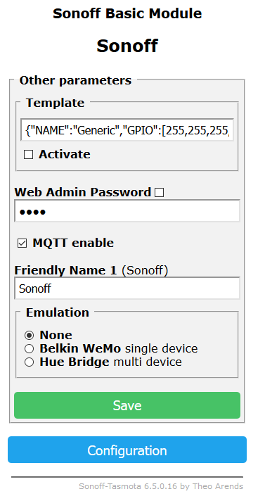

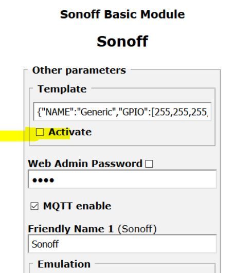

            eben nicht, es werden 3MB verwendet und warum auf Basic und nicht auf generic?
            OK, wenn bei der 6.6.0.4 nichts für Dich relevant dabei istr kannst auch bei der 6.5 bleiben wobei da nach Changelog schon einige Bugfix drin sind.

                Glasfaser @ecki945 last edited by
                @ecki945
                Mach den bitte aktiv .

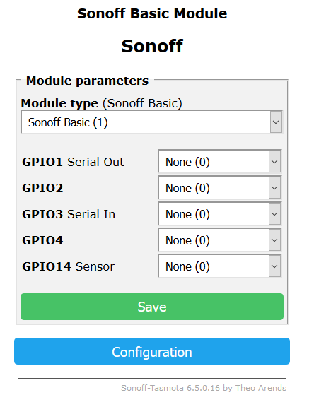

                  Hab ich. Leider hat sich nicht viel geändert.
                  00:00:00 CFG: Loaded from flash at 3FB, Count 17
                  00:00:00 Project sonoff Sonoff Version 6.5.0.16(sonoff)-2_5_2
                  00:00:00 SNS: Hardware Serial
                  00:00:00 WIF: Connecting to AP1 FRITZ!Box 7490 in mode 11N as sonoff-3209...
                  00:00:04 WIF: Connected
                  00:00:04 HTP: Web server active on sonoff-3209 with IP address 192.168.178.45
                  19:35:20 MQT: Attempting connection...
                  19:35:20 MQT: Connected
                  19:35:20 MQT: tele/sonoff/LWT = Online (retained)
                  19:35:20 MQT: cmnd/sonoff/POWER =
                  19:35:20 RSL: tele/sonoff/INFO1 = {"Module":"Generic","Version":"6.5.0.16(sonoff)","FallbackTopic":"cmnd/DVES_63AC89_fb/","GroupTopic":"sonoffs"}
                  19:35:20 MQT: tele/sonoff/INFO2 = {"WebServerMode":"Admin","Hostname":"sonoff-3209","IPAddress":"192.168.178.45"}
                  19:35:20 MQT: tele/sonoff/INFO3 = {"RestartReason":"Software/System restart"}
                  19:35:28 RSL: tele/sonoff/STATE = {"Time":"2019-08-11T19:35:28","Uptime":"0T00:00:14","Heap":25,"SleepMode":"Dynamic","Sleep":50,"LoadAvg":21,"Wifi":{"AP":1,"SSId":"FRITZ!Box 7490","BSSId":"34:31:C4:38:A0:8B","Channel":11,"RSSI":66,"LinkCount":1,"Downtime":"0T00:00:04"}}
                  19:35:28 RSL: tele/sonoff/SENSOR = {"Time":"2019-08-11T19:35:28","SML":{"Total_in":1635.5859,"Total_out":17788.1531,"Power_curr":308,"Meter_number":"0649534b011073747990"}}
                  19:35:38 RSL: tele/sonoff/STATE = {"Time":"2019-08-11T19:35:38","Uptime":"0T00:00:24","Heap":25,"SleepMode":"Dynamic","Sleep":50,"LoadAvg":19,"Wifi":{"AP":1,"SSId":"FRITZ!Box 7490","BSSId":"34:31:C4:38:A0:8B","Channel":11,"RSSI":66,"LinkCount":1,"Downtime":"0T00:00:04"}}
                  19:35:38 RSL: tele/sonoff/SENSOR = {"Time":"2019-08-11T19:35:38","SML":{"Total_in":1635.5868,"Total_out":17788.1531,"Power_curr":308,"Meter_number":"0649534b011073747990"}}
                  19:35:48 RSL: tele/sonoff/STATE = {"Time":"2019-08-11T19:35:48","Uptime":"0T00:00:34","Heap":25,"SleepMode":"Dynamic","Sleep":50,"LoadAvg":19,"Wifi":{"AP":1,"SSId":"FRITZ!Box 7490","BSSId":"34:31:C4:38:A0:8B","Channel":11,"RSSI":66,"LinkCount":1,"Downtime":"0T00:00:04"}}
                  19:35:48 RSL: tele/sonoff/SENSOR = {"Time":"2019-08-11T19:35:48","SML":{"Total_in":1635.5876,"Total_out":17788.1531,"Power_curr":308,"Meter_number":"0649534b011073747990"}}
                  19:35:58 RSL: tele/sonoff/STATE = {"Time":"2019-08-11T19:35:58","Uptime":"0T00:00:44","Heap":25,"SleepMode":"Dynamic","Sleep":50,"LoadAvg":19,"Wifi":{"AP":1,"SSId":"FRITZ!Box 7490","BSSId":"34:31:C4:38:A0:8B","Channel":11,"RSSI":64,"LinkCount":1,"Downtime":"0T00:00:04"}}
                  19:35:58 RSL: tele/sonoff/SENSOR = {"Time":"2019-08-11T19:35:58","SML":{"Total_in":1635.5885,"Total_out":17788.1531,"Power_curr":317,"Meter_number":"0649534b011073747990"}}

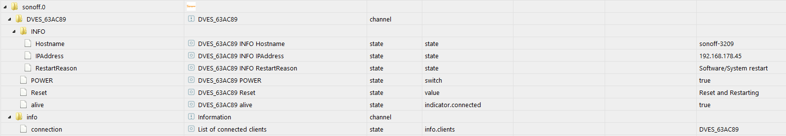

                  sonoff.0	2019-08-11 20:37:08.521	debug	Client [DVES_63AC89] pingreq
                  sonoff.0	2019-08-11 20:37:05.395	debug	system.adapter.admin.0: logging true
                  sonoff.0	2019-08-11 20:36:56.038	debug	system.adapter.admin.0: logging false
                  sonoff.0	2019-08-11 20:36:53.487	debug	Client [DVES_63AC89] pingreq
                  sonoff.0	2019-08-11 20:36:38.487	debug	stateChange sonoff.0.DVES_63AC89.POWER: {"val":false,"ack":true,"ts":1565548598480,"q":0,"from":"system.adapter.sonoff.0","user":"system.user.admin","lc":1565546656230}
                  sonoff.0	2019-08-11 20:36:38.471	debug	[DVES_63AC89] Received: cmnd/sonoff/POWER =
                  sonoff.0	2019-08-11 20:36:38.458	debug	stateChange sonoff.0.DVES_63AC89.alive: {"val":true,"ack":true,"ts":1565548598455,"q":0,"from":"system.adapter.sonoff.0","user":"system.user.admin","lc":1565548598455}
                  sonoff.0	2019-08-11 20:36:38.429	debug	stateChange sonoff.0.info.connection: {"val":"DVES_63AC89","ack":true,"ts":1565548598412,"q":0,"from":"system.adapter.sonoff.0","user":"system.user.admin","lc":1565548598412}
                  sonoff.0	2019-08-11 20:36:38.239	info	Client [DVES_63AC89] connected with secret 1565548598211_1404
                  sonoff.0	2019-08-11 20:36:27.262	debug	stateChange sonoff.0.DVES_63AC89.alive: {"val":false,"ack":true,"ts":1565548587259,"q":0,"from":"system.adapter.sonoff.0","user":"system.user.admin","lc":1565548583399}
                  sonoff.0	2019-08-11 20:36:27.220	debug	stateChange sonoff.0.info.connection: {"val":"","ack":true,"ts":1565548587206,"q":0,"from":"system.adapter.sonoff.0","user":"system.user.admin","lc":1565548587206}
                  sonoff.0	2019-08-11 20:36:27.191	info	Starting MQTT authenticated server on port 1882
                  sonoff.0	2019-08-11 20:36:27.113	info	starting. Version 2.2.2 in /opt/iobroker/node_modules/iobroker.sonoff, node: v10.16.2
                  sonoff.0	2019-08-11 20:36:27.067	debug	statesDB connected
                  sonoff.0	2019-08-11 20:36:27.015	debug	objectDB connected
                  Ich glaube da hat sich grundsätzlich nicht viel geändert.

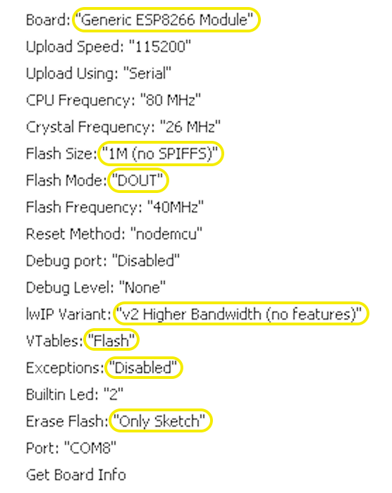

                                          Rückmeldung für die Nachwelt:
                                          Das neu compilieren mit den diesen Einstellungen in der Arduino IDE hatte leider kein Erfolg. Die "Nutzdaten" wurden in IO-Broker nicht angezeigt.
                                          Auch das Austauschen der Plattform.txt Datei nicht:
                                          "Replace in Arduino IDE folder portable\packages\esp8266\hardware\esp8266\2.5.2 file platform.txt with the Tasmota Source code file arduino\version 2.5.1\platform.txt.", beschrieben hier:
                                          https://github.com/arendst/Sonoff-Tasmota/wiki/Arduino-IDE
                                          Erst als ich im LIB Verzeichnis der Ardiuno IDE "aufgeräumt" habe, funktioniert nun die Datenübertragung komplett, mit den Boardeinstellungen von oben aus der Grafik.
                                          Danke Euch für Eure Geduld und Tipps.

                                            Jan1 @ecki945 last edited by
                                            @ecki945
                                            Warum kompilierst Du mit Arduino? Da muss man sehr genau wissen was man macht. Mit Atom oder VSC geht das direkt über Tasmota geregelt von ganz alleine. Ich nutze alle 3 und fahre mit VSC am besten.
